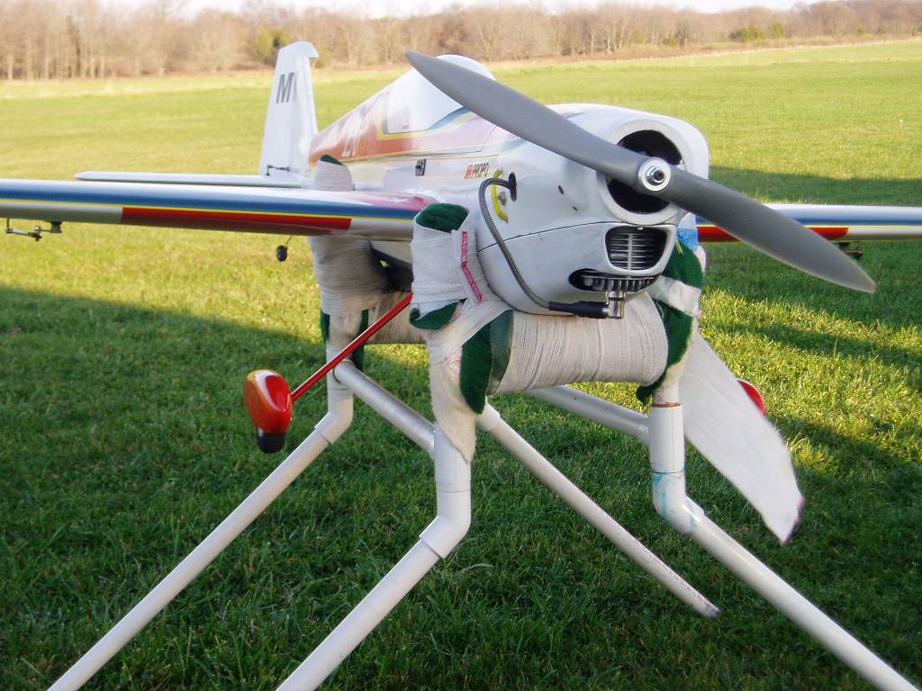

Here's a couple of pictures of the SAP 180 in Matt's Enigma:
The photo on the left shows the soft mount. The ignition module is mounted using the Syssa supplied hardware...simple, effective, clean. The spark plug wire has a plug with a wire retainer spring ring to keep it snug in place. We had to remove the ring to pull the socket off the spark plug.
The yellow nyrod on top of the picture is the choke rod. The carb factory settings were too lean which caused us some trouble in getting the engine to start, but once we richened it up, we had no problem starting it.
Matt
