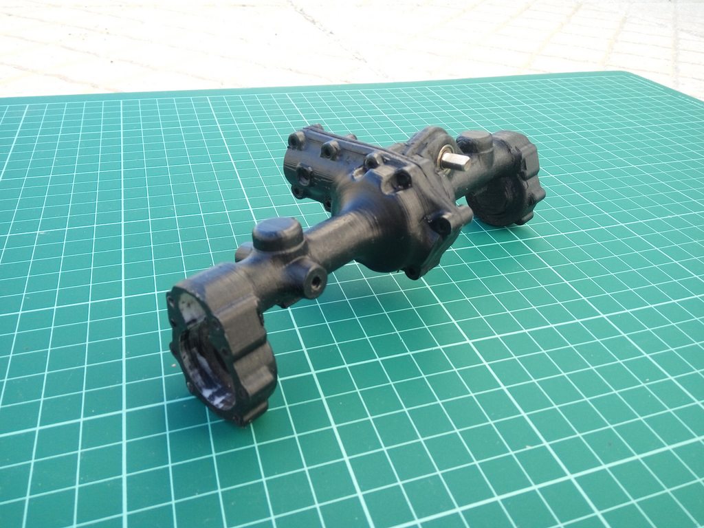

Alright,is that time of year again,time for change...
One thing I think I need to improve in this truck is the front axle width. Wheels stick out from the fenders and there's too much scrub radius from the added width of the portal boxes,making the tires rub
So I've gather some parts and make new portal boxes:
Yes, they look similar,albeit being made from scratch instead of copying the old ones.
I'm using a 12t portal gear and universal shafts from Capra. The big gear is the same 25t 32dp pinion but inverted(The section where the grub screw is fits perfectly on a 10x15x4 bearing!
At the moment, each portal box measures 5,5mm less than the old ones which is great. I can narrow the axle housing if needed,even if it don't solve the scrub radius problem
Old 07-19-2022 | 03:00 PM
  #62
Joined: Jul 2018
Posts: 156
Received 25 Likes on 19 Posts
Everything seems to be going well
Printed the 2 knuckles and 2 covers. Mounted, match the estimate of 11mm narrower axle. Doesn't seem much but is very noticeable with the cab.
At the moment, I'm printing a updated axle housing half. Only had to change a driveshaft bearing position by 1mm to fit the new Capra uni shafts
Before vs. now:

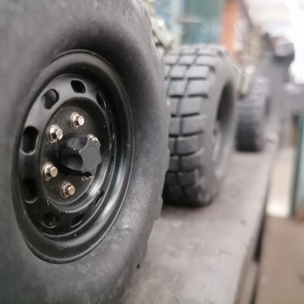

Small detail for this truck:
I've always wanted something better than the standard M4 nuts on the wheels. I once bought a set of "hubs" but they were too long. Ended on the Land Cruiser with the Toyota logo laser etched...
Now I got a different set but they were long too. But these ones were simpler, with just a M4 nut pressed inside. So, I've pressed them an extra 2.5mm and machined the excess. I like the result
