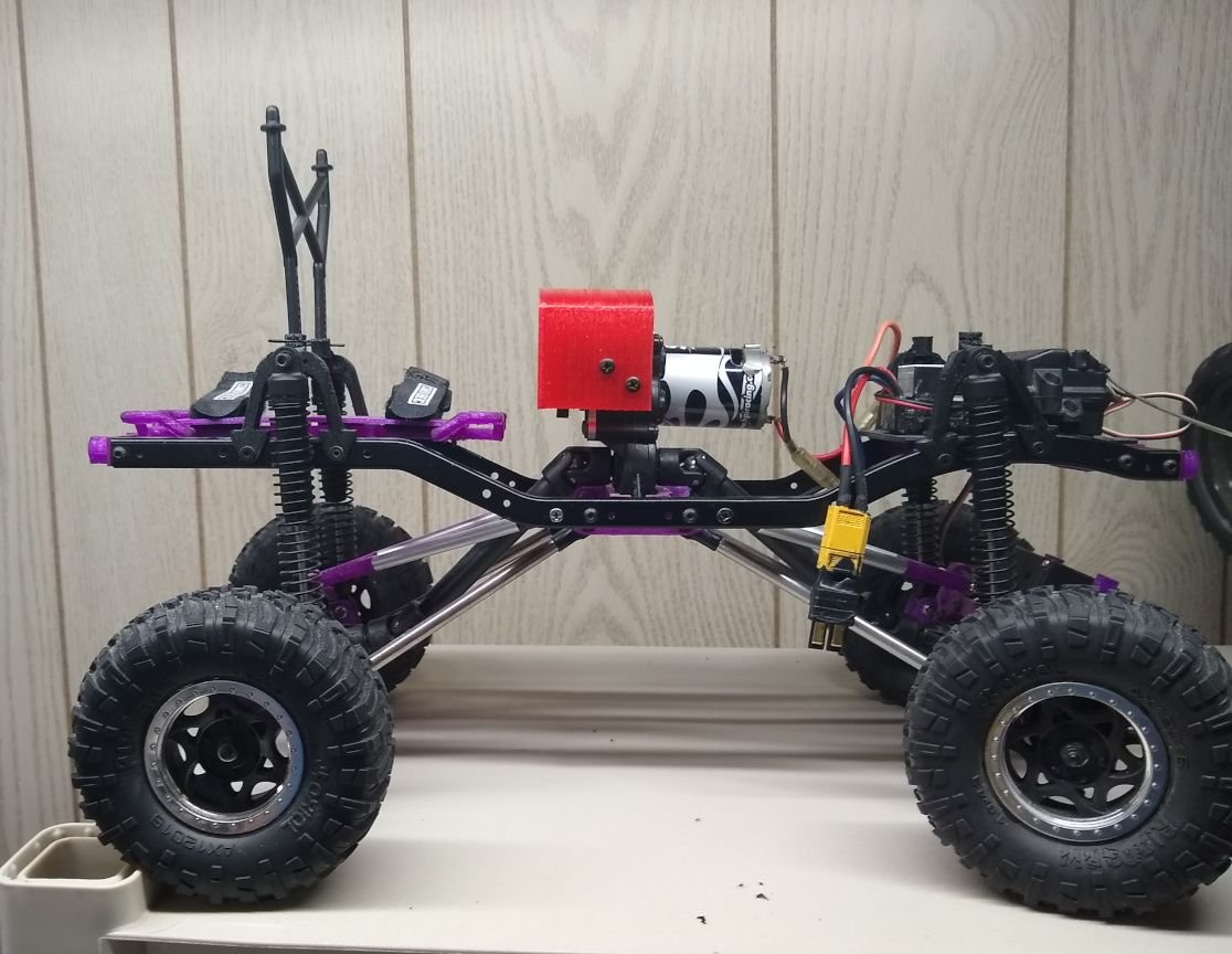

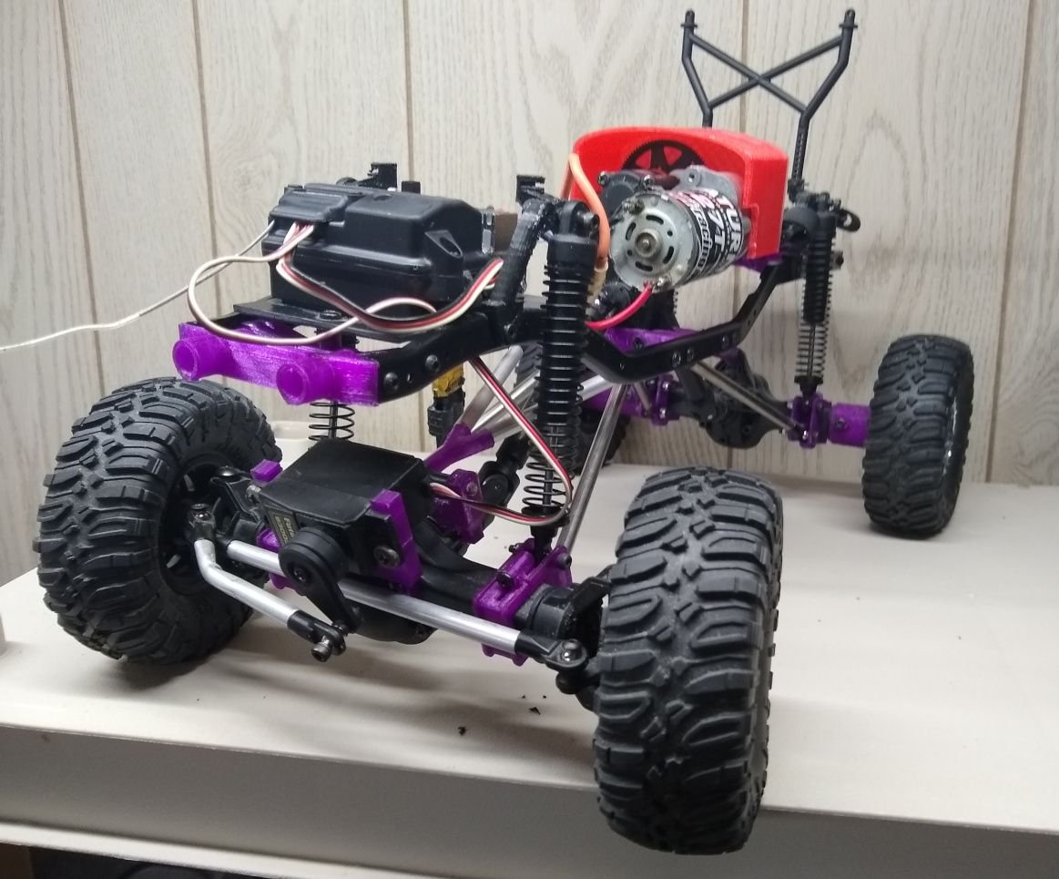

The base of the vehicle is a frankensteined SCX10, and HPI wheely king I made
Here is an old picture(and what I started with)
It has an Axial SCX10 frame a wheely King transmission, and axles, and at this time Wheely king shocks, and a pile of custom made 3d parts I designed along with custom made links. The driveshafts, and connectors to the axles are traxxas(I forgot the part number as I started this 10 years ago).

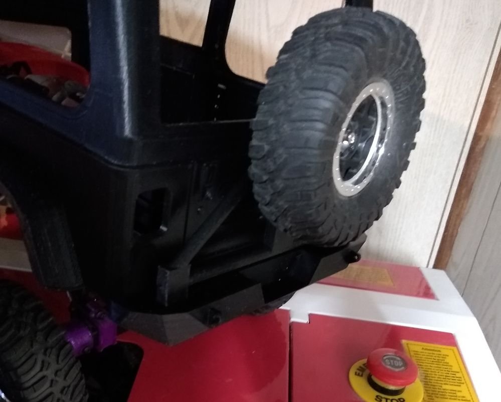

I then proceeded to design it a custom front and rear bumper based on pictures I saw. (btw I used tinker cad for all the work. Thinks I have made in it has blown the mind of one of my old time buds away)
The rear bumper was based on one I saw on Amazon for sale for real jeeps, and the front was based on what I saw were stock YJ's

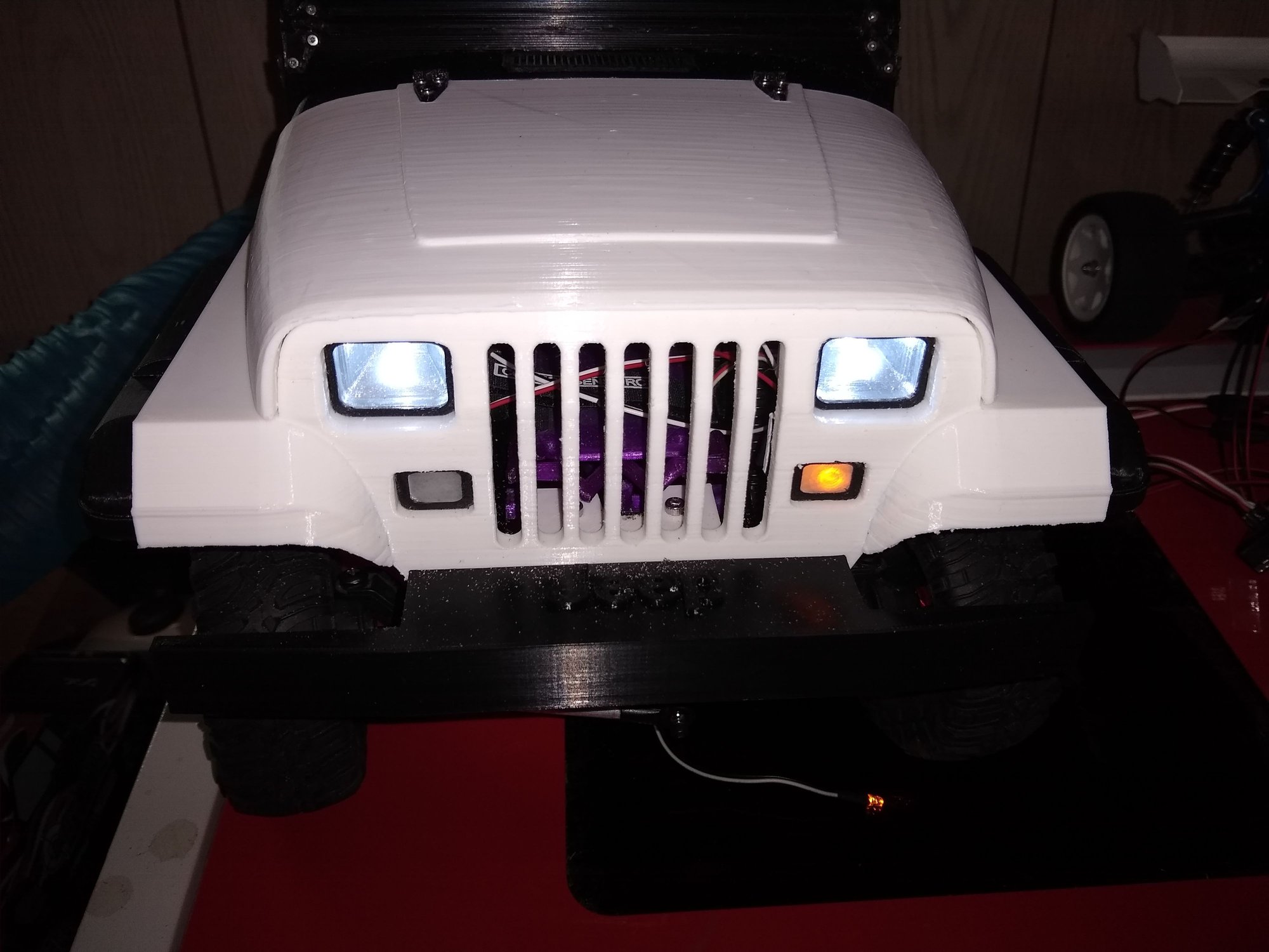

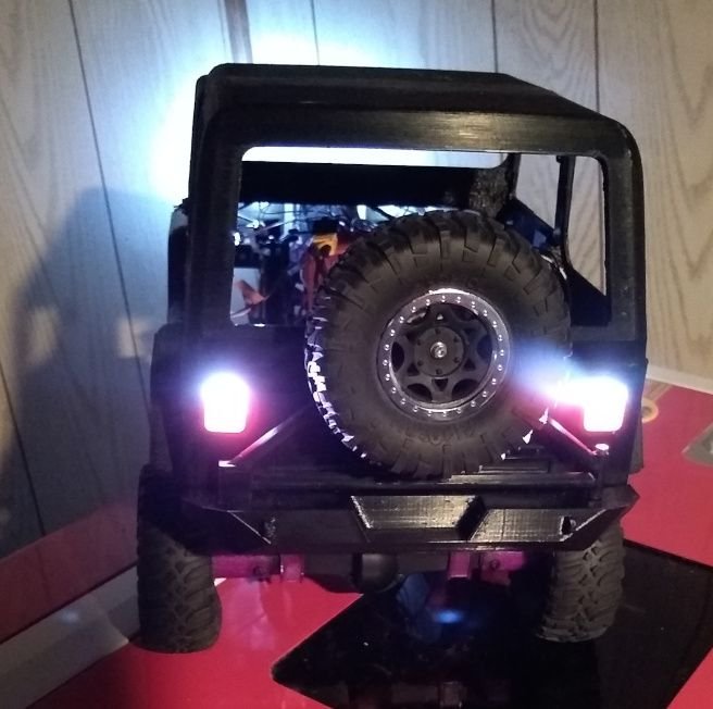

Next step was headlights, and turn signals
I went looking for something in a box, and found some axial SCX10 parts, and saw 2 fog lamps, and was like those would be perfect, so I made a fast bracket, and screwed them into the front bumper in the approximate spot they would go on a real YJ
I also made the tail lights.
The RC off
RC at a stop with left turn signal blinking (it appears better in person) There are 3 LED's in each rear brake light stop/dim for headlights being on, turn, and reverse.
The RC in reverse.
The headlight lenses were made from a Costco pie containers top piece which was clear plastic. To frost it for the front turn signals, and rear lights I took 800 grit sandpaper and sanded it in circles.
For the rear brake lights I then took red sharpie and colored in the brake signal section while leaving the reverse area untouched.
I friction fit the light buckets into the body, and together. There are screw holes I could use but the fit is so tight it takes way more force to knock em out then the RC will ever see.

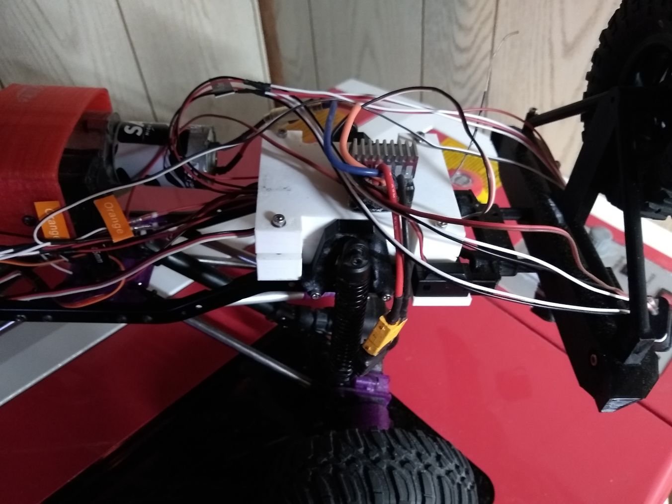

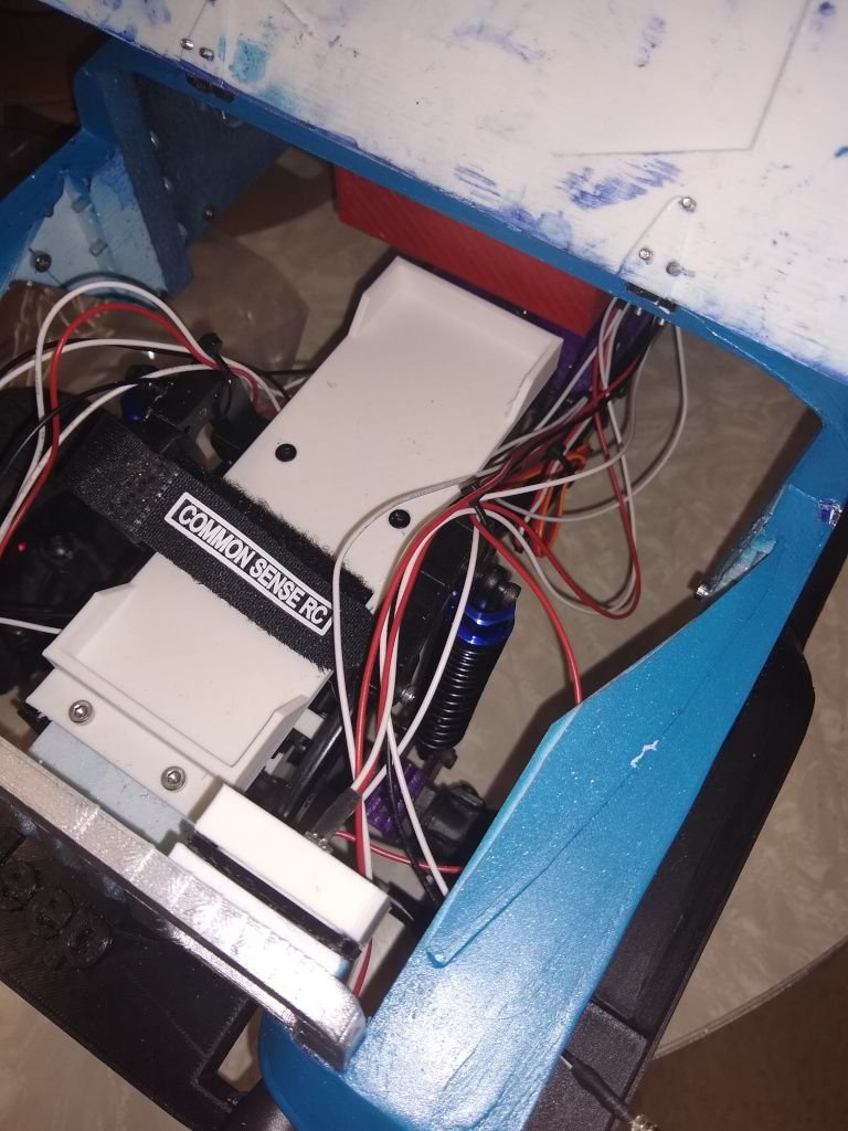

in the last picture in the prior post you can see a rats nest of wires from how I kinda just haphazardly wired it so I decided it was time to clean it up, and mount the electronics better then they originally were.
This was my solution
It is a box I made to hold the LED controller, and the RX. I designed it to wrap around the rear shock towers.
The rear shock toweres also were redesigned for this to allow it to go on easy as I removed the body mounts as they are not needed for this RC, and also to make it stronger as one of the old shock towers were broken due to how thin the mounting tab was. The redesign made the tabs 4x thicker to where I doubt they will ever break. The front also has a new design based on the rears.
The box is made to be as water tight as I could get it. I made it in 2 halves, and took door, and window sealing tape, and put a strip on the top, and bottom with 4 screws (one in each corner) to hold it shut. This allowed me to easily put the pile of wires through.
How water tight is it? I don't know, but it would at least prevent any water getting in outside total submersion to which there is a high chance it wouldn't leak for a foot or 2 due to how much I compressed the sealing tape when I screwed the top to the bottom.
I also put the power switch for the ESC in an easily accessible location right behind the rear shock tower. I'm thinking of looking for a rubber piece I know I had somewhere on a RC to cover it from liquid, and debris though.

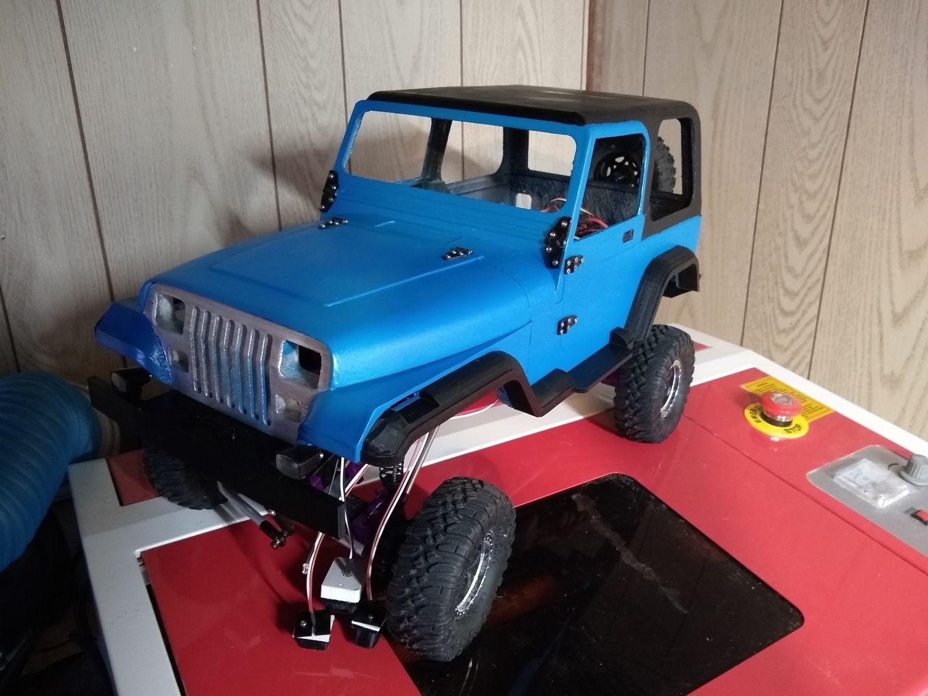

Anyways now that all that was done I decided to paint it
I bought some cheap acrylic paint set off amazon that had a pile of colors tried a few, and ended up painting it acid blue that I mixed a tiny bit of metallic silver (I had a old parma bottle from years back) in to give it a slight shimmer in person.
After I took this picture I resprayed the front grill as in person I didn't see it was blue

I then made windows for it. I originally had the plan to laser cut acrylic, make custom 3d printed mounting brackets, and on hour 2 of making a template I said screw it(well the real word started with f...) grabbed the rest of the costco pie container top, a pair of scissors, and cut em out. Then grabbed a hot glue gun to hold them in, and honestly I am quite happy with the results

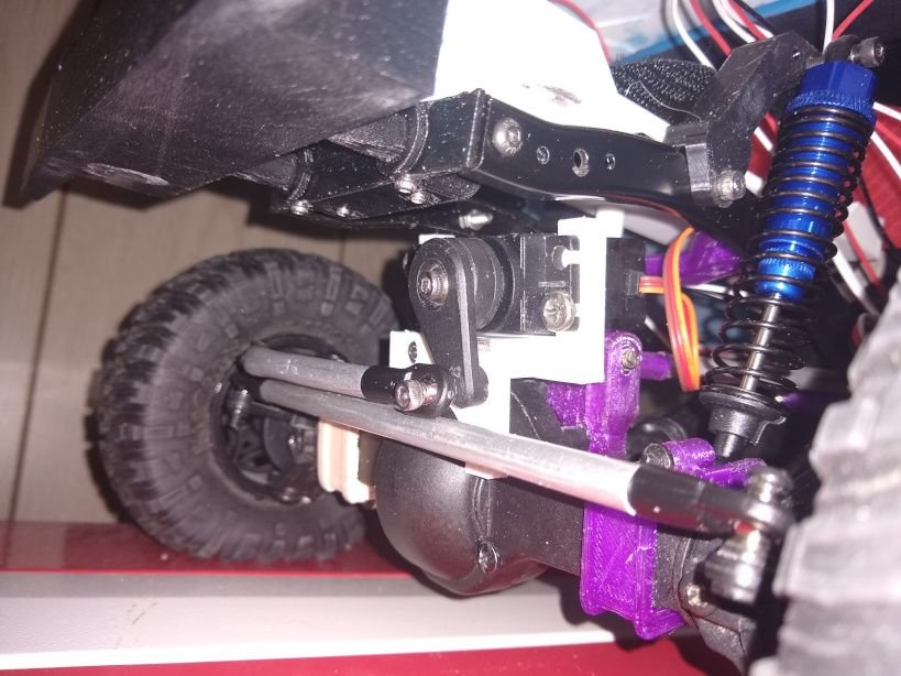

Well with it painted, wired up, and having windows I still wasn't happy with some things
Namely I hated how it sat with the stock wheely king shocks
So I ordered a set of 70mm shocks which from what I saw are the same length as scx10 shocks which brought the ride height down a lot(I think the WK were 120mm >.> ), makes it look better, and it also isn't wobbly anymore... The WK shocks the body would sit a bit slanted(there isn't a pic it is something seen in person), but now it is perfectly straight.
But the new shocks introduced a new problem
I had less then 2mm's travel before the steering servo would slam into the bumper mount....
SO I had to redesign the steering servo mount moving the servo around 20mm's farther back, remove the front battery tray mount, and design a completely new battery tray with spacers.
I wanted to go farther back, but the servo horn couldn't be moved back even 1 more millimeter before it wouldn't work anymore it is JUST clearing the mount now, but with the battery mount removed it clears perfectly.
The new battery box which now screws into the front body mount. It also only needs one strap now due to having a front, and back on it so the battery can't slide around.
With these changes the front shocks can now almost bottom out(they have like 1mm left in travel) before the servo hits the strap of the battery tray
