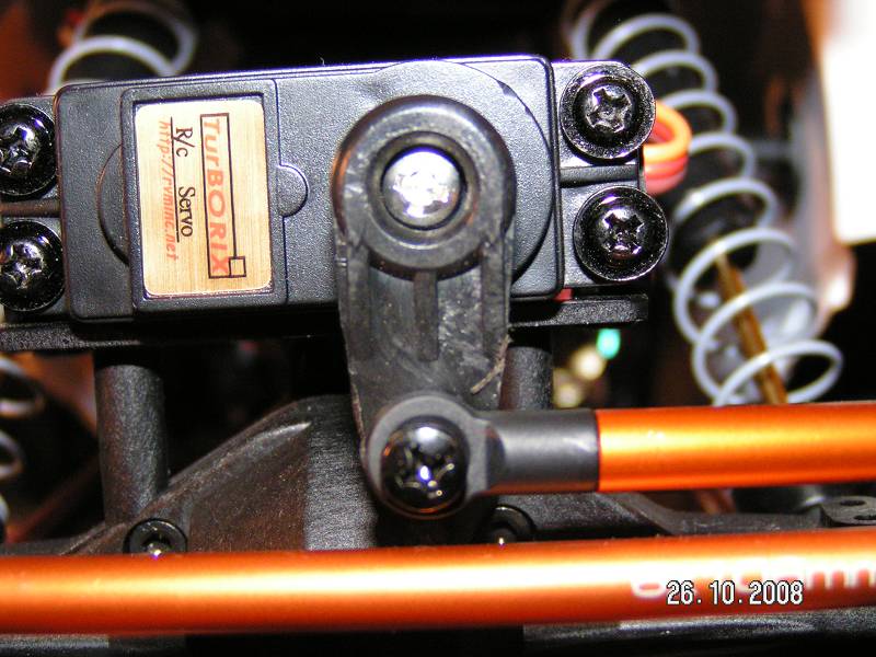

use a longer servo horn for more throw. or mess with your endpoints (if you have them) to turn sharper
Also, get a BEC set for 6V. it looks like you just may need more power to the servo.

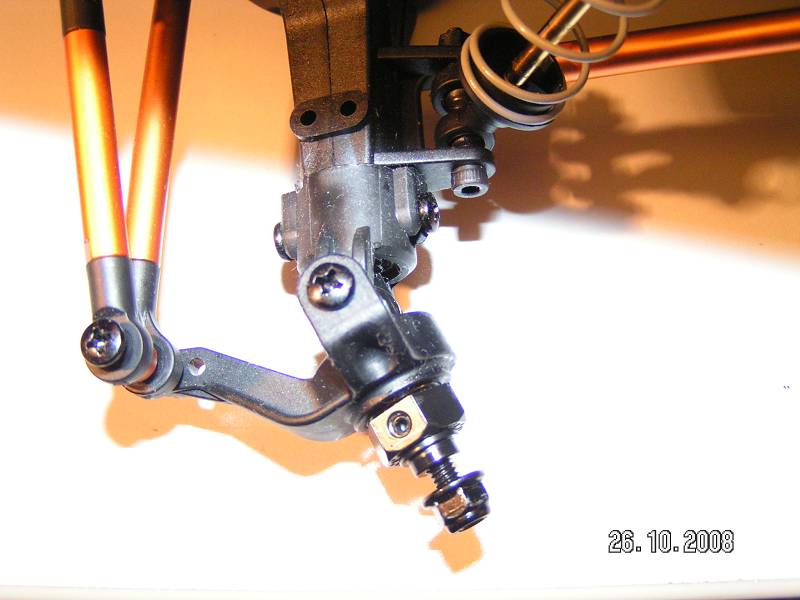

Post a pic from the top with the body and front wheels off. I want to see what holes you are using for mounting the steering links

Think your right Modder in the end it doesn't pay to skimp on servo's! Joe,putting a couple of pic's up so you can see the set up.You are right about the holes in the hubs,should use the first ones not the second as for the servo horn there's no more clearance on the steering rod.

you can get more throw (but loose steering torque) by moving the steering links to the hole closer to the axle on your ackerman arm (the lever on the knuckle)
Steering is a give/take situation, you can either have more throw or less torque.
