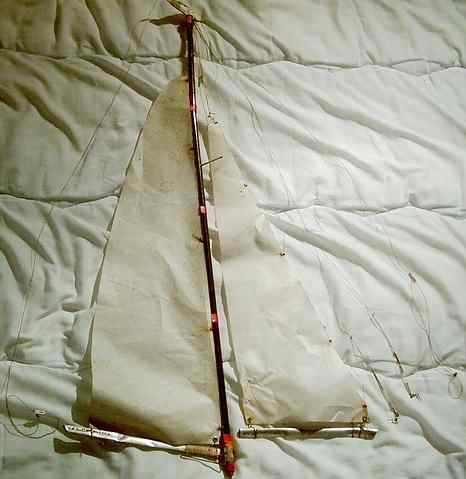

mast head.
the blue line goes to the back of the yacht, and also pulls the rear sail up the tight line also visiable right behind the mast as the yellow line.
the red is attached to the top of the front sail and hooks to the head.
pink is 3 lines, two of which goto the sides, the other runs down the front of the front sail.
green attaches to the front of the boat.
all a bit teci for what i know about yachts

This will be one of the most complicated parts to get right
You will need to be sure the sail will not interfere with Back stay. In other words, make the piece plenty long.
You should also add a Bowi to adjust the back stay

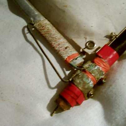

This is one of the things I learned from racing Victorias. This is a little bent piece of Brass that alows adjusting the postion of the Jib.
Oh yea, make new booms for each sail out of would to save weight. Dont worry about them breaking, they wont.

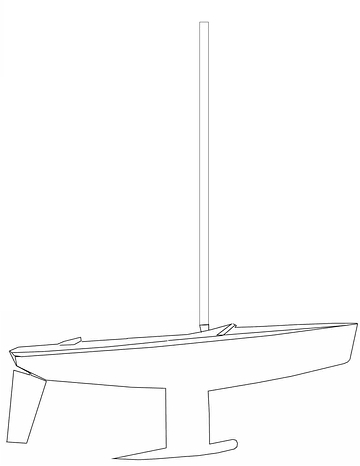

heres a simple pic of Bluey if anything needs drawing.

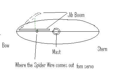

From what you describe, The set up should be like your 575. The jib SHOULD NOT BE ATATCHED TO THE MAST. Exept for the top of course. The SW will come out of the deck through a hole centered in the Deck under the Jib Boom as it is centered Paralell with the Hull.

I am guessing this is how your radio set up is? If not, I higly recomend doing so.
Also, you can usally get SpiderWire at your "Local Shop Hobby"
Other wise, every big fishing store has it.
The two servos are mounted on two sruce rails that run across the boat and are epoxied in place. The sail servo arm should be as long as possibal to maximize sail travle.
Oh yeah, have you found the keel yet? After all, its a very important piece. You wouldent want it to cap size it and drown would you? :drowning:

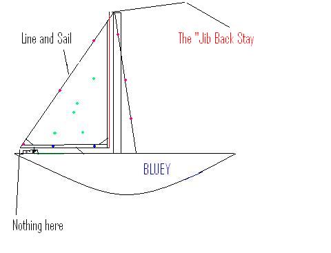

NO NO NO! Once the pink wire comes down the sail, it should be atatched to the Jib boom and tied down there.
Perhaps this picture will clear things up.
The Jib back stay is simply for support and to adjust the curve in your sail for sport racing. But you will still need it on your boat.
Sorry for the bad info :stupid:

ok, i have that radio set up, it was the same for the 575, and Bluey already has a HUGE! fibreglass arm.
if i get the drawing now, i come up the front of the jib, through the head and this wire then goes one side, it tensions the sail.. currently i have another line at the top between the jib top, and head which tensions the sail, the pink line stops at the head and the sail is connected to the line with hooks. ie it can move along the line. i guess bottom tension comes from the front mount at the moment, with the winch at the rear.
Still no joy finding the keel yet. but im going to a display for the weekend, there should be a tradestand with CF tube the size i need, wasnt any in the LHS today. it'll also give dad time when he gets back from London to sort through his cr&p and find it.
if not i laminate up some ply and balsa, and fair in a fishing weight ( streamlined of course )
now.. i guess theres some equation of where the boat should balance on its side when correctly balanced. bottom of the mast? top of the keel?

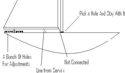

Thank you steve! I never knew about waterlines of a boat! That will be very helpfull for my victoria!
Philly, (what a cool name!) after much slow reading and eye strain, I belive you have the correct figuration of where the lines should go and end.
Exept for one thing. I explaned this the first time, but took forever to write. So this time I will just tell you. Take the cleet off of your deck. The one that tension the bottome of Jib. Its bad luck.
Just use a loop of string or a little clip to hold the Jib down on one of those millions of holeshssdhaslkfjaflka j You know what.

at the moment all my holes are on the jib boom, think it links to the front of the bow.
think what im gonna do is this weekend get a CF mast ( or not lol ) and then get the mast its self built and head. i can then get my 4 mast ties on. and the rest can follow.
once i get the mast on, some clear pics of everthing in place ( as it is now ) should clear things up.
just wondering if i can tape the mast, and quickly connect it now...
if i get your drawings, the hole adjust thing is attached to the boat, and a clip on the end of the boom pulls it out or lets it in. effectivle moving the hinge point for the winch which is attached to the other end of the boom.
oh no, i've just seen your winch is attached to the front of the jib
think i need to see a few pics of diffrent yachts to get all this in perspective.

I cant use pictures of EXACTLY what i'm talking about but here are some very close ones.
Differences= You wont have that revolting for stay.
You will have (acording to what you describe) holes in you Jib boom for adjustment.
And the little line that leads away from the clip is the same as your cleet. That cleet needs to b OH WAIT! Come to think of it, my victoria is like that.... Its my Aussii II that dosent.
Then again the Aussii II is about the same size as your boat...
This is going to be a trial and error type of thing. Build the boat w/ the cleet system. If after a few runs and you dont like it, take it off. By that time, you will come up w/ your own ideas.
