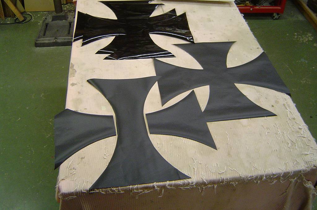

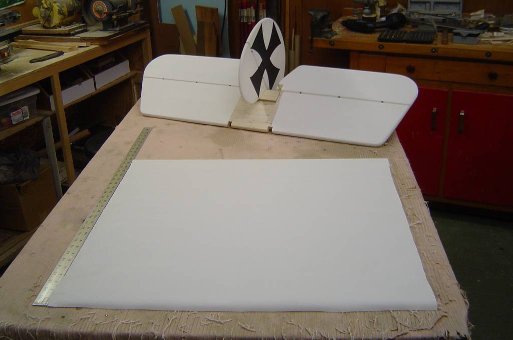

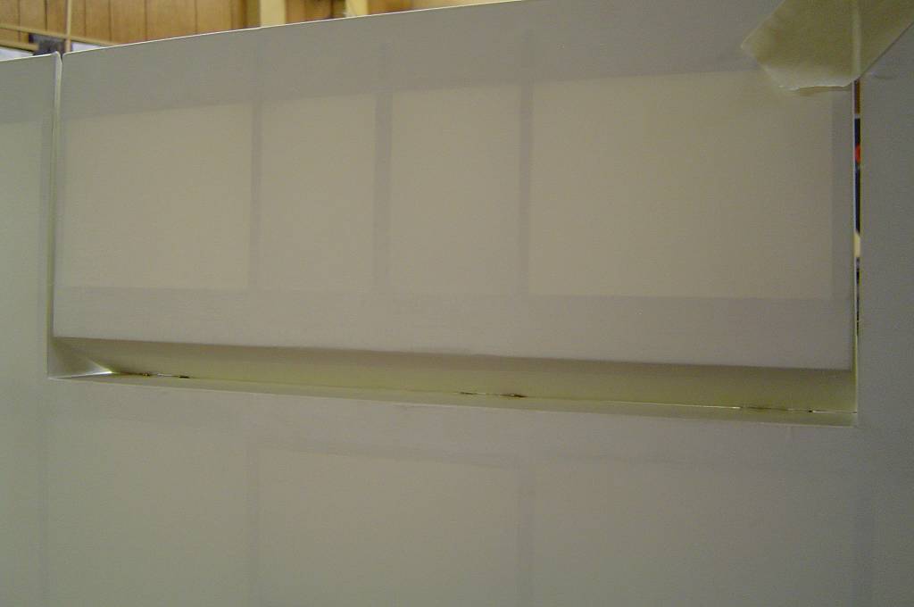

Turtle Report:
The stab is finish sanded and covered as is the fin and rudder.
The rudder has the national markings applied........they are cut from black Solartex and ironed in place. I thought it would be a little easier to cover the tail surfaces and put the markings on before they were glued to the rear of the fuselage.
I think the next step is to permanently glue the fin to the stab and then fit the tail skid assembly.........or bring the wings to a completed state and cover them, too. I have the national markings cut from black Solartex ready and waiting to be applied to the wings.
I had only enough black Solartex to do the upper wing surface markings........and then I had to piece it together. When ironed on the seam will be nearly invisible. The glossy markings are cut from pre-painted Coverite.......I will put these on the bottom surface of the wing because of the high gloss. Maybe a little rub down with some steel wool will dull it down.
Oh, by the way........these markings cut from Coverite & Solartex can be easily ironed on top of most iron on fabrics with no problem. Just use enough heat to activate the adhesive and not enough to cause shrinkage. They can also be ironed onto painted surfaces, too. I use a sock for my iron and place the iron on the covering - DO NOT drag the iron......it will mess with the paint. I am talking about latex house paint. It also works on other types of paint, but always do a test piece before you apply markings to your model.

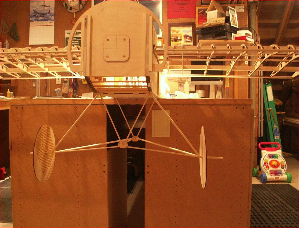

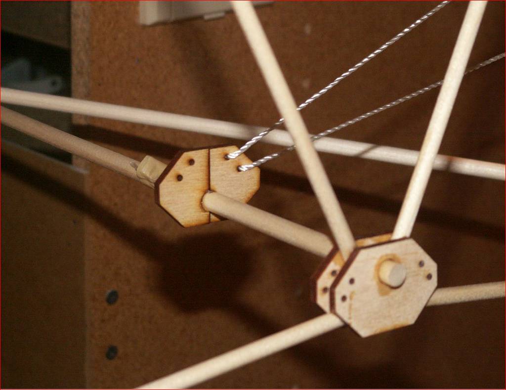

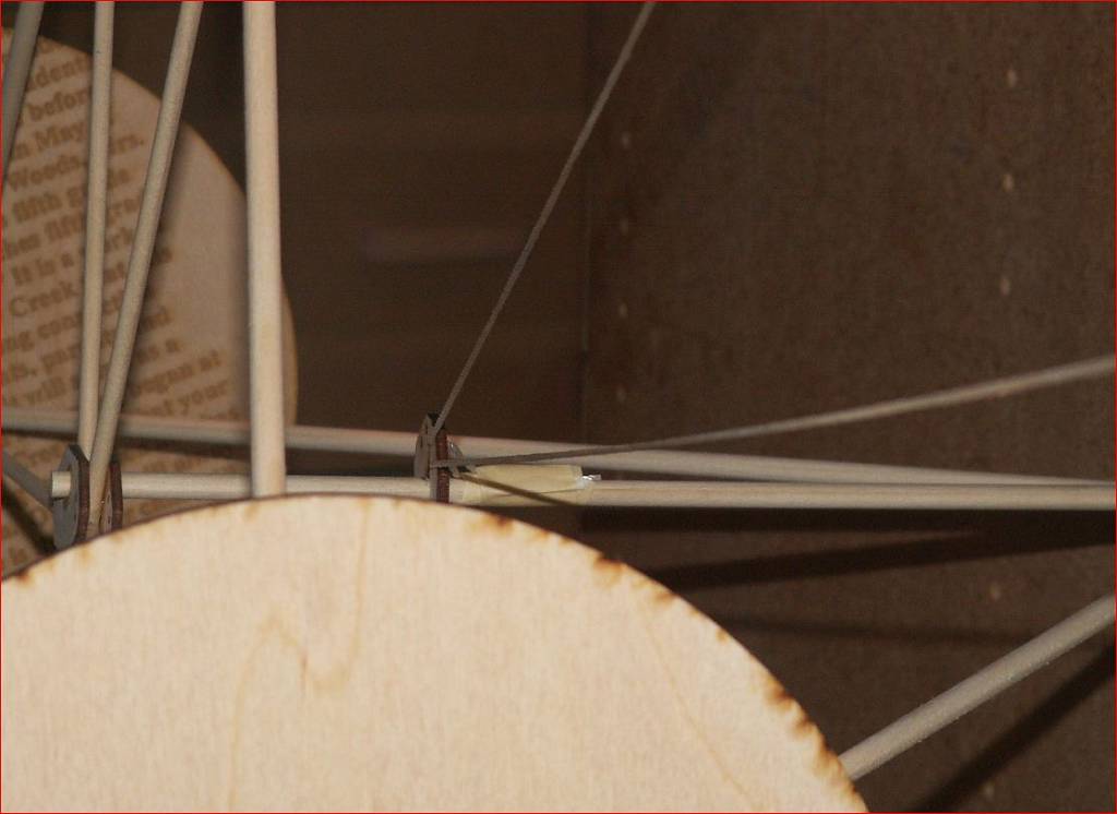

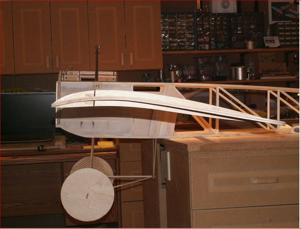

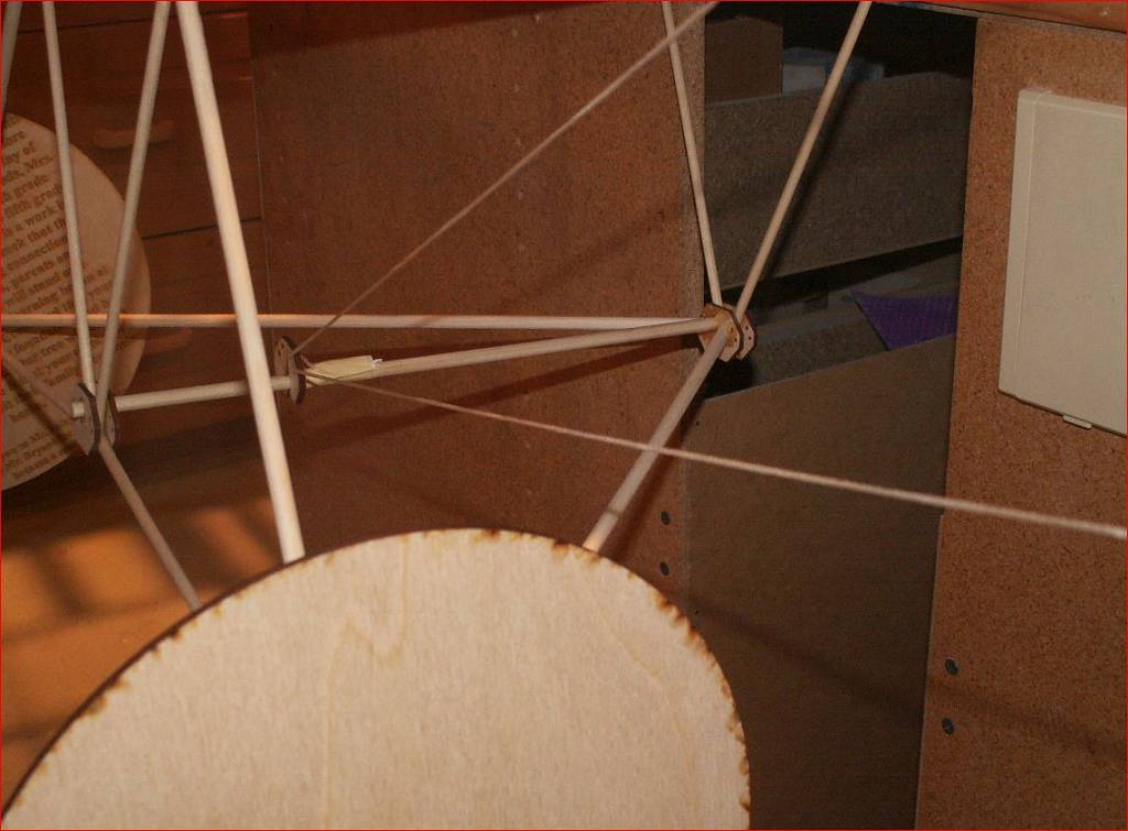

Turtle Report:
......been working on the tail skid supports and this is what I come up with - - - - -

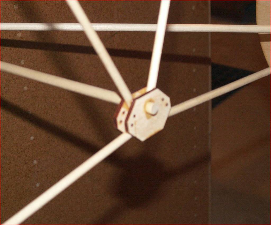

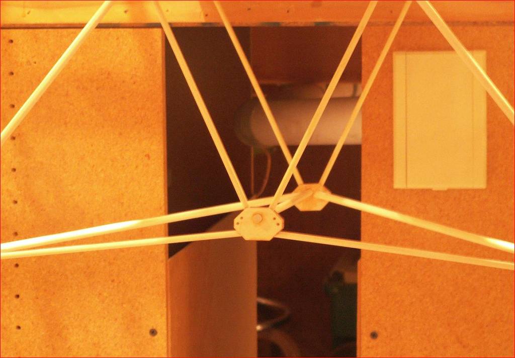

This is what it will look like..........one side done - the other side half done........
It's not scale, but does somewhat resemble the outline - and for a fun scale model, it certainly meets the goal.

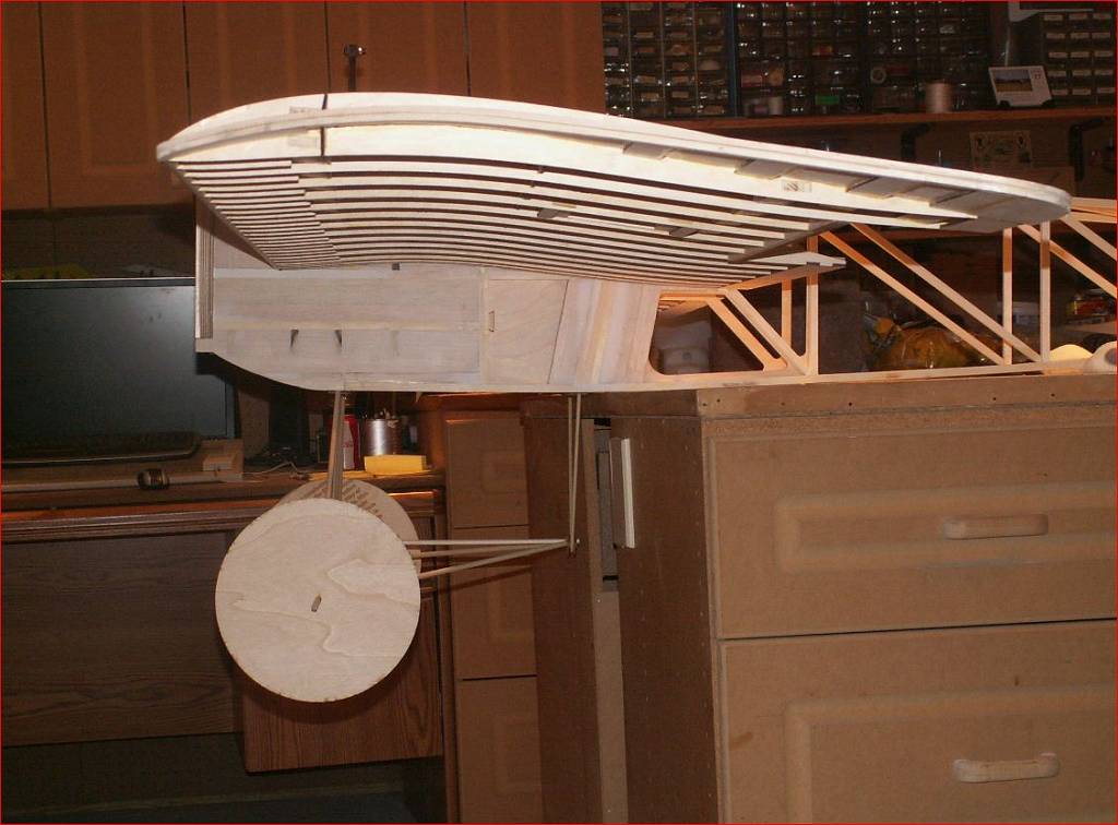

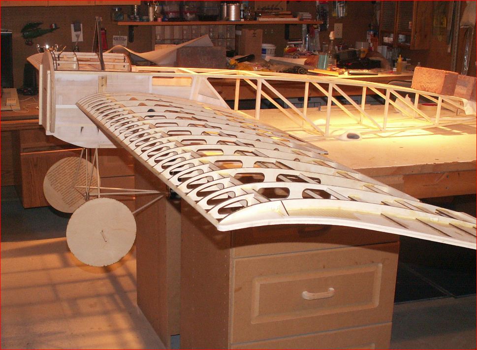

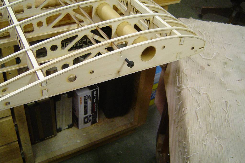

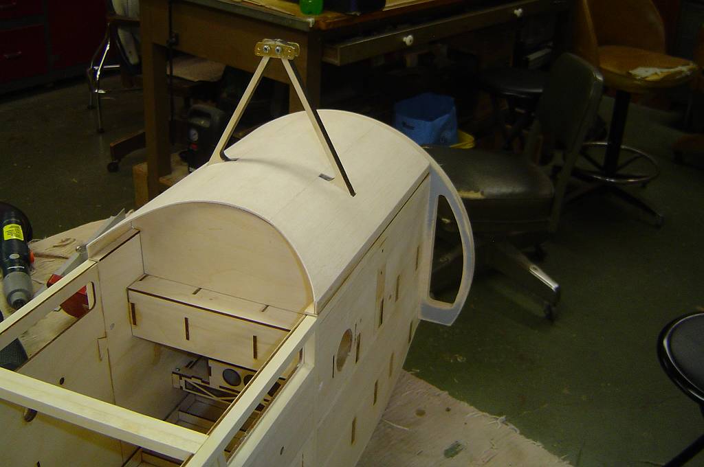

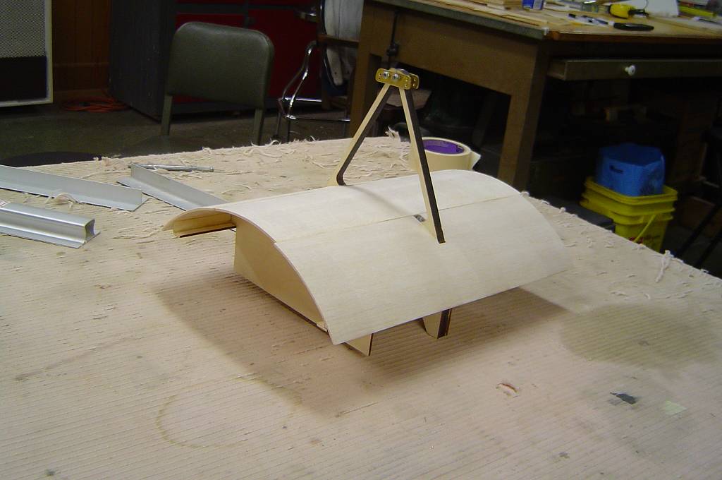

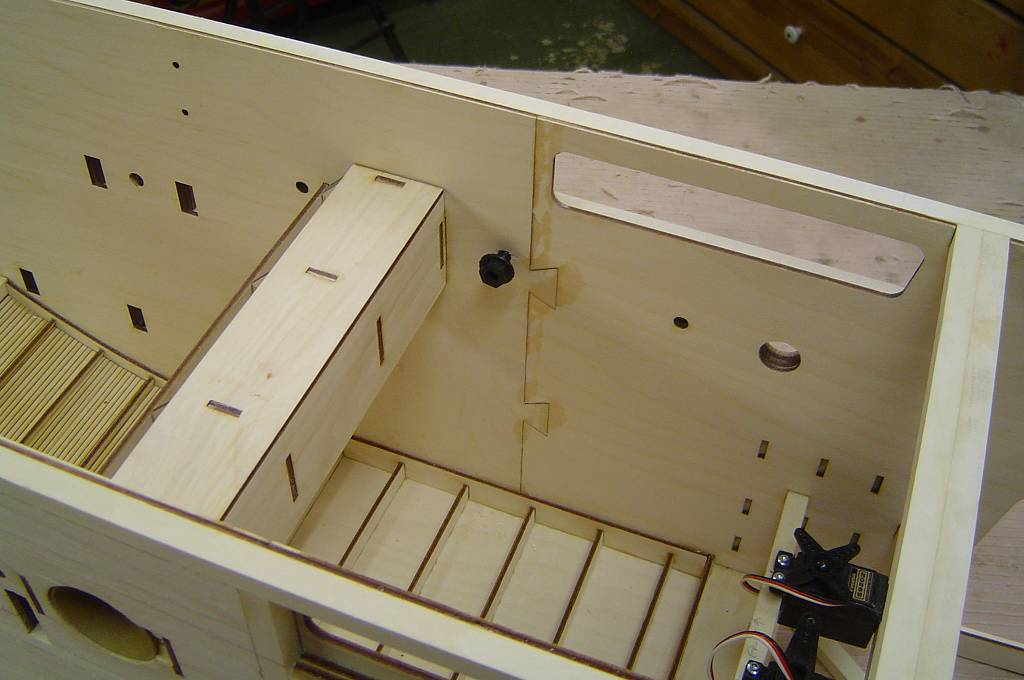

Turtle Report:

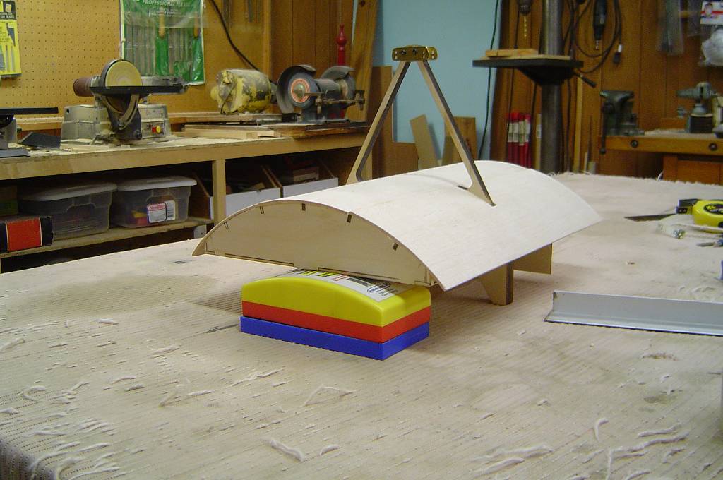

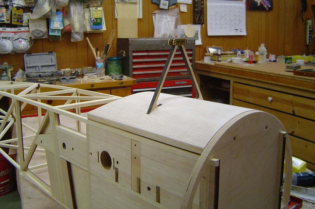

I finished the tail skid cage and knocked off the edges on the skid - it still needs considerable shaping.
Added the wing tube sockets, final fitted the aileron hinges and the ailerons and gave the wing a final sanding.
Then I added two extra layers of ply to the inside of the root ribs just behind the wing tubes - then drilled the fuse and threaded the wing to accept nylon 4-40 wing bolts. This will provide an added level of security to keep the wings on the tubes even though the flying and landing wires alone will actually hold on the wings. As soon as I test fit the wire attach points on the wing and fare in some balsa for the covering to stick to, the wings will be ready for covering - yippee!
The hatch is nearing completion - I have added the brass pieces where the landing wires will attach as well as the hard points to hold the drag wires for the king post and I will also add wires on the backside of the king post. These are not scale but will keep the king post from breaking in the event of a nose over. It needs the balsa sheeting and final sanding.
It's about time to decide which engine I will mount to the firewall and get it drilled and then glued to the front of the fuselage.
I am waffling between a Zenoah 445 twin or a G62 w/prop drive..........

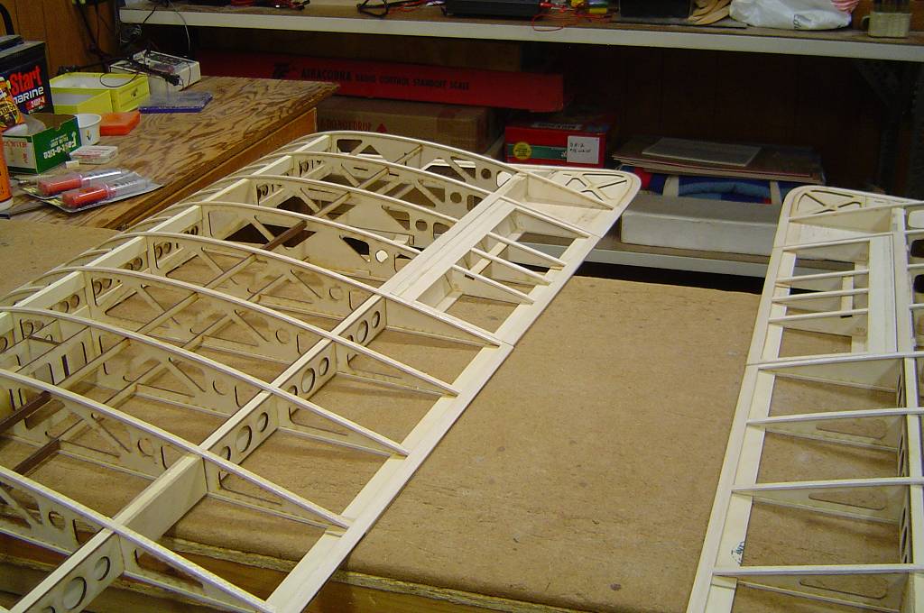

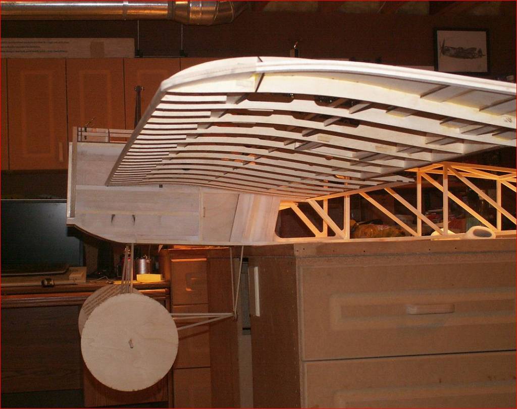

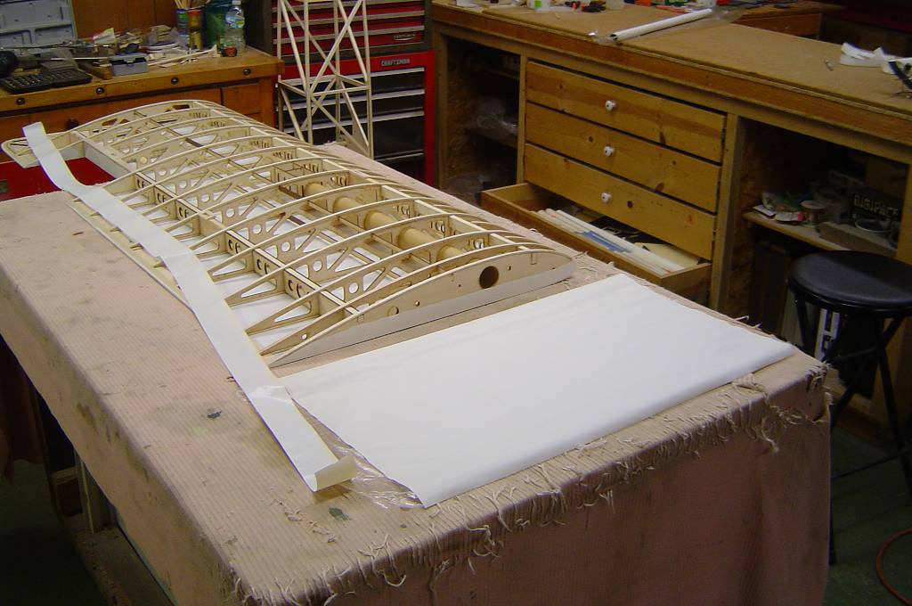

Turtle Report (or should I say "Snail Report")

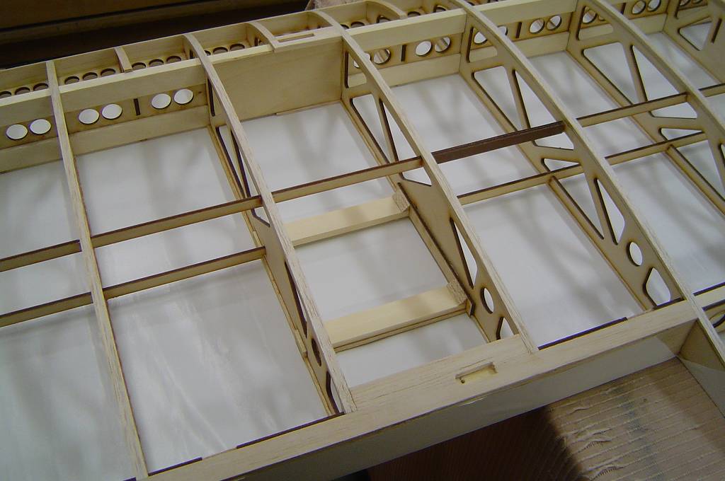

It seems like I am getting slower and slower ......... I am making progress even though I haven't posted anything for almost 2 weeks.
I added extra balsa pieces where each of the landing and flying wires will attach - this allows the covering to be secured around these areas.

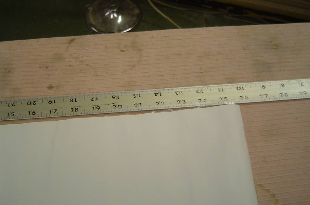

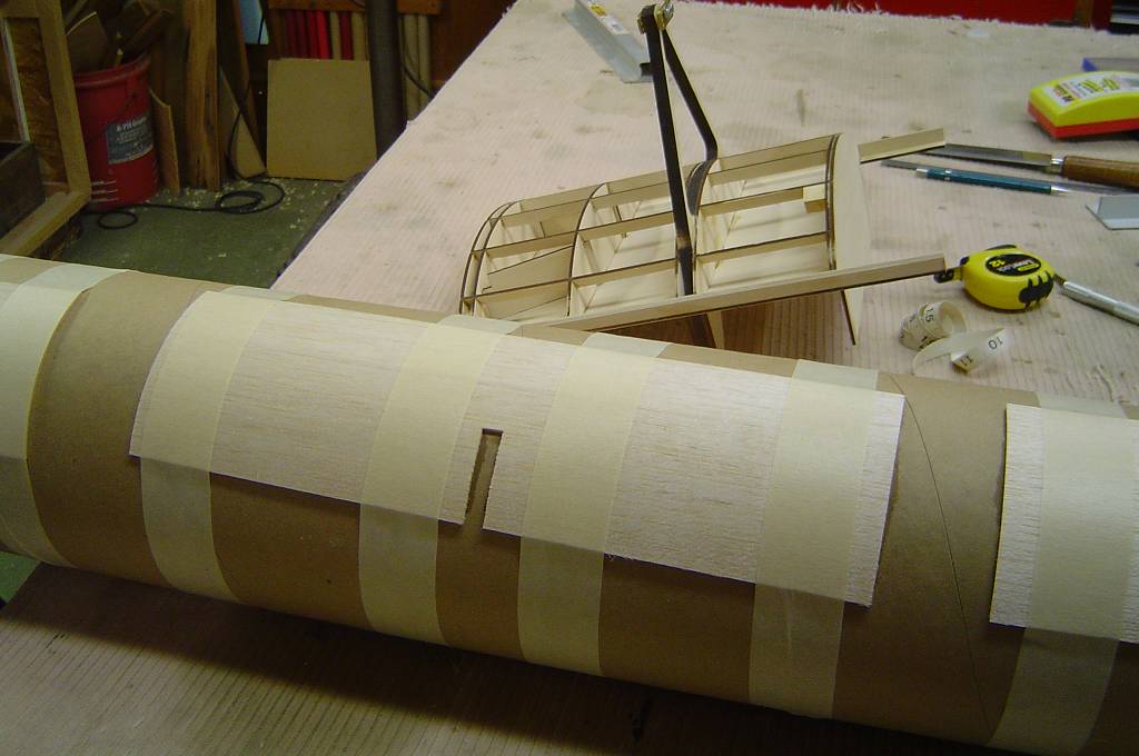

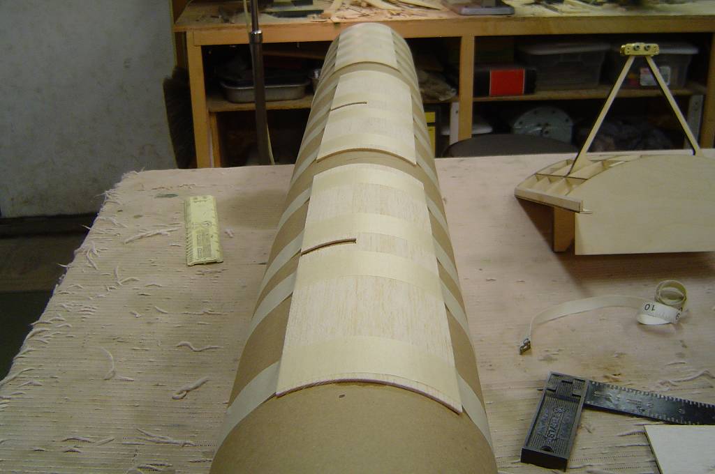

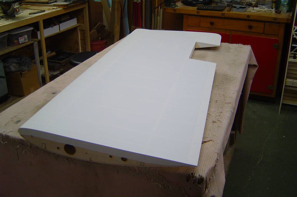

I have started the covering process on the wings.
This is one large model airplane! Each wing panel will take a 2 meter roll of Solartex on the bottom and the top......that is 2 rolls per wing panel.
I ripped a 2 inch wide strip from the roll and cut off about 12 inches from the end of each roll - the rest was used to cover the wing! Most of the 12 inch cut offs will be used on the ailerons........so really all that is left is the 2 inch by 2 meters long strip!
For reference I have shown what was left over after I covered the stab, fin, elevators and rudder.......about 25 inches of a 2 meter roll of Solartex.
Because of the length or the fuselage, it looks like it will take most of two mores rolls.......that's 7 rolls for the entire plane.
Like I mentioned earlier in the thread - this is a BIG model!

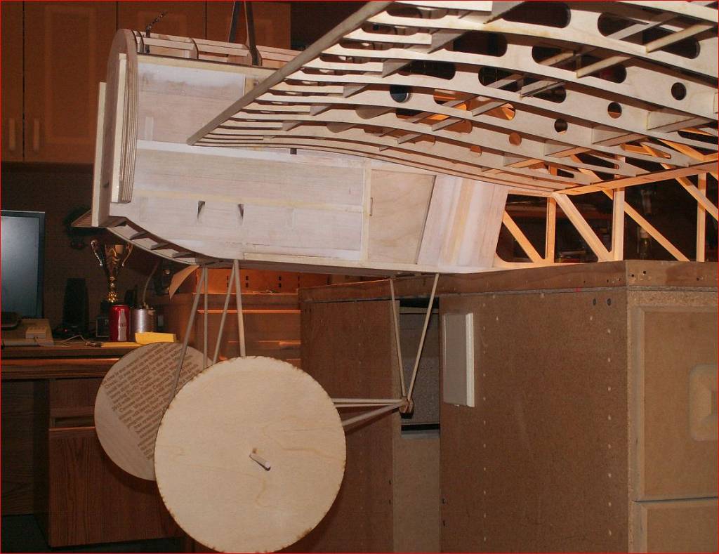

Lee, thanks for the pictures and video. Work kept me away Saturday and then the rain crept in early Sunday morning. I did get a flight on Cutter's big Sopwith Pup on Saturday evening just before dark. Thanks Jeff, that was a treat! I also got my N-11 put together and fired up - got the cobwebs blown out of the pipes and managed to put in a 15 or so minute flight just before the rain settled in for the day.
I STILL DIDN'T GET A CHANCE TO FLY PAUL'S EINDECKER [:@][:'(] maybe next time Paul.

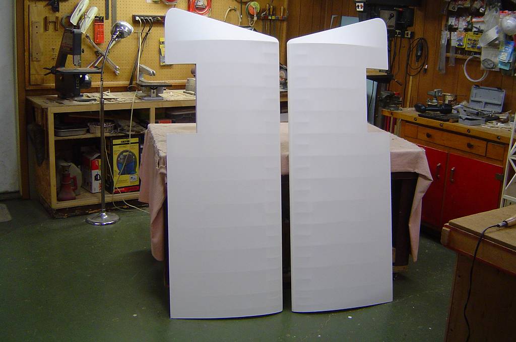

I now have two wings covered.....next up are the ailerons.

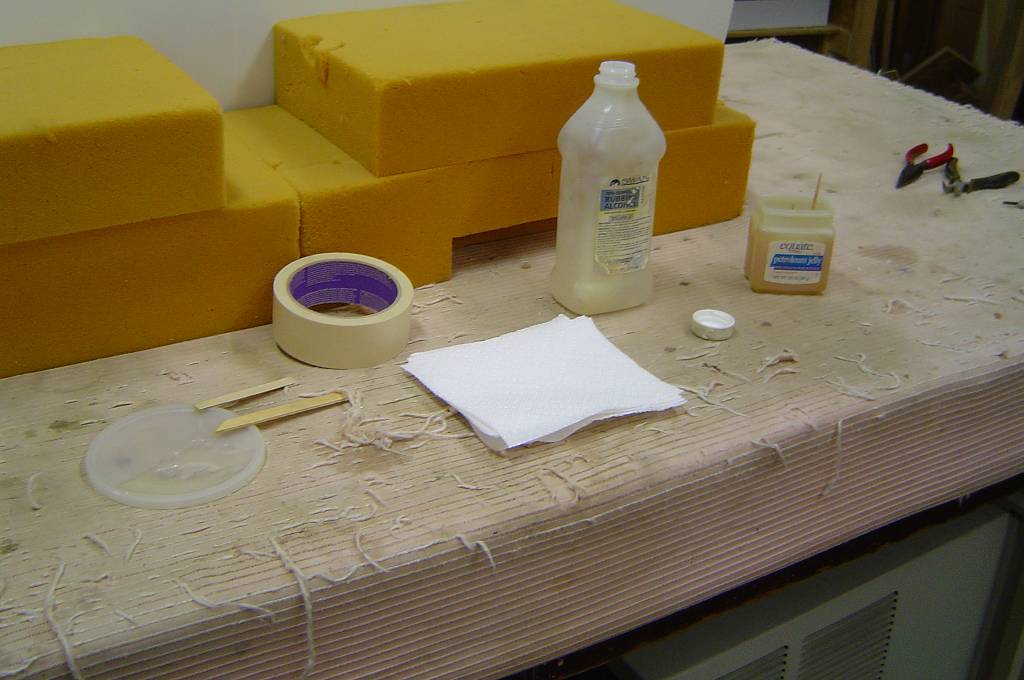

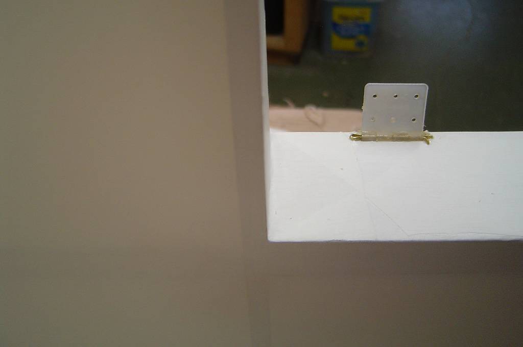

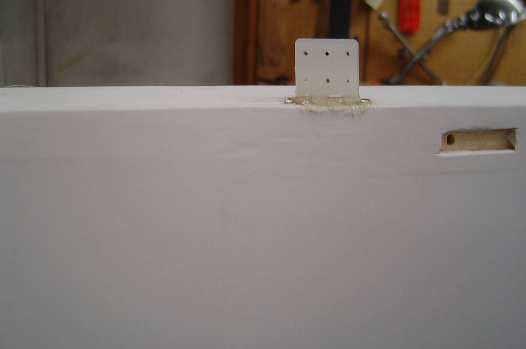

Turtle Report:

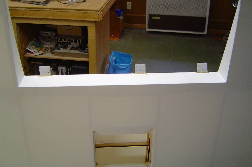

Ailerons are covered. Now comes the hinging[&:][:@][:'(][:'(][:'(] I HATE THIS PART !
Hinging is a process........Vaseline on the hinge joints, then epoxy into the wing trailing edge........then pick out all the oozing epoxy after it sets but before it get too hard to remove........then more Vaseline on the hinge joints, you really can't get too much - just make sure you don't get it on the hinge itself....... butter the hinges with epoxy, fill the slots in the ailerons, slide it onto the hinges and tape upright.......make sure the control surface is aligned properly, then hold or tape into place......again, before the epoxy completely hardens, pick out all that has oozed out of the hinge slots. Since Vaseline was used this process is not too difficult.
Note: as you are placing the parts together, have paper towels and plenty of alcohol available so you can wipe off what oozes onto the covering before it hardens
One down, one to go.......
I have about 2 1/2 inches of travel down and 3 inches of up.......I will use most of the up travel and only about a third of the down travel.

What do you do when you need to sheet a curved surface......?
"for what it's worth" I cut and fit the balsa sheet, then wet it down with water......when it softens, I form it against a round object (in this case a large cardboard tube) and tape it into place.......in the morning, or when it's dry, I will remove it from the form and then glue it to the hatch.

Old 05-19-2013 | 04:15 AM
  #416
R/C Art's Avatar
My Feedback: (38)
Posts: 2,043
From: Shelbyville, IN
Default RE: Eindecker EIII
The balsa sheet dried overnight so I lathered up the hatch and laid the 3 sheets into place.
When this dries I will sand down the front and sides and make the cut out for the pilot's station.
ID:	1883115   Click image for larger version
ID:	1883116   Click image for larger version

How about an update on the Eindecker EIII version 2.0.
It has been coming along but with a business to run time is usually in short supply. I have found a local metal shop where I am having the landing gear made and the alum. pot cut up for the cowl.
I have made a dowel rod mockup and a framing jig for him to make the landing gear fabrication as easy as possible. The gear is going to be made from 1/4" and 3/16" steel and "TIG" welded together. This shop has all of the metal working tools that you could imagine.
When the kits are available the landing gear will be assembled and ready to bolt on out of the box.
There is a plate across the gear that is screwed into the maple mounting block. This plate is welded to the gear which will add to the rigidity.
Two copies of the landing gear will be made by the end of the week along with two cowls.
I have the engine mounted and I am starting to work on the control linkages and by next weekend I want to be covering. It may be flying by the Mint Julep but it will still need some ginger bread added later.
Larry

Old 05-19-2013 | 11:40 AM
  #420
Posts: 101
From: Pickerington, OH,
A couple of more photos.
Larry
ID:	1883228   Click image for larger version
Old 05-19-2013 | 01:20 PM
  #421
Posts: 101
Worked out where the attachment point works so the lower wing wires clear the 9.33" wheels.
Larry
ID:	1883277   Click image for larger version
ID:	1883278   Click image for larger version
ID:	1883279   Click image for larger version
Old 05-19-2013 | 03:25 PM
  #422
R/C Art's Avatar
My Feedback: (38)
Posts: 2,043
WOW ! With that new wing and the landing gear mock-up, Now this is an EINDECKER!
I got the hatch cleaned up some. Next is to figure out the engine mounting/choke/throttle set up.
ID:	1883380   Click image for larger version
