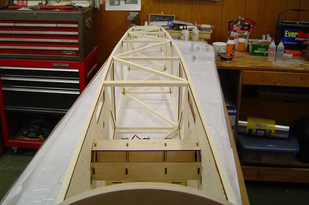

I think this will give "Windows" a whole new meaning!
Larry has designed a series of building jigs to keep the rear fuse aligned when cutting in the cross pieces.
The jigs are slid over the fuse and located as marked on the plans and pinned in place - it makes fitting the cross pieces more precise and makes gluing them in very easy.......and all the while keeping the fuse straight and without twists. yah, I liked that, too!
Kudos to Larry [8D]

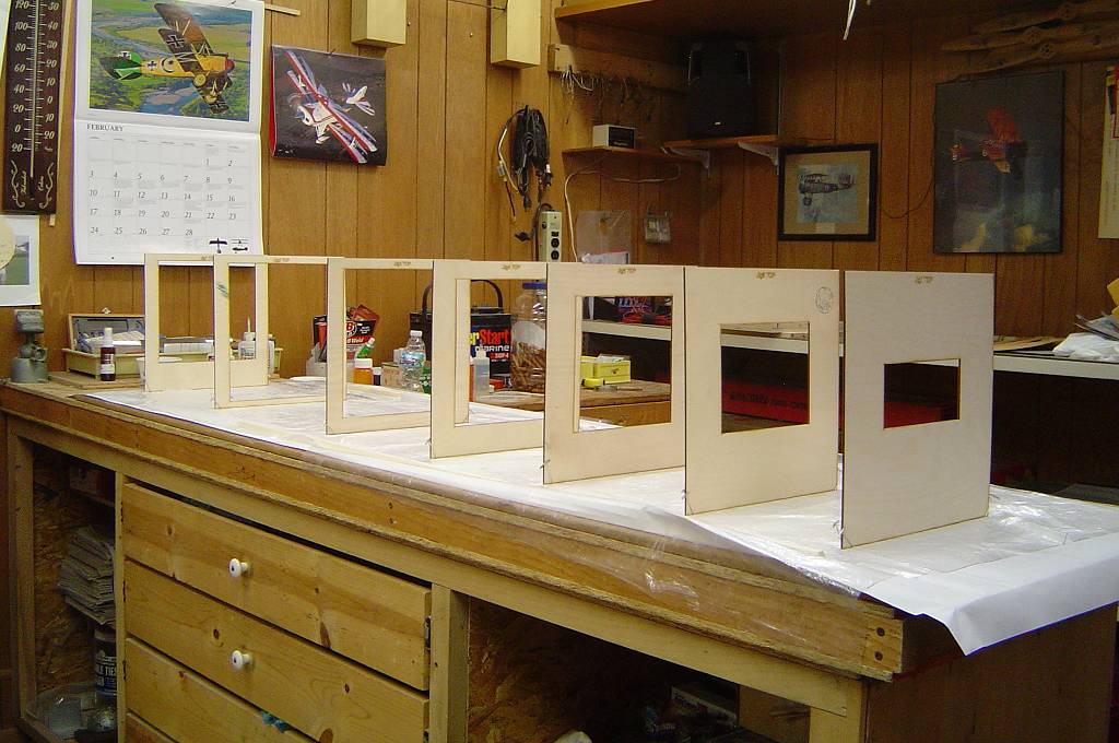

I think another look at the ingenious series of fuselage jigs that Larry designed for this kit is in order. I have located them on the plans in their respective locations. The windows, if you will, represent the cross section of the fuselage at each location - sheer genious!
The fuselage is now straight and the stab is almost perfectly aligned with the wing tube. A difficult task made easy. I have been envolved in this hobby since 1975 and this is the most foolproof system of joining the tail together and cutting in cross pieces that I have experienced.
Oh, just in case you haven't been paying attention - this is a 1/3 scale model - yah, I'm liking this a lot!

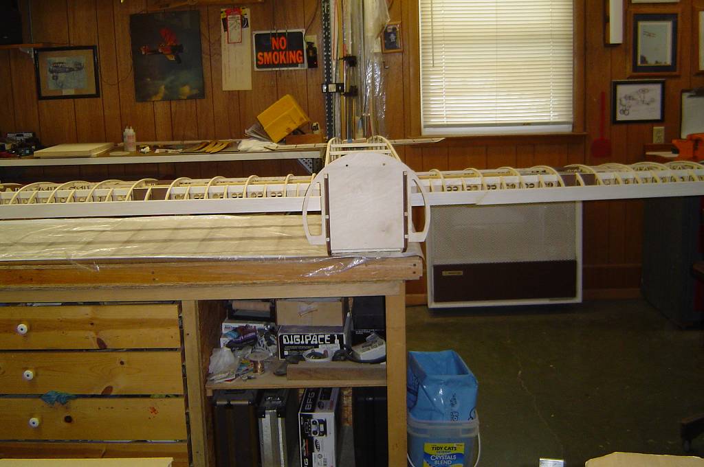

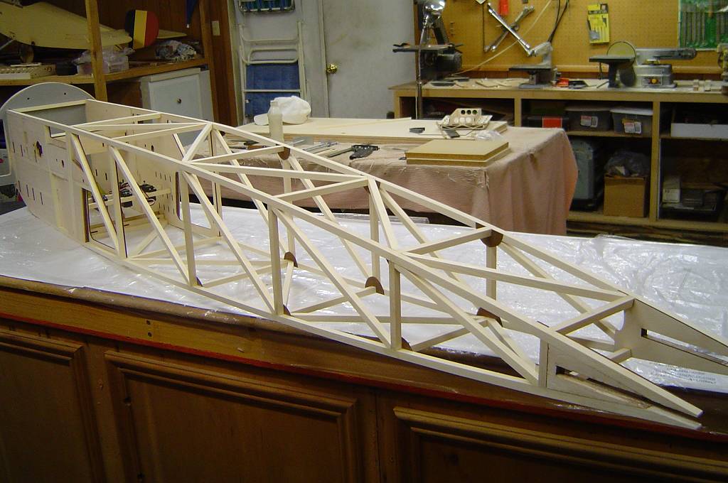

I have added the diagonals to the top and bottom of the fuse.
Also I am trying figure out the hatch - there seems to be some L's I don't know what to do with.......

Art. Could they be offcuts from ather pieces (waste?)
EDIT... I gotta tell you that the jig pieces for the rear of the fuselage are brilliant. I can see working that into a future build.

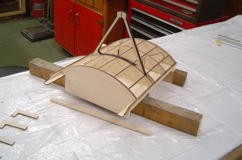

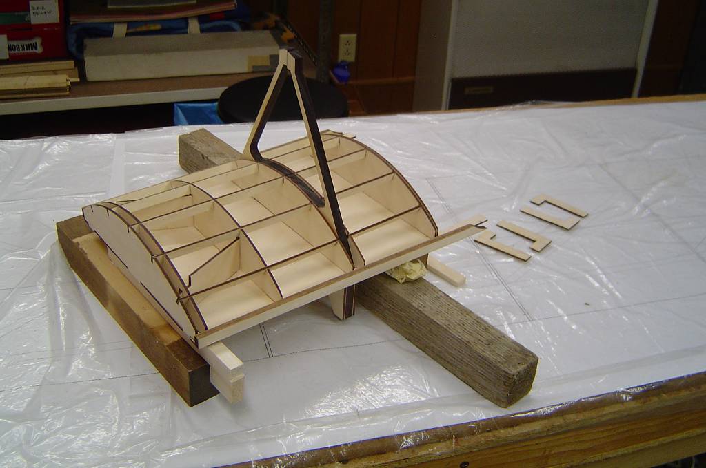

Art,
The "L" pieces go inside against the fuselage for the king post to rest against.
Larry

Art,
Did you do that little trick we talked about when adding the top cross piece where the angle starts
to tamper to the rear?
Your fuselage looks like it has less bow in the top longeron than mine did.
