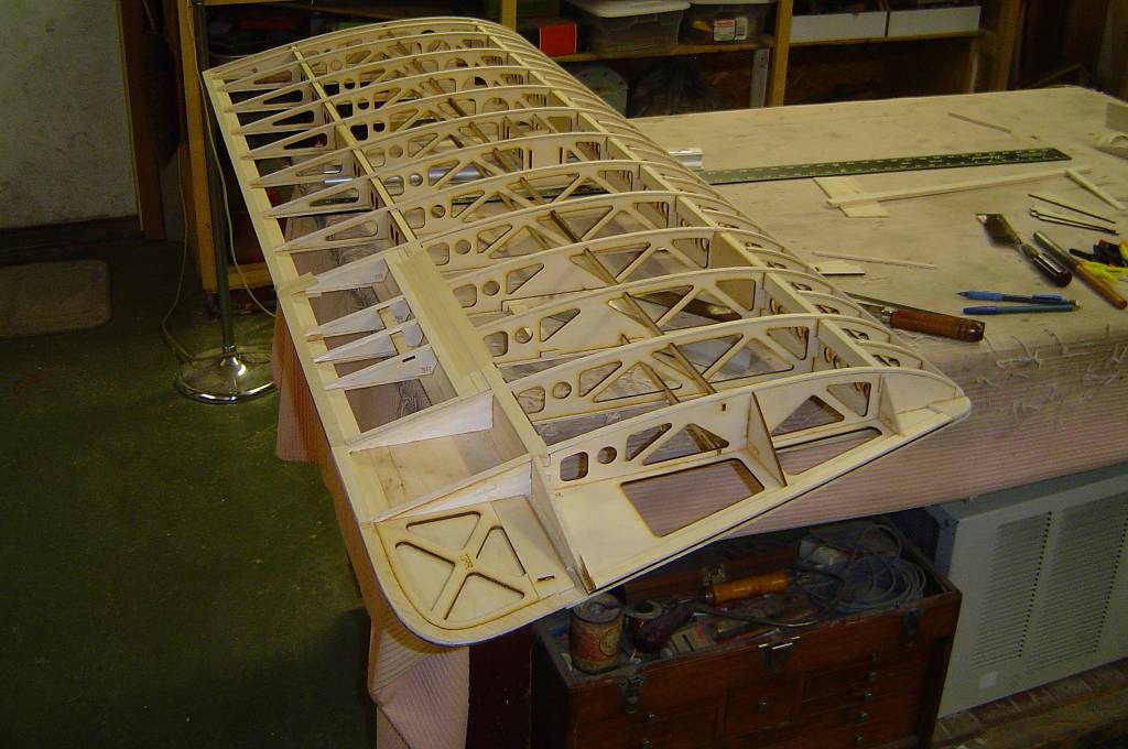

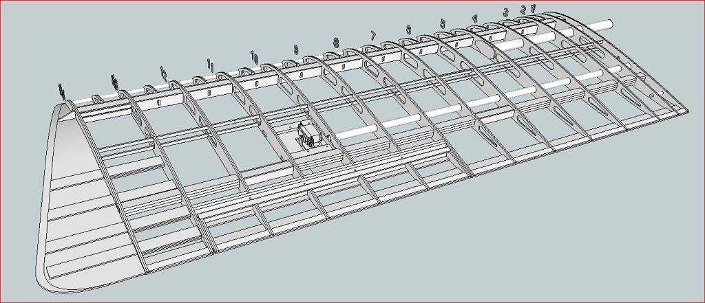

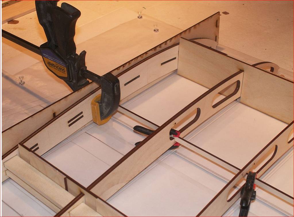

Eindecker Design Update
My original thought with this design was to use a flat bottom wing with a 1 1/2" wing-tube.
This works fine but I had wanted the wing wires to be non functional. Without any sheeting on the wing there is just to much twist without functional wing wires.
Also the wing tips are not strong enough when a cross wind picks up one side and drives the other tip along the ground.
So a redesign has been done.
1. The new wing is the same overall size.
2. The airfoil has been changed to an under cambered airfoil.
3. 1" wing tube for ease of assembly.
4, Ailerons moved inboard one bay, 5 bays wide and 4" deep instead of 6" deep.
5. One piece wing tip braced back into the wing two ribs.
6. Wing wires are required.
I have completed the drawings for these changes and I have cut the left wing panel.
The new wing build begins today.
Larry

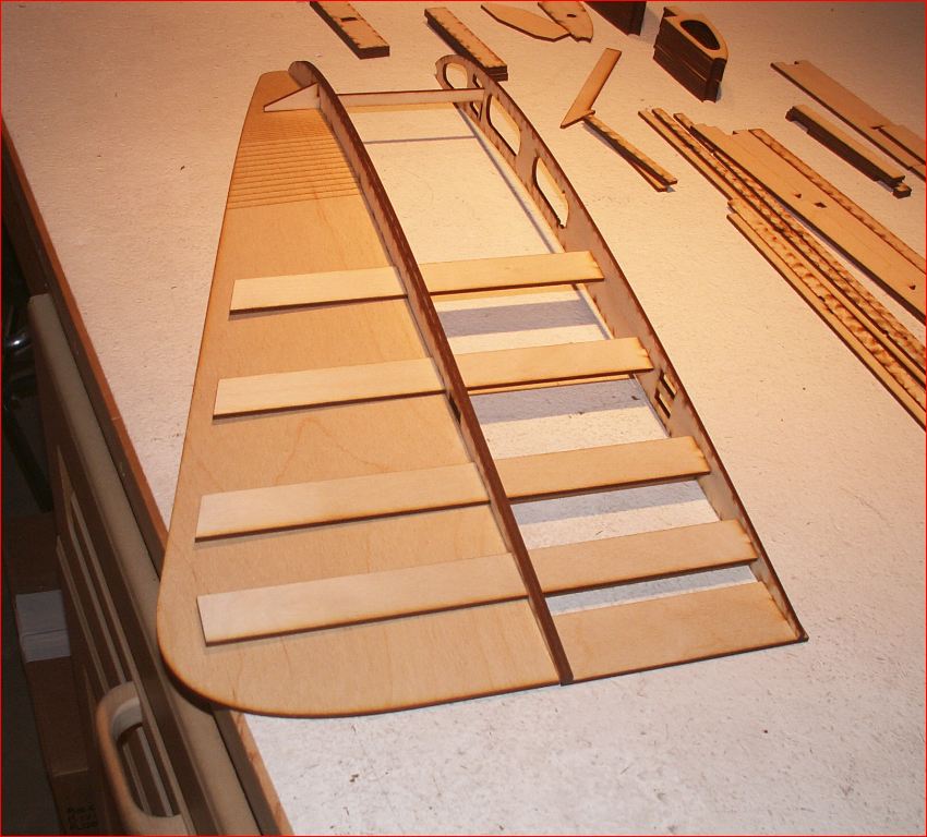

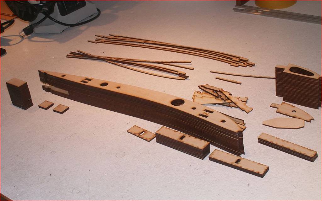

Here is the new wing tip dry fitted together. The tip is one piece 1/8" Baltic Birch and I score the front where it curves the most with the laser.
There are tabs that slot into the double tip rib. The brace pieces in the rear are 1" wide Baltic Birch glued on the top and bottom of the tip that are tied back into rib 13.
Larry

Turtle Report

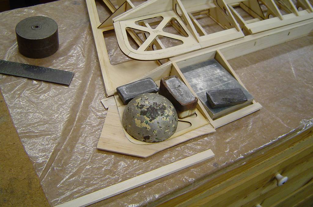

The second wing tip has been fitted and glued up. The aileron has been cut down to size. After the glue dries on the tip I can clean up the edges and fit the re-sized aileron.
I did some more measuring and I calculate the new aileron area is approximately 6% of the total wing area. I don't think this will be noticeably different in roll response than what Paul's plane is....his aileron area is about 33% greater than mine and looks to be 8% or so.
It will be fun to compare the two planes and make in the field evaluations of each one and then compare them to Larry's version.
They all will exhibit adequate roll control and be much snappier than a wing warp system would.
(waiting on glue to dry)
Art

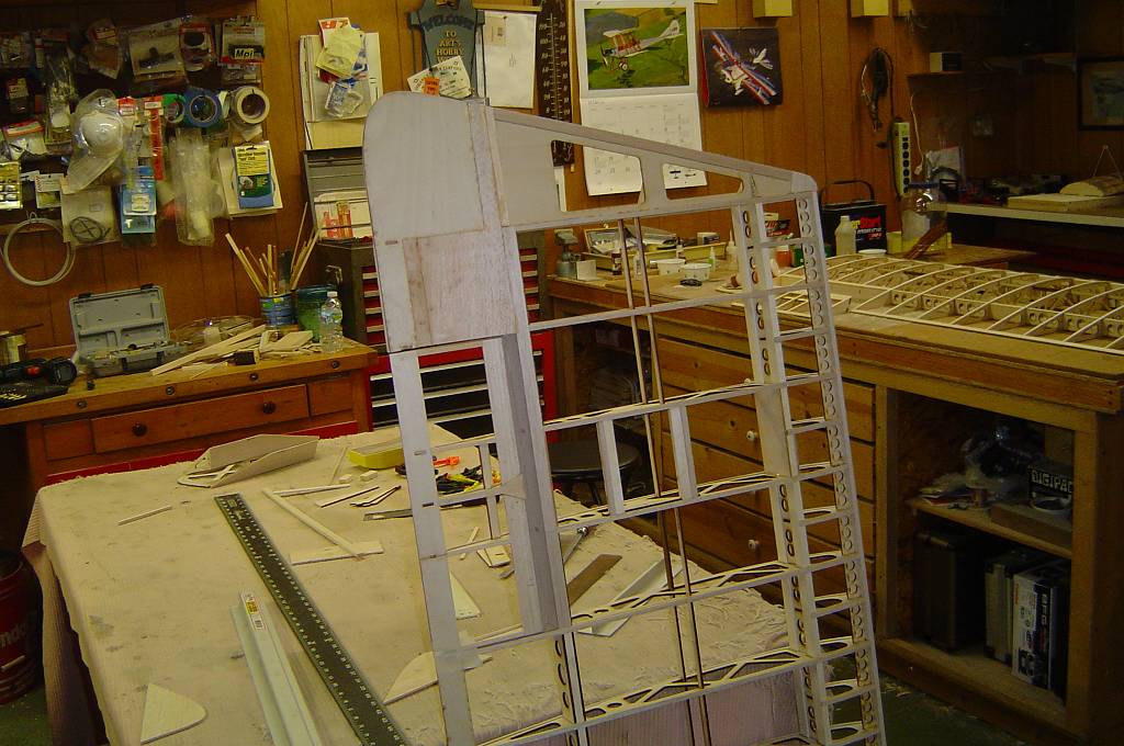

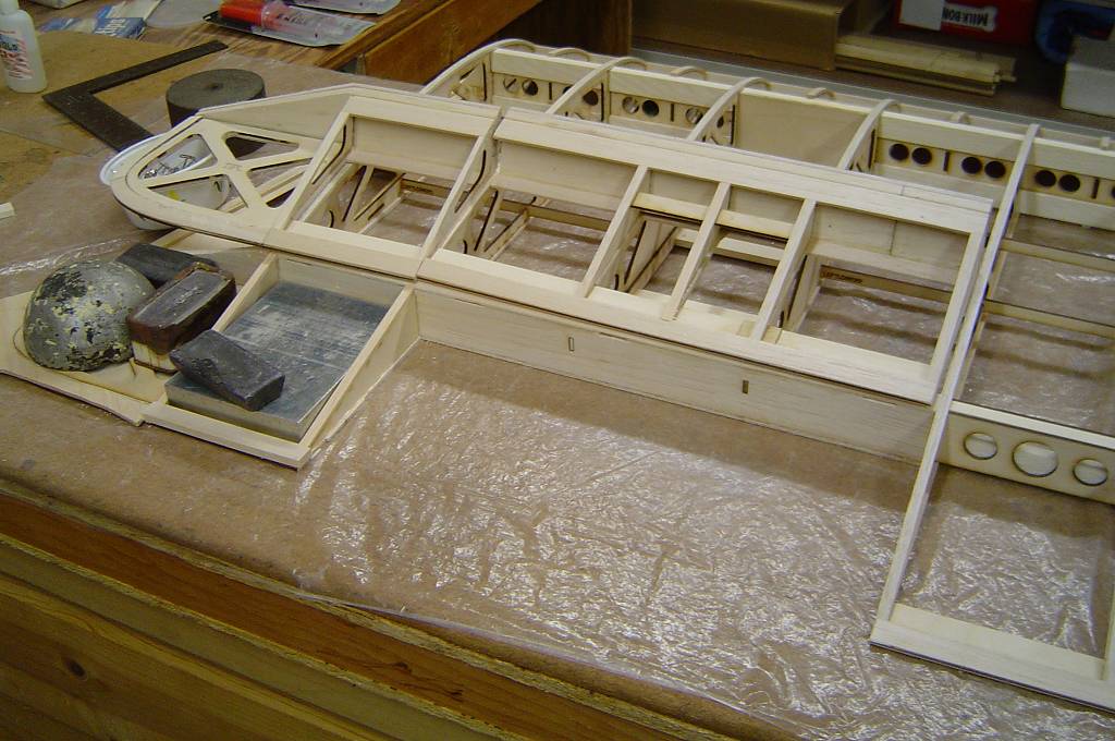

Got the second aileron end rib glued in - tomorrow, after the glues dries I will put the cap strips on.
The wing looks much nicer at the tip with a one piece wing tip and recessed aileron.

Here is the new wing all laid out. I have made jigs for the rib placement and end pieces to keep things aligned.
At this point everything is locked into place with no glue.
I plan on using the small bottle pictured with wood glue to glue things together. I get these bottles at my local wood worker supply store.
I am doing it this way since all of the ribs slide onto the 1/4"x3/4" spars and it would be impossible to glue pieces in place as you build and keep things straight.
Larry

Nicely done! This is making me want the new version wing........do you think you might be putting out an ARC version of the new modification?
(or in case that wasn't a strong enough hint - when will you get mine built?) hahahahaahhah
Are you telling me that the little squirt bottle is what you will use to apply all the glue? Does it work very well?

Art,
The little bottle didn't work. The glue was just too thick.
I ended up using little sticks and q-tips to spread the glue around.
Remember this is my third set of wings, Paul's wings, a just built completed set with the flat bottom wing and these.
No more Eindecker wing building for me.
I need to get my plane finished for Mint Julep!
I got most of the left wing glued together tonight and I should finish it off tomorrow evening.
I would like to have the right panel and a new stab finished by Sunday evening.
I also have made some revisions to the stab with a 3/8"x3/8" stock leading edge.
For production kits I am going to use the strut like Paul added to his stab and have that tied back into the struts for the tail skid.
Larry

Larry,
Barry and I use that little bottle all the time!
The trick is to thin the glue alittle with some H2O and it will work like a champ!
HPA

Turtle Report
I haven't got a lot accomplished this past week as I have been under the weather and going to work was about all I could get done......gotta keep the paycheck coming.
Starting to work on the elevators......... I traced the outline of the original elevators onto 1/8 balsa sheet.......found some 3/8" balsa sticks......the outline will be double pieces and the ribs will be single pieces.......then the top sheet will go on.
I will cut the control horns from 1/8" a/c ply and add them after the elevators are covered.
Ohio State is about to tip off and IU is coming up at 2:45 - so I won't get much done today either [8D]
