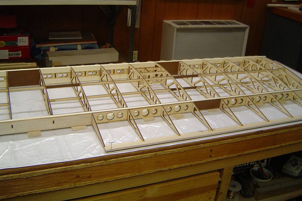

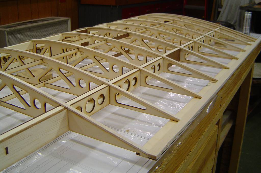

I have made a little progress this Christmas Day.
ID:	1833821   Click image for larger version

Very precise-looking construction! One thing I'm wondering about though is the idea of having lightening hole on the sheer webs. Doesn't that sort of defeat the purpose of them? But then maybe not. Maybe what's still there does the job.
It would interesting to test this and find out if there is a difference. I've always used shear webs, but have never put lightening holes in them.

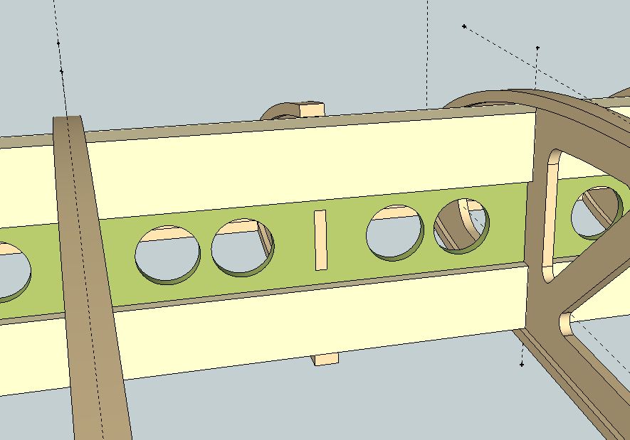

To answer the question about the shear webs.
The material that I have used is 1/8" Baltic Birch Ply.
To save weight I have added the lightning holes. If I was using balsa and needing to depend on the grain in the wood I would not use lighting holes.
The front webs are between the spars and in essence creates a beam structure. This is not unlike a beam used in building construction. The half ribs are actually notched into the webs.
The rear webs are on both sides if the spars and creates a box beam. Most of the hole area is in the open space between the spars and there is still quite a bit of surface gluing area.
The use of this material is also substantially less expensive than using balsa and I believe stronger in the end.
Larry

Since the webs are made of ply there's really no doubt about the strength. Thanks for clearing that up. (Is ply really cheaper than balsa?)

Since I am looking at this as a kit to sell I have been looking hard at all material costs.
My laser has a 12"x24" bed size so I am limited to the 24" length.
I get the 1/8" Baltic Birch from a local woodworker supply store in a 5'x5' sheet.
They cut it down to 12"x24" at no charge so a 12"x24" piece costs me $1.60 total.
A 4"x24" of 1/8" balsa sheet costs $1.57 plus shipping from National Balsa
$1.57 x 3 = $4.71 plus shipping for that same 12"x24" area. []
The wings and tail group alone take 20 12"x24" pieces.
I think that this material really only works in aircraft kits of 1/3 scale and larger due to the weight but I am reducing that weight gain by
being able to have so many lightning holes, due to the stronger material.
And it is easy to cut lightning holes with the laser. Think of all of the dies it would take to do the same.
Larry

Thought that I would post an update.
While Art has been building the production prototype I have been trying to stay one step ahead of him building the developmental prototype.
I got the parts cut for the fuselage and have been able to frame up both sides. Still need to put in the cross pieces and some other parts but you can see
how things are starting to shape up. The length is about 84" and the out to out is 9". The firewall is 14" in diameter.
I will be sending Art all of these parts by the end of the week since I am sure everything is going together as intended.
I also made a decision on the cowl front to back dimension of 7 1/2".
This is about 2" bigger than scale but you can see in the photo below the G62 engine and muffler setup I am going to use on mine will fit in the 7 1/2".
It will be easy enough to cut the back side of the cowl off for other engine setups that are not as deep.
The cowl will also have a cowl ring that will actually set on the fuselage sides that protrude thru the firewall.
It is the red shape in the photo.
The elevator servos will be mounted on the sidewall behind the pilot's seat. The center-line of the servo is the center-line of the
stab so the pull-pull will be a straight shot. The rudder servo on rails in the middle.
The drawings show only a one-sided servo arm but they will be full size.
Larry

.....and while I'm waiting on my fuselage parts I have been putzing around with the capstrips.
I am using a combination of carpenters glue and thick CA. On the straight runs wood glue and various clamps are used and then at the front of the rib, CA and kicker to hold the curve. And a soaking in a glass of water for the cap strips to help them bend.
