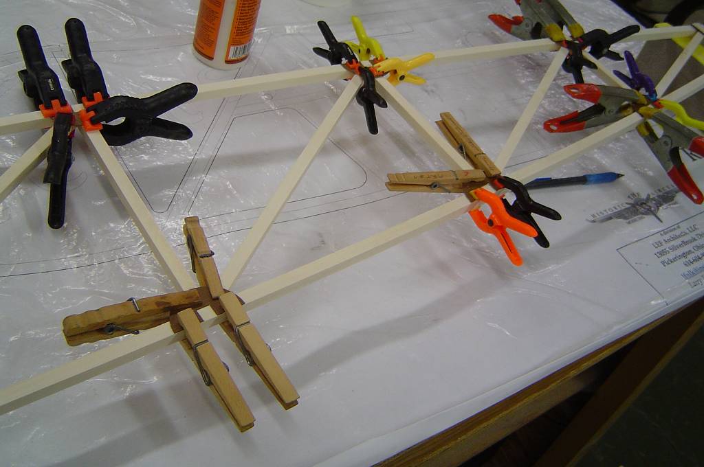

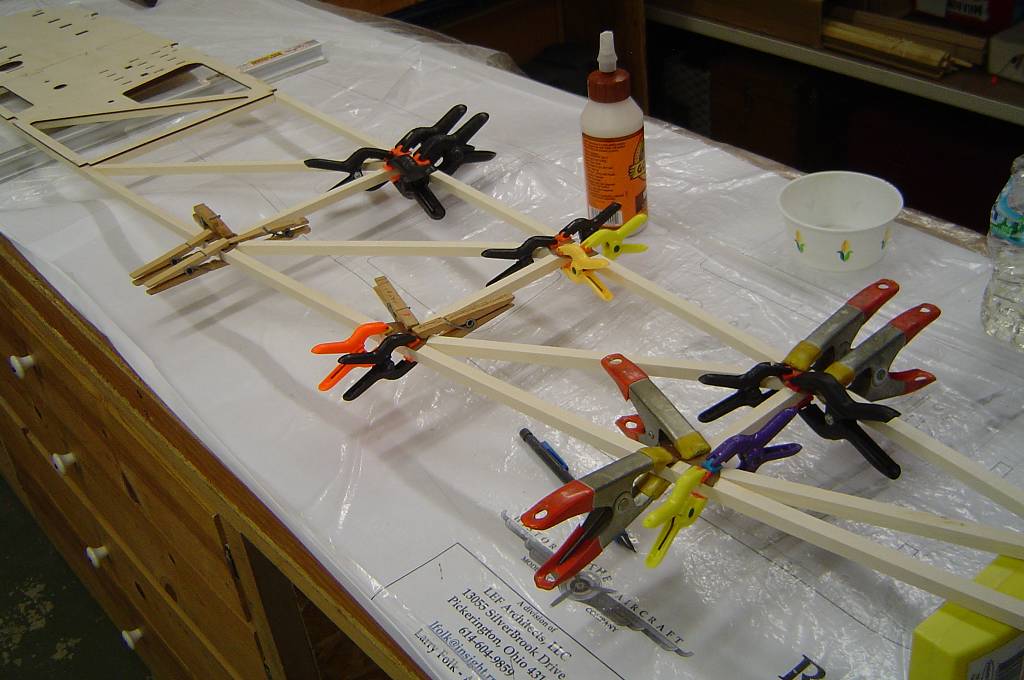

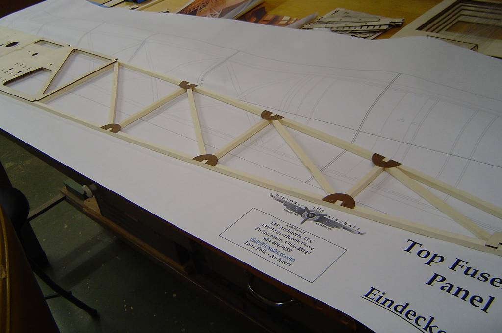

Default RE: Eindecker EIII
I 've rough sanded the fuselage sides and installed the gussetts which support the various stick wood joints.
One side is done and the other side is drying.......the Gorilla Glue tacks pretty quickly when clamped........10 minutes or so and the gussett isn't going anywhere!
The next step is the one which always frightens me! Joining the fuselage sides together - I've got to make sure EXACTLY where the firewall goes - that sets the initial alignment and controls controls how well the fuse does or does not join together. The jigs which are provided by the designer will help greatly when each cross piece is added......it is rather ingenious........kudos to Larry for providing them.

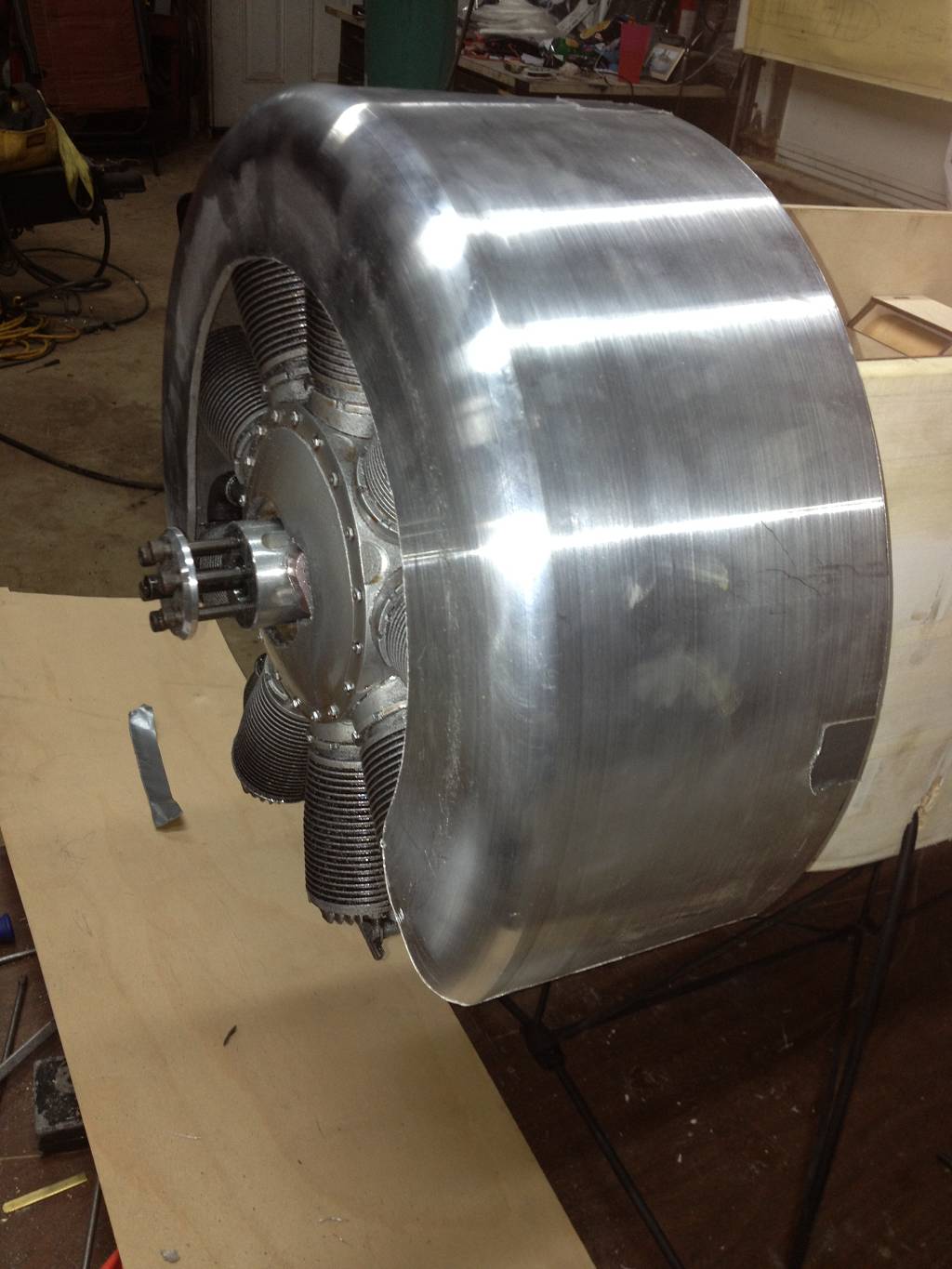

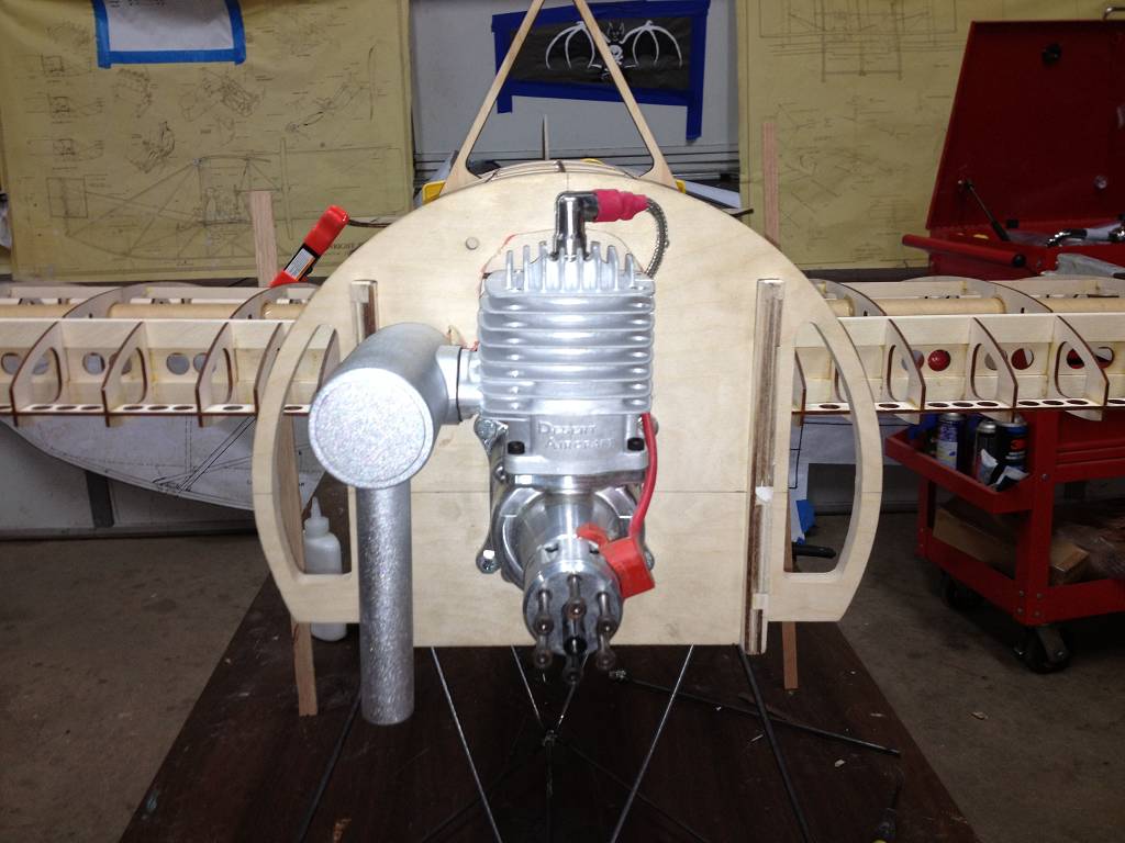

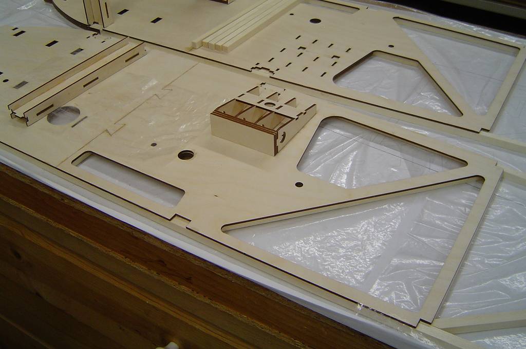

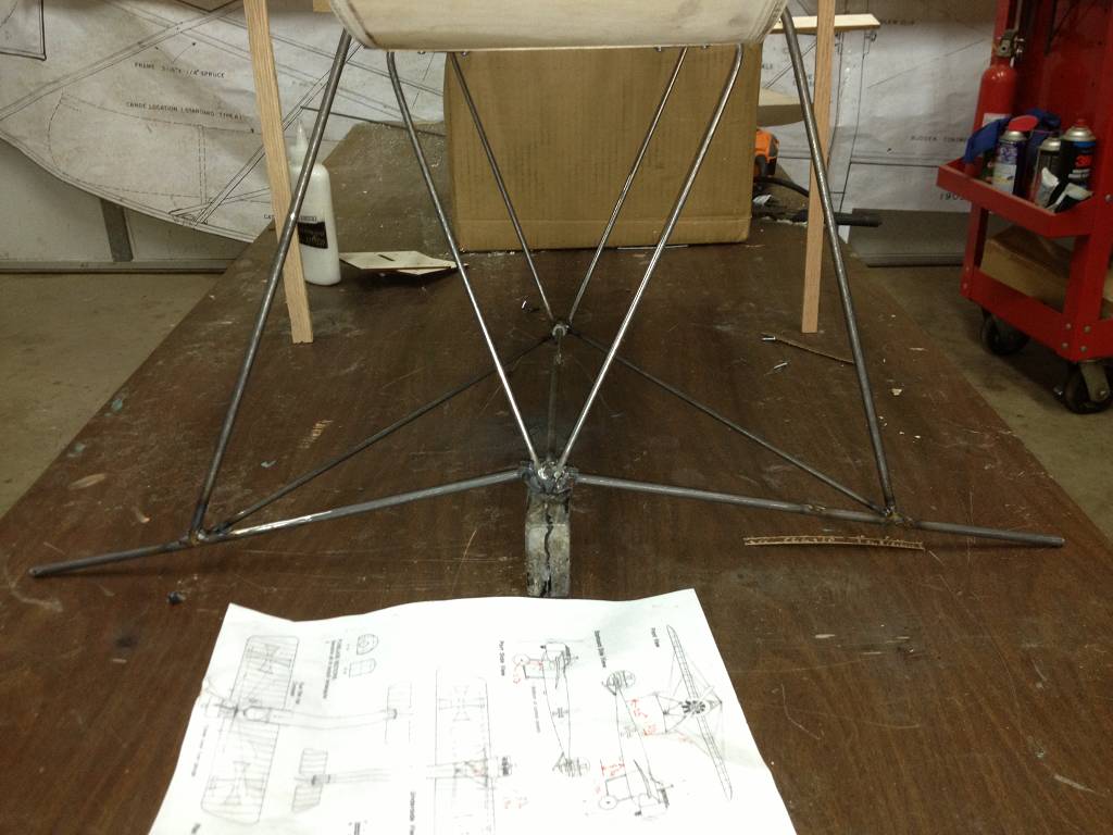

What do you think about this landing gear?
I know its rough looking...all that can be cleaned up.
Each side pivots on the center rod and the uprights go into the fuse to a bungee system.
I could not for the life of me get that darn reduction drive to fit this fire wall!
so the DA85 will have to do!

Old 01-29-2013 | 06:19 PM
  #134
R/C Art's Avatar
My Feedback: (38)
Posts: 2,043
From: Shelbyville, IN

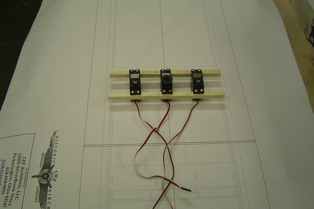

Paul, looks like you are making good progress.......it will be interesting to see how the suspension works out in the field. I know you will give it a good work out when you get her flying! haahahhah!
I am a little bit envious - that small router looks to be a great time saver.

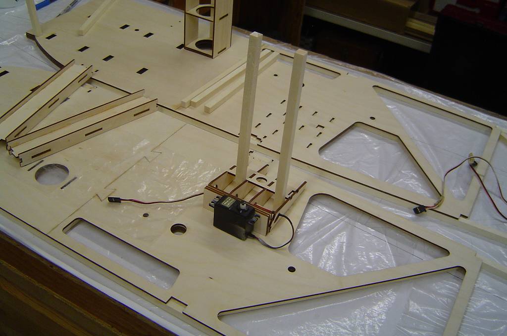

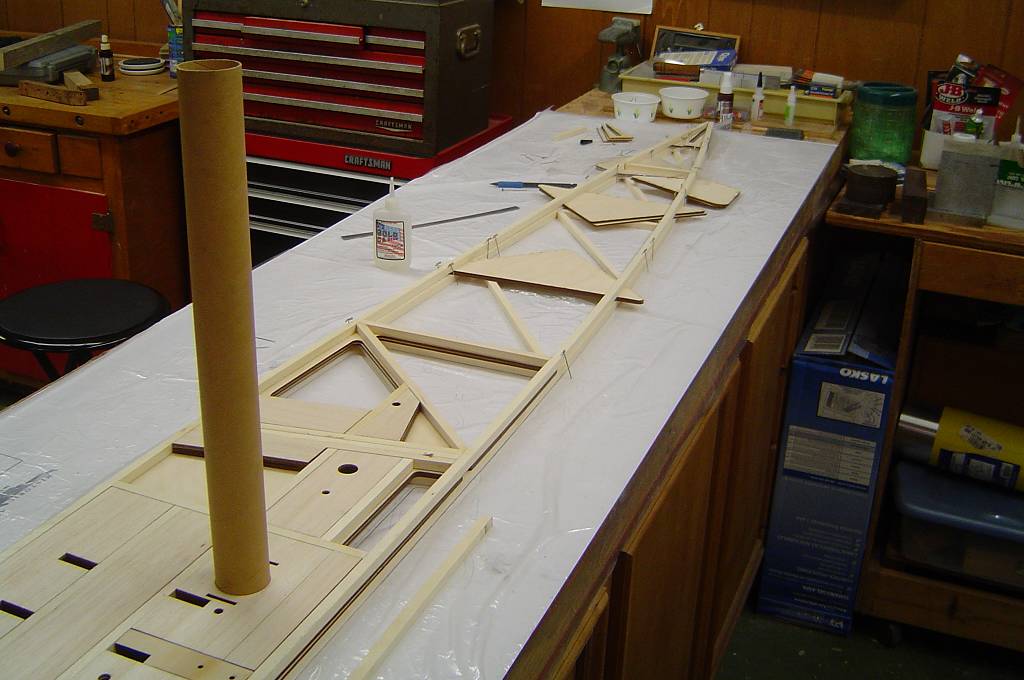

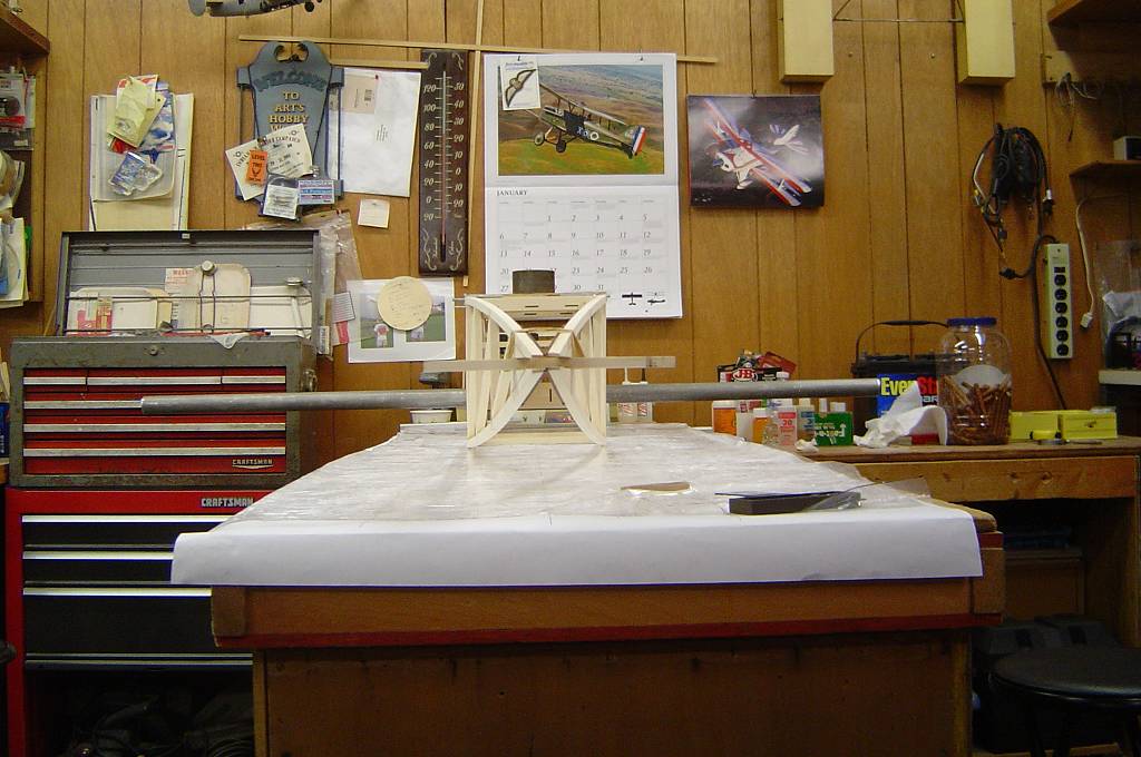

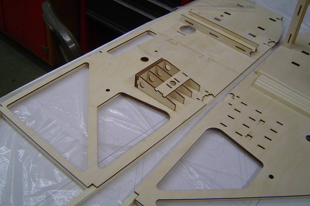

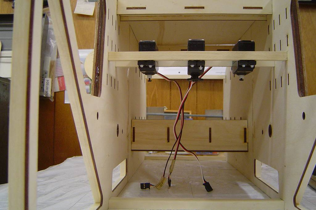

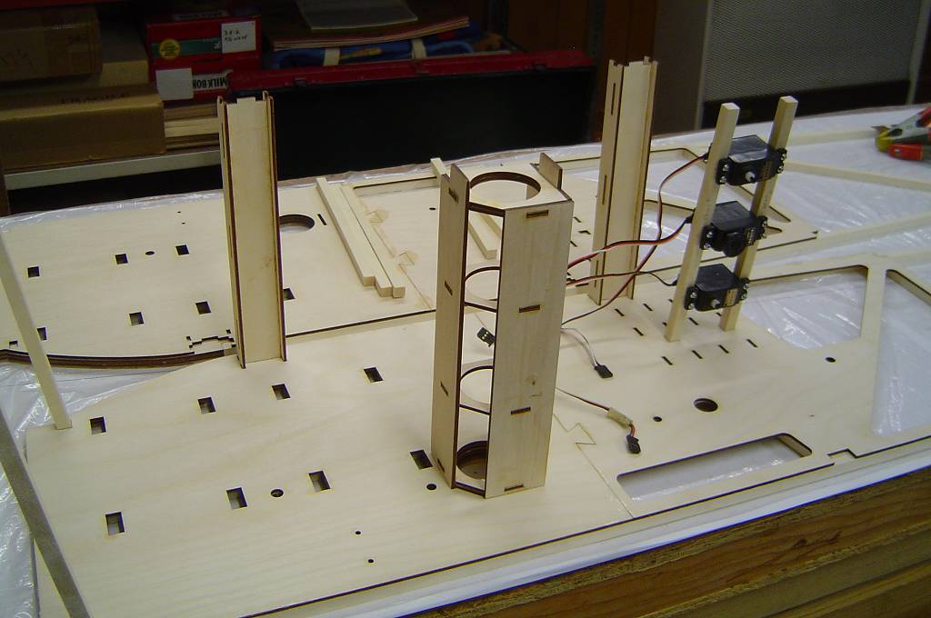

I have been working a bit on my build. I think what was slowing me down was deciding which servos to use.......I have a couple of sets of different sizes and well, to make a long story short.........I'll show you what I ended up with.
Also, there were some sub-assemblies which needed to be made before the fuse sides could be joined......
The first pictures show the designer's servo mount set up........, followed by my modification. It seems no matter how well thought out a servo mounting system is - SOMEONE (that would be me in this case) wants to change it all around. It is stricly a personal choice. Actually, as far as the geometry is concerned, Larry's design is 100% correct and gives equal up/down elevator throws.
The next pictures show the sub assemblies, one for the wing tube and the other two for the landing gear blocks.
All these assemblies as well as the other forward fusealge cross members will be glued to one side using squares to keep them properly aligned.
Then the two fuse side will be joined together.

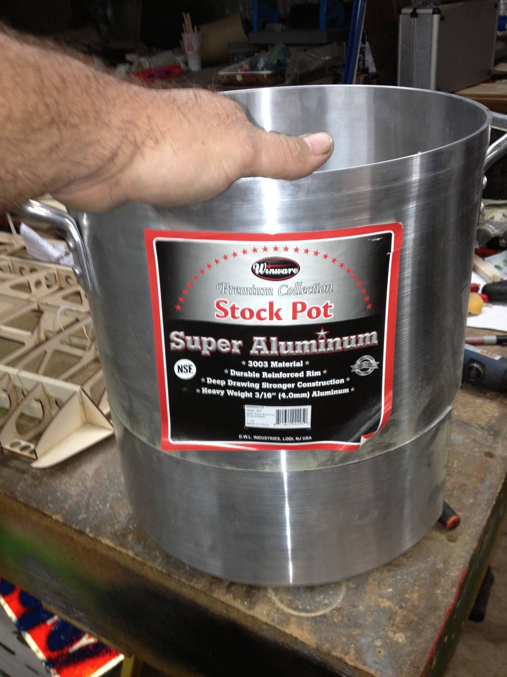

I received my pot today and 1/4 inch thick wall thickness ...WOW!
I do not think it looks bad at all........the pictures dont look as good as it does in person....
I was cuttin on that pot for a Hour! LOL!!
HPA

What's the diameter?
Old 01-30-2013 | 04:18 PM
  #139
Horsepoweraviation's Avatar
My Feedback: (50)
Joined: Jun 2004
Posts: 1,102
From: Cincinnati, OH
14 inches round by 15 inches tall
Found it on the internet for 35 dollars
HPA
Old 01-30-2013 | 06:13 PM
  #140
abufletcher's Avatar
Joined: Feb 2004
Posts: 15,019
From: Zentsuji, JAPAN
Thanks. Just curious really. They sell 36cm (just about 14") thin walled aluminum cooking pots here and I've always wondered what size model would fit.

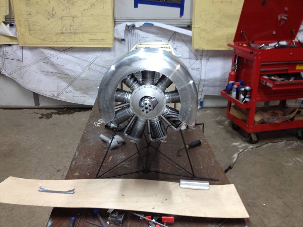

HPA-</p>
I assume your using a da twin behind the ziroli dummy engine? I coming up with the same setup for busa 1/3 pup but am concerned the dummy engine will restrict engine cooling. I do have holes drilled thru bulkhead for air to move in and out. I don't want to run a hot da.</p>
Old 02-01-2013 | 03:53 AM
  #143
My Feedback: (50)
Joined: Jun 2004
Posts: 1,102
ORIGINAL: valleyk
HPA-</p>
There is not enough room for a twin and dummy engine AND a cowl that is only 6" deep.[&o]
I am using a DA 85 sitting at the 12 o'clock position .....you can see it in one of the pics that was posted
I will post my cooling cut out later...basicly I traced the cylinder and removed all the material.......leaving no doubt of having a cool DA...
HPA

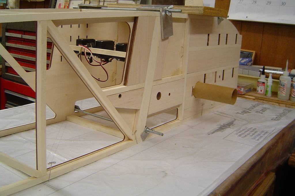

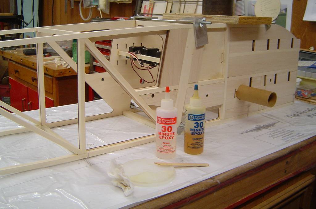

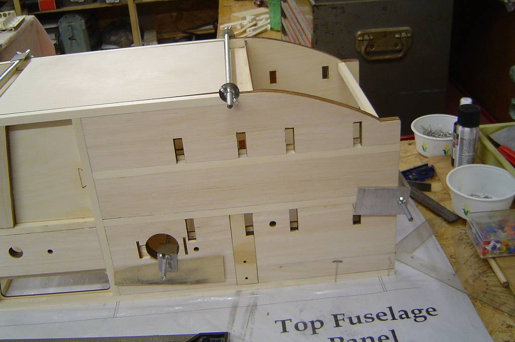

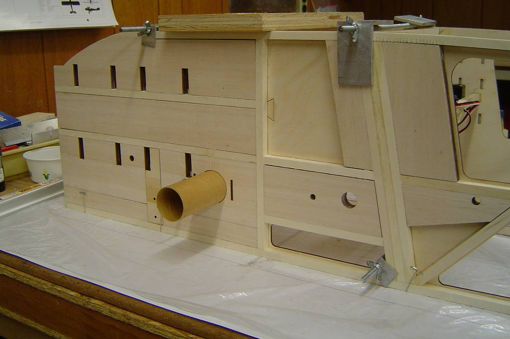

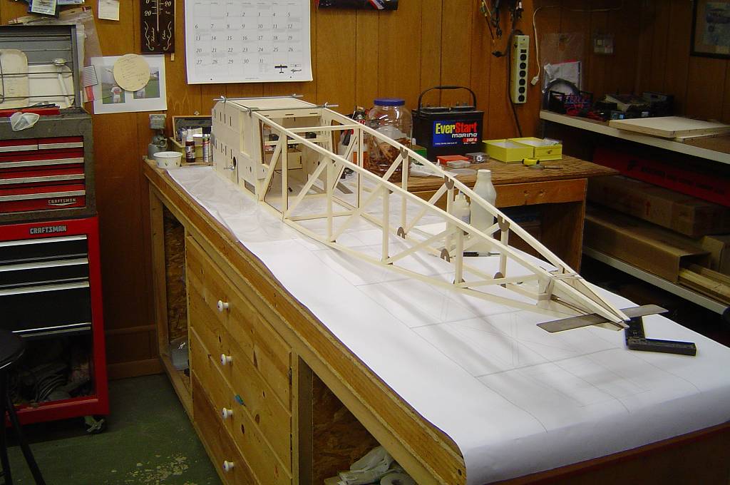

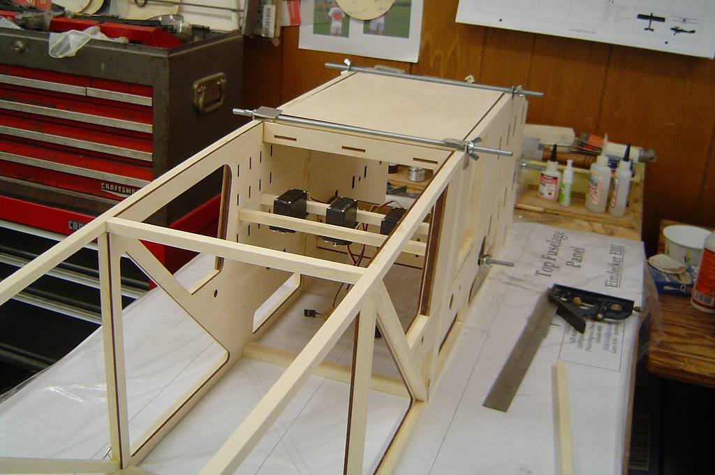

Progress is being made.......slow but sure......I think in a previous life I must have been a tortoise.
I have the wing tube frame and the landing gear block holders glued to one fuselage side. I used 5 minute epoxy for this task. The designer used wood glue on this part of his fuse build - both seem to work well, so I guess it's builder's choice here.
I have test fitted the other fuse side onto the first with all the other cross members for the forward fuse in place (nothing glued at this time). Things seem to be lining up pretty well so far.
I also pulled the tail together to see how that lined up - I might be a 32nd of an inch off as it sits......wow, just like magic (or a good design). Now if I can apply glue and put everything back in the same place..........
You might notice the all-thread clamps with angles or washers - my Dad taught me this trick many years ago. Pretty versatile.

Wow, that looks roomy enough to move into!
I like the all-thread clamps what size all-thread 1/4" ?
Old 02-03-2013 | 10:57 AM
  #148
R/C Art's Avatar
My Feedback: (38)
Posts: 2,043
Yes, they are 1/4". But the all-thread could be any size from 2-56 for small delicate assemblies up to as big as you want - but for most third scale projects that I have encountered quarter inch is sufficient. Different sizes of aluminum angle and fender washers seem to work for most of my needs.

ORIGINAL: abufletcher
Hold on there, Don - No Freeloading Allowed! [8D]
Old 02-03-2013 | 03:28 PM
  #150
R/C Art's Avatar
My Feedback: (38)
Posts: 2,043
More progress this afternoon - I now have the forward fuselage sides joined together. I used 30 minute epoxy for this task ..... and I'm glad I did,
too. It took me 25 minutes to get the epoxy spread all around, the fuse sides put together (this was done while on it's side), then turned upside
down (because the fuse top is flat from the firewall to the rear of the cockpit) then put the various pieces back into place (because some fell out
when I layed it upside down), then the ply board put on top with a steel weight (this helped square the fuselage sides to the table), then put in the
wing tube and an alignment piece in the rear fuse (this allowed me to insure the fuse was square and the wing tube was level to the stab and then
clean up all the dripping epoxy with alcohol and then finally remove the wing tube before the epoxy set up.
This sounds like a big production but it's not really difficult to do........it takes time and the epoxy allows only so much time. I made a couple of dry
runs with the procedure so I wouldn't make a mess of things. If I thought I needed more time, there is always Hobby Poxy II with a 45 minute
working time.
