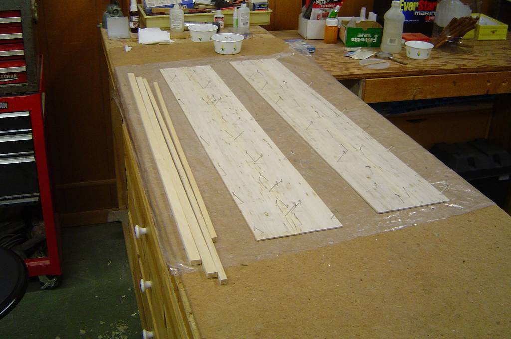

Ok, after some field testing and lots of discussion, I am replacing the original stab with a new sheeted stab.
I am using 1/8" balsa sheeting top and bottom with an inner structure of 3/8" balsa sticks.
I am using the trailing edge from the original stab - it is hardwood and will add a lot of stiiffnes and strenght to the stab. I will also back up the leading edge with another piece of hardwood stick.
I think the elevators will also be restructured in the same fashion, using only balsa wood.
The first step is to edge glue some sheet stock together.

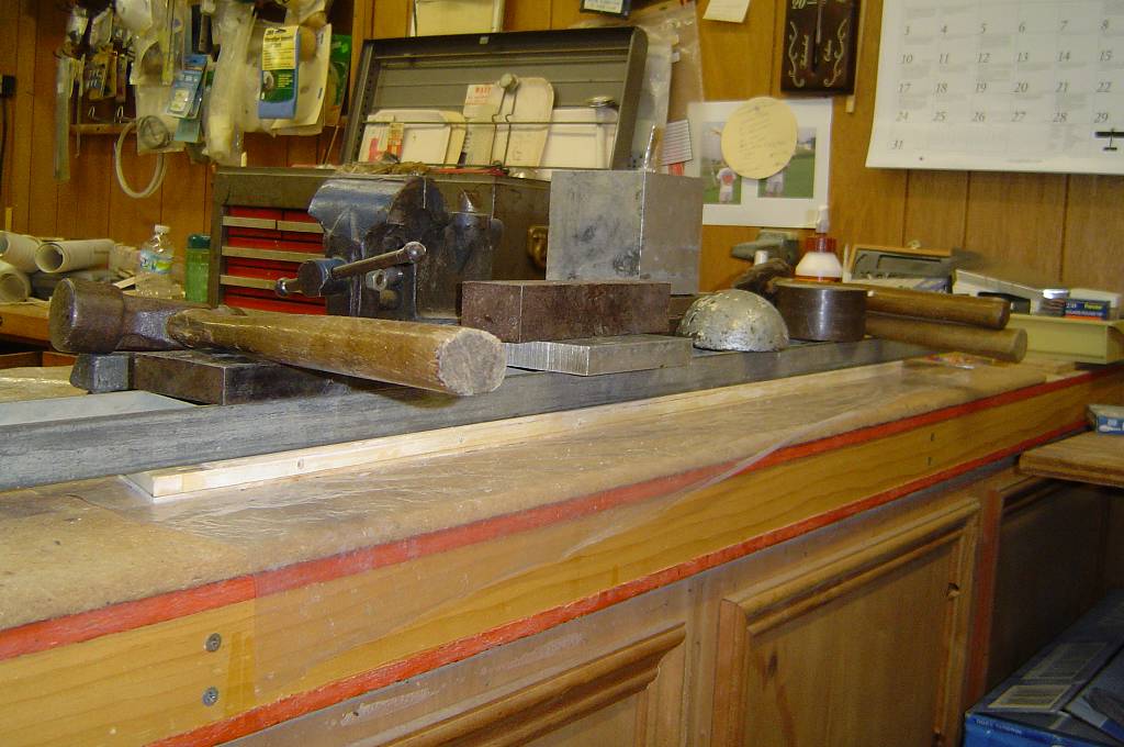

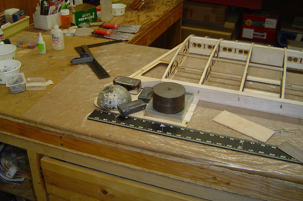

Turtle Report
I added the interior truss work to the stab and also the top sheet balsa. Then I weighted it down with all the heavy stuff I could put on [>:] ........I forgot to take a picture of the stab before the top sheet was added - so you'll just have to imagine a shot or two showing the balsa sticks arrranged in a multiple triangle type of arrangement.
I'll give it two days for the glue to dry - don't want any warping going on here [8D].

Mr Turtle are you afraid the stab will fly away on it's own accord?
Old 03-12-2013 | 05:58 PM
  #339
R/C Art's Avatar
My Feedback: (38)
Posts: 2,043
From: Shelbyville, IN
Default RE: Eindecker EIII
ORIGINAL: metaldriver
Well, yes I am......sort of. When I glued up the trailing edge to the bottom sheeting I let if set for a full day.......I came back to start adding perimeter pieces and found it in a badly warped condition. So I weighted it down and let it set for a couple more days.......fortunately, it finally dried and did so without any warps. So I am just heading off any future warp issues with this method.

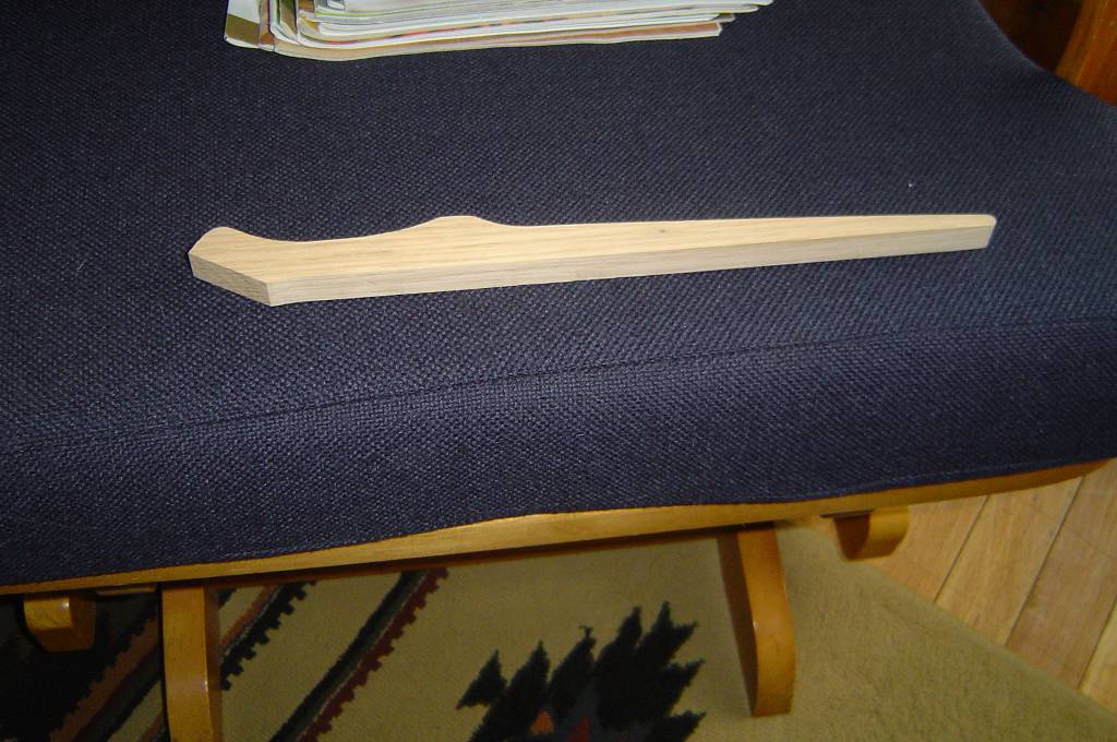

Meanwhile I am working on the tail skid. I choose half inch oak from which to cut the blank.
I think I will experiment with the router and see if I can get the edges rounded - might try a quarter inch round over.
If that doesn't work I will cut another blank and run it throught the planer to reduce the thickness.......

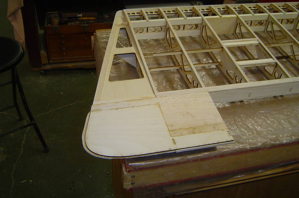

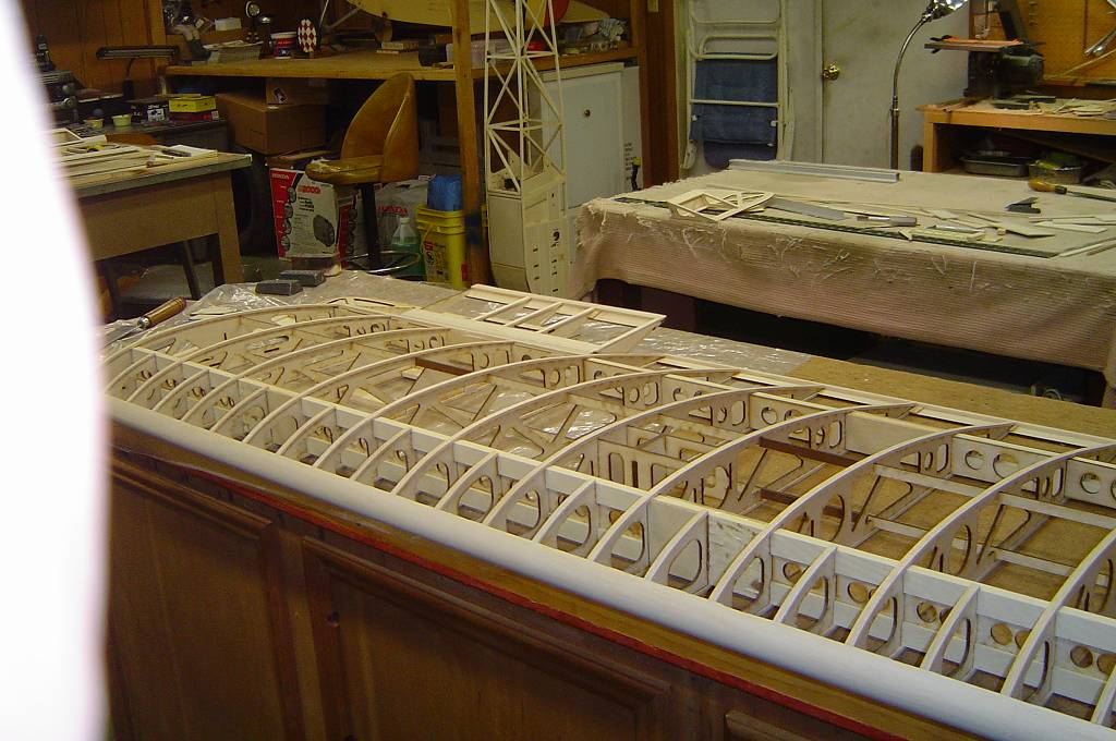

A decision to modify the wing and aileron tips has been made. The aileron tip will be cut off as well as the next bay (at least on mine). The tip will be glued to the wing trailing edge and the wing tip. This should make for a more pleasant look and provide more efficient lift at the tip.
This is but one man's modification........the designer is working on a new tip design which will be different than mine. Paul is also working on one of his own making.
Mine will have reduced aileron area and some might say will be much less effective.......it will be a little less effective, but I don't think the overall design will suffer much in the roll department. An Eindecker won't roll well anyway no matter how you ask it to........soooooooo -

Aileron tip is now cut off - no turning back now!
Chuck Cunningham's articles of design that were published in Radio Control Modeler back in 1976 or so called for an aileron area of 12% of the wing's total area for a sport plane. I haven't measured but it looks like this aileron is about 6 to 8 % of the total wing area.
I think with this plane a lot of rudder will be used for most of the maneuvering along with the ailerons..........I base this on how my old third scale E1 with wing warping flew and also on my observations of Paul's model. I think I'm gonna like it!

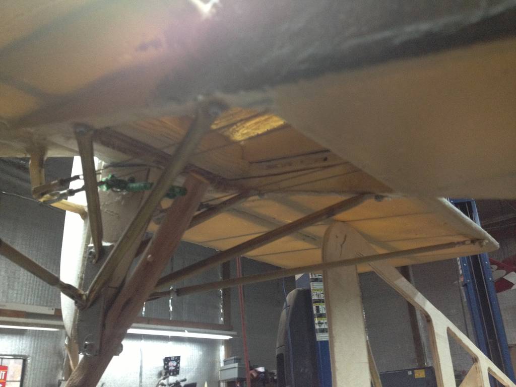

ORIGINAL: bugle3
It is correct that the full sized planes used a goodly number of flying wires but they also internally braced the wings with diagonal struts that went from the top of each rib to the bottom of its adjoining ribs. From front to back, their were four of these X pattern braces between each set of ribs; this added a lot of internal stiffness to the wing.
I'm not sure what you mean by "diagonal struts." The original EIII (the ONLY surviving original EIII) in the London Science Museum, absolutely does NOT have internal bracing struts. Perhaps you are referring to the span-wise criss-crossing FABRIC tapes which served to hold the ribs in position as the covering was tightened. These fabric tapes were also found on later Fokker aircraft (such as the DrI) and are still used today of many modern fabric covered aircraft wings. Remember that since the original flew with wing-warping, a flexible wing was an absolute requirement.
As you can see in this photo, there were however, diagonal cable bracings that spanned several rib bays.

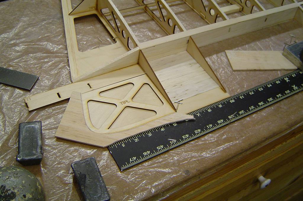

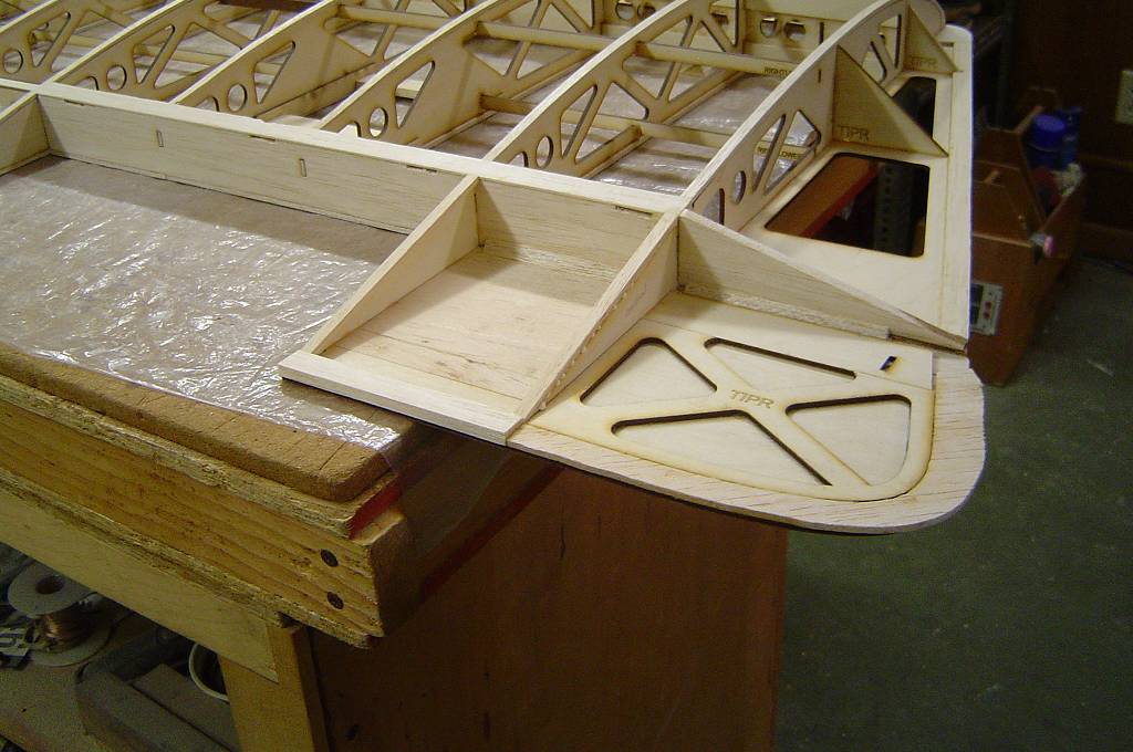

One wing tip on and awaiting final sanding.
Second wing tip fitted, fill in pieces rough cut.......tip & bottom sheeting glued and secured. When this is dry I will add the other pieces and ribs and cap strips.
Then I will cut and fit the aileron to the new space.

These 2 pcs show ONE of the ways you can make the tail cage assy.
This is kinda Arts and Larrys ideas rolled into one.........
I like this construction because it is EASY, inexpensive, STRONG........and did I say EASY???
HPA
