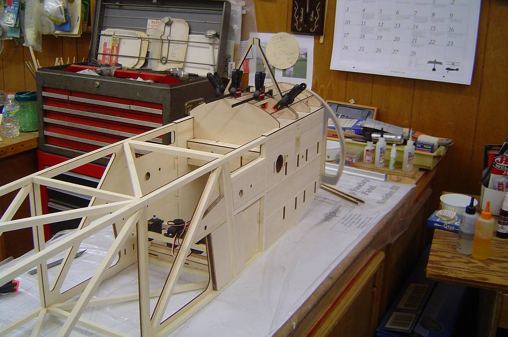

Default RE: Eindecker EIII
ORIGINAL: CubCrafter
Art,
Did you do that little trick we talked about when adding the top cross piece where the angle starts
to tamper to the rear?
Your fuselage looks like it has less bow in the top longeron than mine did.
Larry
Nope......I thought about it, but I wanted to use all the pieces that were in the kit along with the jigs without any modifications. I think it went together very well. I must have used staighter wood or sumpin'

Doc,

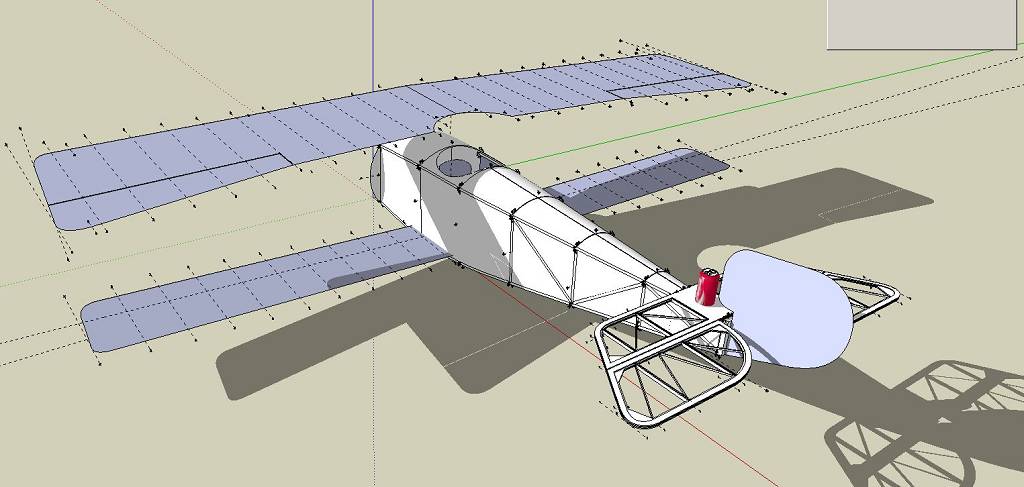

The way I did the jigs was since I did this all in 3d I was able put a cutting
plane at each upright and then did an intersect with model to get the outside shape of the
fuselage at that point.
Then all I had to do was delete the shape made by the intersect and it left the hole in the cutting plane.
Larry

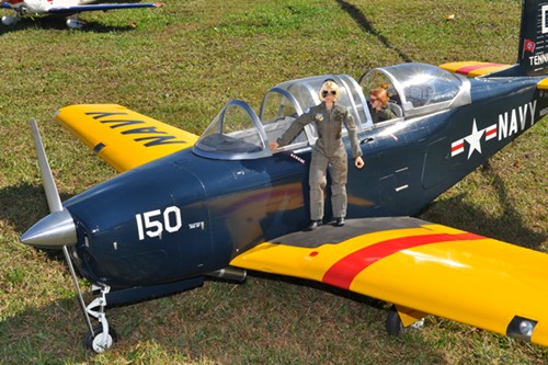

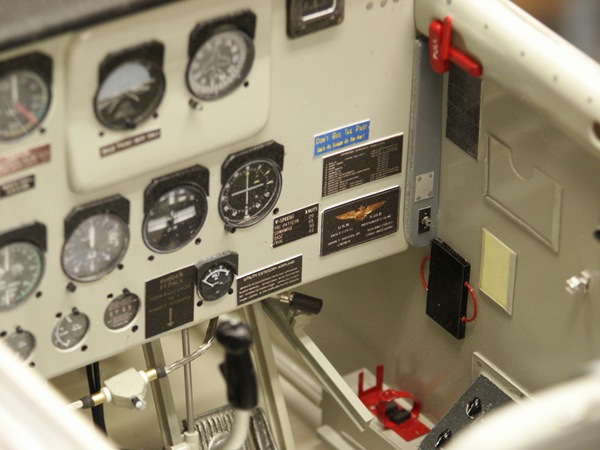

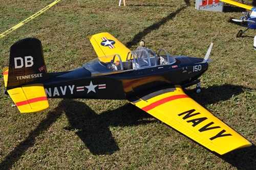

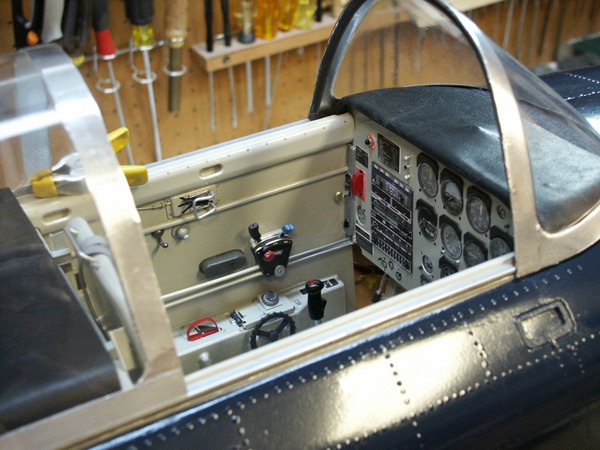

The Eindecker is massive and I am marvelling at the engineering thought that Larry put into his kit. Watching you breath life into this subject is down right fascinating.
Larry, The T-34 is flight ready and about 98% complete. I am thinking of showing it at Toledo and soon after, it will have it's maiden flight. If I don't roll it into a ball then I am planing on competing with it at the Mint Julep and maybe the NATs after that but my bride thinks that I may have a conflict with the family vacation. Unfortunately, my plane is going to end very close to 20 lbs so the whole roll-up-into-a-ball thing is a possibility. In that case it's back to the judges box for me.
Ripley

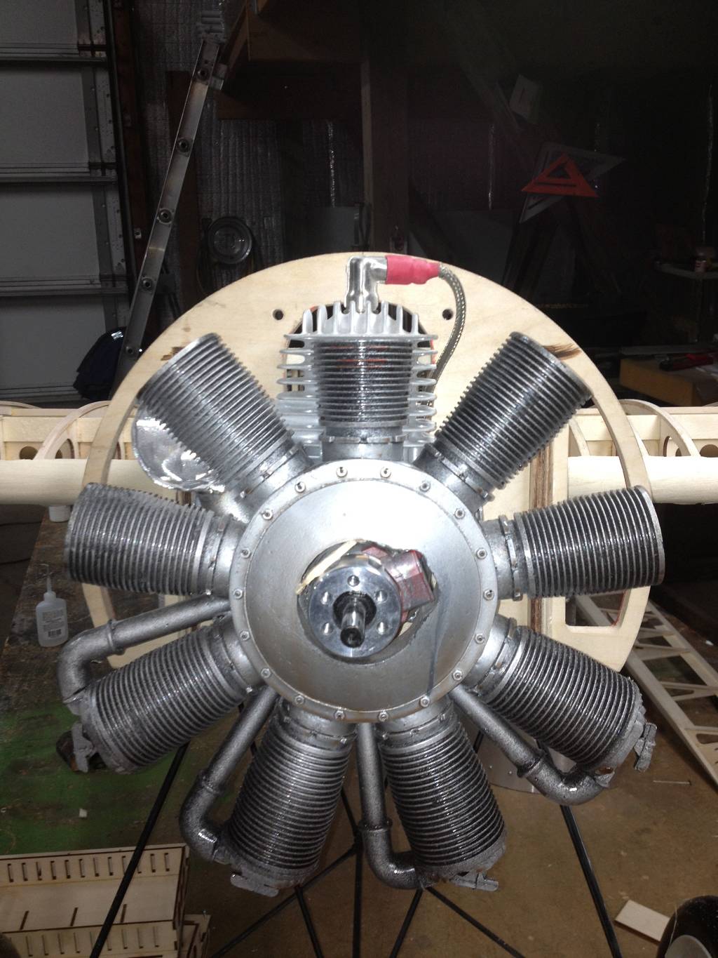

Here are a couple of pics with wheels ....leading edge formed (nice forming tool Larry)....the cut outs in fire wall to cool the DA and a final mock up of the dummy cowl and the prop...
Art or larry did you guys decide whats going on in the "tail skid" area?
The plane was mocked up with everything EXCEPT the servos and covering and she came in at 31# .......and she was real nose heavy........yes the tail was way up in the air!
We wont get tooo excited until we have all the componets installed....but I think we can keep the weight under 34 lbs.....a 132 inch 1/3 scale plane!!! Hats off to Larry,,,and you too ART! LOL!
HPA

ORIGINAL: Horsepoweraviation
HPA
Hey HPA,
What kind of dummy engine is that?
Jim
Old 02-09-2013 | 01:04 PM
  #200
geezeraviation's Avatar
Joined: Nov 2007
Posts: 1,736
From: Greeneville Tn.
I think it's a Ziroli, but Paul will know for sure.
Doc
