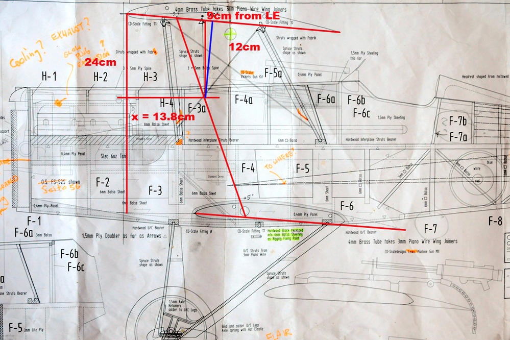

Originally Posted by jack steward350
I have Dave Platts' plans for and exact 1/6th scale Se5 and he shows CG to be 2.7 cm back of the top wing leading edge. My intuition tells me that this too far back but in reality I do not know for certain.
Huh? 2.7cm back from the top wing leading edge??? That must be a typo.

well yes ! Well no! I mean 12.7 cm ! Sorry. I have been making measurements in 2 and 2.5 mm the last few nights and miss spoke. It is at 12.7 cm or 5 inches if you use that cumbersome base 12 English measurement system. That would be at exactly the half mark on the length of the wing chord. Still to me always seemed wrong when I first looked at it.....but I really don't know.

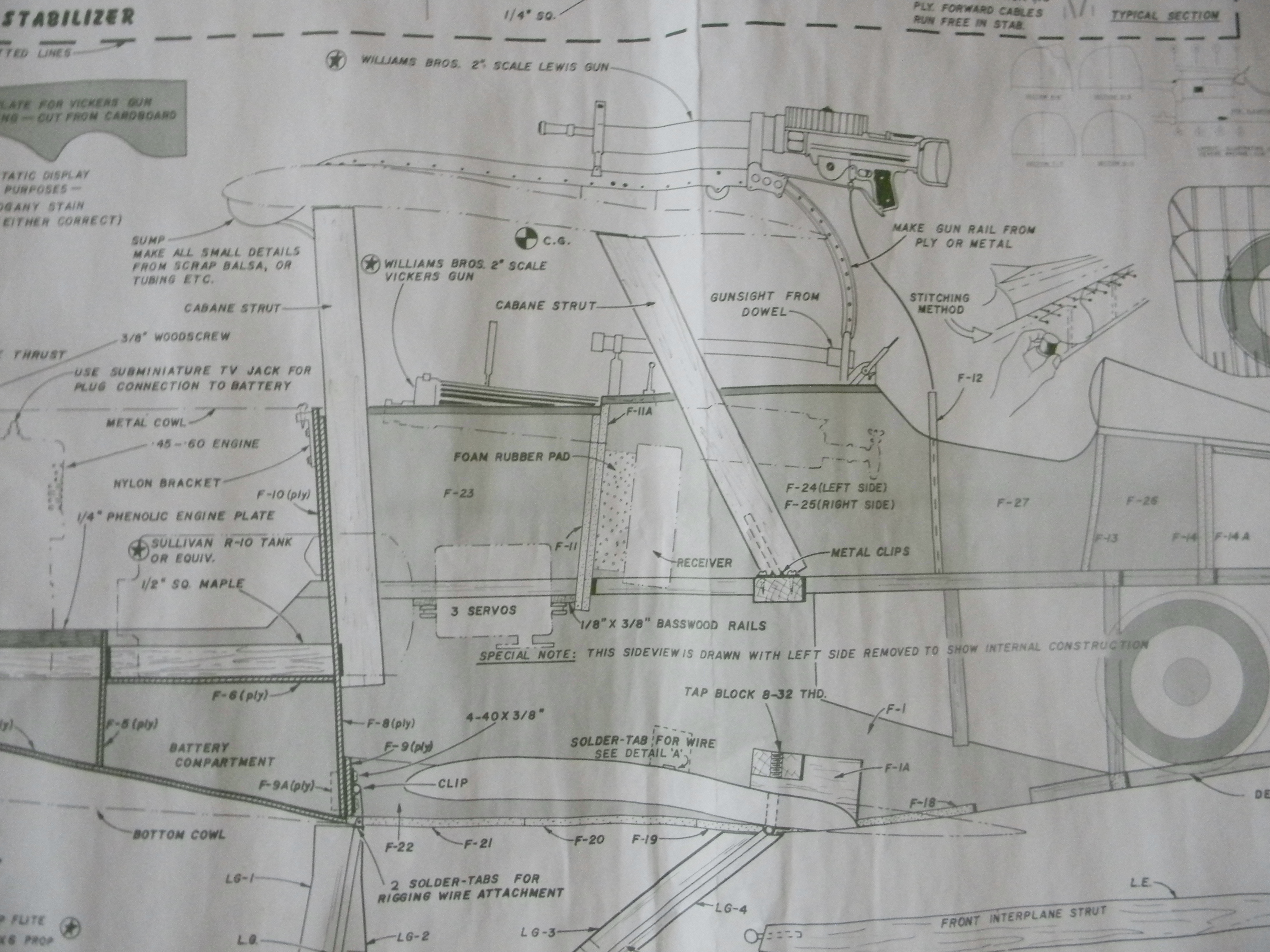

Here is a photo of his plans so you can see what I am talking about:

Here are a couple of photos I just took with my model. The first shows the model (with the same lead weight it had on it's last flight) balanced at 9cm. In the second photo I'm balancing the model at the 12cm point. This is obviously far too nose-down with the weight I have in there now. But it flew uncontrollably when I had it balanced at the 12cm point for the maiden.
I'm sure Chris was aware of the Dave Platt design (and maybe also a Boddington SE5). I'll ask Teus (again) where he balanced his CDScaleDesigns SE5a.
PS. The Platt design looks great (which is unsurprising). Personally, I don't think CAD design has much to offer WWI modeling.

This diagram shows the calculation method used to come up with the 9cm location. The photo shows this geometry applied to the CDScaleDesigns plan. Notice that the CG location marked on the plan (about 12cm back) is very similar to that on the Dave Platt design. But the incidences/airfoils on the two models are not identical.

That is fascinating. The best thing you could do would be to contact someone who has one that they have flown. I think I have seen some Dave Platt builds on line that could be a good source. I don't think the wing incidence would have a relationship to the CG location? So they both work out on paper to be correct....maybe. For what it is worth the first photo I would call tell heavy. The second is obvious. I am just wondering if it seemed pitch sensitive or if you needed excessive up trim in the elevator or if it seemed unmanageably unstable? I realize a lot of other things were also going on with alignment issues but on top of the alignment problems a tail heavy condition would act just like that and make you wonder what the heck is going on with this model? I have been there. Some one out there knows the correct CG for that airplane. As SE5A models go that's a great one!

For what it is worth, looking at the first photograph and if I were about to test fly it, I would want to bring the tail up a small bit and I would do just that. To my eye it doesn't look level but close. However I think it is highly likely that balance at the 9 cm point would be manageable as a starting point. The big question is was Dave Platt wrong? and the plans you have wrong? Maybe the CAD designer used Dave's design and carried the error forward? Who knows? It's either that or they are both wrong and I have to wonder how likely that would be.

For what this is worth people are balancing the Dave Platt SE5 at 9 to 9.7cm not the 12.7cm mark. The one person who flew his at the 12.7 cm reported that it flew lousy really lousy. This is from a Dave Platt SE5 thread I just read. There you go more confusion but I think 9cm is it. See if any body else knows.

To be honest, designers often don't know until they have actually flown the model. They can make best guesses based on experience flying prior models and looking at other designs (and making formal calculations) but in the end, until it's flown it's all guesswork. With such a skilled modelers (and flyer) as Dave Platt maybe he was just a much better pilot than I am and could fly the thing balanced at 12cm.
At 10cm back, my model would definitely be a bit nose down.

Teus says that his model, with the CG at 10.5cm, adopts a slightly nose down attitude. He further reports that in flight it resists turning with only ailerons and that rudder is required to make a turn. He also said that because his model has a lot of scale weight it flies fast. I believe my model weighs around 3.5kg.
Anyway, I think I'm done. (With the exception of making sure the engine runs properly.)
