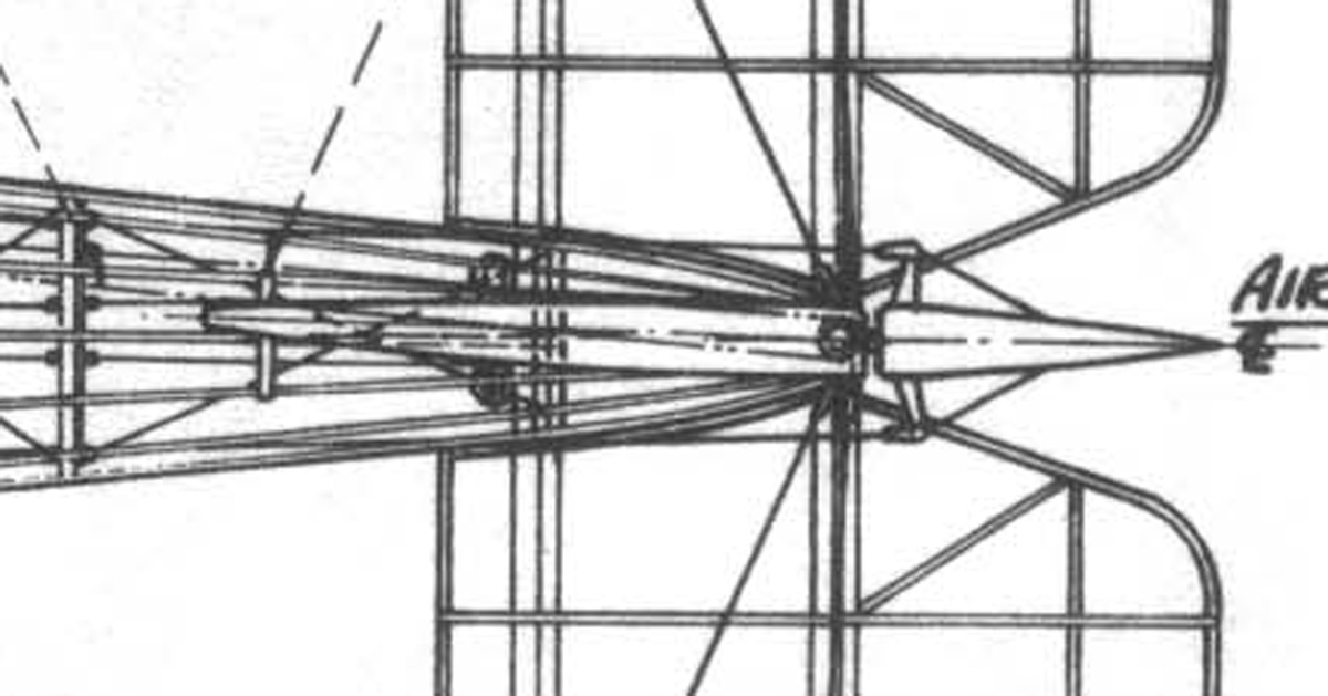

But I would note that in some cases, the full sized prototype had the vertical Stab offset by about 4° to the right to counteract Engine/prop torque.
I've heard of that idea but never really paid careful attention to it before. Now that I'm looking for it, I see in the Wylam SE5a drawing (also shown on the forum link someone provided earlier) that the vertical fin is indeed off-set to the right!
That's the thing about going scale. If you're going to go scale, you have to go ALL the way!
Makes me think that maybe I DO have to somehow get more right thrust. BTW, something else that I haven't checked is whether there may be some slight degree of left offset on the model's vertical fin that could be adding to the problem. If there is, I can't change this now, but I could add in a click or two of right rudder.

Using photoshop to measure off the above drawing, it looks like the fin was offset to the right by a bit more than 4 degrees. So...does right engine thrust of 2 degrees = right fin off-set of 4 degree?

Actually Don, that Wylam Drawing is showing the Fin off set to the LEFT! At least that's my interpretation. And I would not take a Wylam Drawing as gospel... There a great many details on his drawings that bear NO relation to reality.
Consider two things.
A) the Tail Moment is about three (maybe three and a half) times longer than the Nose Moment.
B) the Offset motor is PULLING the nose around to the right, while the (right) Offset fin/rudder is REACTING to the airflow by pushing the tail to the left. So possibly, the fin/rudder offset is less effective than the engine offset.
Just postulating... my Aerodynamics might be right up the Khyber.
Damn semantics! If you look at the tail post of the fin, it's dead-center. Then look at the "nose" of the fin. It's offset to the right of the center stringer.
You're right there. I just checked on the Replicraft drawings and there is no indication of any off-set on the vertical fin.
...while the (right) Offset fin/rudder is REACTING to the airflow by pushing the tail to the left.
I'm assuming that what the vertical fin will want to do in flight is adopt a position of least resistance, i.e. with the LE directly into the airflow. If we take the LE to be on the right side of center, then for the fin to get lined up with the airflow, it will try to swing the tail to the right. So that doesn't make any sense! I suppose the better way to look at it would be as a vertical airfoil with the right off-set equating to a raised LE. This should (at least in my mind) produce more "lift" ("pressure") on the left side compared with the right side so the fin should move to the right.
That's the opinion of an English teacher.

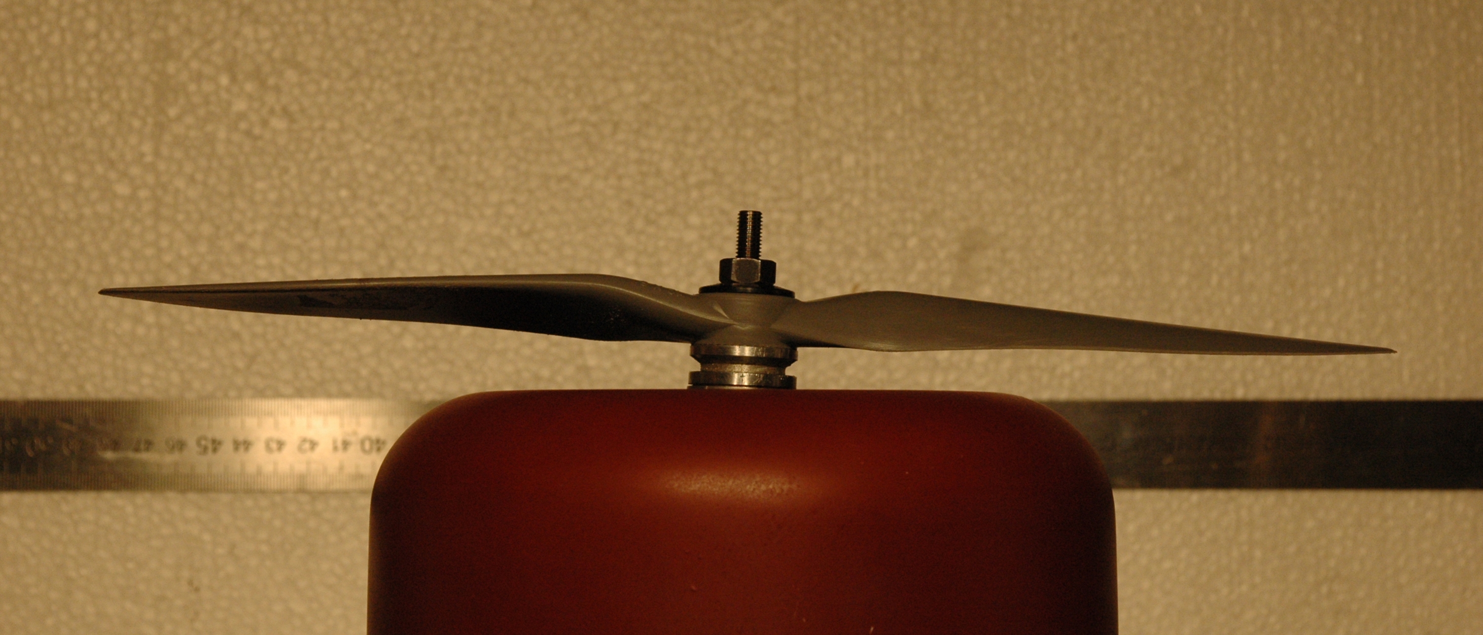

Again using PS for a bit of photo-analysis, the engine is now has between 1.5 and 2 degrees of right thrust. In the case of the SE5a it doesn't matter too terribly much that the crankshaft center is a couple of millimeters off center. That sort of thing is more visible in a "round cowl."
If it flies well...and after I get used to how it flies...I might consider moving it back to 0-0.

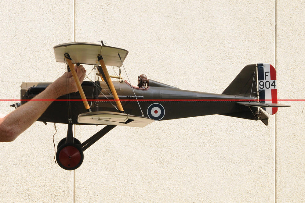

The only things remaining are to re-check the balance and re-check all the radio set-up. Here's the discussion on balance on my RC GROUPS thread:
http://www.rcgroups.com/forums/showt...363887&page=73
I feel like determining balance is my Achilles heel. I very frequently get it wrong on the maiden and the position indicated on the plans is most definitely wrong. I just barely got the model back in one piece with it "balanced" at that point.
I think part of the problem is the different ways that different modelers used the term "balanced." To me, that word means that the model is "level" (for example, with the stab parallel to the ground). Other modelers talk about "balancing nose down." Well, that's not really balanced it is. Can you imagine people using a weight balance like that and saying "balance it with the left side down a little bit?"
Anyway, the number I seem to be coming up with for the CoG is 9cm behind the LE of the upper wing. If I put my fingertips at that point, the stab is about level (I think since I can't really see it properly and hold it at the same time). If I place my fingertips at the 12cm point marked on the plans the model adopts a significant nose-down attitude with the stab also pointing downward.

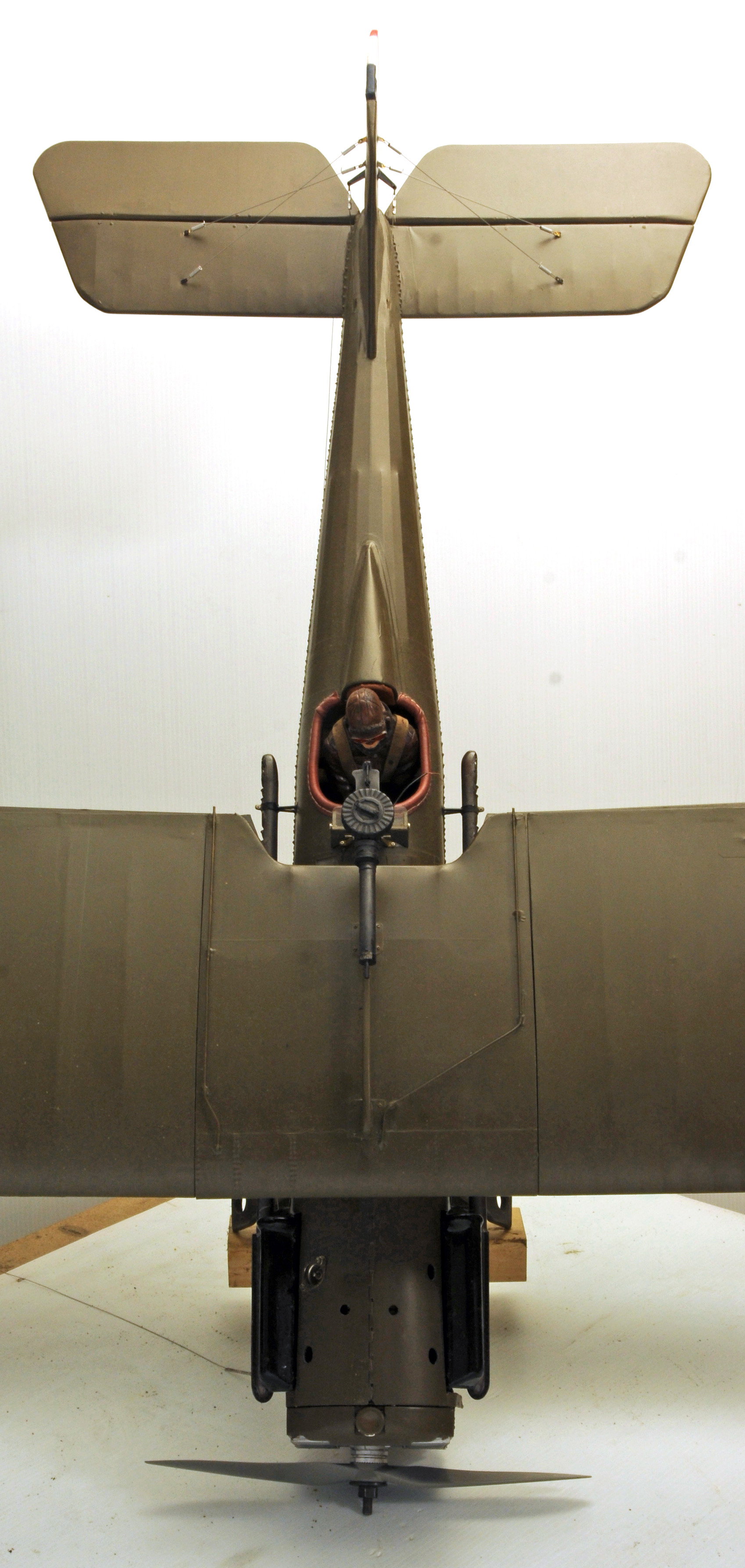

Don. Of course I am interested in your conundrum from an SE5 / builder standpoint. Lots of good tips and info. so far,. It is obvious from the last frontal photo that things have gotten rather "out of true". Good thing you have a Robart incidence meter.
Your frontal pic shows two major issues that I can see.
The incidence on your Starbord side ( yes= right side if you are the pilot sitting in plane) is more positive than your Port side.
This will of course in create more lift on that side, thus the Port side roll effect.
Also your cabane is not symetrical which may be causing some alignment problems to begin with but I doubt that this is causing you any major attitude problems.
On my Recent 1/4 Fleet rebuild I spent 15-20 hrs. adjusting the incidence to get all wings within 1/10 of a degree of their proper amounts.
This necessitated making all new wing root inserts so that the wings would be at the correct setting WITHOUT any cable adjusting help.
I then firmly held the wings in place as I made my cables and made sure I had the same incidence once all was removed.
For the first time in my building career I tried "0" degrees engine side thrust and "0" degrees down thrust...
Let me just say that it flew like it was "on rails" on the first flight which made me a firm believer in getting all incidences as close to identical as possible and also not worrying too much about side and down thrust.
But of course every model has it own dynamics.
Hang in there, Eric

All of these issues have now been corrected (see the finished rear view on page 4).

Originally Posted by jack steward350
It is very important that you know for certain where the CG point is supposed to be and best not be guessing where it should be.
As Shakespeare would say: "Aye, there's the rub!" This kit is definitely still at the prototype stage. I'm only aware of one other CDScaleDesigns SE5a that has flown (Teus' model) and I don't think more that a dozen were ever sold. The plans show the CG at 12cm back from the leading edge and that's where it was for the maiden flight...which was a disaster as the model was absolutely uncontrollable and I have no idea how I managed to get it back on the ground more or less in one piece.
Using the calculation shown on the RC Groups page above, I came up with the new position of 9cm back from the LE. I then held a dowel spanwise at that location (to avoid the influence of my fingertips) and added weight to the dummy radiator. See the first of the balance photos above. Technically this is slightly "nose down" since with the fuselage center line would be perpendicular to the TE of the rudder (and the stab is actually a +3 relative to the centerline).

You are correct about the stab relative to the centerline that is exactly where it should be. I empathize with your dilemma being a designer and a scratch builder I have been there more than once. I have Dave Platts' plans for and exact 1/6th scale Se5 and he shows CG to be 2.7 cm back of the top wing leading edge. My intuition tells me that this too far back but in reality I do not know for certain. With all the Scale Se5s that are flying go with what these knowledgeable modelers recommended for they truly must know for certain and base this on reality not theory or math. It is also correct that the nose should be at a slight nose down attitude. I would be very interested to know where it ends up as someday I plan on building the Se5 kit that is tucked away in storage. Good Luck !
