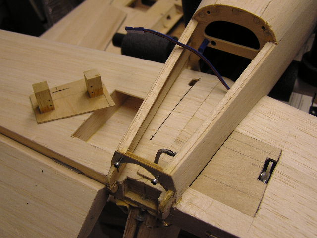

Old 01-11-2015 | 02:21 PM
  #100
Joined: Oct 2006
Posts: 432
From: kelowna, BC, CANADA
Dual elevator setup in the H9 twin Otter by ARF design that I adapted to my Top Fite Cessna 182-60 and would do it again in a snap. System is tight with no slop.
Name:	006 Install tail elevator servos.JPG
ID:	2063096   Click image for larger version
Name:	010 twin tail elevator setup.JPG
