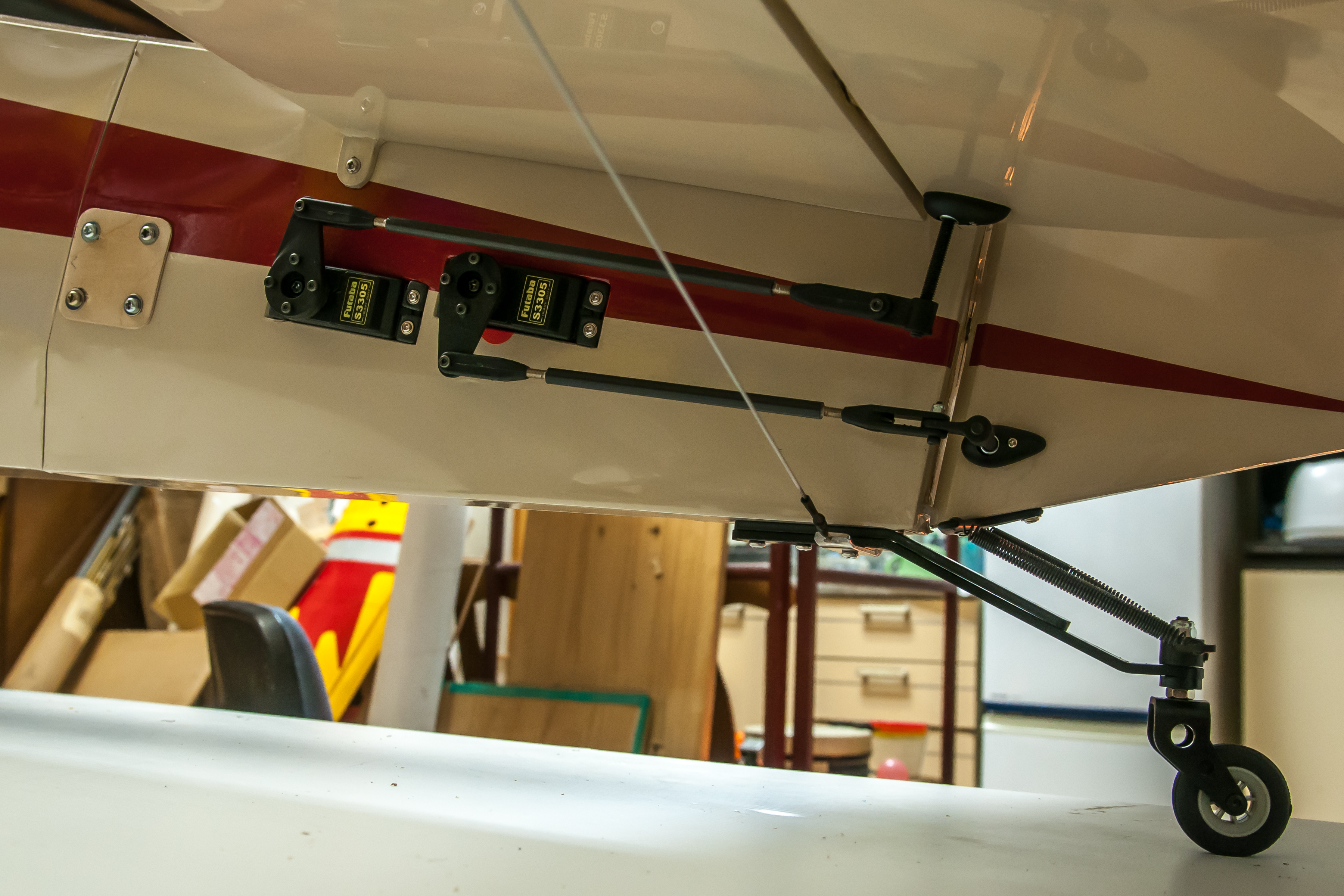

Here she is so far.
ID:	2061019   Click image for larger version
ID:	2061020   Click image for larger version
Old 01-05-2015 | 05:50 AM
  #66
abufletcher's Avatar
Joined: Feb 2004
Posts: 15,019
From: Zentsuji, JAPAN
#@%@! Two unpleasant discoveries: 1) I'm getting some twitching on the servos at rest and 2) while I was under the wing I found that on the right aileron three of the seven hinges hadn't slipped into their slots while doing the epoxying. If we number them 1, 2, 3, 4, 5, 6, 7 starting inboard, then hinges 1, 2, and 4 aren't attached to the wing (only to the aileron). I don't know how I allowed this to happen. I was so cautious otherwise, even went to the effort to put dabs of grease around the actually hinge area to prevent epoxy from getting in there. It probably looked fine from the other side and I didn't check it. #@%@#. Not sure what to do about that. Cut off all the other hinges? Drill out the old hinge bits? Start all over?
Also don't know what to think or do about the twitching.

Bummer, she's a beauty. The hinge issue, I'm afraid, is going to be the hard road. Cut out and start over is the only way I know. As for the twitching try rebinding the receiver. You don't have a velcro strap or anything wrapped so tight the bind button gets pressed do you? No carbon fiber near the antennas?

I'll also try a different battery. In the past I've sometimes gotten twitching with a low Rx battery. As for those hinges, well, as the Brits say: "There's nothing for it." The nice thing about having done some scratch building is that you learn that anything that can be built can be unbuilt...and then built again.

Speaking with decades of experience.... ABSOLUTLEY DO NOT USE A SERVO REVERSER. They are not very reliable and often the causes of crashes. Simply plug the servo into another rx channel and do a mix with the radio. If you don't know how, pick up the manual and read it. If you value your pricey build and want it to last a long time, do not use a servo reverser.
Didn't read all the posts, but if you used a reverser, it can cause twitching. If you didn't use a reverser, then you most likely have a bad servo ( servo with a bad potentiometer ) which causes other servos to twitch by giving unwanted feedback into your RX. Find it and replace it!

The dual elevator issue has been resolved as the RDS8000 does have the ability to work split elevators with separate servos. as well as they can be reversed.... See old dogs ( me ) can still learn something new. After some research I found how to do it.
Regarding the servo twitch , try swapping out the twitchy one with a known good one that does not and see what happens. If the twitchy one is a used servo
; it could be a dirty pot, would be my first guess. I agree that the servo reversing harness is not a good way to go . Seems to have issues with certain brands of radios more than others
