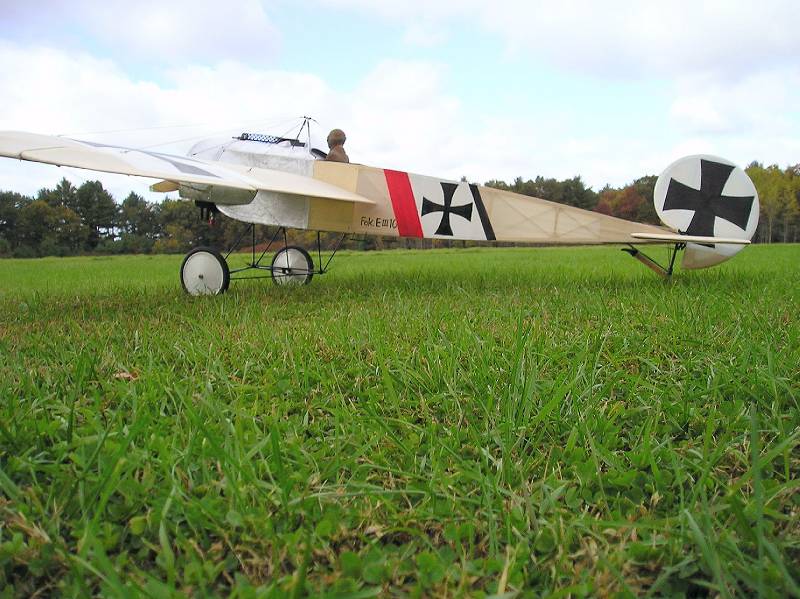

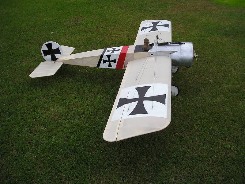

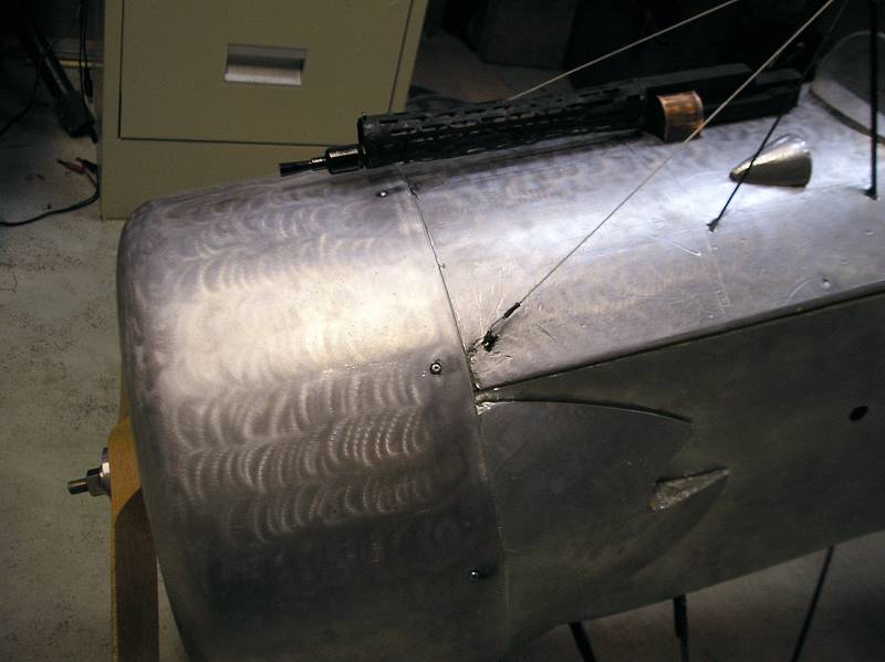

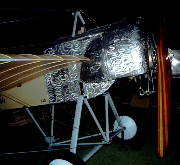

A couple words on scale detail. First the metal cowling on the eindecker did NOT have those uniform rows of machine turned swirls that you see on most models (and that so awe people at the field). If fact, Sopwith seems to have been the only manufacturer who did this. The German scrolling is much more random and looks more like squiggles (or Arabic) than circles. It'd be a shame to expend all that effort to so that patterns machine swirls only to end up with something that is non-scale. To do the scrolling I borrowed an electric eraser -- and practices on some Dollar Store aluminum pots until I got the look I was after.
On the turnbuckles, I found some much cheaper ones from a wooden boat hobby shop in Canada somewhere (about $3.50 a pair). I think I ended up using at least 8 of them. Since I found myself pressed for time at the end of my build though I gave up on scale attachment points on the wings and just went for black metal clevises and thsoe DuBro 2-56 threaded couplers attached to small eye-screws.

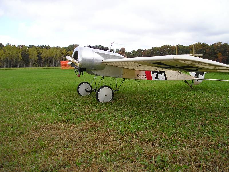

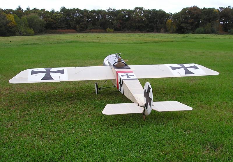

wow Don, I was about to reply to your comments about burnishing when I began going through your threads and ran across a thread on ackerman. I have had problem with my elevator all season and finally I think I have solved it. I chose to do a full flying elevator on my SR E111. I took the carbon fiber leading edge and made it the pivot point on my structure. I used a dowel for the LE and used SR's controll horns, which are 1 piece and wrap around the carbon fiber spar which is the hinge point for the entire structure. Every once in a while the E111 would start" porpoising",and I recognized that it had something to do with the fact that the elevator was "loose". No matter how much I tightened up the pull-pull lines I still had the problem and in fact, since I had a single spar for a pivot point it would begin to bind. The ackerman article just prompted me to measure my control horn and I found that the connection point for my horns are 5/32' in front of the forward edge of the spar and 11/32" in front of the center line.The last 2 paragraphs of the ackerman article make since until you consider that the E111 full flying elevator is 3 1/4" in front of the hinge line and 6 1/2" behind it!
I will be grounding my E111 until I redo the elevator. But I can't wait till I get to the field with it and show everyone how "smart" I have become!
BTW I love the" Flying" pic of yor E111. You should make it your signature instaed of the BE2.

Default RE: SR Eindecker
Don,
Here's the EIII at the san diego museum and as you said the cowl has the squigles.
BTW: Where can I find the ackerman article?

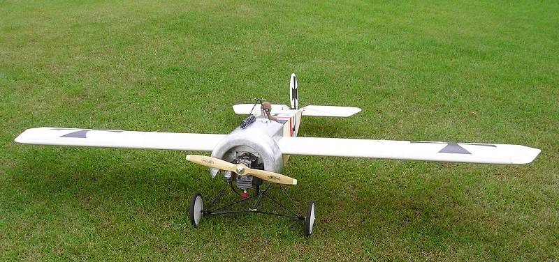

here are some more pics from before my dead stick mishaps!
