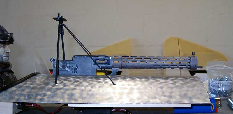

Cafeenman, your model looks extremely well crafted. But I do see one of my pet peeves that might easily be corrected:
The machine guns were always embedded in the top deck and not just sitting on it. This makes your gun a full 1/4" or so too high. You've obviously done a very professional job at building an detailing this model so it's unfortunately to see it seeing there in such a non-scale manner. Actually if you look at the forward attachment point of the WB gun you'll see a short straight part and then the part that angles backwards. The part that angles backwards would be below the deck. About a 1/3 of the body of the MG will also therefore be below the deck. The solution is either to actually cut a hole in the deck (more scale) or if this is not possible then remove a quarter inch or so of the lower part of the gun.
I see this again and again on otherwise outstanding looking scale models (for example on all the kits from 3 SeaBees) and it can be so easily remedied.

abufletcher - Yikes! Thanks for the info. The gun is wrong for the model. I left off the flash supressor and made a new front site using scraps from photo etch for a plastic kit. I waited until last to mount the gun because I couldn't find any decent references. In fact, the gun was always off center on the E1 where I could see it but the mount was still not clear enough.
I don't know what I can do about it at this point. I can cut into the top decking somewhat but I'm concerned as the only thing holding the wing on is the deck (which is held by the wing - strange setup).
Thanks for the compliments. I'll see what I can do about fixing the gun.

I had noticed the new front end and rectangular sight on the MG. In many ways with a sport-scale model like the SR Eindecker (or the Legionaire I'm building) you don't necessarily shoot for exact scale but rather a nice impression of scale. Most people will never be aware of any discrepancies anyway so we might as well be "artists." I've already taken many liberties with the Legionaire but I'm hoping that it looks "really scale" to most people thanks to some nice touches on the surface, for example rib stitching. I know that Platt says this is like dressing up a pig but I figure any techniques I can learn and practice on this model will make the next really scale one a bit better.

When I said I need to finish up the gun I meant glue on the ammo cover and fuel proof. Thanks a lot man...

PS. I don't see getting the gun much lower without cutting away the longeron which I think would be a bad move structurally.

So how are you doing that "worn metal" look on the gun? Looks great! I imagine you've already glued the gun down so I'll just shut up at this point.

That is actually very easy and there are several techniques that work. First, never use black paint for anything that's supposed to be black. Use 80%ish gray instead (4 parts black, 1 part white). That always looks better. After the base coat dried I used a 100% black wash to darken shadows. I followed that with random burnt sienna washes and a dirt (tan) wash. I dry brushed with light grays.
Another way is to rub the edges with a regular pencil. The cooling sleeve was sprayed with a shade of Testor's metalizer. I don't remember which, but it didn't matter since I had no idea what the right color was. I had to dry-brush it several times using white oil before the highlights were visible. Again, I sealed it all with klass kote satin clear epoxy.
I managed to cut another 1/4" off the bottom of the gun. The gun is overall 3/8" lower than in the first photos I posted here. This has complicated things since there is a nylon bolt glued inside the gun to hold it down and remove it for repairs if necessary. Unfortunately, cutting away the plastic revealed CA and micro balloons that were originally used to glue the bolt in place. The glue will interfere with the nut used to hold the gun down. I'm not taking acetone anywhere near this gun. It would take hours to remove the glue and I'm about positive I'd end up hitting the paint by accident more than once in that time. I tried chipping it out of the threads but it won't budge.
My choices at this point are to try to break the bolt free and glue in a new one or just glue the gun in place and cut off the bolt.
