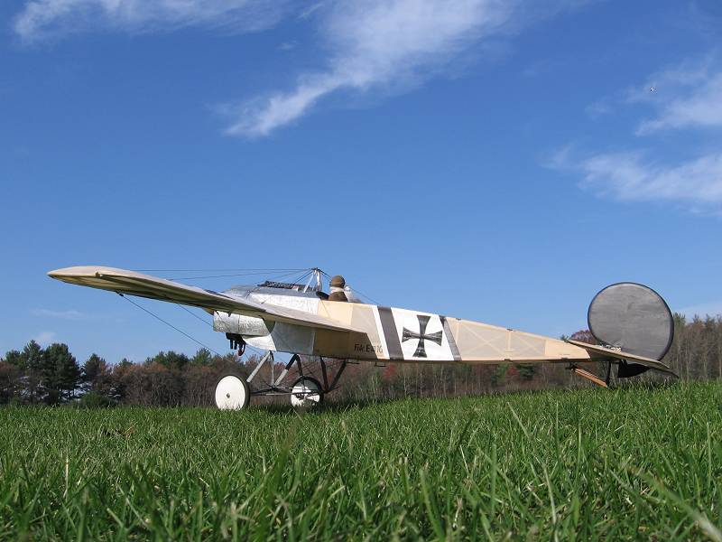

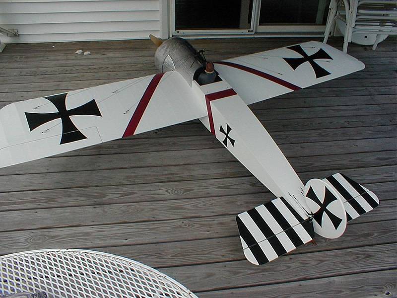

Hi Nickbee,Been flying mine for 2 seasons. I have a G26 but no smoke. I use a zinger 18x 6/10 with excellent results . On calm days It climbs with just full trim on the throttle.
Couple of must do hints Fix the rigging blocks to the spars and Not just to the ribs as suggested by SR. Any hard landing will have the forward flying wire come in contact with the tire and the block will end up getting ripped out of the wing. Also get some adjustable clevises and turnbuckles for the rigging. Saves a lot of time and effort if you have to make adjustments. I use 4 turnbuckles on the bottom for the flying wires and 4 adjustable clevesis on the top landing wires. On the top, I replaced their bracket with a brass plate with a slot that fits over the top of the pylon and 4 holes for the clevises. When I set up I attach the bottom rigging first and than just 2 clevises( I leave 1 side attached to the brass plate) then I lift the plate up and on to the pylon.

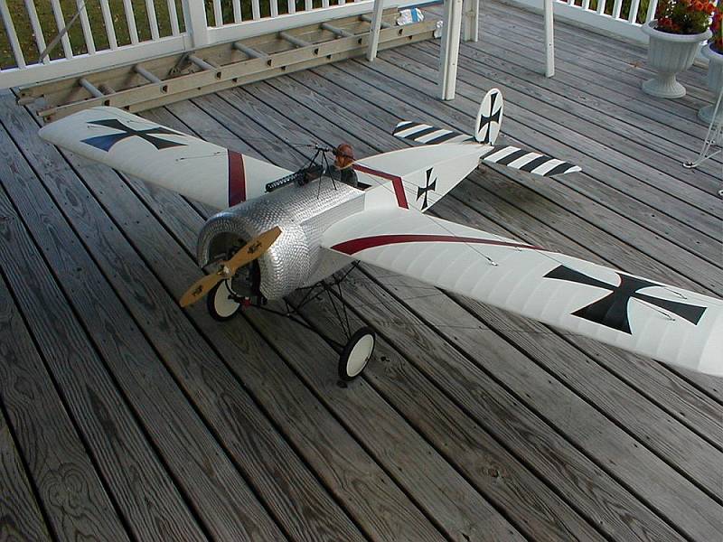

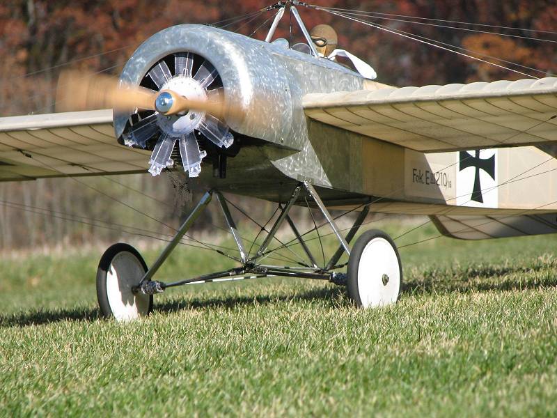

Yeh I 've seen a lot of Eindecker cowls with the swirls done in a regular pattern and that is not how the real aircraft appeared. The swirll effect was very random and that is almost harder to do than a regular pattern. I simply sanded the cowl and sides with a 400 grit wet n dry and than I used the steel brush tool from the dremel tool on a slow speed.
If you want the plane to look just a little better you can also put some fairings on the landing gear and pylon. If you use bass or hardwood it will also strenghten the gear. I used basswood and made a groove to accept the wire. I epoxied them to the gear and then wrapped them with some of SR's metal tape.

Nice pics. Like the dummy Oberusel! Do you know what the words near the little black reinforcement patches on the fuz say? Any close-ups as a font guide? (Don?)

Hey Cam, Good to hear from you. The words are Hier aufassen forward most and the last 2 points say Hier unterstuen with 2 dots above the "u" after the "t" I'll see about getting a font. The Oberusel is actually a Photo of a Le Rhone which Don ( Abufletcher) supplied on another thread. I doctored it up a bit and mounted it on a piece card board. I doctored the pic by removing the red spark plug cover.
Nickbee, I didn't use blocks because my wings were already built. I drilled holes in the blocks and wired them to the spars and than wrapped the blocks to the ribs with coverite. The drilled block idea is so much more simple provided you incorporate them as you build the wing. However you do it, I can testify that it will save you head aches. I have made a few hard landings and the wires ended up behind the wheels with the aircraft nosed over and the rigging remains intact.
The forward points say "Hier anfassen" ("Grab hold here" ) and the rearmost says "Hier unterstutzen" ("support here" ) -- as Feep says there are the two little dots ("umlaut" ) over the second "u." Unfortunately, "Hier auffassen" would mean something like "Perceive here"
My understanding is that these were applied as stencils -- so the font is probably a fairly simple san-sarif font. I ended up using a slightly fancier "German-looking" font -- for no particularly good reason.
Feep, thought I recognized that! I'll repost that photo later (the image isn't on my current computer) but it's of a LeRhone Type C. What you have removed would be the brass-colored exhaust pipes -- which the Oberusel didn't have. I might suggest running black sharper along those edges though! I plan on using this "trick" on my Snipe and already have a great photo of the BR2 to use. I think to really make this illusion work, it's important to print the photo with as much color and contrast as possible on high quality, glossy photo stock. It won't win any scal contests but it looks good enough for flying photos.

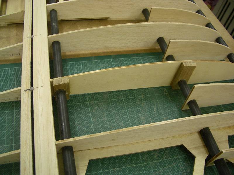

Default RE: SR Batteries Eindecker Questions...

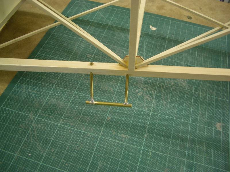

O.K., here's the blocks epoxied to spars/ply ribs, plus my mod to the root to add aluminium skins on top and compass.

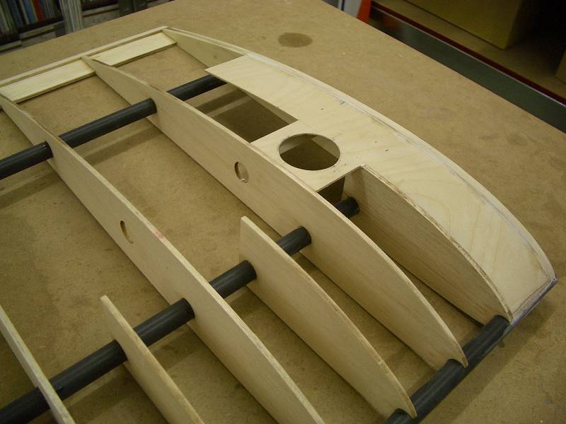

Couple more - the brass skid protector was pure artistic license, for practicality. I'll do a bit of local reinforcement to make up for the step holes!
Thanks for the info re the markings guys - can't wait to get to covering and those sqiggles now

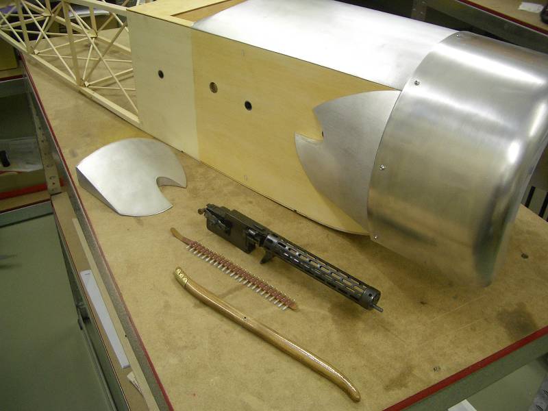

That's looking REALLY good!

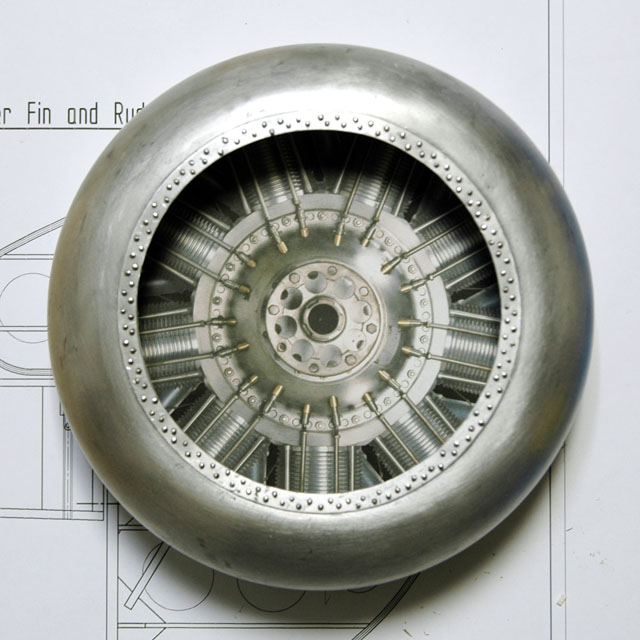

BTW, getting the "random patterning" seen in period photos of the EIII is a definitely a challenge. Overall, it has the random look of galvanized metal but up close you can see the individual "squiggles." I found that when I consciously tried to imitate what I was seeing in photos, it came out looking too "designed" or "imitative" (and it didn't help matters that I kept seeing Arabic words appear).
In the end, I just thought of the guy there in the Fokker factory, polishing away at these cowls day in day out and figured it must have gotten to be a pretty mechanical process -- something you could do WITHOUT your brain turned on. What worked for me was just to give the cowling light 2-3 secord bursts with a borrowed eraser tool. I tried not to look too closely and just tried to get a certain "density" of squiggles.
This shot shows my "squiggle pattern" better.

Isn't that the BUSA eindecker? How did you get the aluminum finish on the plastic cowl. I have the kit and wondered how to do it.
Well, it started out as a BUSA eindecker but after building the wing (the only part I kept, though in modified form) I decide it was WAY too "sport scale" for my tastes so I entirely scratch built the rest from the Nieto drawings (scaled up to the size of my wing).
This was my first ever scale model (and as a matter of fact my first ever RC build) so it was very much of a learning experience. I started out with the kit ABS cowl and tried applying FliteMetal but that was less than satisfactory -- also by that time I had realized that the kit cowl was both seriously too small and seriously too deep to be anywhere close to scale -- so it was off to the "pot" shop!
