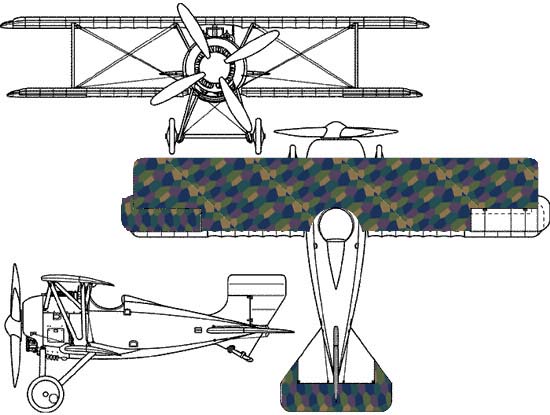

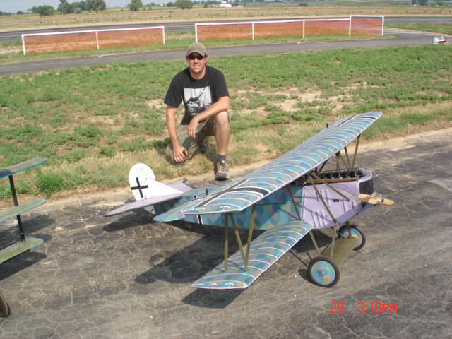

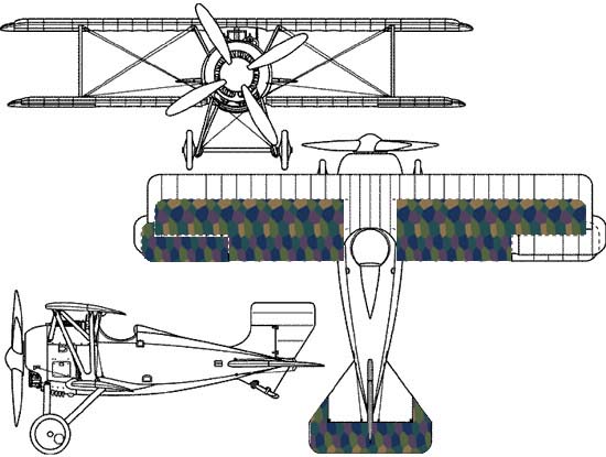

Here is a study pix I posted on the Aerodrome site, after I got the alignment information from Dan-San Abbott. If I can work out the issues, I will get his color chips and make up my whole-wing files to send off.
The third pix shows one of the Fokker (four color camo on E.V 151/18) images, which included all the fuselage graphics making the color scheme super fast to build. The other versions of the Fokker are also shhttp://www.rcuniverse.com/forum/post.asp?do=reply&messageID=6764677&toStyle=tm#

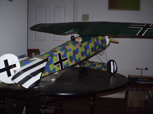

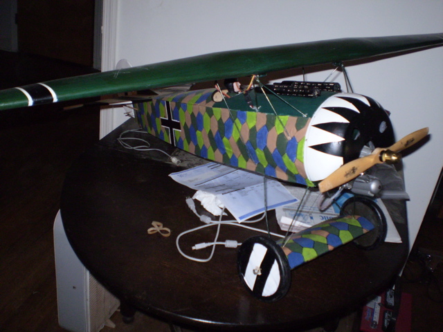

I painted the ones on my Fokker EV. It really was not so bad; the first color was the worst as it seemed to take the longest. I think it took two afternoons. I am looking for easer ways and I have some ideas, but I will not let it stop me from building the other 3 lozenge planes I want to if I dont.
