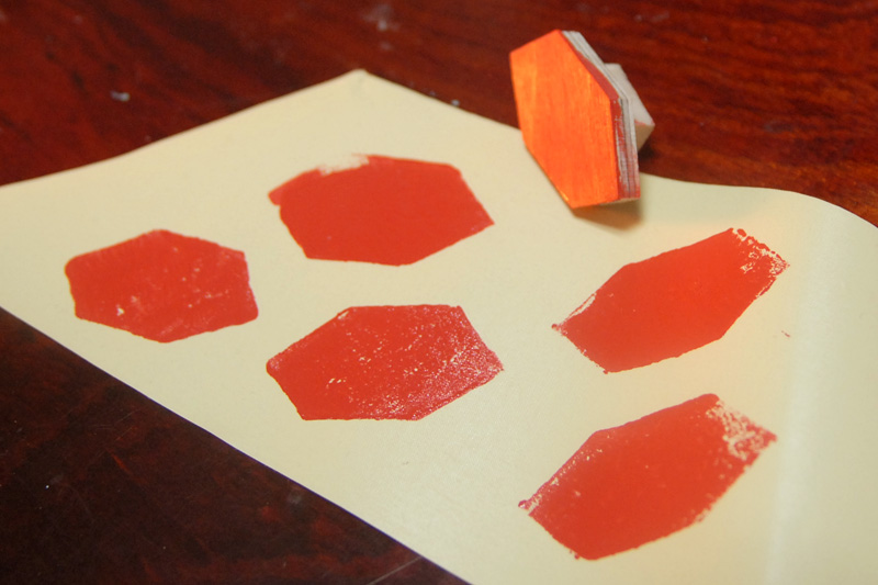

Yeah, but applying heat to painted fabric might not be!
Here's a quicky test of the woodblock idea. The results are encouraging but my technique still need a lot of work. For example, I need to get a rubber roller to apply the paint evenly. For this test I just moved the pattern piece around in a drop of two of unthinned paint on a smooth piece of piy. Also the surface of the pattern wasn't absolutely smooth. Making the stamp from rubber material might also help.
Again the idea would be to have multiple raised areas and stamp large areas at one time. It would only be necessary to stamp an area as wide as the original fabric.

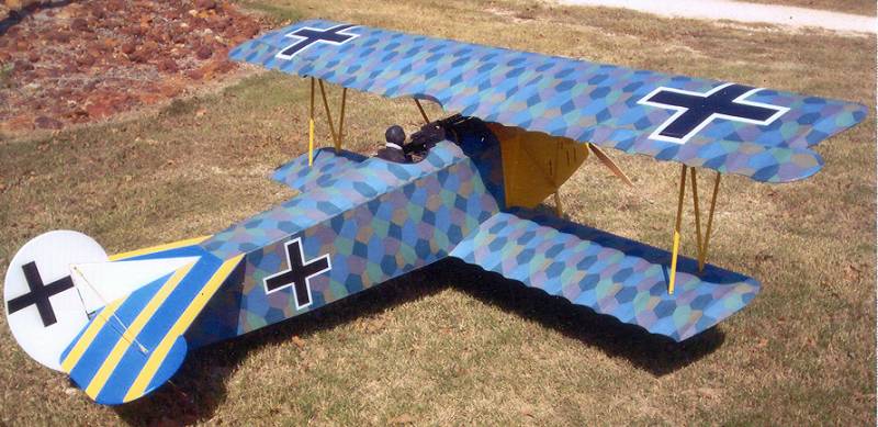

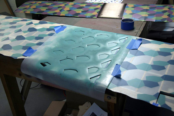

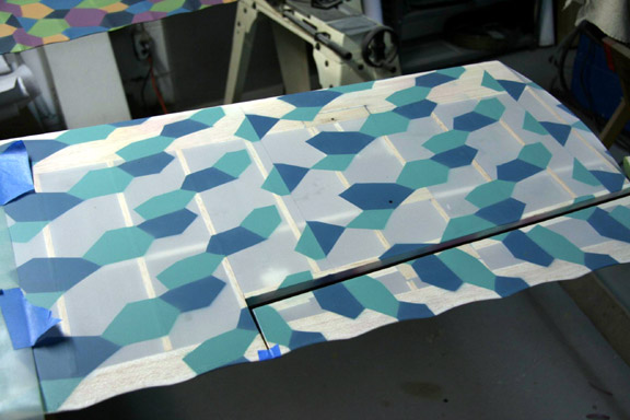

For my time and effort the most trouble free way I found to do a lozenge scheme was to make stencils out of a very thin type of clear mylar found in a good art supply store. I did a 1/4 scale Fokker D-VII for my first attempt ( 5 color). Each stencil was for a different color, and they were all keyed together so you could keep the next lozenge lined up in its proper place to paint it thus assuring proper overlap. Since this was a gas model, I used latex house paint sprayed with an airbrush. The paint dried quickly, and I even sped things up with a hair dryer. Very satisfactory results.

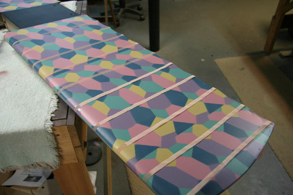

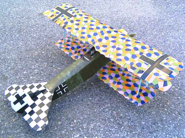

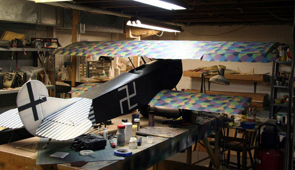

ORIGINAL: destrat
I did it exactly the same way recently on my 1/4 scale D.VII. This method works very well.
Jim

Old 12-20-2007, 12:06 PM
  #42
Tmoth4
Tmoth4's Avatar
Join Date: Mar 2002
Location: Northfield Center, OH
Posts: 2,205
Default RE: Lozenge
ORIGINAL: jashley1
T Moth, that is some beautiful work on your D-VII.
Thanks! I'm in the process of putting on the rib tapes now.
Jim

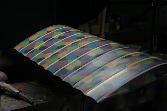

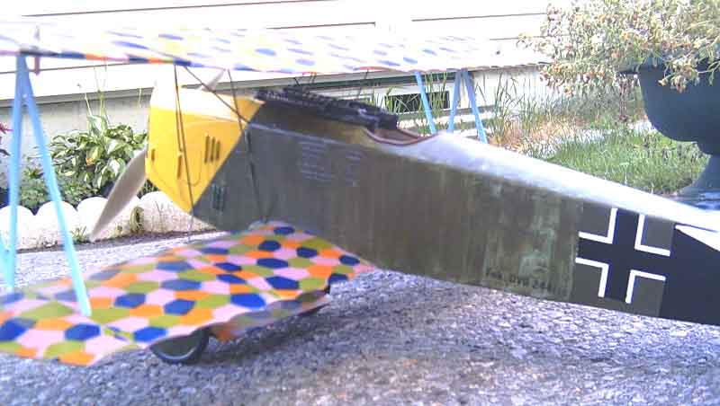

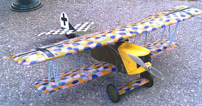

I used the stencil method on my 1/9 scale D.VII. Yes, it's a lot of work, but heck, if it were simple, then ARF buyers would be doing it too, right?
You can dowload the patterns from http://www.aerodromerc.com/ . Click "decals" at the top of the page, and follow the links from there. The patterns are there in .dxf format too, so it is easy to re-size as necessary. Once I had the correct size, I printed the patterns on to the back of that clear film that stationary stores sell to protect book covers, maps, etc. Then I cut out the individual colors, and went at it. The end result is worth the effort!

Yes, it's electric. I scratch built it from Peter Rake plans about 3 years ago. It's a fantastic flyer. Very light weight. I went electric about 4 years ago. I love WW1 aircraft, and it is just so much easier to run electric than glow with all those wires, struts, etc. No vibration or oily mess. Personally, I'd rather have the sound of a 4-stroke, but you can't have everything.
Kurt certainly has some great designs. I've actually done the prototype build for two of his kits (57" Albatros C.III and 47" Dr.1), and am currently working on the 1/9 scale 41" Snipe.
As far as the colours go, I matched mine using other documentation, and just used the .dxf files for the lozenge pattern. Nothing like mixing 8 custom shades of dope! I have always found that computers are very unfriendly when it comes to reproducing colours accurately. It's like Chinese whispers, and the accuracy always suffers everytime you go from program, to download, to monitor or printing.

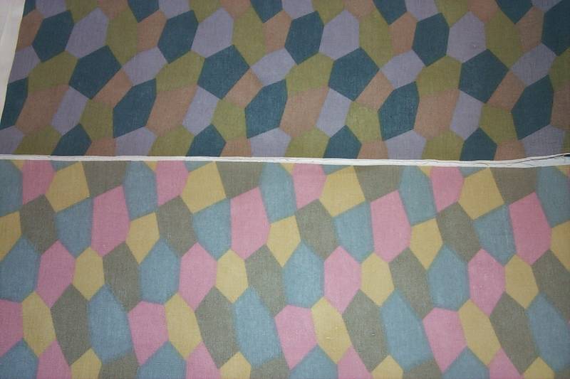

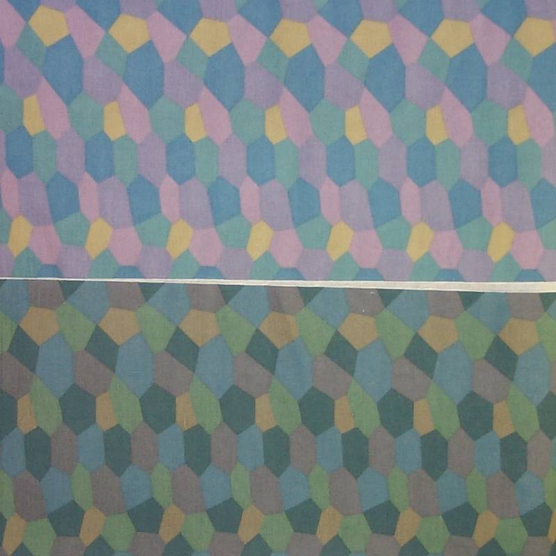

Does anyone know of a single source offering reliable color chips/swatches of lozenge (and other WW 1) colors so exact matches can be custom mixed in the shop as needed? Better yet, do any model paint manufacturers sell accurate pre-mixed colors in usable quantities? (I think that some of Testor's Model Master line are at least very close, but MM only comes in 1/2 oz. bottles).
Old 12-22-2007, 09:36 AM
  #49
FokkerAce
Join Date: Mar 2007
Location: Cortland, NY
Posts: 413
Default RE: Lozenge
Caribefoto:
[unless I'm mis-informed[:@]]

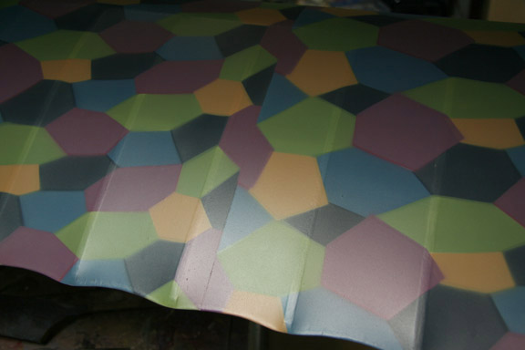

Glenn Torrance Models has fabric in the colors, 1/4 & 1/3 scale, 4 & 5 color lozenge.....colors are matched to original fabrics.
Get samples, and match your colors to them.
FA[8D]
Picts are 'borrowed' from Glenn's webpage

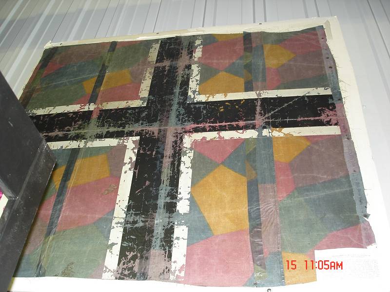

Default RE: Lozenge
Here is an example of an original piece of fabric from a DVII. This is hanging at a local WWI museum and they have several other pieces of original fabric. This looks to be the light color from the bottom of the plane.
