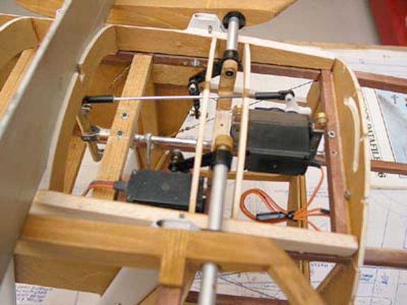

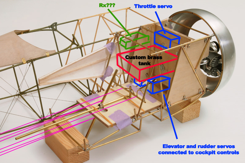

As everyone knows, I'm working out the cockpit controls on my DrI. I've figured out how to have the servo drive the rudder bar which in turn acts as the bellcrank for the rudder cables. I can also see how to connect the elevator servo to the joystick to have that move the elevator cables. And at the moment, I have the 2-axis movement on the stick which would allow scale aileron control, if I wanted to go with a full closed-loop system up to and through the wings.
BUT, is this simply impossible to achieve mechanically? The engineering problem, as I see it, is that while it would be simple enough to hook one servo to the stick for front to back motion and another servo to the shaft on the floor for side to side rotational motion, the interaction between these two motions on the stick/torsion bar would mess with the length(s) of the servo linkage(s).
It there a mechanical solution for this? Seems like something a good Yankee engineer from the 1880's could have figured out!

Perdeval has the idea sorted on his Tiger moth.
http://www.rcuniverse.com/forum/m_90...page_2/tm.htm#
While the moving control column & rudder bar idea is cute perhaps the more common sense idea would be to mount the servos upside down & lower, run the pushrods under a false floor & mount the belcranks behind the pilot's seat. - John.

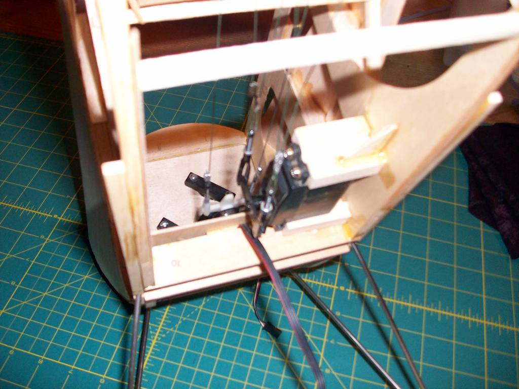

In terms of the rudder bar and elevator, what I'm doing is really nothing different mechanically from the way Summerwind did the bellcranks on his Nieuport. My bellcranks are just gussied up a bit.

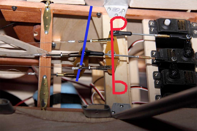

If you went full loop, you could burry the aileron servo in the wing and have the stick part of the loop. but not used directly to move the surfaces.

VERY interesting idea! A loop's a loop and it doesn't matter where in that loop the servo happens to be. Though I must admit I was planning on two independently adjustable servos. Makes like so much easier! But then I'm not very good at doing easy.
Oh, and Nieuport Nut, no need to worry about the unavoidable mixture of elevator and aileron as that just gets transferred to the human fingers at the end of the Tx sticks (for those flying Mode 2). But the system itself has to keep these two controls separate, that is a precise 1-directional movement on the stick should in principle only effect one control surface. It's up to the human to control the amount of interaction.

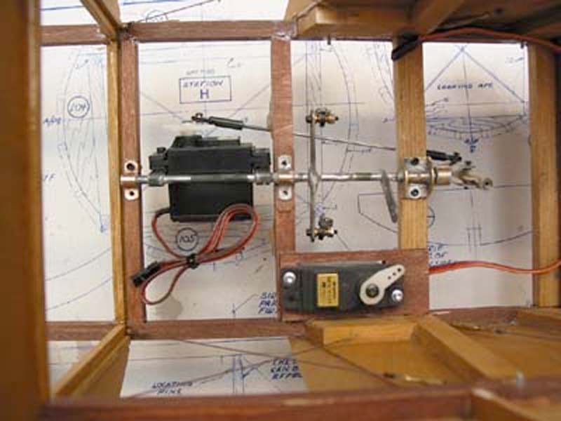

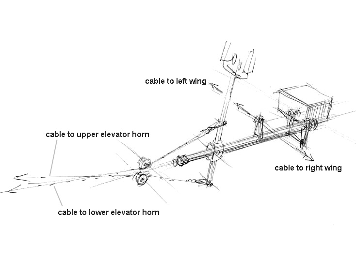

Would this work for you? I am only showing the servo for aileron in this sketch.
The 'collector' pulleys for the elevator cables take almost all of the aileron-elevator interaction out of the system.

The problem (as I see it) is with that unshown servo. Assuming that both servos are fixed in their location, as the aileron servo rotates the bar on the floor (which rotates the stick) it also moves the elevator servo arm slightly away from (or towards) the attachment point on the stick. Maybe this is just marginal and a bit of looseness on the elevator linkage would make up for it.
OK. Wait. I get it. By using the "collector pulleys" we're taking out the problem caused by the wide separation of the two connection points on the stick. Is this right?
No, the linkage is still a problem. I think.

You are absolutely correct that there could be an issue between the elevator servo and the stick, which would cause an aileron deflection to input elevator movement. The collector pulleys take out the interaction between the stick and elevator but not necessarily the stick to servo.
This additional sketch shows an aileron servo (probably looking at the wrong side of it here) that has its control arm output IN LINE with the stick's longitudinal axis. This would create a conical movement, without shortening or lengthening of the linkage.
Good luck fitting all three servos in their optimum locations in that little area however.
(Note that the linkage to the elevator servo is at 90 degrees to the servo arm - or you will get differential)

Maybe that's got it! And you know that might not even be that hard to setup. With the elevator servo "inside" the ammo canisters (which are above the rudder bar) and the servo controlling the aileron tube torque would be off to the side. The rudder servo is the least problematic as it doesn't interact with the other two. Might do a working mock-up of this!

The proctor build of the N28 on the RCSB had the aileron servo rotate the roll like allanflower's drawing and the elevator servo piggybacked the whole thing.

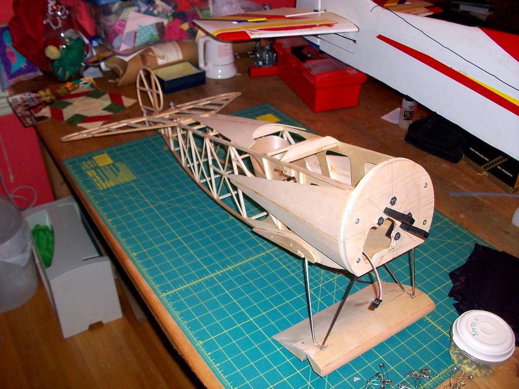

Yes, I think we have a winner here! At least this is certainly ONE possible solution! I don't know if I'll be able to use something like this on my little model, but it's nice knowing it CAN be done and that somebody's done it! [sm=thumbs_up.gif]
BTW, I also like the way we've all just nibbled away at this problem until eventually the pieces came together.
