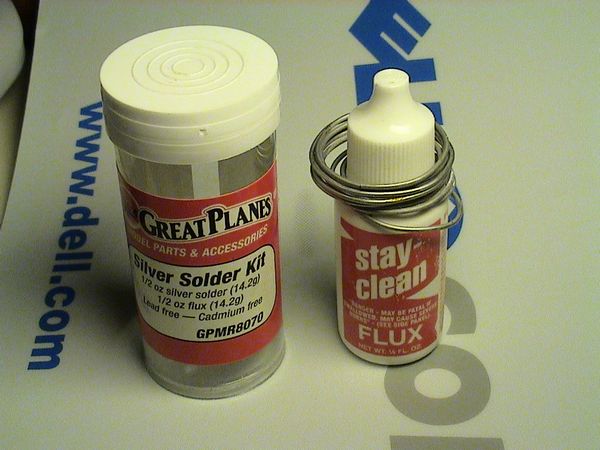

Can anyone help me solve a problem I'm having with soldering. About half the time it works perfectly and the rest does not. I sandpaper the metal and rub it with alcohol, then bind the joint (say, a landing gear) with copper or steel wire, then smear with flux and heat the part with a Weller iron. I've also used hobby-sized and full-sized blow torches. The silver solder flows on to the joint and then flows right off again. In any case, the joint fails. The problem is usually with wire-bound joints. Should the wire be wound closely or wider apart? Should I be using a better flux? I used to use a liquid flux that got better results. Any tips would be appreciated. Thanks.

Make sure you are using Stay Brite silver solder like Tower sell. The silver solder at the hardware store in the plumbing department is not the same thing; they attached that name for plumbers who have to use it instead of the old lead type. Both parts have to be just as hot or it wont work. Sounds like you have the clean part down.

My silver soldering problems largely disappeared when I switched to StayBrite solder or any of the other 3% silver solders. I use a liquid flux (the one that comes with the StayBrite kit). And all I need is a large soldering iron. No gas torch needed. But there's also a bit of a magic touch to soldering and somedays I have it and other days I don't.

stay-brite is excellent there is no better but it's the flux that makes it work so well. i used there flux with at least 15 different solders and all of them worked excellent. there flux is like no other it's hydrochloric acid and that's the key. remember to heat around your soldering area, dont burn the spot where the solder is going to go. i use to be just like you guys and after a couple of years useing stay-brite, it's really the hydrochloric acid i can weld anything, i even weld aluminum but i don't use solder.
RE: soldering
That's a very good point! It's the little bottle of liquid flux as much as anything else. I've now switched to Novak Racing Silver solder which is EXACTLY the same stuff at StayBrite but you get more of it. And the little bottle of flux from StayBrite goes a long, long way. So get yourself one of the StayBrite kits about about three packs of the Novak silver solder (from Tower).
