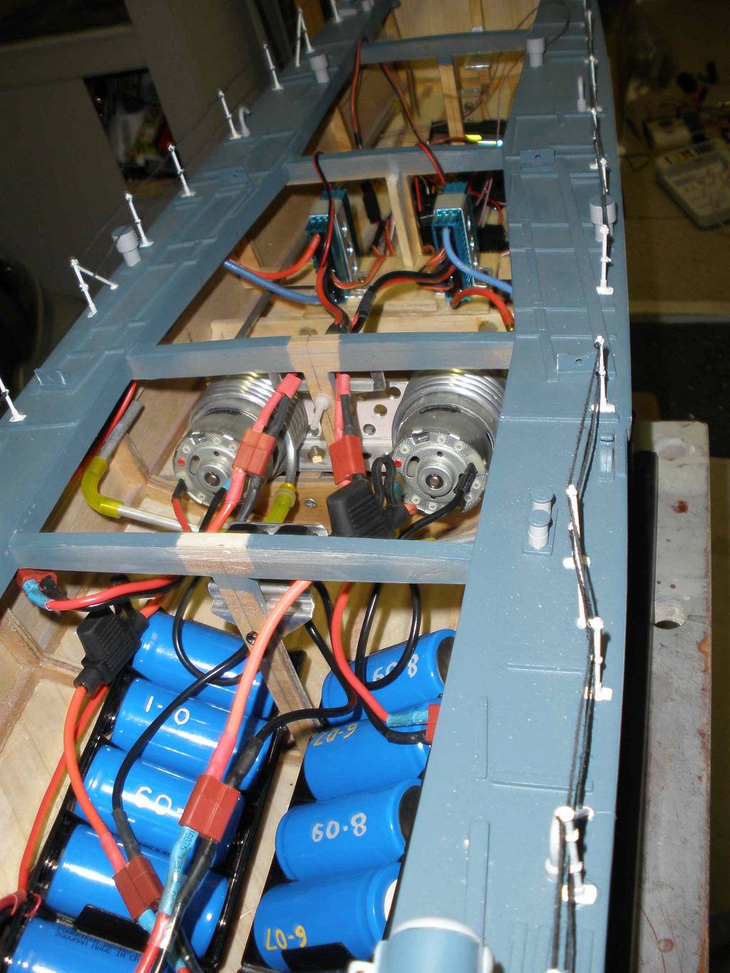

Hi Guys,
I have finally got the internals together in my 1/24 Fairmile D and I was test running the twin motors when one just stopped.
After turning off the circuit and turning it on again the motors work again with no problems, but then suddenly one will stop.
Upon reset and more running everything is fine but then suddenly one will stop. There is no pattern but it is a problem.
All the batteries are fully charged. Each circuit has eight NiMH cells x 9AH. The motors are 700BB (12v)
Both electric motor ciruits are independent. The only common thing is that both ESCs are connected through a Y harness to a single receiver outlet so I can use a single stick throttle.

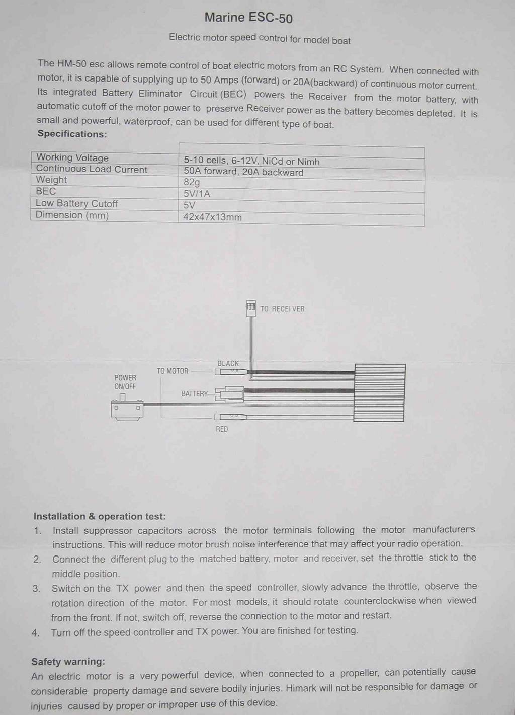

I have attached a copy of the ESC details, and a photo of the inside of the boat. The ESCs BEC is disabled.
I am new to ESCs but have been doing RC boats for a long time. I am looking for some expertise to help me through this problem

Just make sure you are using the 50 amp rating and ensure adequate ventilation.
If you are running in water then you have triggered a safety cutout.Since there is no indication in this,you are left in the dark.Force cooling or reduced battery voltage will confirm if that is the case.
It would also be advisable to measure your current drain which is caused by friction or oversized props.

There is water cooling on the motors, The pros are two bladed 38mm dia. The fuses are currently 15Amp. The ESCs are rated for 50Amp but should not get there
I was testing on the bench and there was no load, no overheating. The system re-starts immediately if you turn off the power and radio receiver and re-start.
The boat has not been in the water.

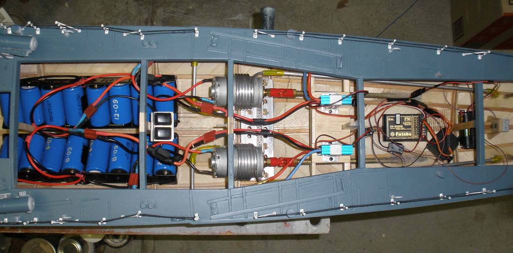

Is the system running on an RX battery AND BECs?
Its normal practice to use either, but not both. If the red signal wire of the ESCs are disconnected by winkling the red wire out and taping back, the ESCs will each draw control power from their respective power battery.
I would consider putting a twist into the motor leads to reduce transmitted interference, in addition to all the previous suggestions.

The BEC is disabled in both ESCs.
I tested the current drain on the motors and at no load 'free running' out of water only 1.3 amps was being indicated on each. The boat has not been in the water. There is no overheating at all.
I have not added suppressors, as the Graupner 700 BBs were supposed to be internally suppressed, according to a previous forum item, and it also said so on the motor instructions. I can add these, but there was no jittering, all runs smooth until one of them stops - either one.

So one esc is disarming? That would be a starting point but I stand by what I said on fitting an external suppressor.
Out of my own interest,does this esc auto-set the neutral at power-up or is it a fixed neutral?

Latest update, and thanks for all the help and ideas so far,
I haven't had time to put the suppressors on (but will do so), but thought I would try a few ideas out.
On one circuit (Port side) with one ESC, the motor ran for at least 5 minutes before I stopped it. Then I turned off the circuit and switched on the Starboard side. It ran similarly. The only thing that got warm were the tubes of the propeller shafts which are fully greased. Both tubes were similar
Then I started again with both circuits on. They ran for nearly two minutes before the starboard stopped. On the next attempt the Port side stopped, this time about a minute running time.
So one thing is clear. They don't like running together. The next is suppression and more testing.

So the esc switches are in the ON postion and their circuitry get their juice from the D cells.Getting somewhere now.
The escs are disarming because the internal circuitry detects low voltage.
Suppress the motors.
It's up to you whether you are willing to try reconnecting centre pins and keeping switches OFFor using a different grade of battery.
The D cells can't maintain enough voltage with a 700bb and no suppressor.

Hi Stmjxxi,
I will add the suppressors tonight (no question), but I flattened the batteries last night with my testing and haven't recharged them pending some helpful info per my previous post with regards to the battery charging.
The main power each of the motors is from 8 x D cells = 9.6V. The power to the ESC's is via a separate receiver battery (4 AA cells ~ 4.8v) so that low main batteries don't cause my radio to stop. I will do as you suggest and run via BEC to correct the transient earthing possibility.
I am trying the two x 8D cell NiMH battery systems as they have a better power to weight ratio than the usual 6V x 7.2 A/H gel batteries that I normally use in the other boats. The 9 A/H rating was also a plus.
Question. Why does the disarming only happen when the two circuits are in operation. Do you think that the receiver power supply - when split via Y harness may be the problem.
Question
I am not sure if I understand this correctly.
What will occur if I connect the BEC wire and keep the ESC switch off It's up to you whether you are willing to try reconnecting centre pins and keeping switches OFF. Power is connected from the main battery and from the receiver. If the switch is off then I assume the power may come via the main battery. Is that correct. Will the radio signal still come through to the ESC.
Question
If you have that center red wire removed from the plug, then the ESC are still getting their
power from the main batteries.
Removing that center wire, OR, leaving the ESC switch OFF, just prevents the BEC from supplying
power to the receiver. If you are running the main batteries down, then the ESC may still be
executing a low power reset when the main battery power drops.
The signal and its baseline come through the white/yellow wire, and the ground(black/brown).

I was not on the same wavelength as you.I tried to find out which battery supplied esc internal circuitry(and the voltage failsafe) and you said you disabled the becs.
Joined: Oct 2007
Posts: 39
From: Avondale HeightsVictoria, AUSTRALIA
A while ago (21Oct2007) I asked this forum how to disable BEC in ESCs. The Thread is 6518113. Even Umi offered some advice.
I did as recommended and disconnected the red wire. I am still learning a lot more about them thanks to all the comments.
Question.
Why does either circuit work without problem if only one is in operation, yet has random dropouts "disarming", if both circuits are put into operation?
If it is down to the D cells, then the ESC should drop out even if only one circuit is working.
In last night's testing I ran each circuit separately - right down to stopping (ie low battery) but neither ESC cut out.
The ESC's only work with the ESC switch turned on.
There is a copy of the ESC's instruction sheet with the original thread. Worth a review.
I thought that the NiMH batteries were the best for the purpose (apart from the LiPO), is this not the case?
Is there a better way to disable the BEC? or not have the main batteries to power the ESC circuitry

Yup,I read through the instructions.
All I can add is that ,if it was dropped on my workbench,I could have sorted it out while being on the stopclock.
For now,I would ignore the fact that they individually worked ok.
That depends on where the switch is connected and what bec component is used.There are ways of finding out but have you got the inclinationright now?
