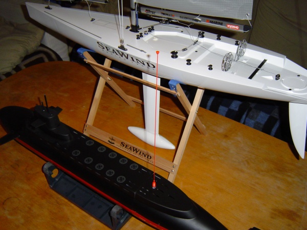

Your welcome junglelord!
You only get better by jumping into it and getting experiance
I fear that summer wil be a while from now......still snow, and ice on the lakes/pond [>:]
And yes it is the speed controle. But it realy isn`t very good.
Even though it is electronic, it increases speeds in small "steps"
My cheaper airplane speed controls have stepless, or smoothe regulating speed.......but they dont run backwards [8D]
But it should work for my aplication.

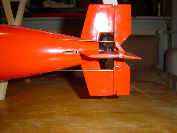

Just installed a whip antenna....dont want range problems.
maybe ill paint it if it strains my eyes too much in red [8D]
Also took a picture of the controle links on the underside of the bouat.

thanks for the pics SJN, and encouragement. i have a airplane speedcontrol (no reverse) but i may use it anyway. is your battery 6volts 5amps?
is your front dive plane RC? ARE U using the dynamic dive or going static? if static what system will you use?

Yes, it is the stock 6V 5Ah batt...
my front dive planes are "fixed". They have got a dab of CA glue to hold them in place, as I dont know what angle I should pre set them.
I can only controle the rudder and "elevator" or what you call it :-) at the rear .
Ill try and see how it goes.
I have deviated from the plan, and have glued my nose section permenantly on......so if I want to make the dive planes RC, then ill have to cut a new hatch in the bottom..
But lets see how it performes :-)
