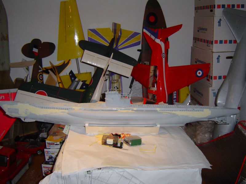

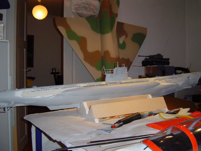

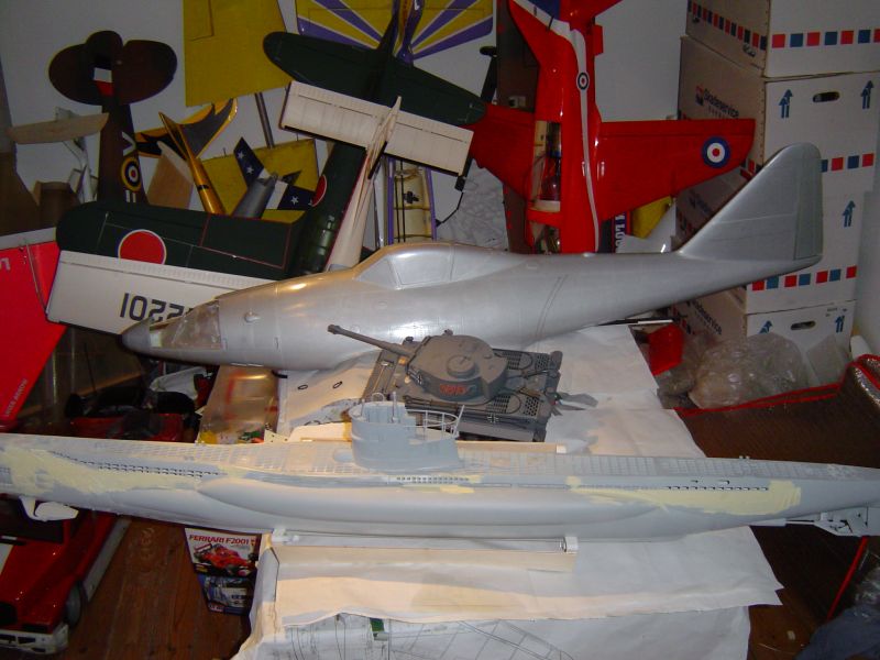

I am building the robbe U-47 VIIB, and i thought about making it a little scale. I found some original pictures of it, and began modding my kit. Then I found some more pictures, but coudld not understand why it had changend apearance..... then i found some more pics, and it looked different again
It seems that the submarines where updated and modified during their short lives every few months........ not making it easy to do a scale job
here are some pics of mine at the moment
