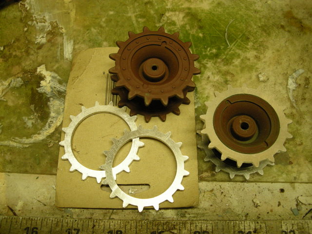

Another small step forward. i received the adapter rings i ordered from Daryl Turner. These rings reduce the overall diameter of the KV-1 sprocket to the IS-2 sized sprocket. It seemed like a small detail but i wanted to strive for a close resemblance. I have turned the KV-1 sprockets to accept the adapter rings (see photos) one photo shows the new ring in front of a stock KV-1 sprocket so yo can see the small difference in overall diameter. I have made a new hub cap assembly which i will add later. The rings will be J-B welded to the turned hub and should have more the sufficient strength t keep up with rough treatment. In a previous post i showed my version of a reconfigured HL recoil similar to what either yellowshaker or bubbajoex made some time ago. I have mounted the turret drive so this puts me closer to finishing the turret. i hope to actually get this tank finished this month but life keeps throwing small obstacles at me.

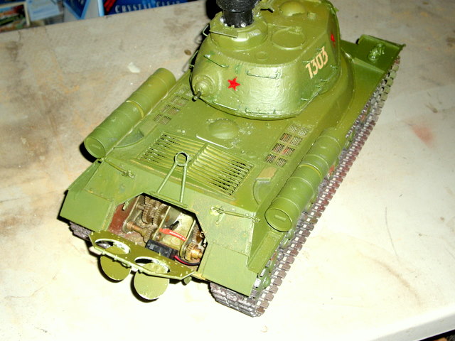

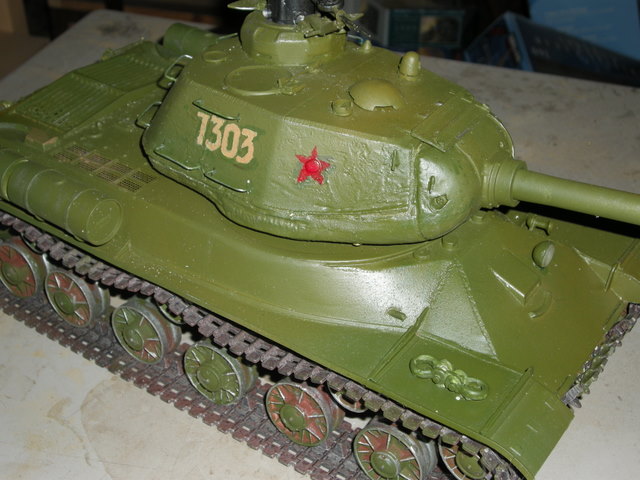

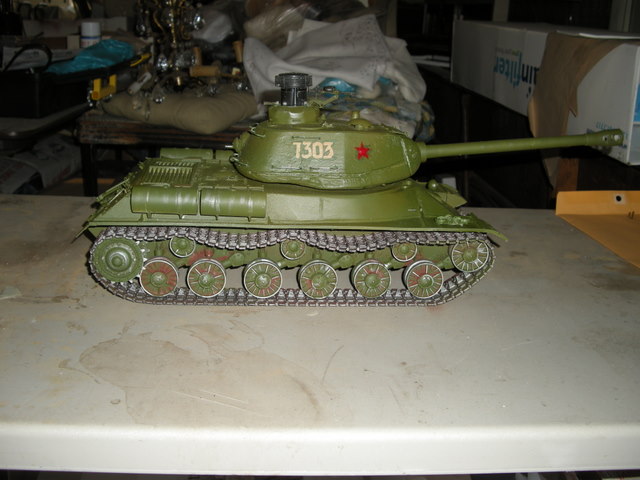

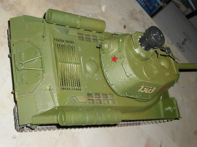

Well it only took a year but here it is ready for field trials. not my best work but it should be a good fighter. I ended up using Tamiya instead of El-Mod electronics

<span lang="en" id="result_box"><span class="hps">This is a</span> <span class="hps">really</span> <span class="hps">great job</span><span>.</span>
<span class="hps">But you</span> <span class="hps">are wrong</span><span>, arguing that</span> <span class="hps">this work is</span> <span class="hps">better than the original</span><span>.</span> <span class="hps">Two small</span> <span class="hps">remarks</span>
<span class="hps">1</span><span>.</span> <span class="hps">JS -2</span> <span class="hps">did not have a</span> <span class="hps">periscope sight</span> <span class="hps">like the</span> <span class="hps atn">KV-</span><span>1 or</span> <span class="hps atn">KV-</span><span>85 on</span> <span class="hps">the turret.</span> <span class="hps">This tank</span> <span class="hps">has</span>5<span class="hps"><span id="result_box" class="short_text" lang="en"><span class="hps">externally</span></span>identical</span> <span class="hps">periscope</span><span class="hps"><span id="result_box" class="short_text" lang="en"><span class="hps">review-</span></span>sighting</span> <span class="hps">device.</span>
<span class="hps">2</span><span>.</span> </span><span lang="en" id="result_box"><span class="hps">Turret</span></span><span lang="en" id="result_box"> <span class="hps">JS -2</span> <span class="hps">has</span> <span class="hps">no</span> <span class="hps">small</span> <span class="hps">hatch</span> <span class="hps">eject spent cartridges</span><span>.</span> <span class="hps">This</span> <span class="hps">hatch was</span> <span class="hps">on the </span></span><span lang="en" id="result_box"><span class="hps">turret</span></span><span lang="en" id="result_box"> <span class="hps">KV -85</span></span>

To me, the best thing about your build is the hinged engine compartment hatches at the rear. That is something most guys wouldn't bother to do. Nice touch!
