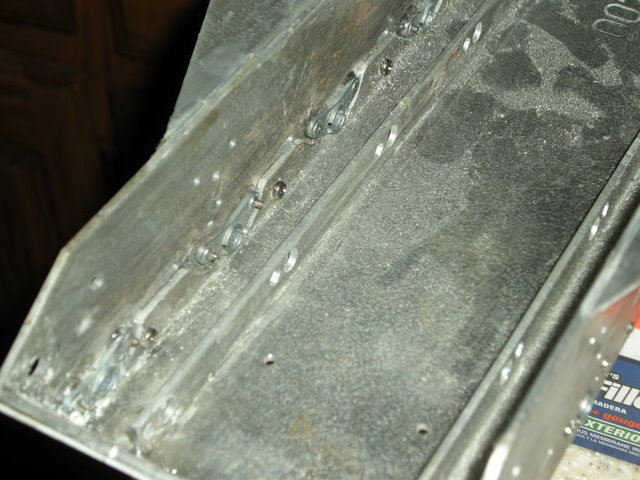

here are a couple of pics about the hull build. not much to shout about but if you love working with epoxy [:'(] then you will have fun with this.
I found out that the kit maker had used the Asiatam KV hull parts for details such as the swing arm bearings, bump stops, torsion bars, return wheel mounts track adjuster, etc. I had a lot of Tamiya stuff (torsion bars, swing arm bearings on hand so i started modifying as i went. I just received a parts tree from tamiya to copy into resin parts for some of these details. I just primed the lower hull and a bunch of metal parts today so i hope to do a bit more soon.
I am also starting to prepare molds for lots of different details plus have feelers out to get some sprocket adapters built as the IS and KV sprockets are different in diameter

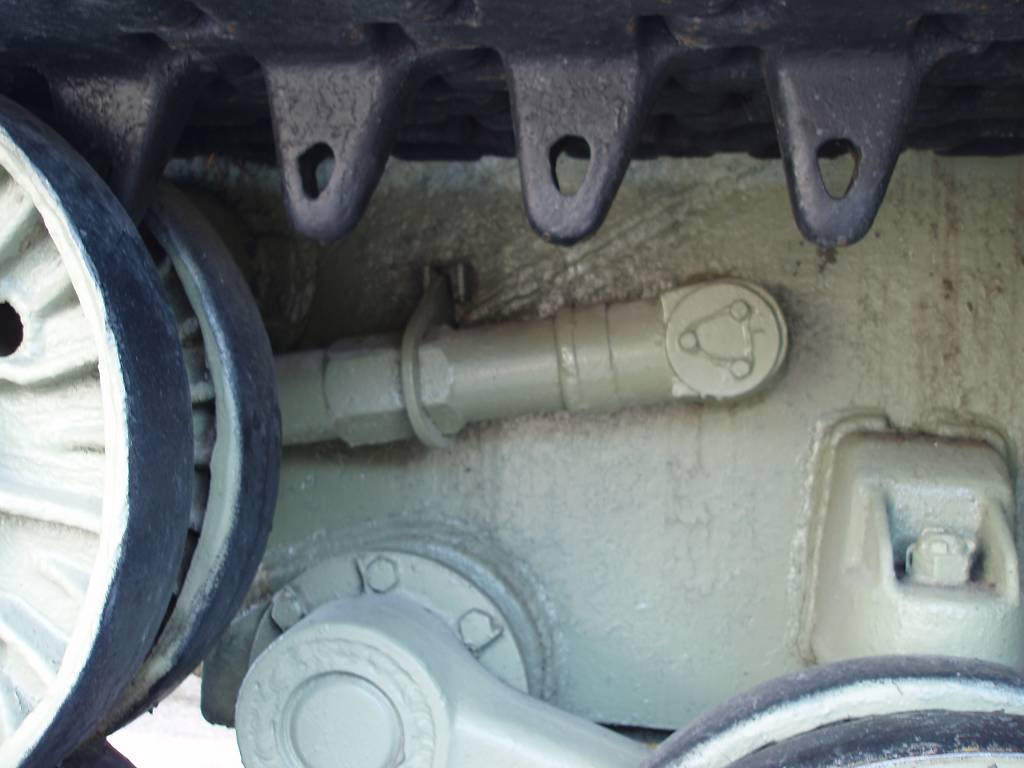

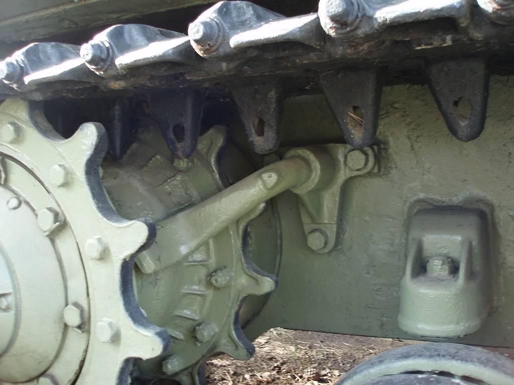

In the mean time i need some help. Does anyone know where i can view the idler adjustment and how it actually touches the idler arm? i know what the adjuster looks like and that it sits at a different angle then the KVs but as to the view, at the point that the arm couples to the adjuster screw, i have no clue.

Here's what I have on the idler for the JS in Sevastopol. Let me know if you need more, and VCO and I will pop over there.

ok i see how it attaches now. thanks

Not a problem. The sad thing about this JS is it, like all the others at Museum, were runners when installed on their plinths. They were then neglected for 50 years, and of course will never run again.
