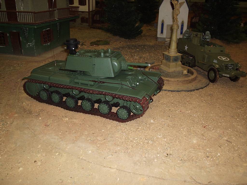

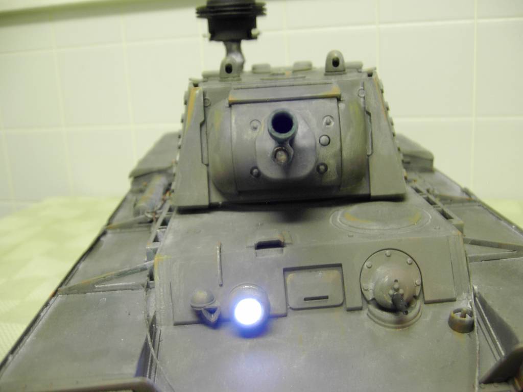

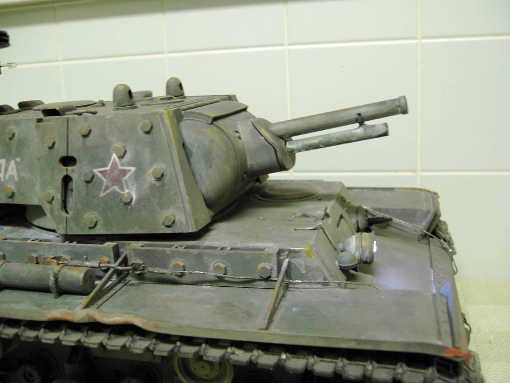

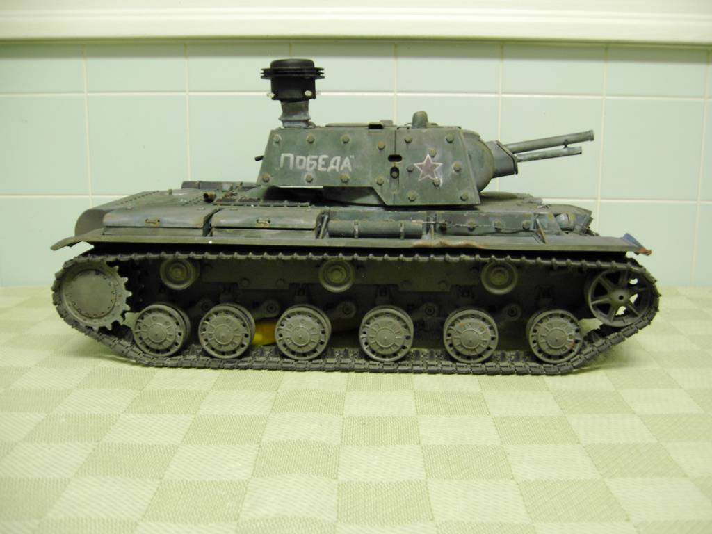

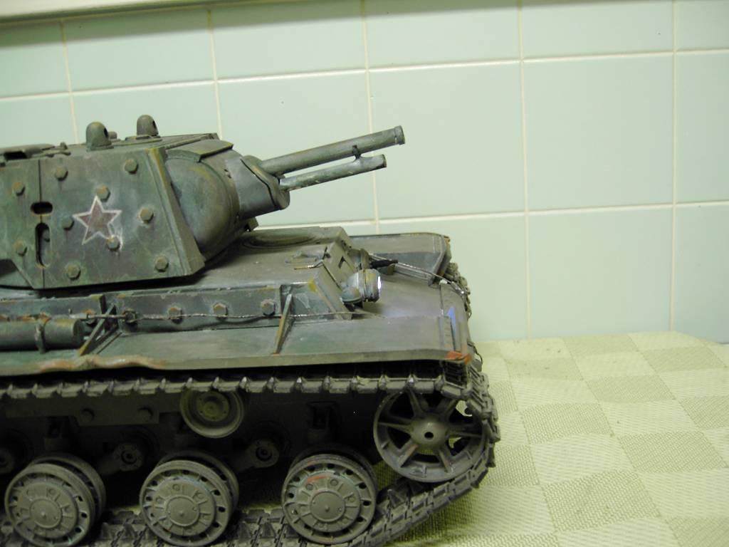

The KV-1 is sporting a new look tonight just finished installing a DBU system (Thanks Tim )
we will have to try it out on battle day in august
hope the way i installed it is ok i put the IR LED in another tube looks like a double barrel
+ i wanted to keep my airsoft
Question, does the Apple have to be Black can i paint it the green and match the tank?
i did just the base to give it a different look

Looks pretty nice. You can simply put the IR LED in the mantlet and do away with the second tube. looks a bit strange.

You can paint it, just be carefull not to get paint on the sensor windows.

punch out the LED for the airsoft gun and put the IR led in there. Mount it in a tube with the tip of the IR emitter recessed 9mm from the end of the tube.
You can also mount your receiver in a hatch. Paint it if you wish, just don't block the window to the receivers.

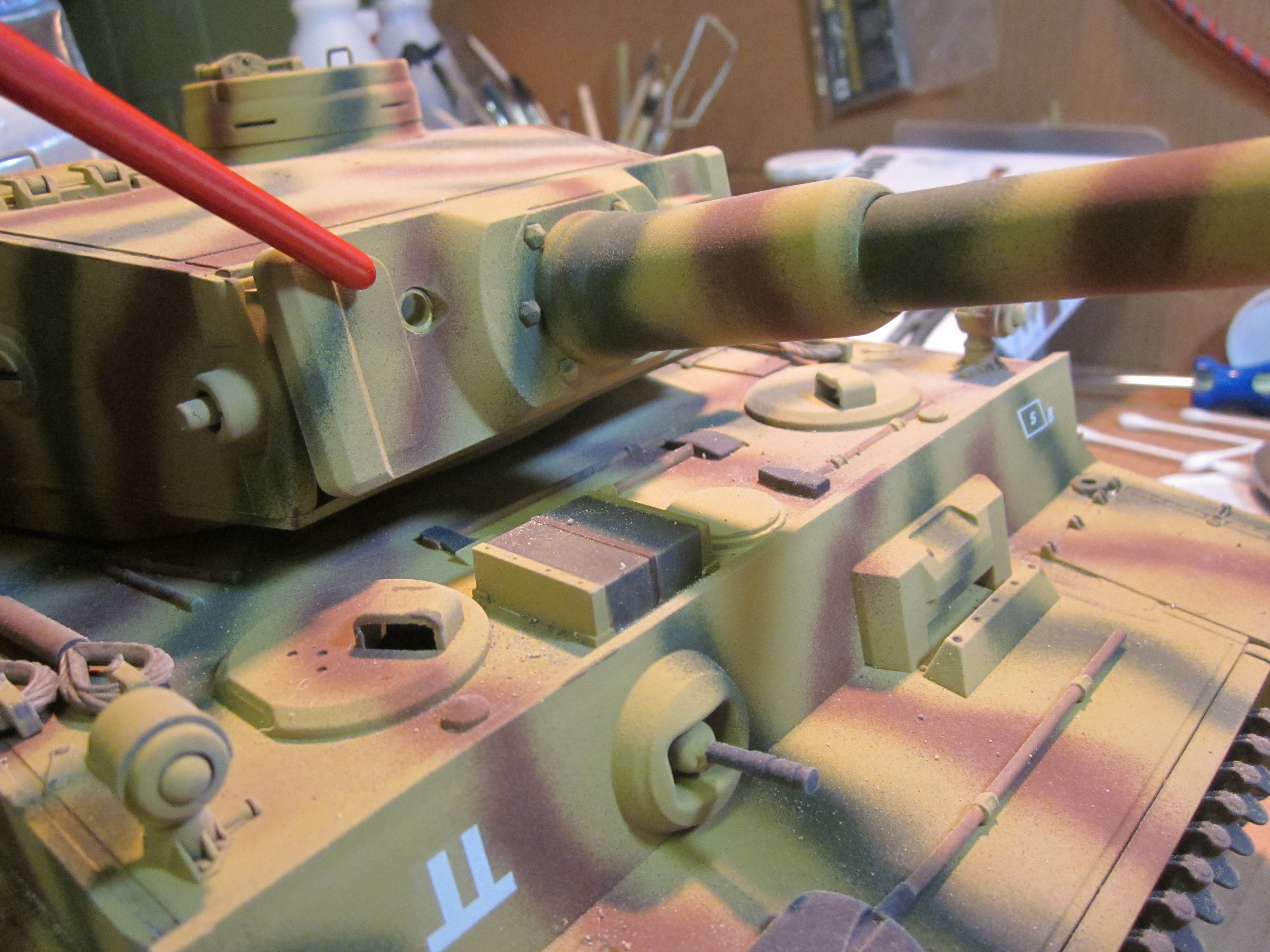

ORIGINAL: Fireman Tim

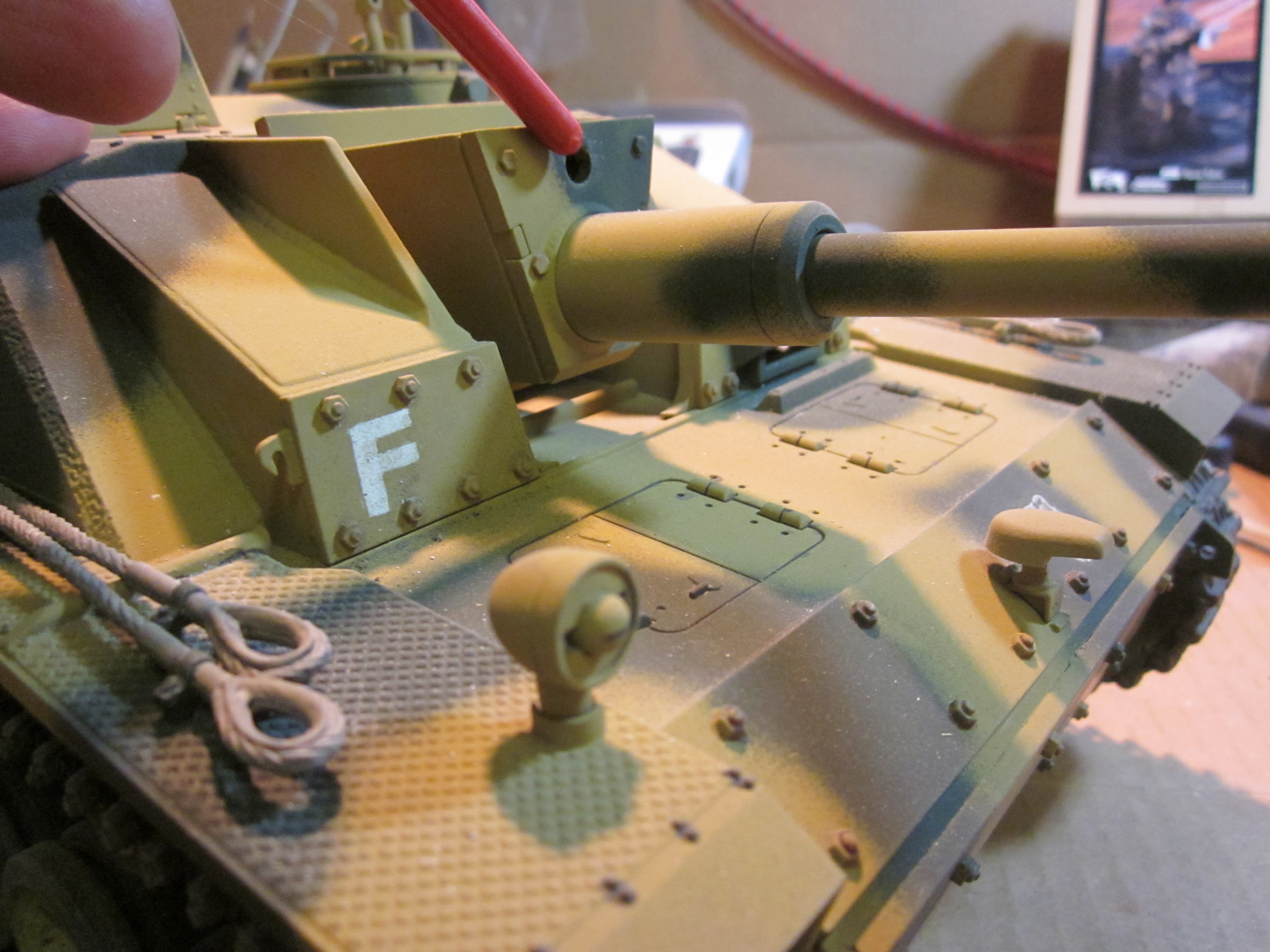

Here's a couple pictures of what Tim is refering to, one is my DBC Stug III, the other is my lastest, the Tiger I with an SLU.
The red paint brush handle is pointed towards the emitter in both pictures.

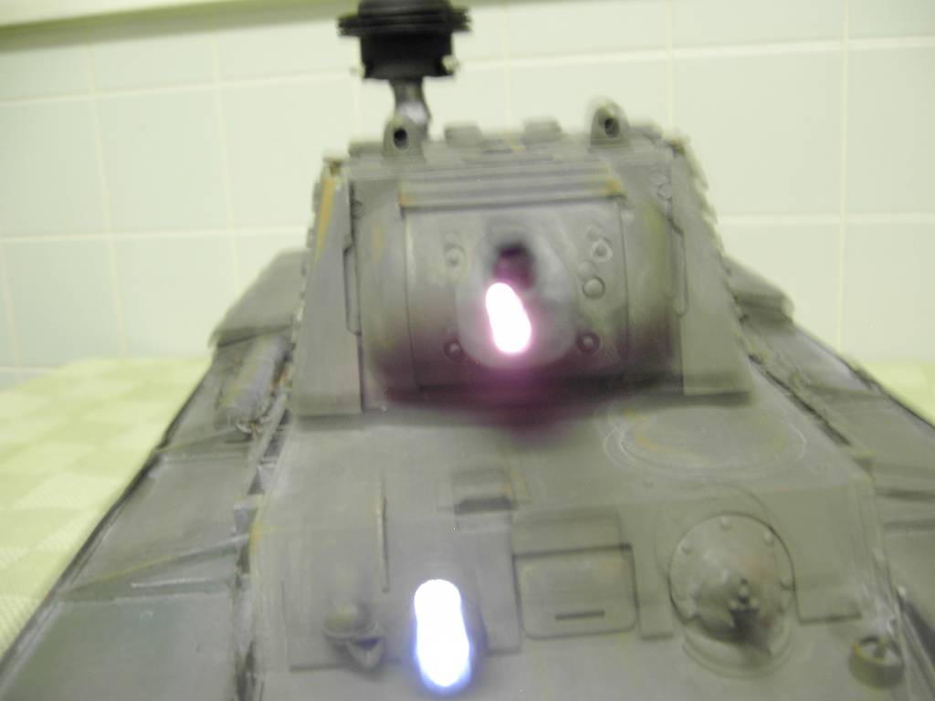

Greg,
Thanks Guys
i might leave it like it is for now you know me i might change it 50 times later on...lol
i had no room to put it in the hatch the airsoft gun and motor are right there i kind of went with what i seen on what Thecommanders had on his only thing is i made mine look like another gun

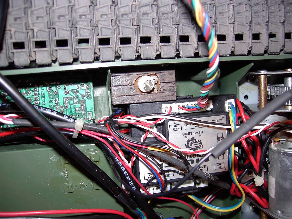

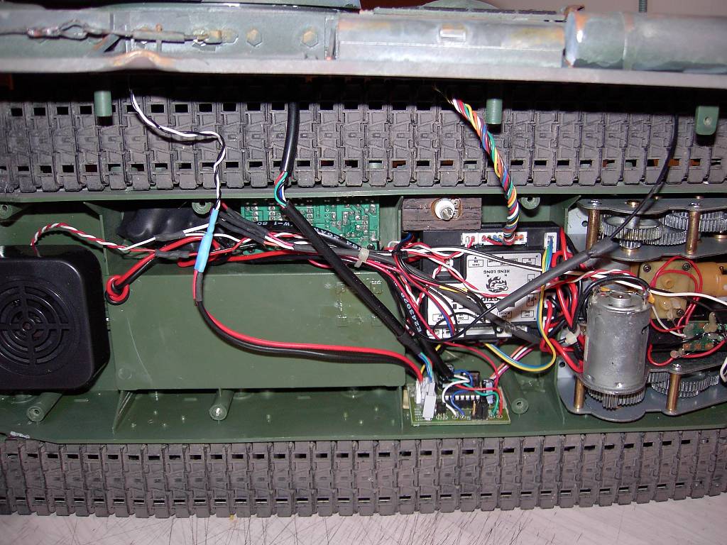

here is my system hooked up i couldn't reach where the old volume control went so i used and ammo box from the Pershing and glued itto the side of the hullto set the new one in, i just make sure it's up all the way before iput it back together

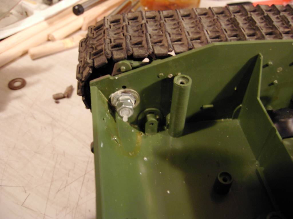

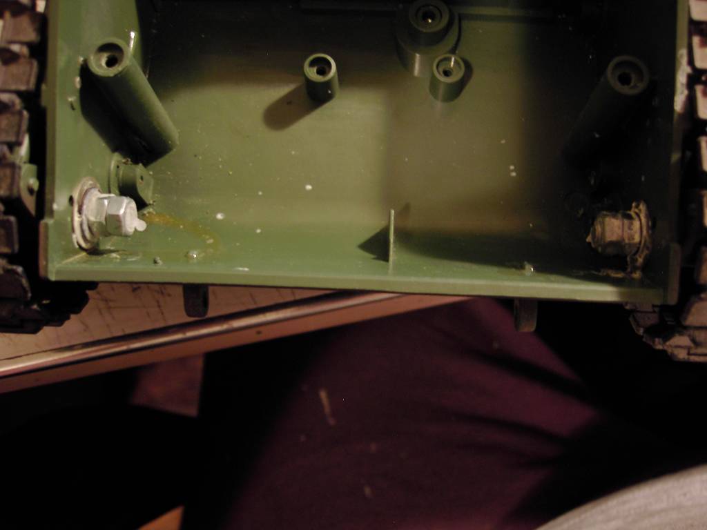

just finished doing the bolts through the idler wheels on the KV-1
hope this will be better

You saved me the trouble of posting the pic of my HL DBU KV1...thanks. This was the first DBU tank at the Danville battlefield and it scored several kills that weekend along with Steve's (AKA Shenlonco) DBU Walker, which is also brought with me. Steve has not made it there yet. But I'm still trying to get him down there. As you found out the "Apple" can't be put at the hatch and the remember also, the HL KV has NO depression. You will notice my emitter points downward to impart some depression which is a must for my battle style. ALL Danville tank emitters MUST have a emmiter shroud (internal or external) to constrict the IR beam. If not friendly fire issues from the shotgun effect will be an problem. I have been mounting the IR emmiters in the LED & HL IR emitters for 2 years now. Be forewarned the stock HL KV with DBU has very little power or turning ablility when burdened with 7 or 8 hits.
