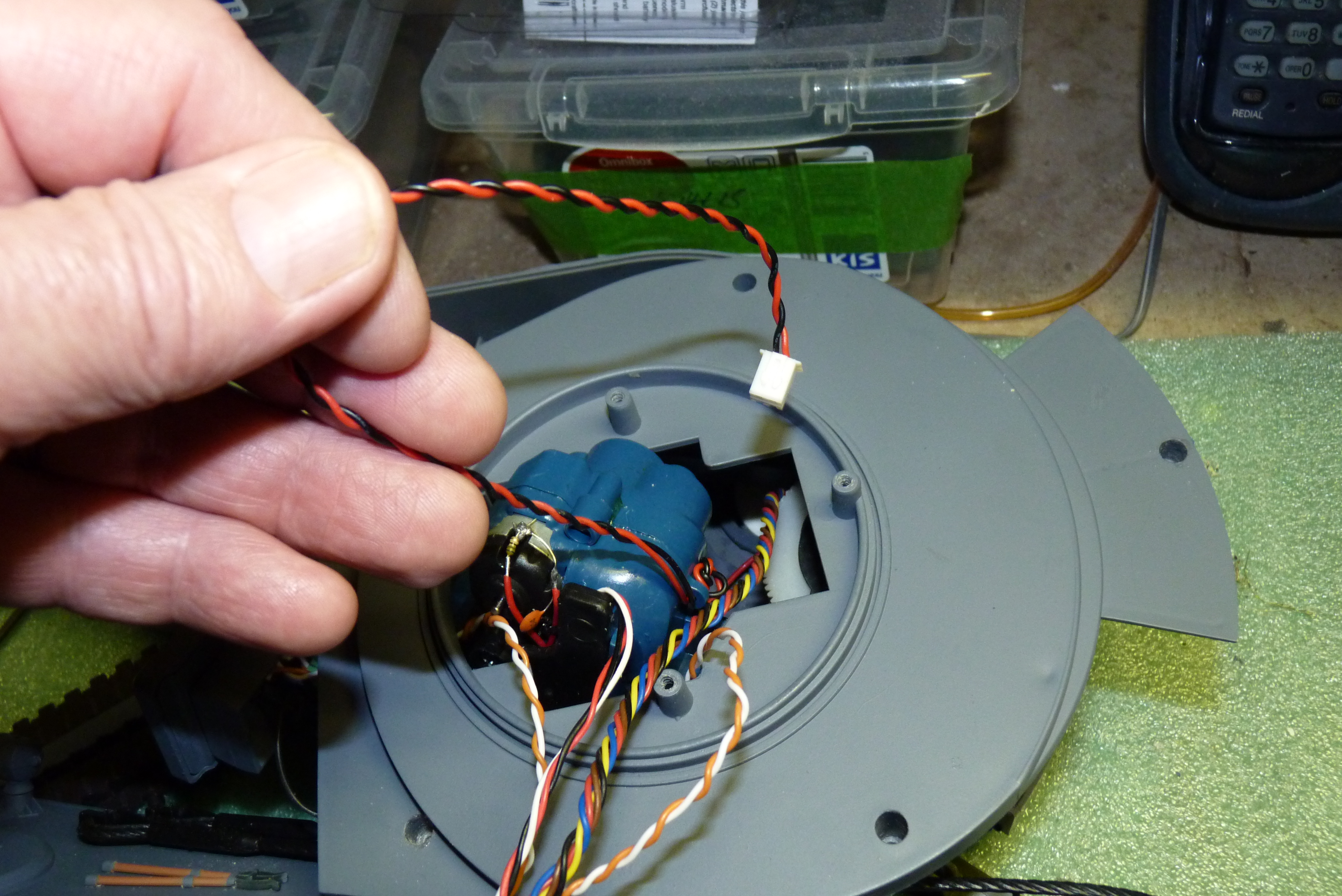

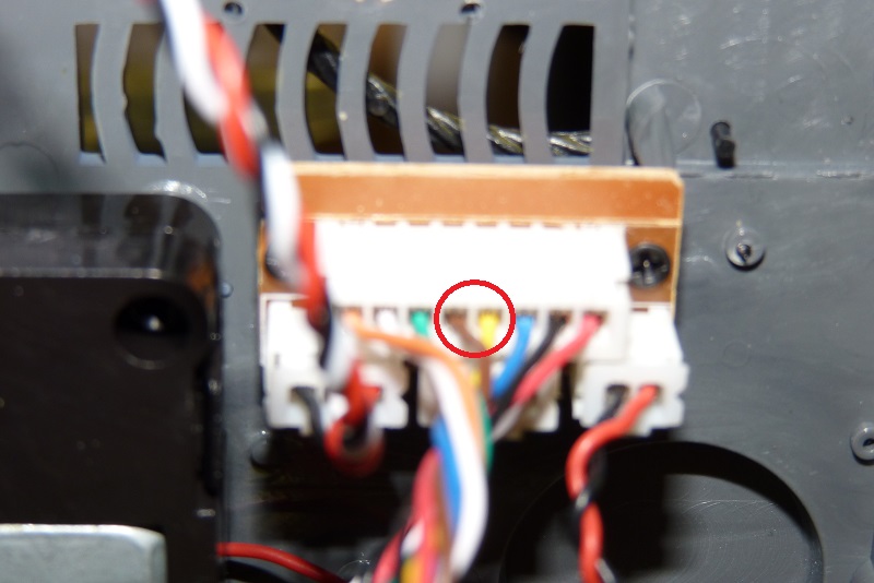

I have installed a DBC3 in my HL tiger 1 and all is working well except that I have no gun elevation.

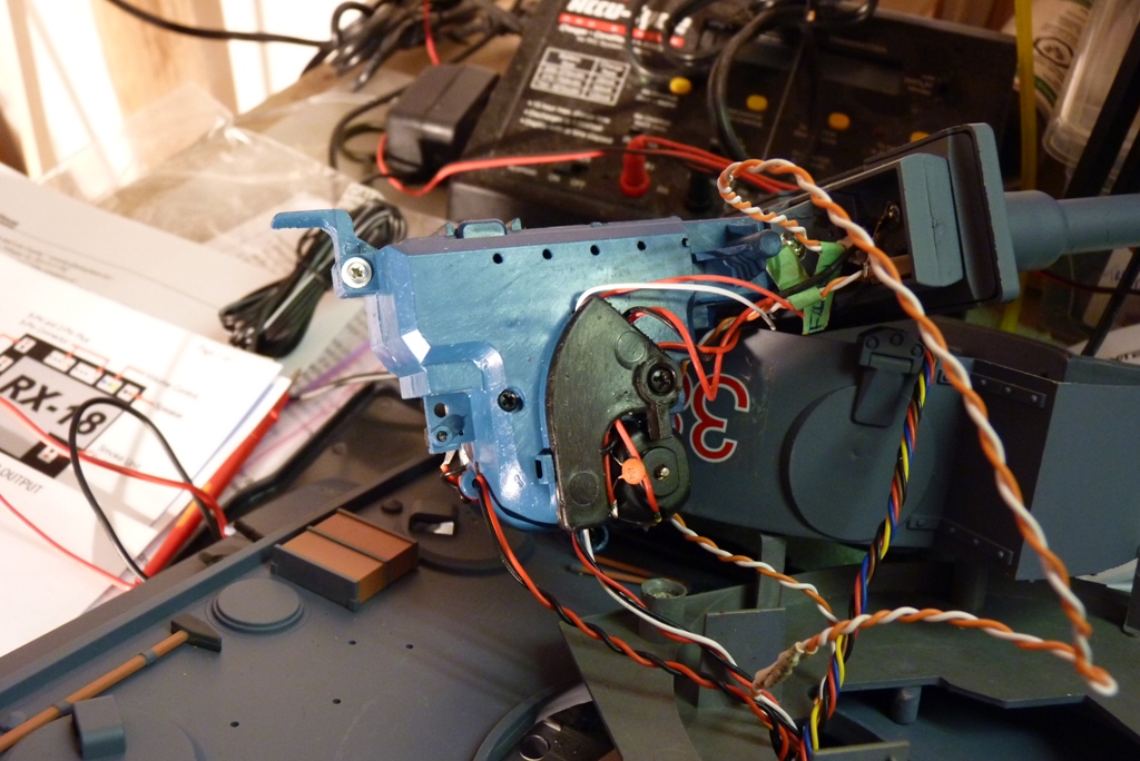

In picture #4 you can see the red/black wire with a 2 pin connector that I cannot find a connection for. The wire comes from the bottom of the elevation motor and I cannot see anywhere that it would hook up.
Can anyone help the newbie out with this????

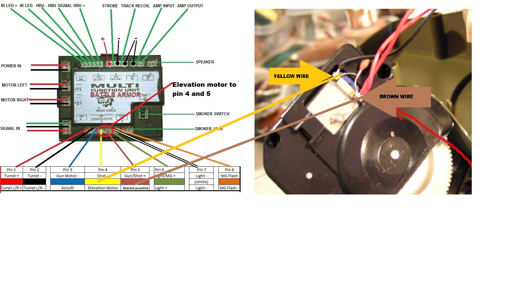

The elevation motor has to be connected to the RX 18. You can either connect them directly to the RX18 or to the yellow and brown wire I have circled. Do the same kind of thing you did when you joined the Blue wire. Pull the yellow and brown wire from the harness and connect them directly to the wire you have in your hand. As long as those wires in your hand are going directly to the elevation motor

I have unhooked the yellow and brown from the 5 pin hull plug .I tried yellow to red and brown to black and nothing. Did the reverse and still nothing!

Well that is a mystery then. The Brown wire is Positive and the yellow wire is negative. It should make no difference how you hook them up to the red and Black. The Heng long elevation is a cam and is happy turning either way.
Tell me what you did once these wires are hooked up. Down on the left stick should should cycle the elevation motor. Are you are absolutely sure the wires you have in you hand are connected to the poles on the elevation motor and are not connected to an LED or something?. I haven't bought a new Heng Long in a while and have never experienced the elevation motor with a dedicated two pin connection like you are holding. That is why I am asking, are you sure those wires are hooked up to the elevation motor.
If you have another low amp motor hook it up to the brown and yellow wire, or of course a volt meter would help to make sure you have power to those pins.

I think the two pin wire you are holding in the 4th picture is the recoil wire. Can you check and see if that wire is connected to the airsoft unit (blue plastic) for me? If so then that will connect the the motherboard.

There are two red/black wire sets coming off the gun. One runs back to the turret motor which is working fine and the one I have in my hand which comes from the bottom of the gun which goes??????

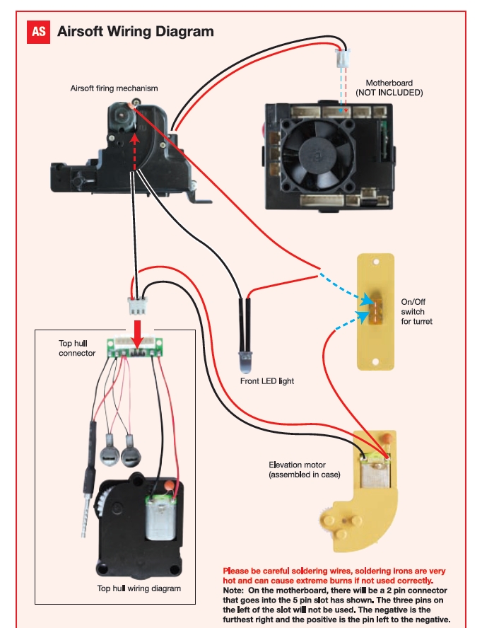

Let me know if this helps. This is the airsoft wiring diagram from our kit manual. It should be very similar to yours except for the top hull wiring connectors. The two wires at the very top left going into the motherboard are for the recoil in the RX18.

Ok on the first post, 4th picture you are definitely holding the recoil wire for the airsoft unit (the blue big piece of plastic). In the picture I see above the wire on the left is the same as the 1st post 4th picture. That is a contact switch. If you start the tank and hold them together then it will recoil and jerk until you separate the wires. On the right picture of the quote I see the airsoft unit, but no where do I see the elevation unit. Could you get us a picture of the elevation unit and the wires please? Also the on/off switch if you have one please too.

AS you can see from the diagram it is fairly straightforward but the connection after the hull plug is something I can't find . Here are a few more pictures that may help. If any others are required just let me know.

Simply find the two wires that come from the elevation motor and connect them to the yellow and brown wire.

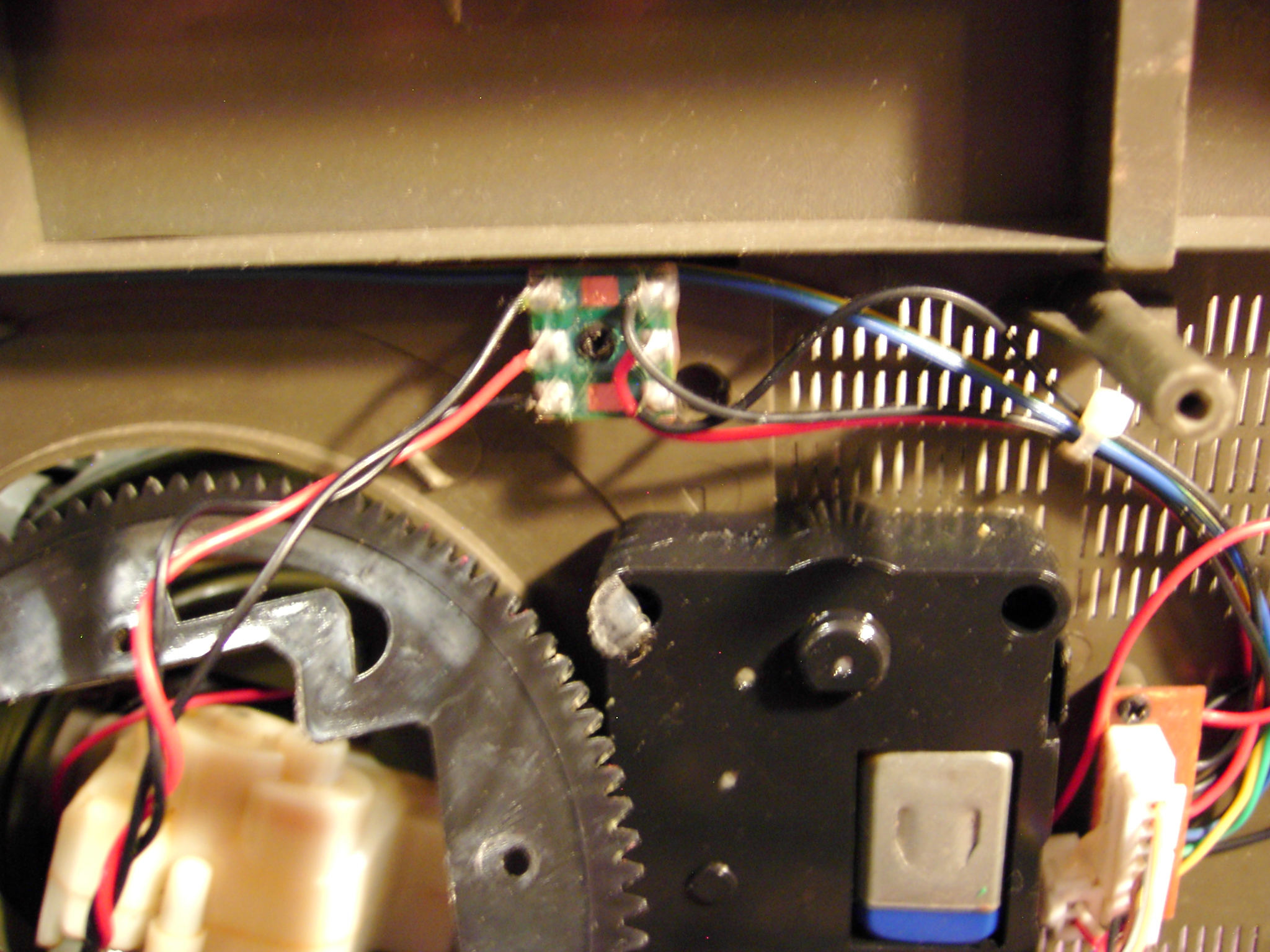

taking my Pershing apart see how it is wired
Old 03-07-2014 | 07:16 PM
Airbrushler's Avatar
Joined: Apr 2011
Posts: 3,813
Received 15 Likes on 10 Posts
From: Windsor, ON, CANADA
ok Eph322 here are some pics from the inside of my pershing hope it helps

In its simplest form hook up the yellow and brown wire to the elevation motor as I have indicated.
