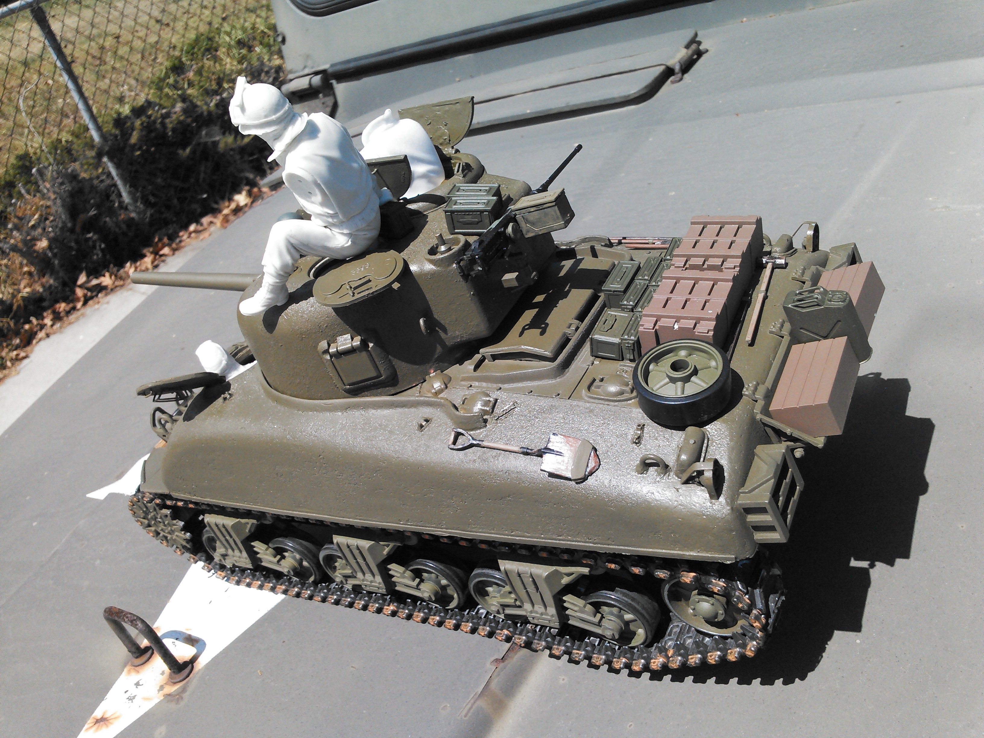

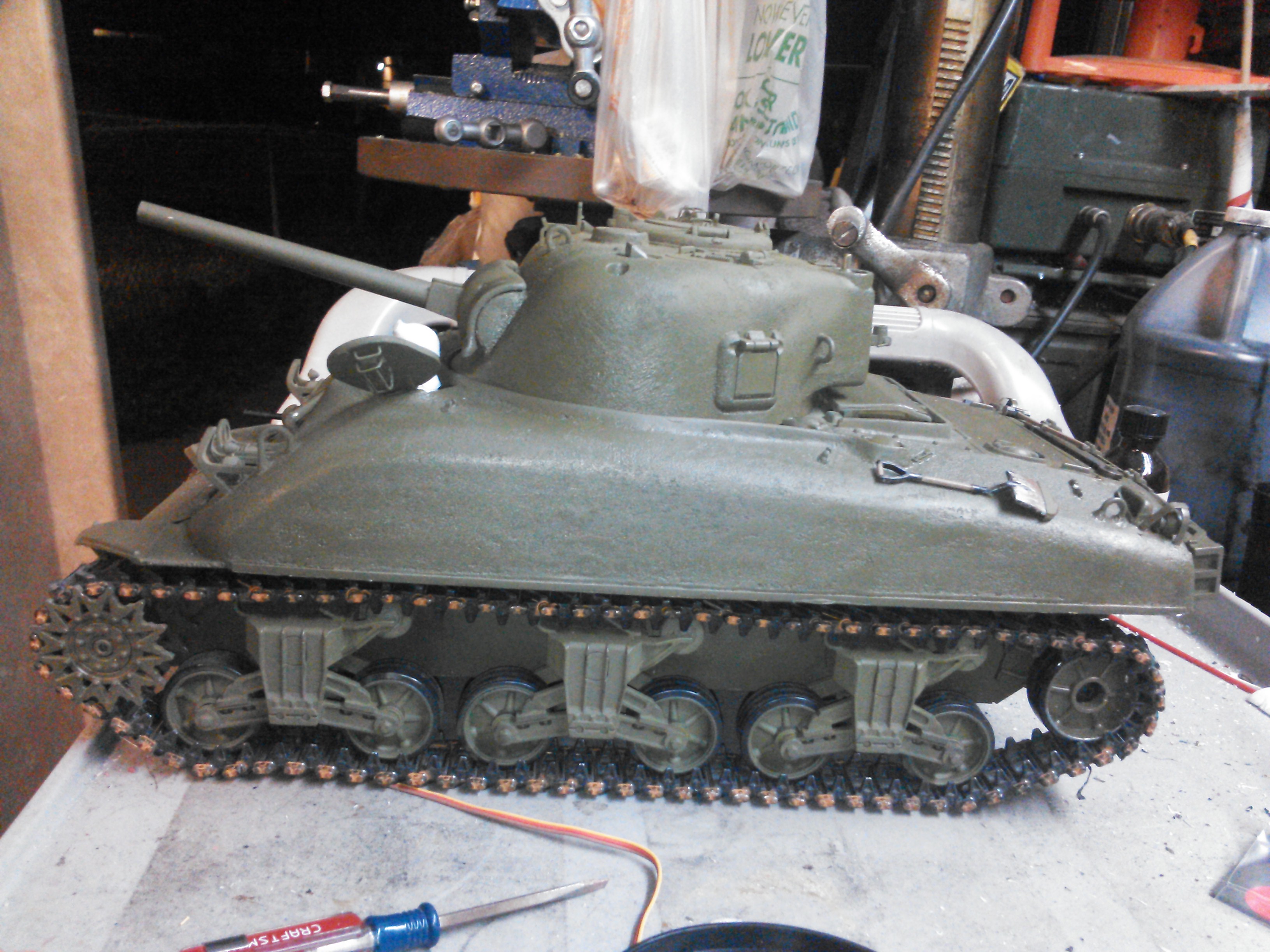

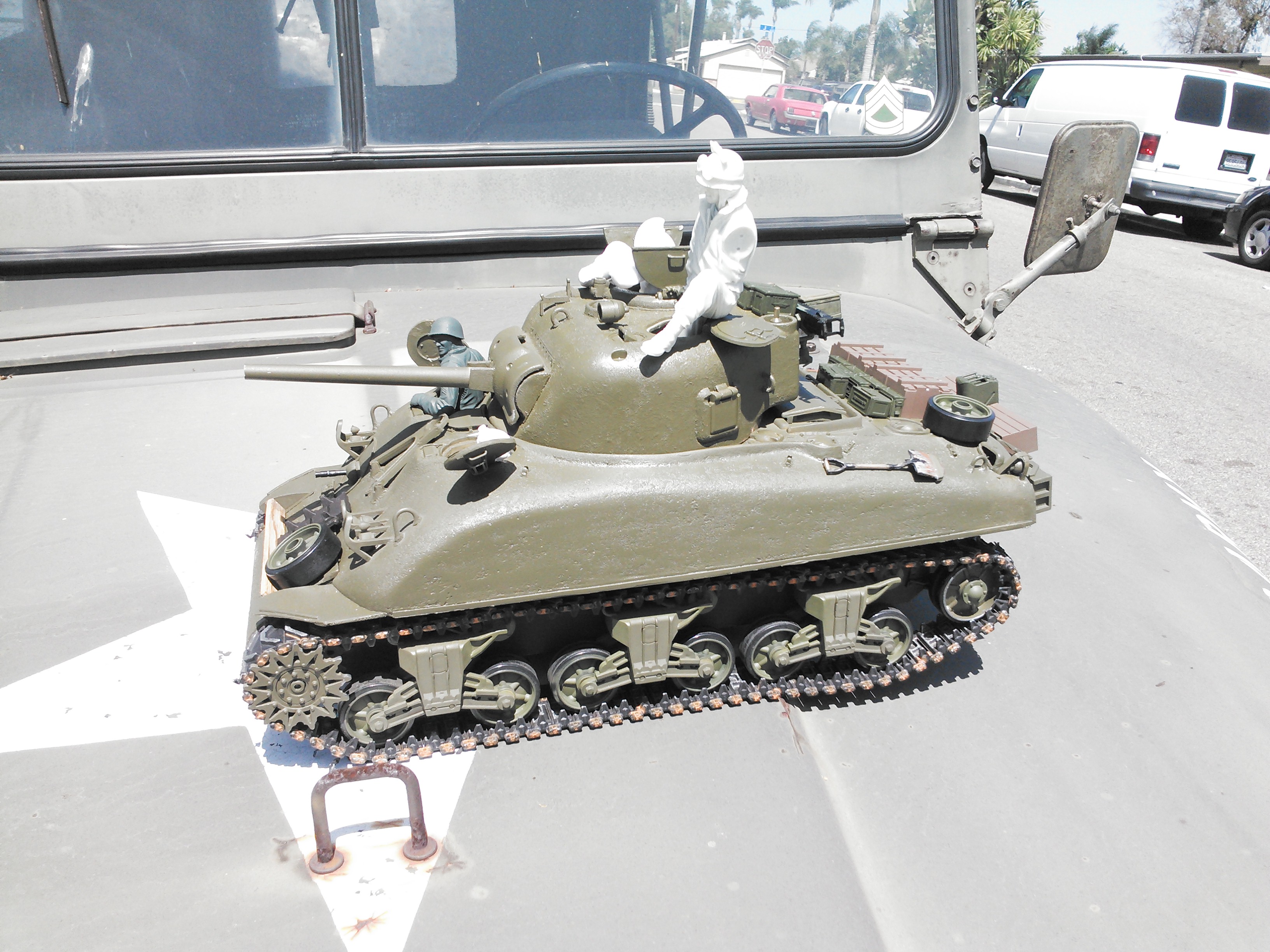

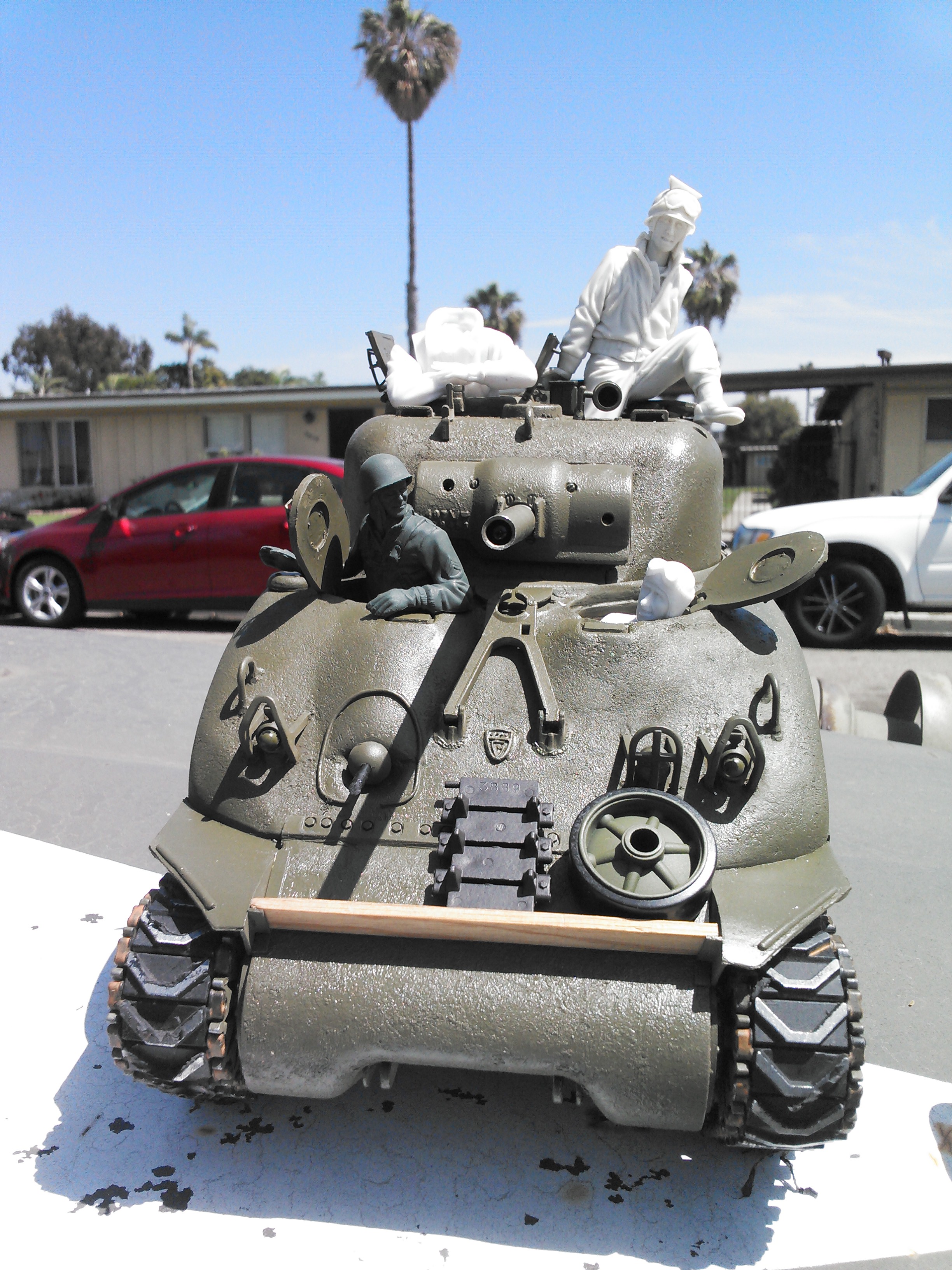

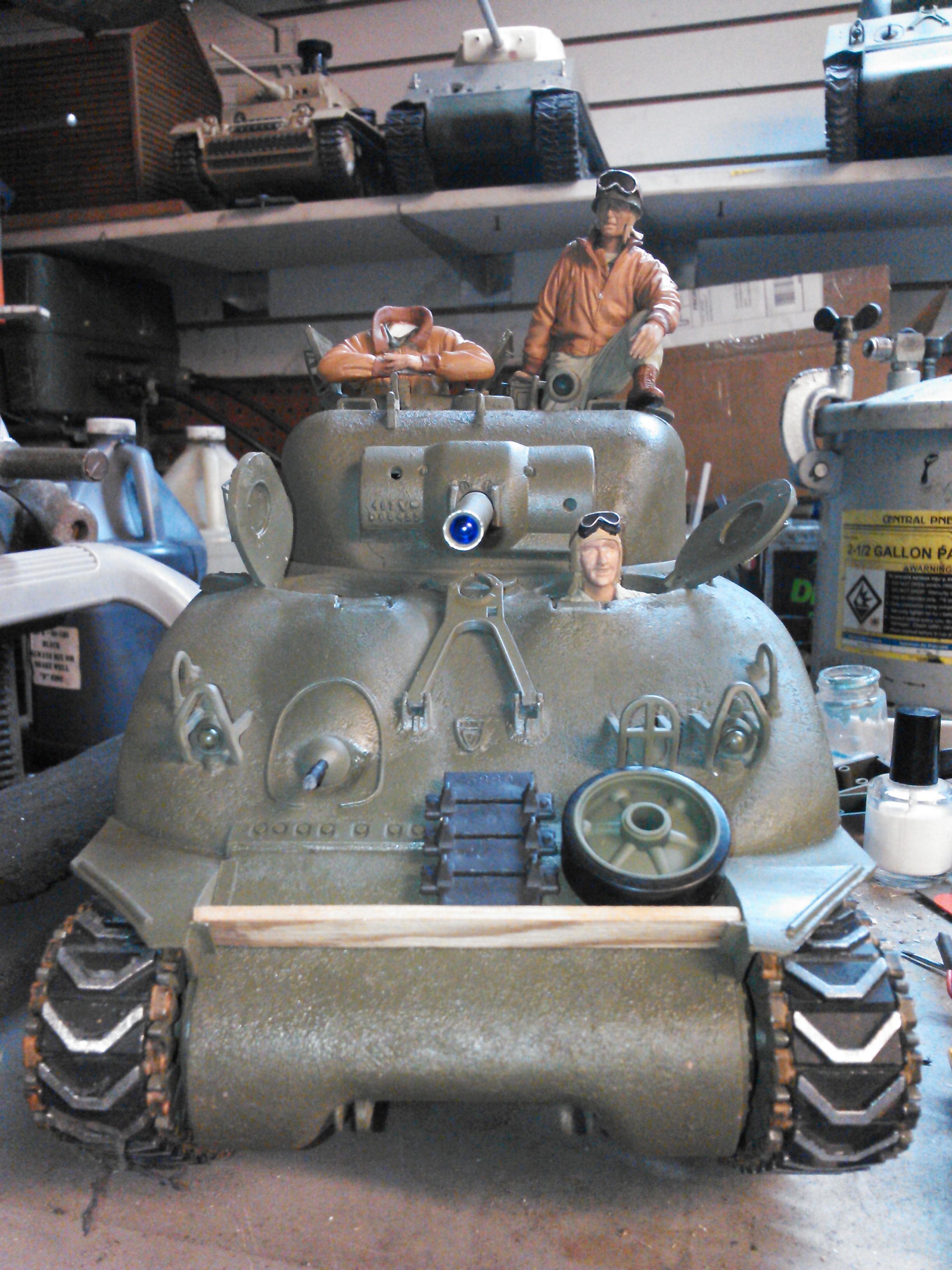

Any way, a few photos overall with my driver siting in the tank, He has to be sat in place by lifting the body because his shoulders are too wide to drop through the hatch. He sits right on top of the relocated on off switch. He, and my other figures are made by Sol model of Korea.

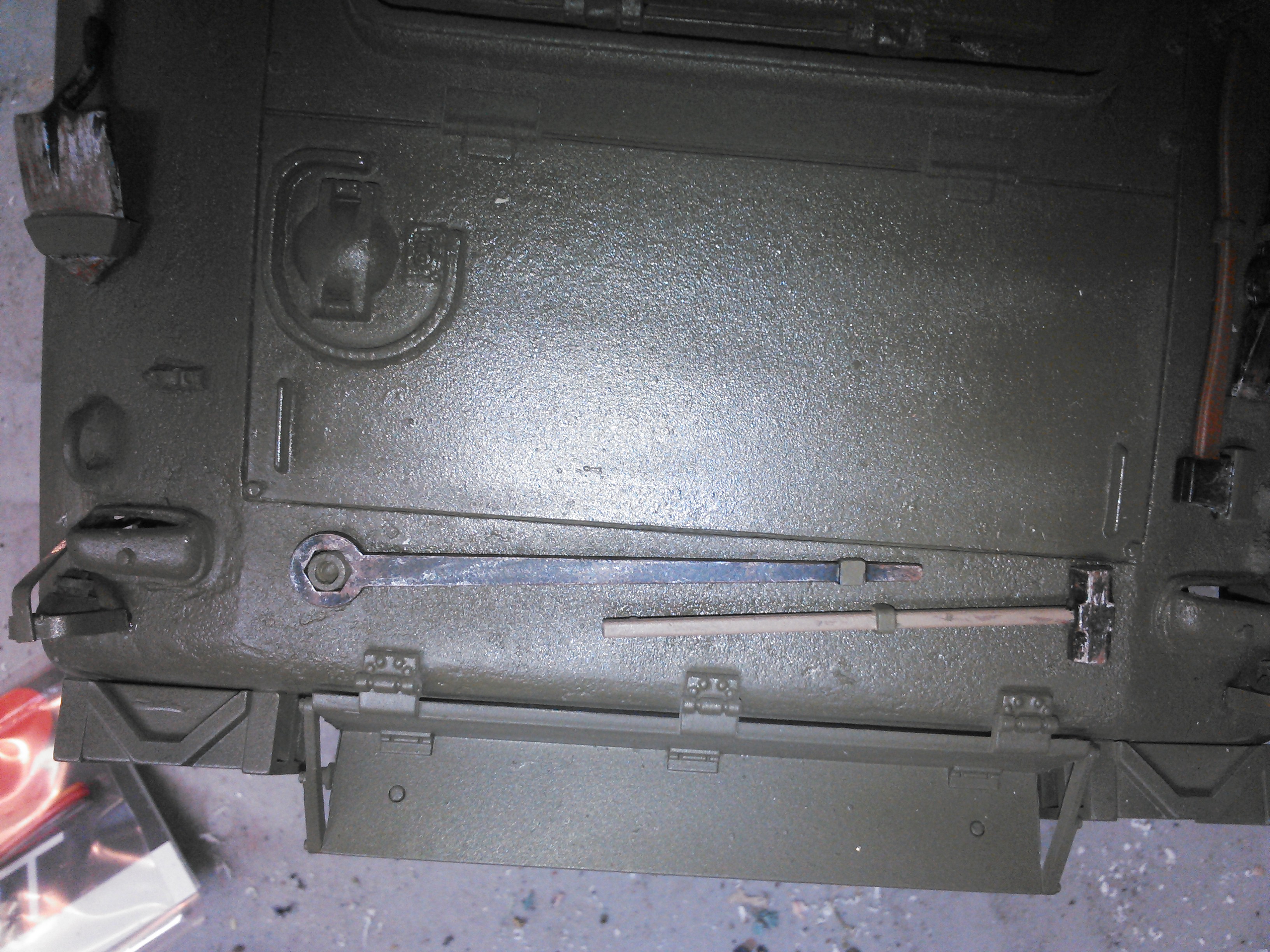

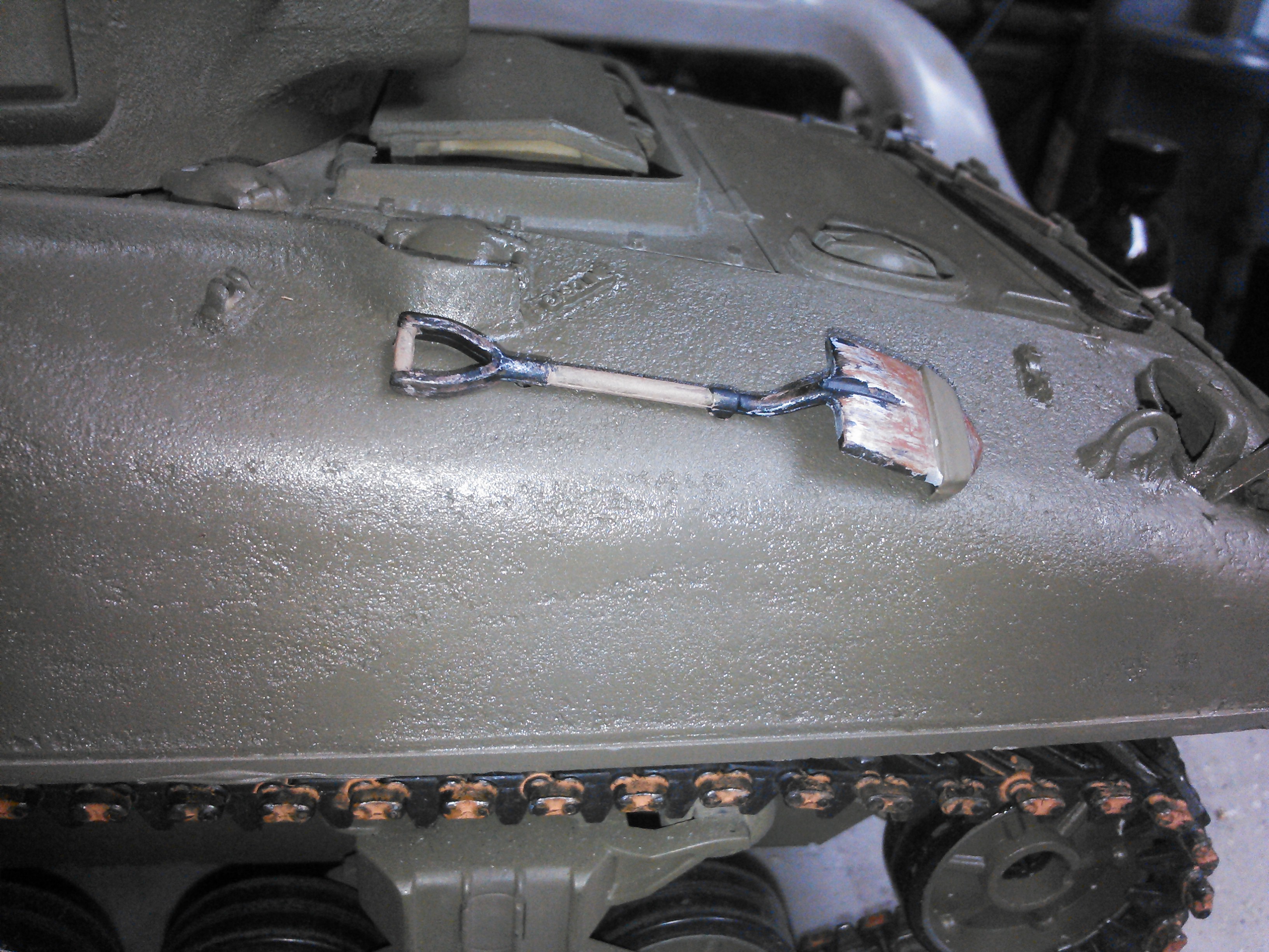

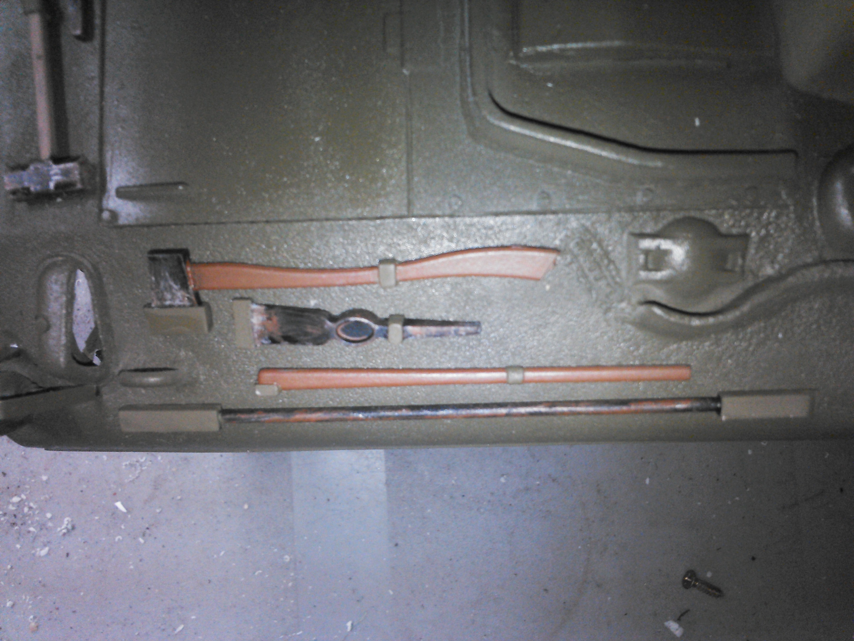

TOOLS, I painted weathered and mounted the tools. Lighting aint so great but you get the idea.

Because everybody likes pictures, heres a quick picture of my progress on the figures. Nearly done painting. Im not all that great without perfect references but lots of reviewing Fury pics to help me and the box pictures.

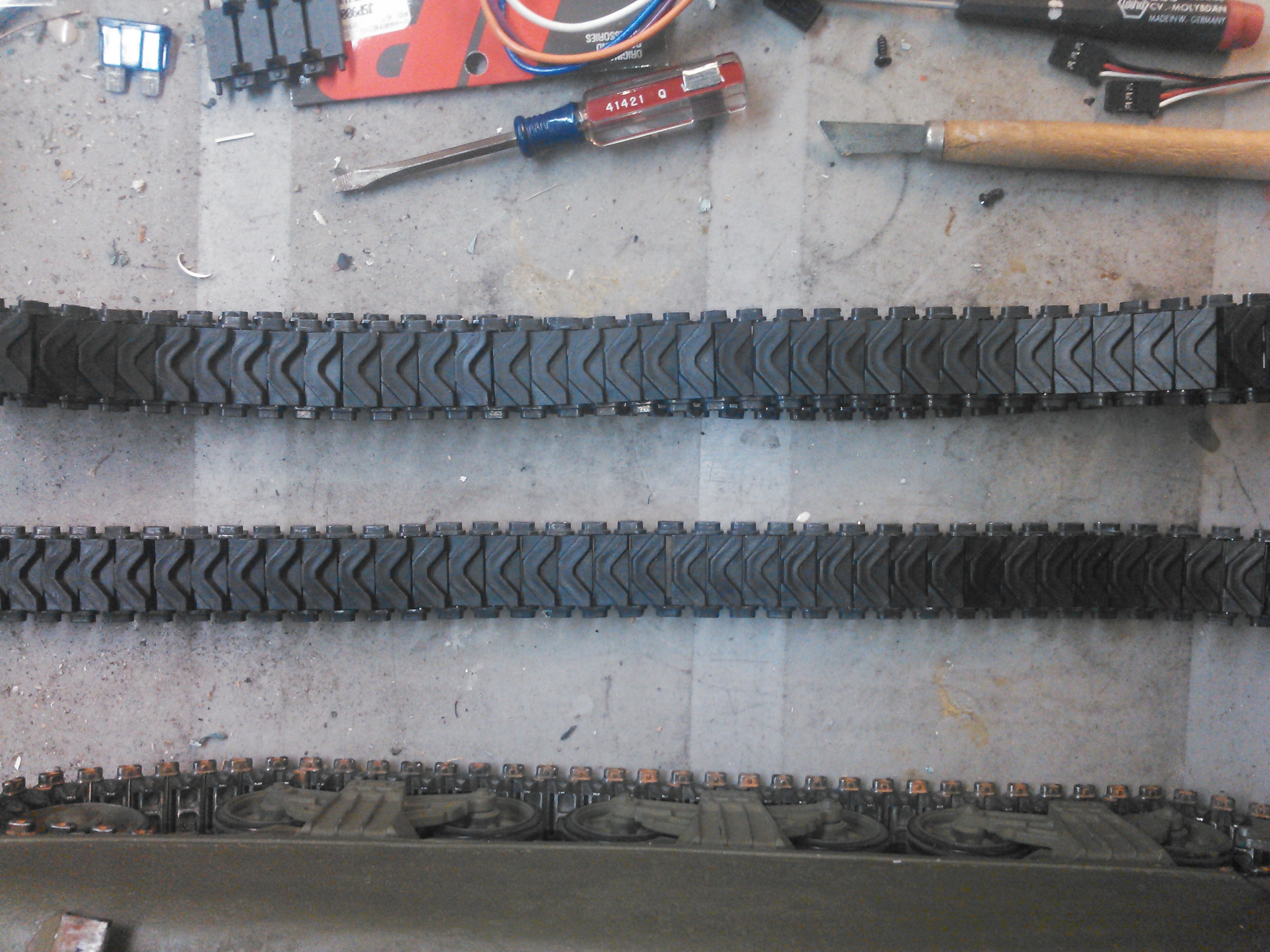

Ok I got my MATO plastic tracks today. These are the ones Dan recommended to use since they have metal end connectors and guides. I don't know if they are any more robust for operation than the HL plastic tracks, but they are thicker so they tread may last longer on hard surfaces.
They DO NOT fit the HL drive sprockets, metal or plastic.
I got out a MATO aftermarket duckbill T74 set of tracks and test fit the drive sprockets with these plastic tracks, they do fit.
Now the down side...
The set I received has some issues. One track is fine. The other I noticed several spots where the track blocks were further apart than the others. Upon inspection, I realized the blocks do have have two holes drilled in them like the metal ones, they are hollow, with spacers in various important spots to maintain directional rigidity.
The cause of the extra spacing between a few of the blocks was the cross pins were bent into a V shape inside the hollow track block, allowing lots of slack between those two blocks because of the engineering of the block. I painstakingly pushed one bent pin out, and straightened it and put it back. A serious pain in the ass compared to the metal MATO track pins. Im sure the pins got bent up while being over pressed into place. I don't know if these things will run and not bind on the sprocket with the extra space between a few blocks. I will eventually put on the MATO sprockets and try them out.

They don't fit the Mato metal sprockets - I've seen people try them when they first came out, and even after some serious dremeling to the sprocket hub, they still don't run right. Sounds like you have a bad set, as I haven't seen bent pins on new tracks before.
(also the track pins are different between the metal and plastic versions, so you can't even use them, nor the edge connectors

Yeah, I saw the pins are different. I wrapped this track around a sprocket that came with my MATO T74 duckbill set and it seemed to fit the sprocket ok. I would think that must be the sprocket that is meant for these tracks. It cant be a sprocket the same as HL because the HL isn't wide enough.
