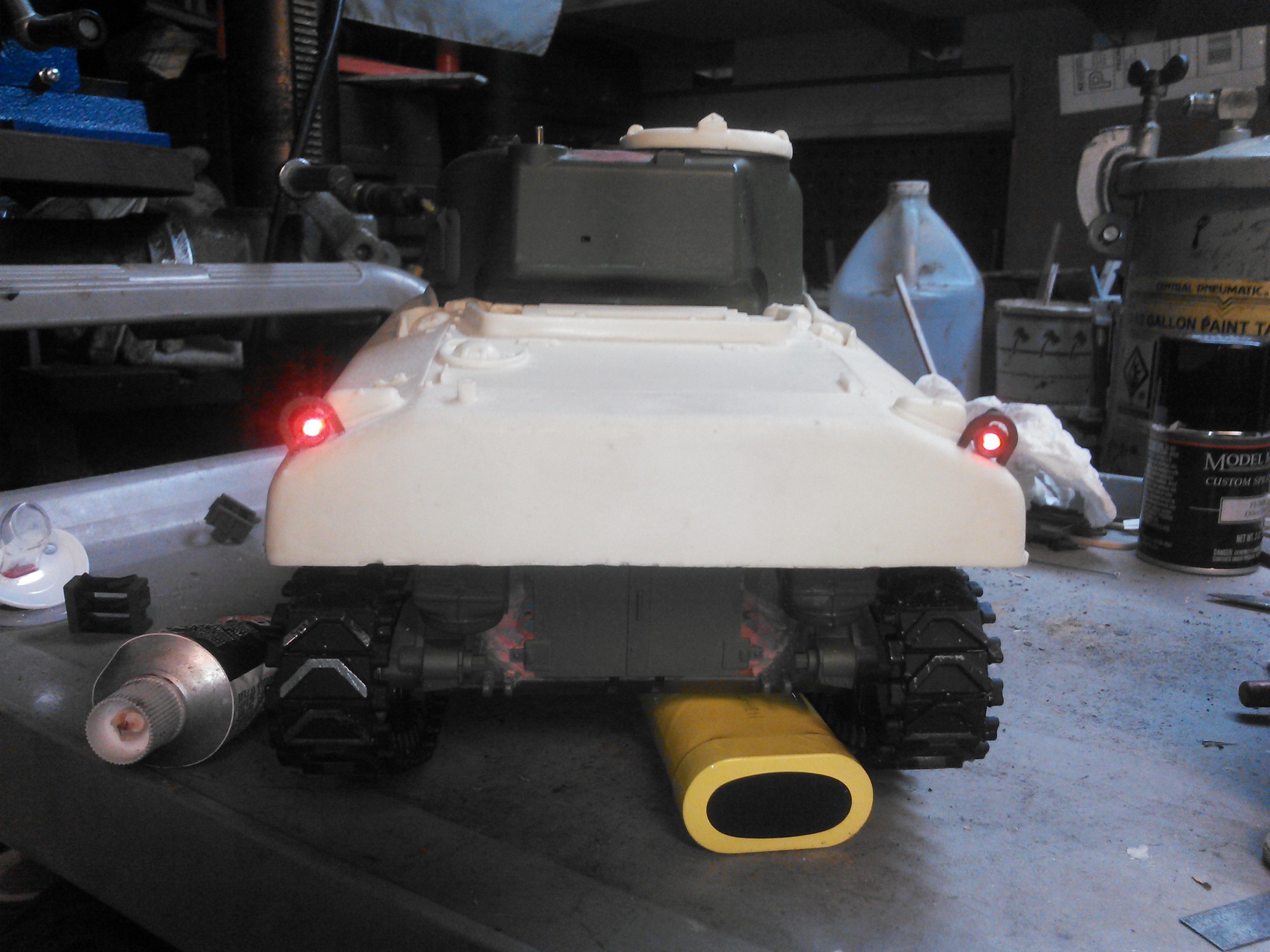

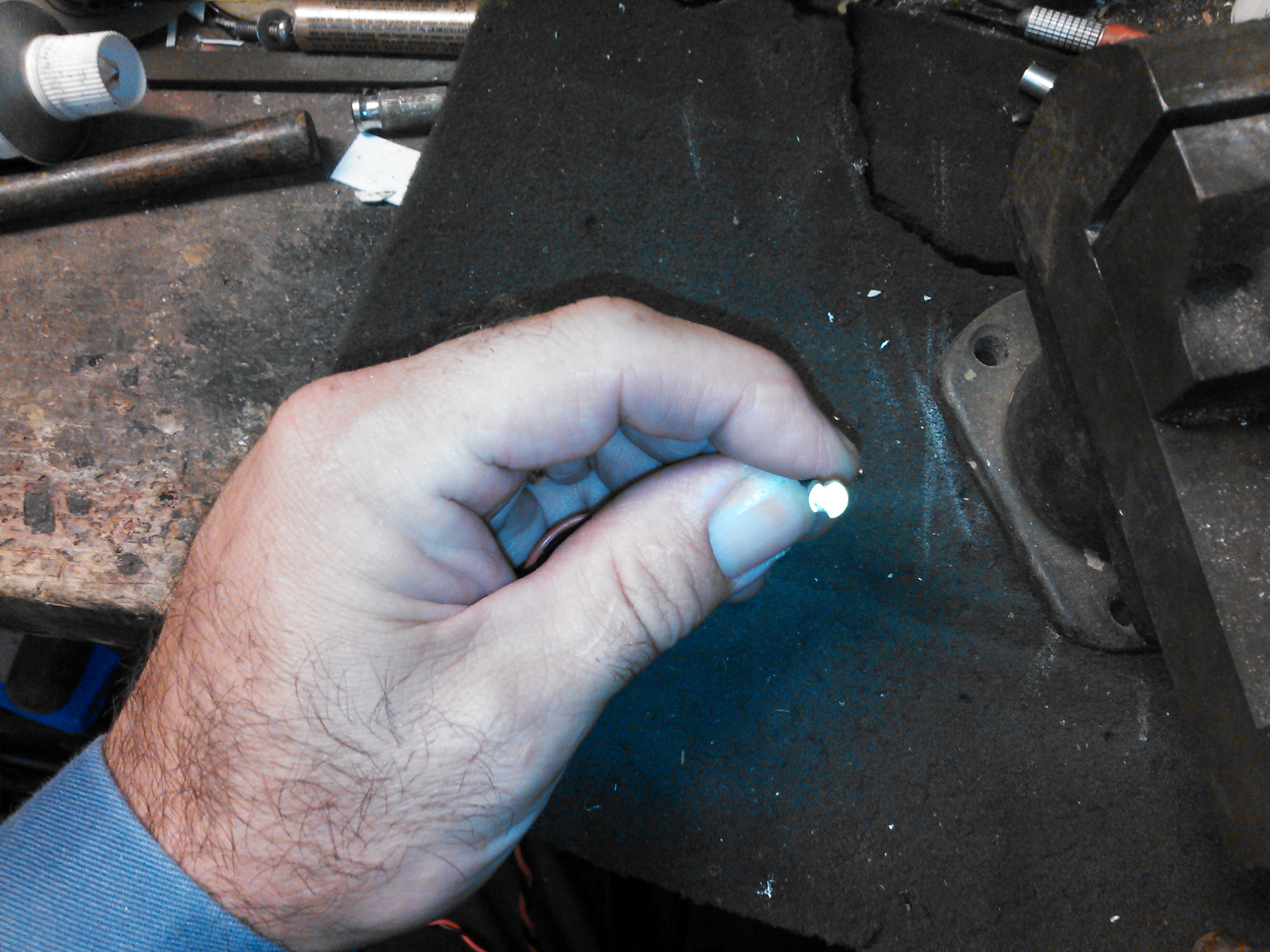

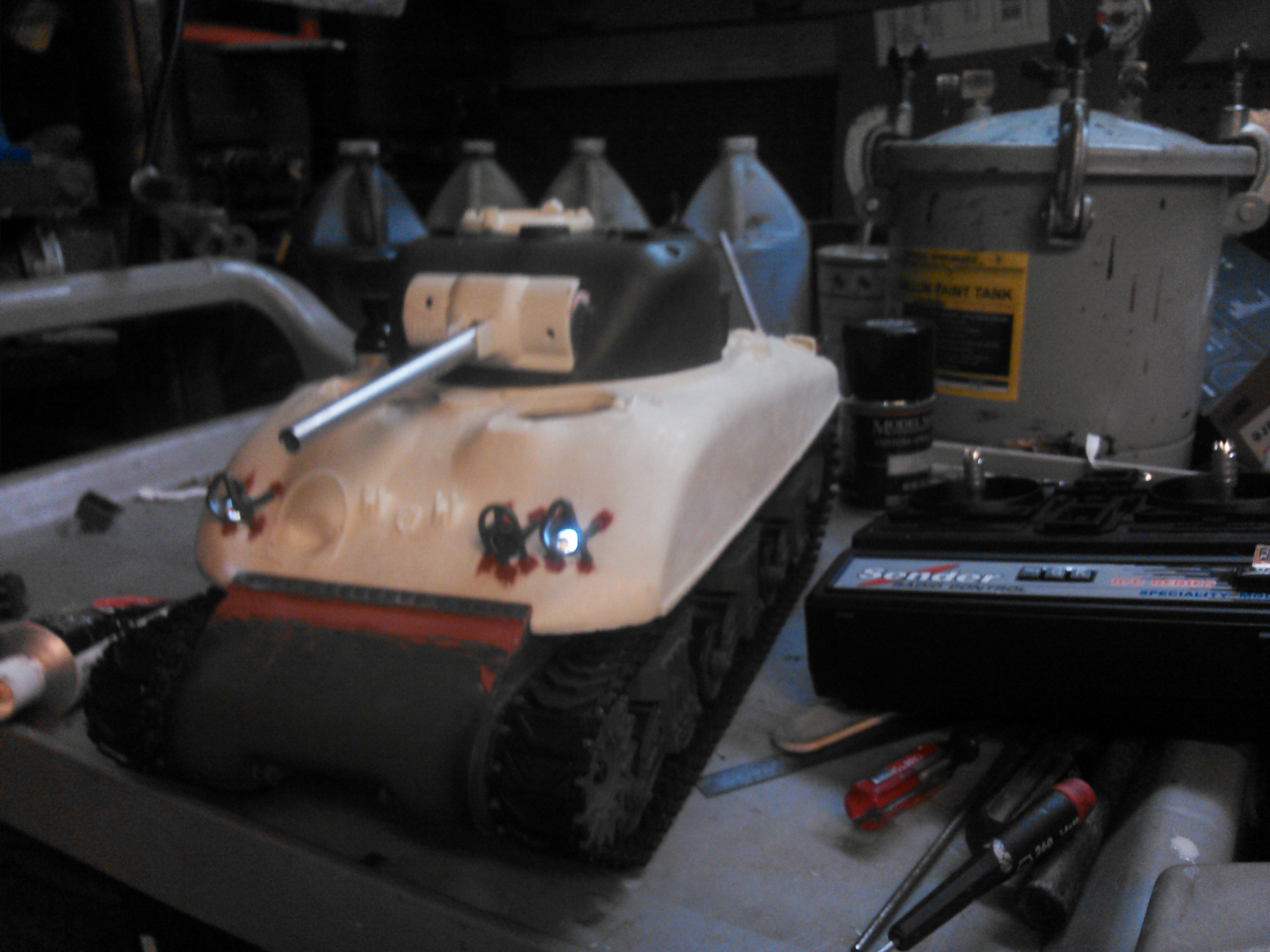

So I got the LEDs installed and soldered to the buss and then glued in the brush guards, accept for the rear, they don't fit right since they came off the flat rear of an A3 so I will make new brass ones this weekend.
I put it all together and fired it up. The lights all work and the turret rotates great.
Then I puttied some welds around the brush guards to fill in the holes they are mounted in.

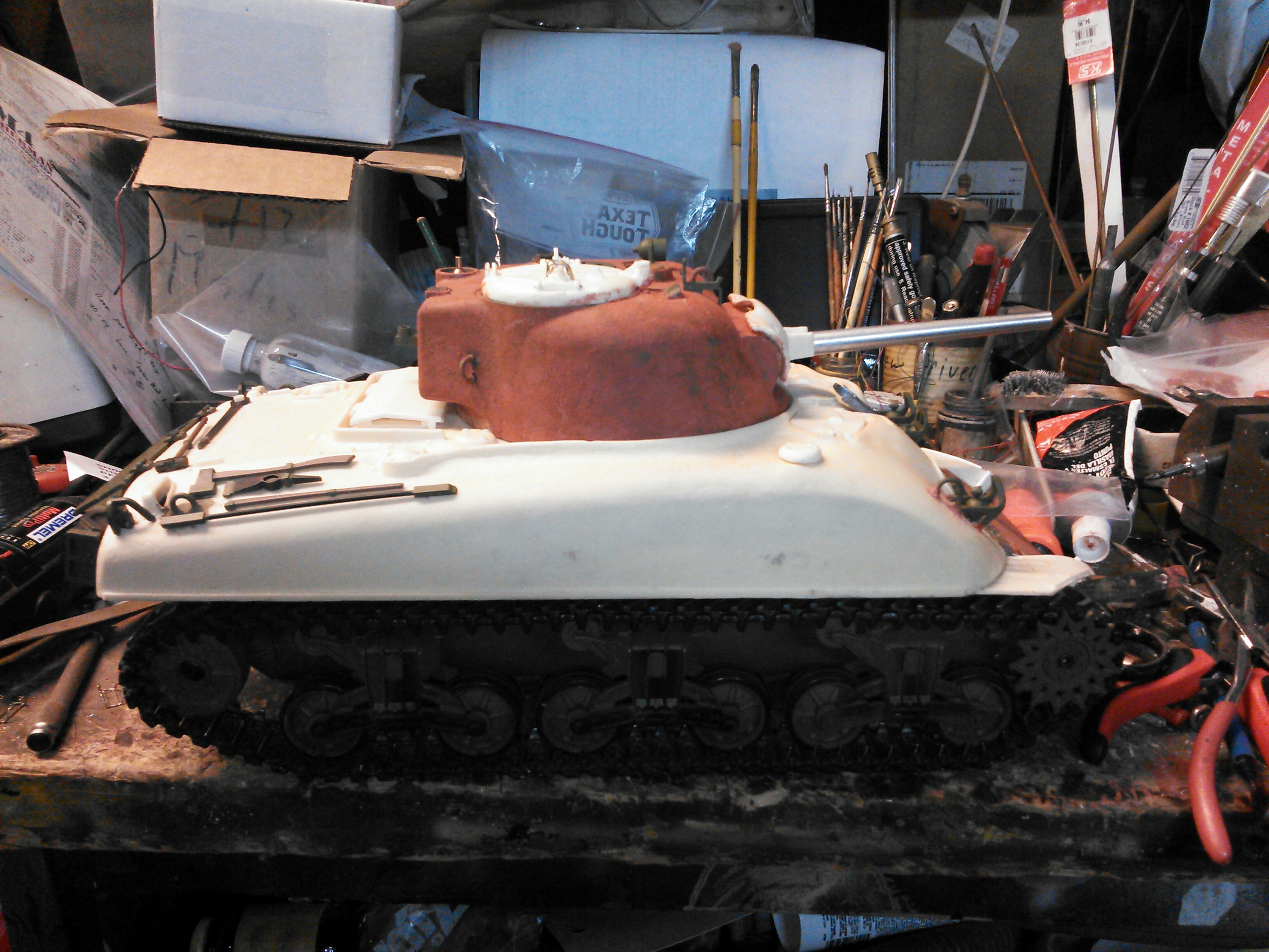

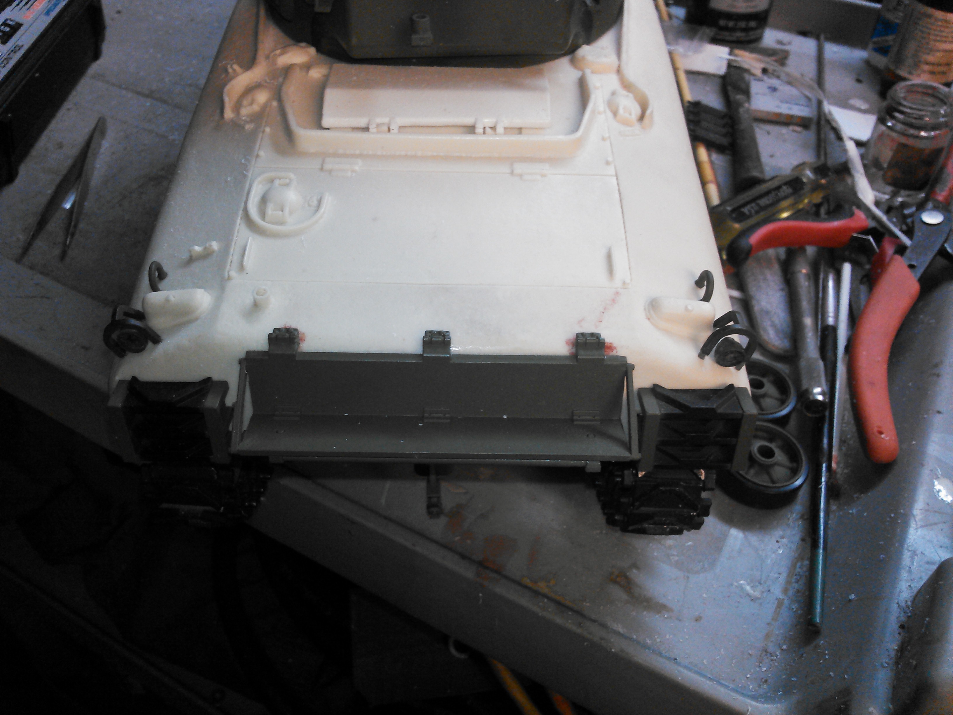

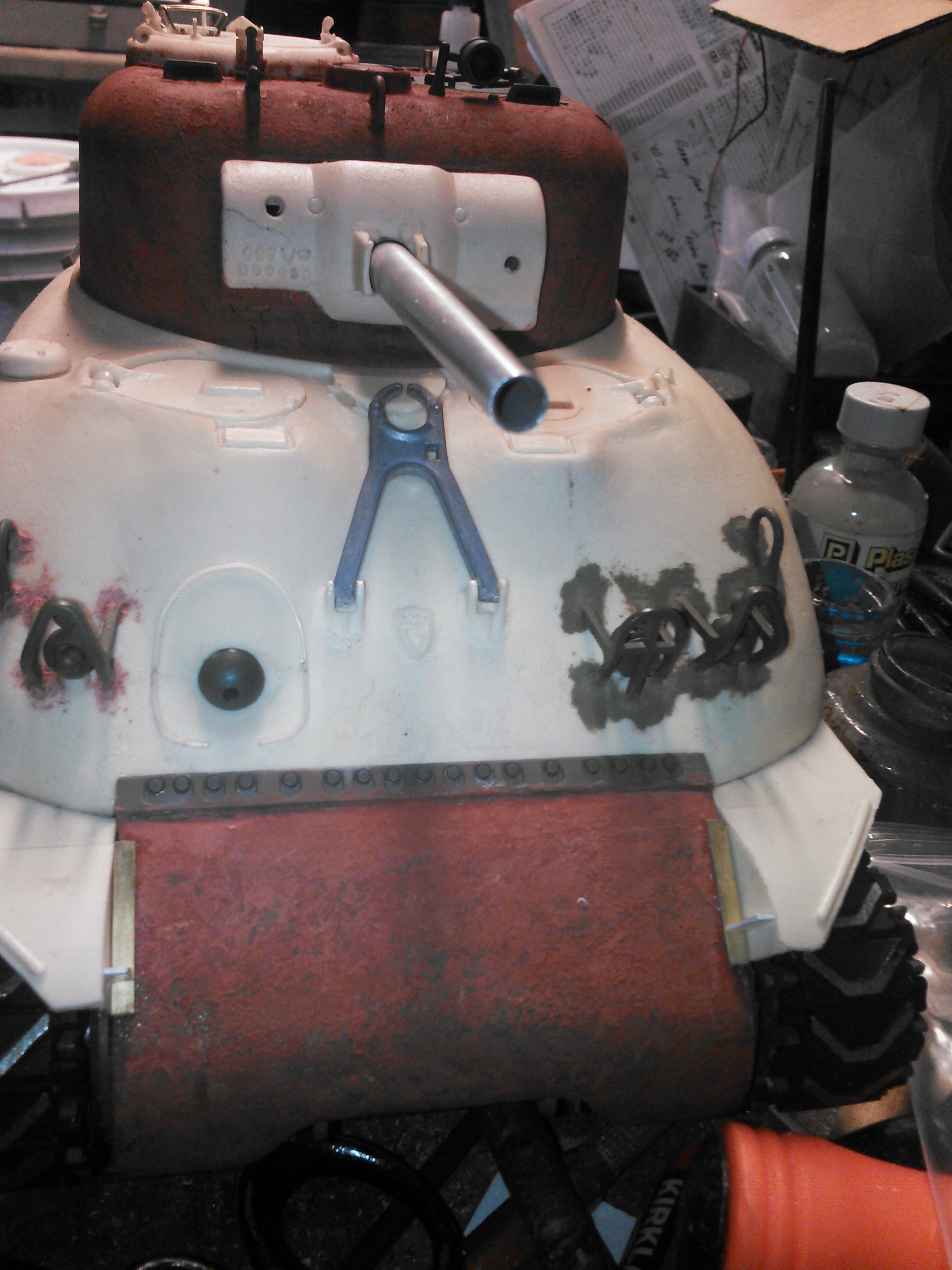

I got the hatches set up and hinged along with finishing the welding putty around the brush guards.
I also finished mounting the fenders. I cut grooves into them along with the hull and added dowels to help with strength and hopefully they wont break off.
Then I got ambitious and decided to try texturizing the transmission cover. I used Bondo brand spot glazing putty and tried several brushes. I found that the shortest brush, about 3/16 long and extremely stiff worked best. Its an artist oil painting brush (left overs from grandmas hobby)
The process took me a little bit to get down and I had to clean my brush in some laquer thinner every few minutes because the putty does begin to dry and clog up. I also was able to smooth out some areas I got too thick, by dabbing with a drop of thinner and spread it back out. Overall, I am very happy with the results. Its very durable when dry, I have rubbed it with my finger and it does not rub off or flatten down. I cant wait to get to the turret and then spray some paint on it!

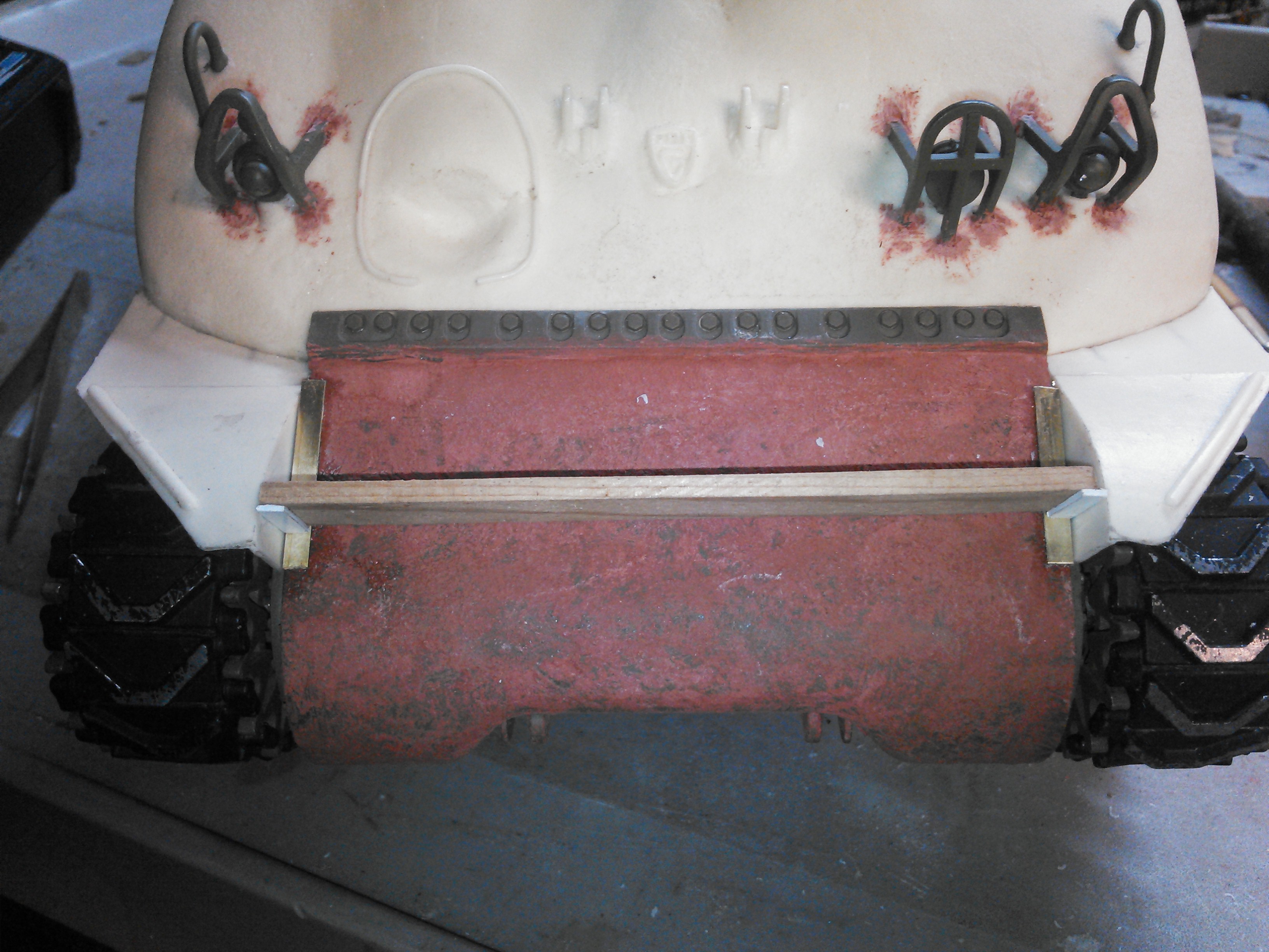

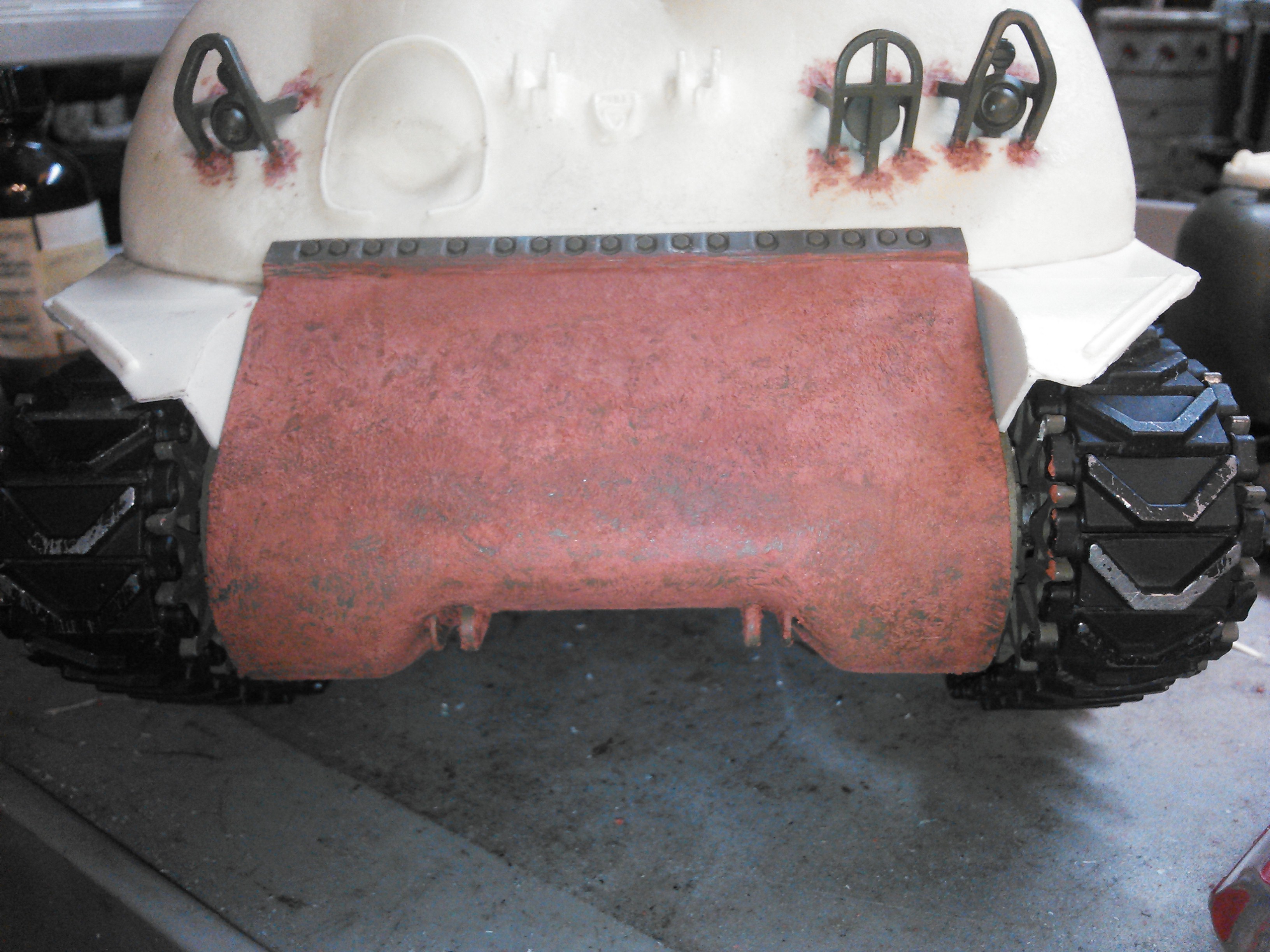

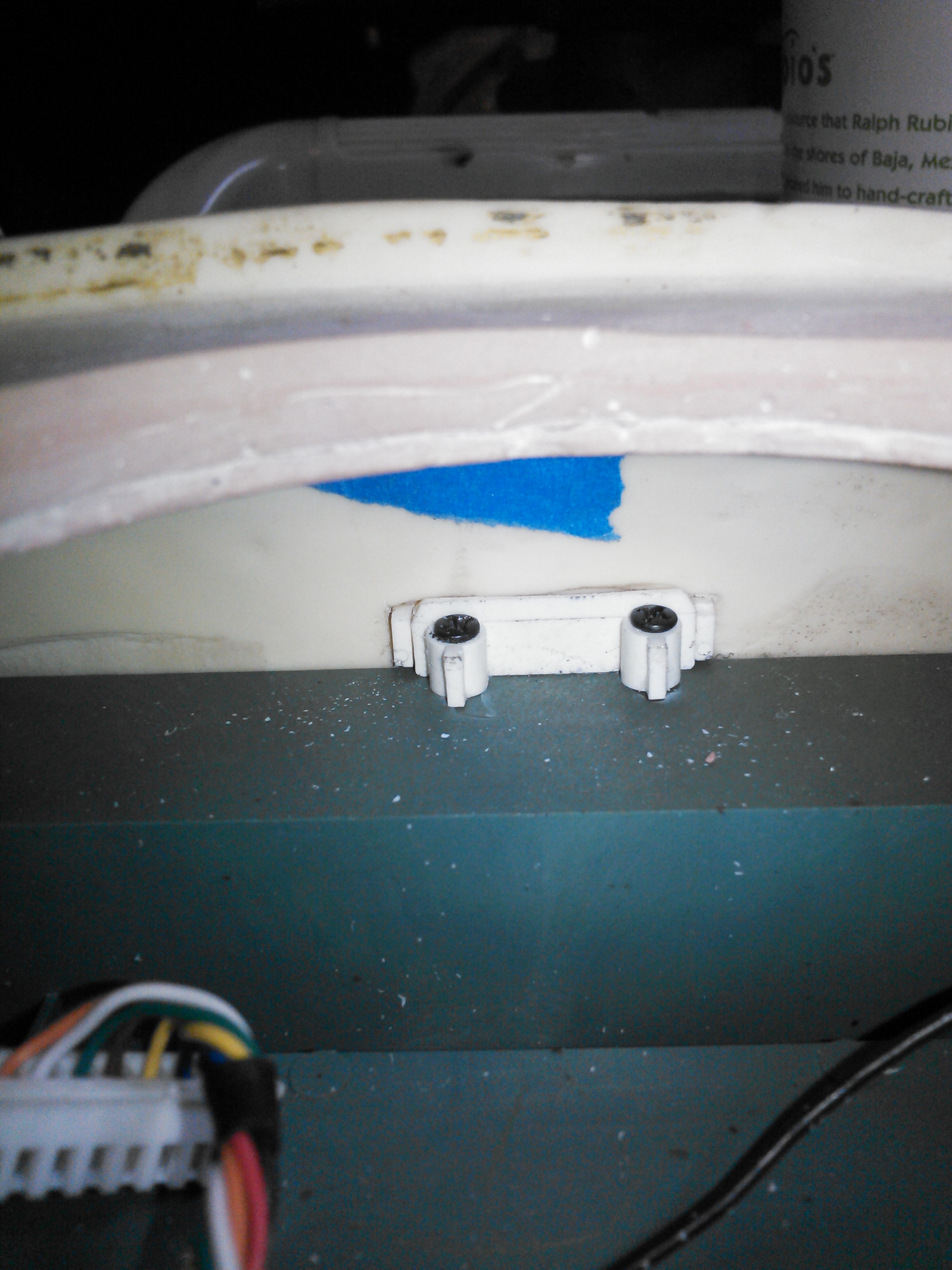

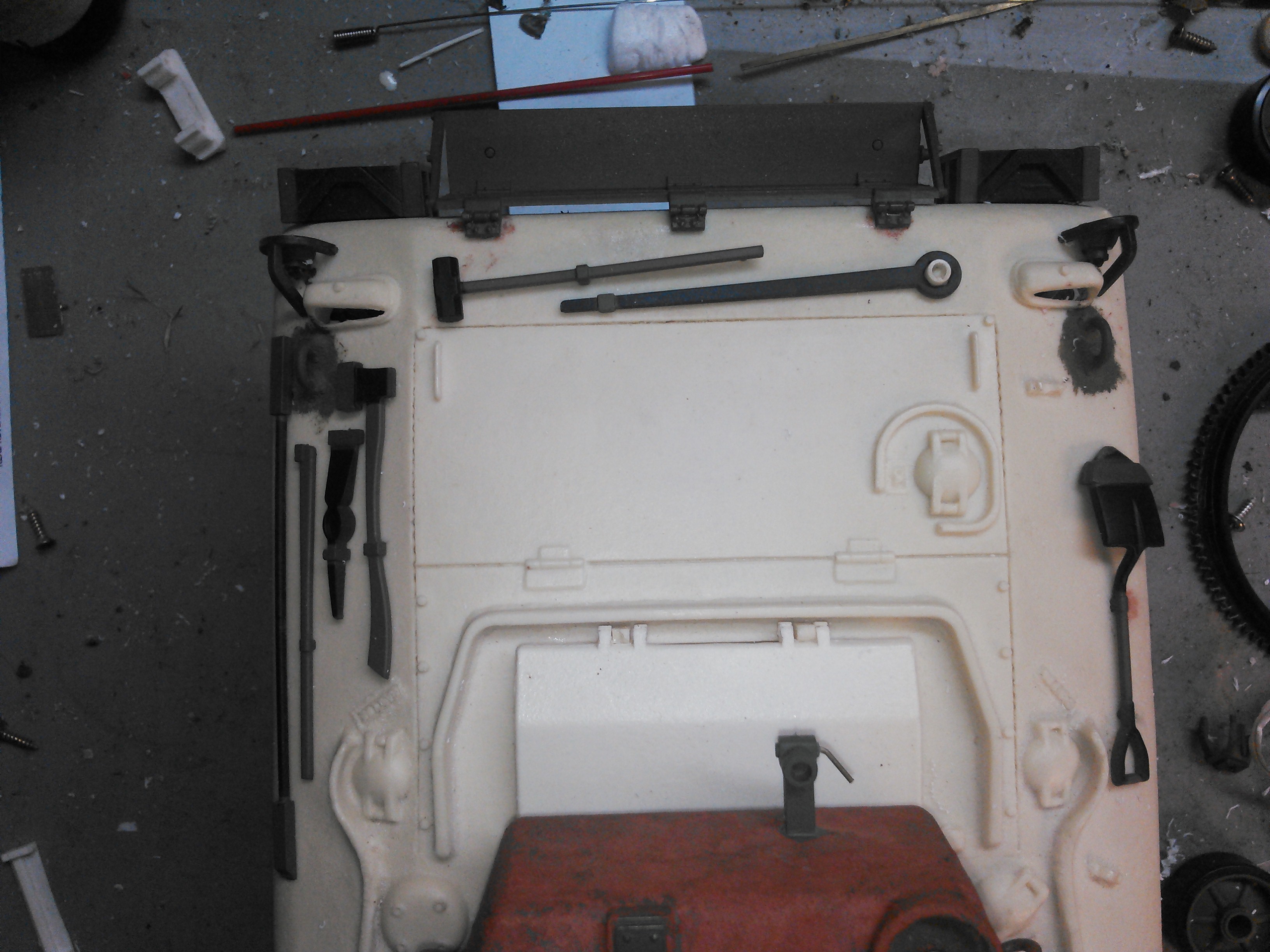

Ive been hard at work. Lots of things done.

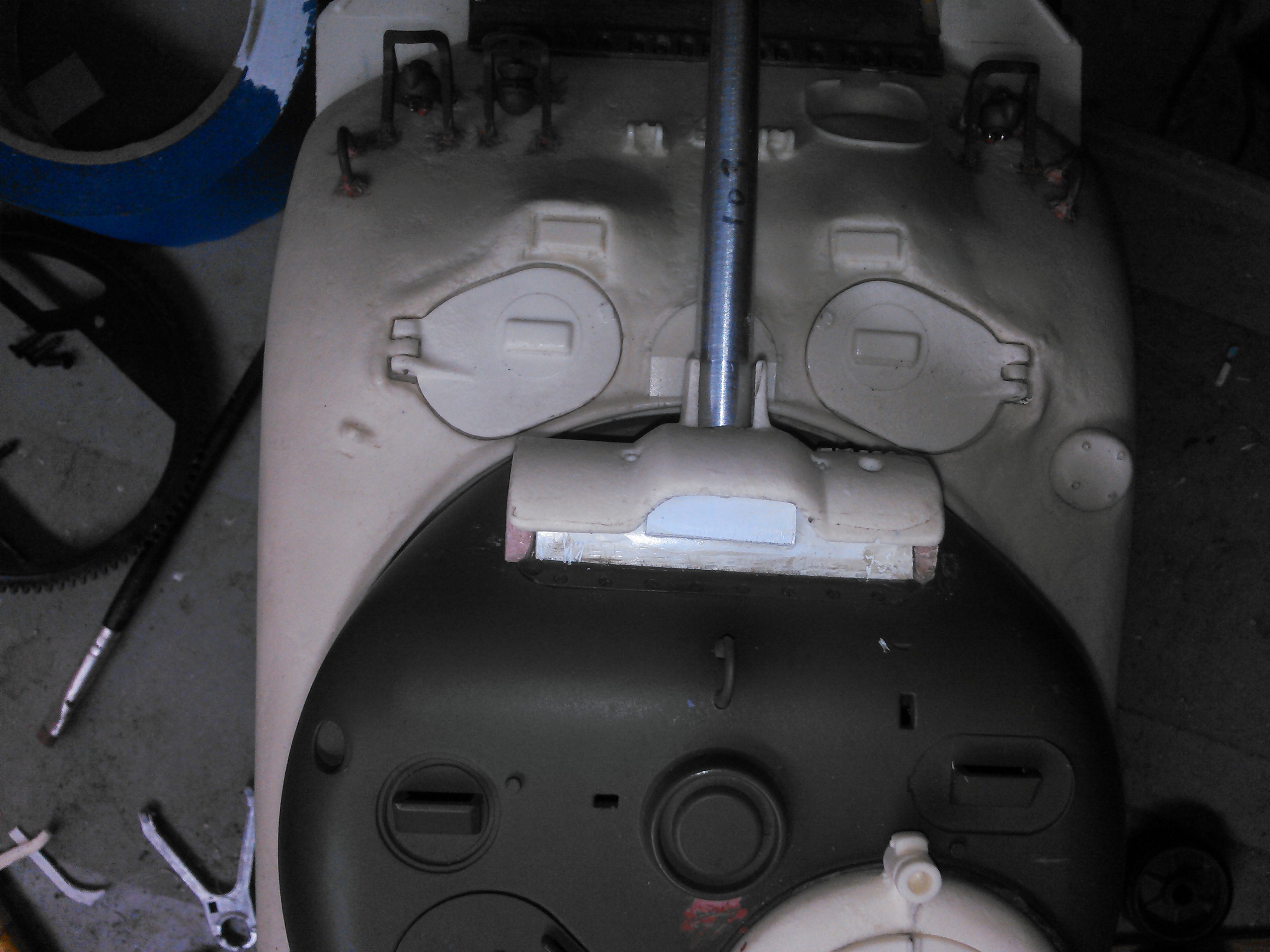

Stowage board installed across the transmission cover. The board comes off, it is just sitting in place right now.
Hull lift rings installed and "welded" in place.

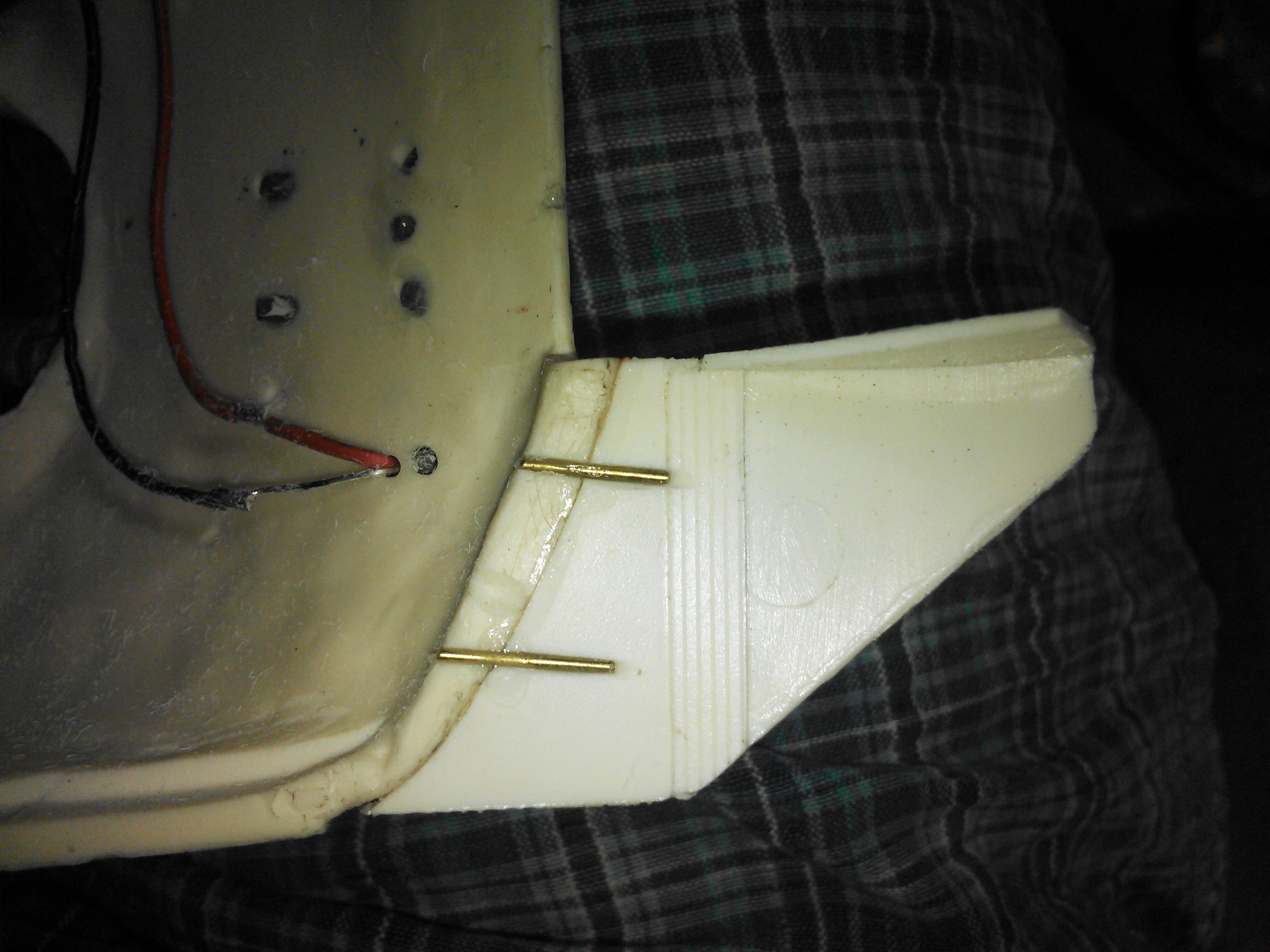

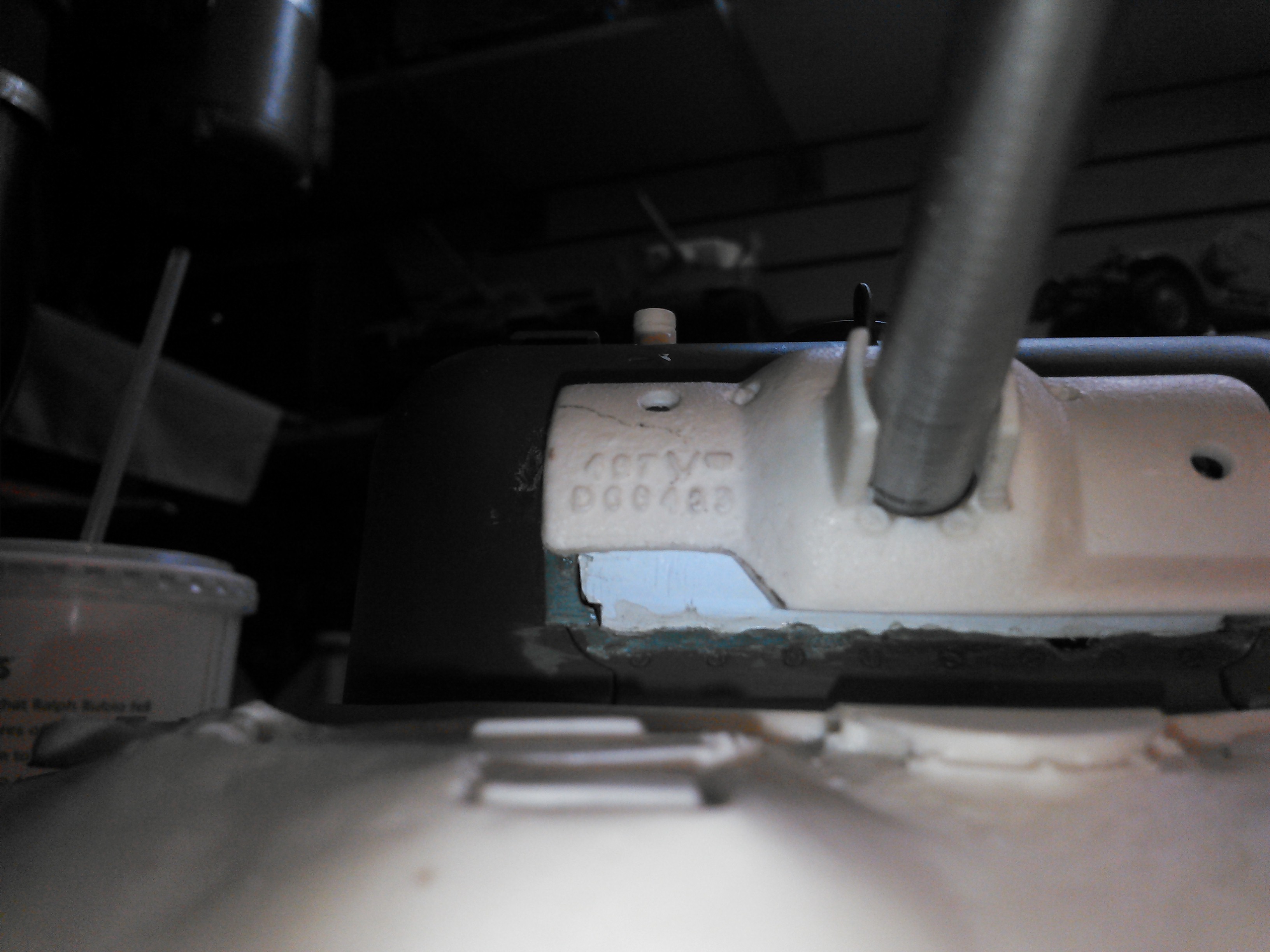

Filler plates installed behind the gun mantle to cover the gaping holes top and bottom. What a pain in the butt that was. I still need to putty around the panels to blend them in. Next time I am going to try from the beginning to use Nick's turret mantle mount casting.

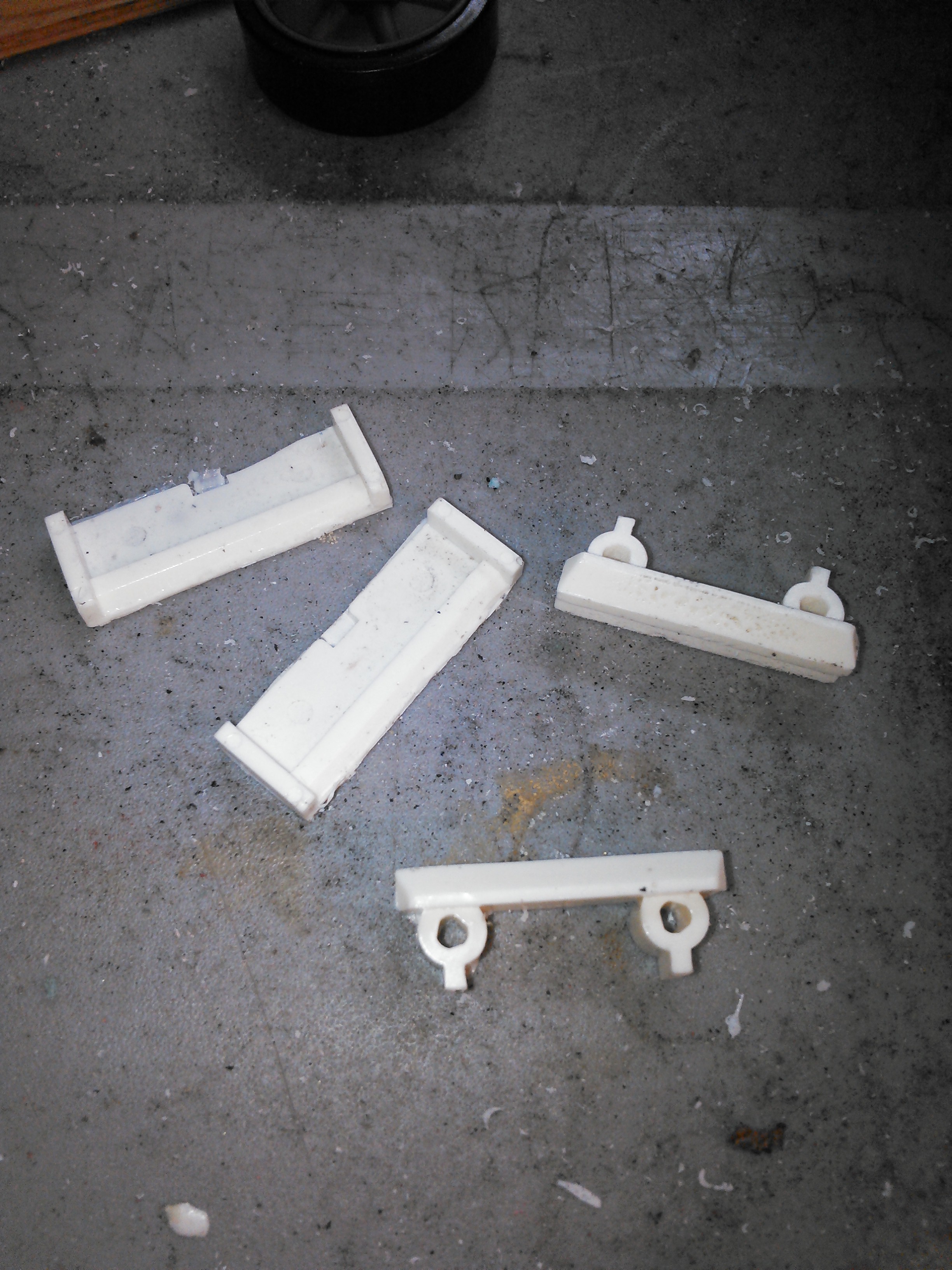

I also made some molds and castings of body clips and got one side installed tonight. Works well. Hull should fit tight, might wind up being too tight.

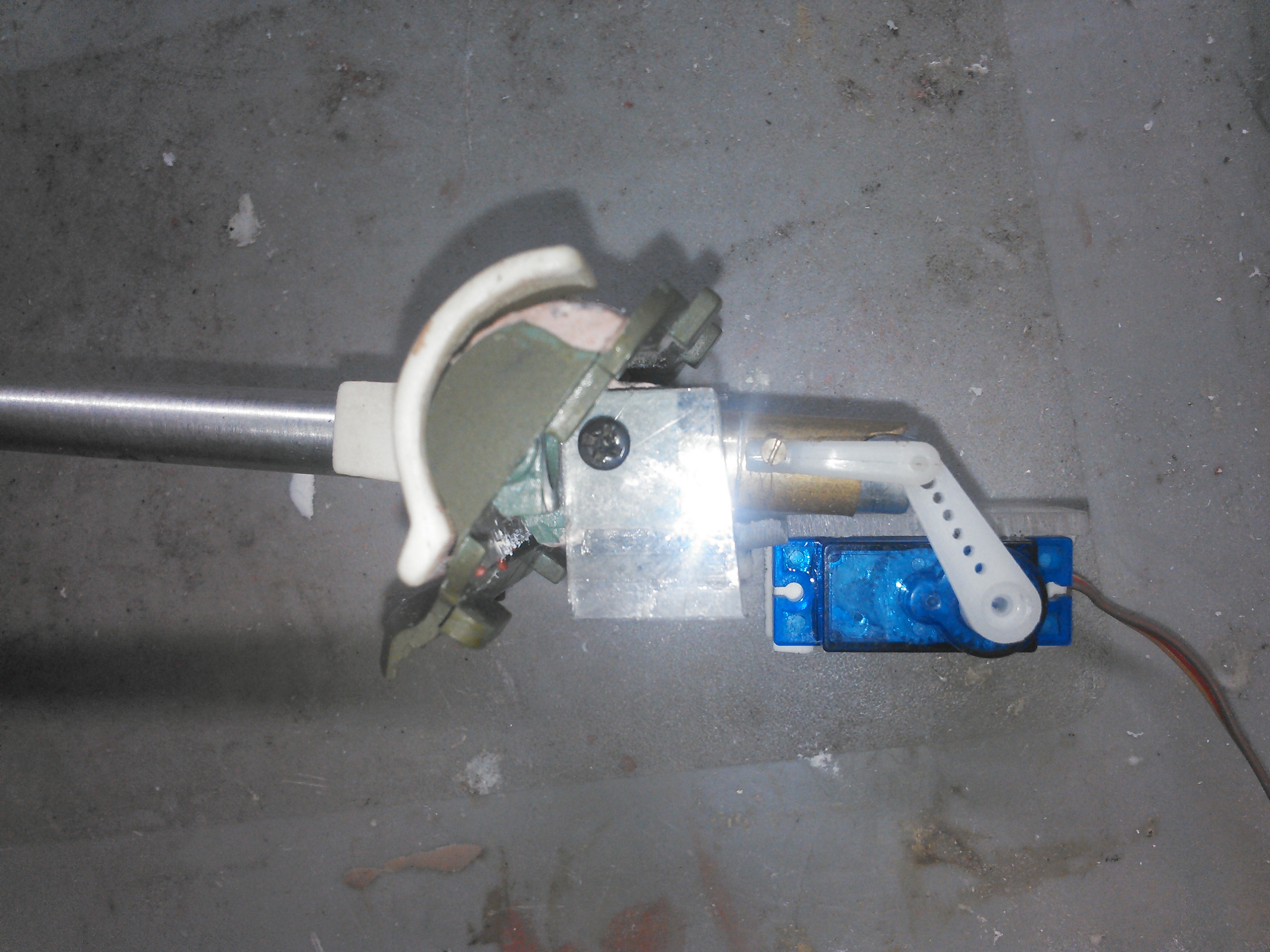

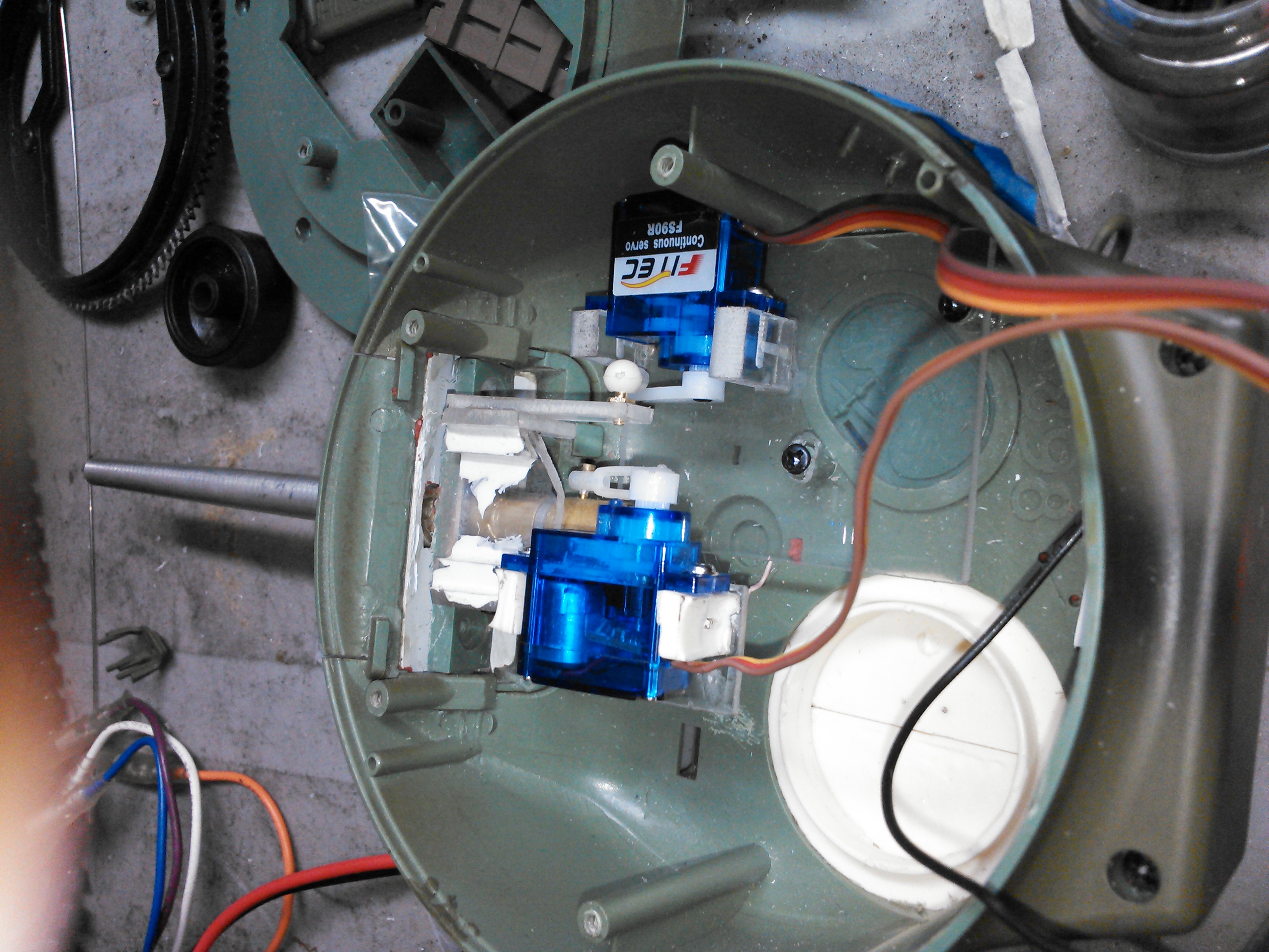

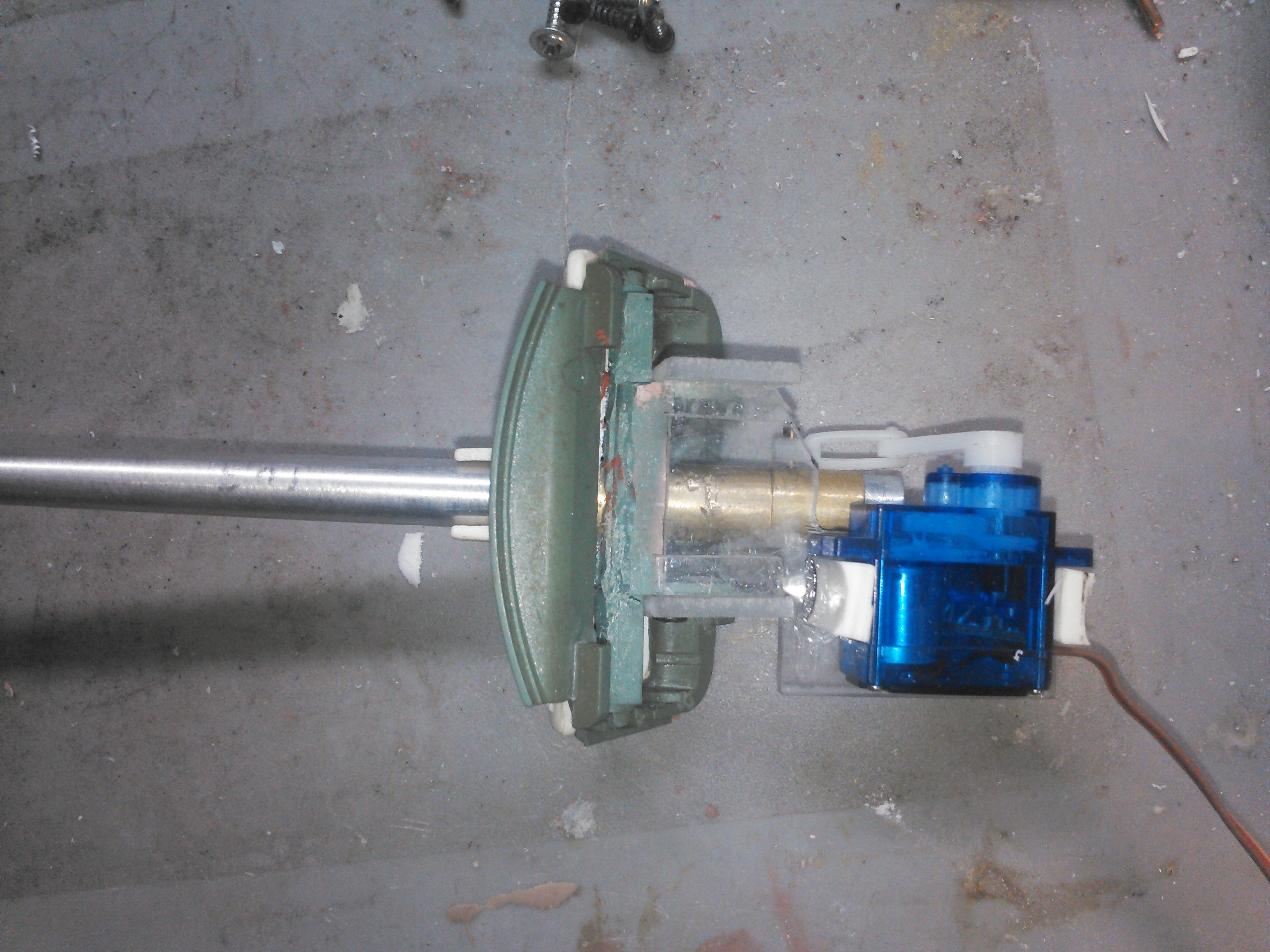

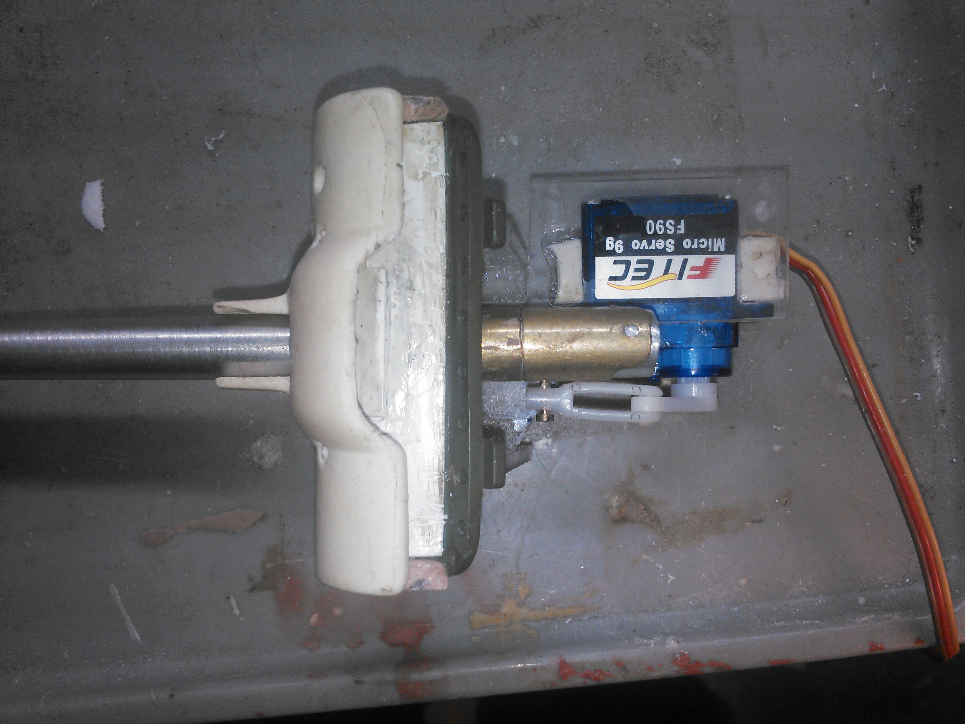

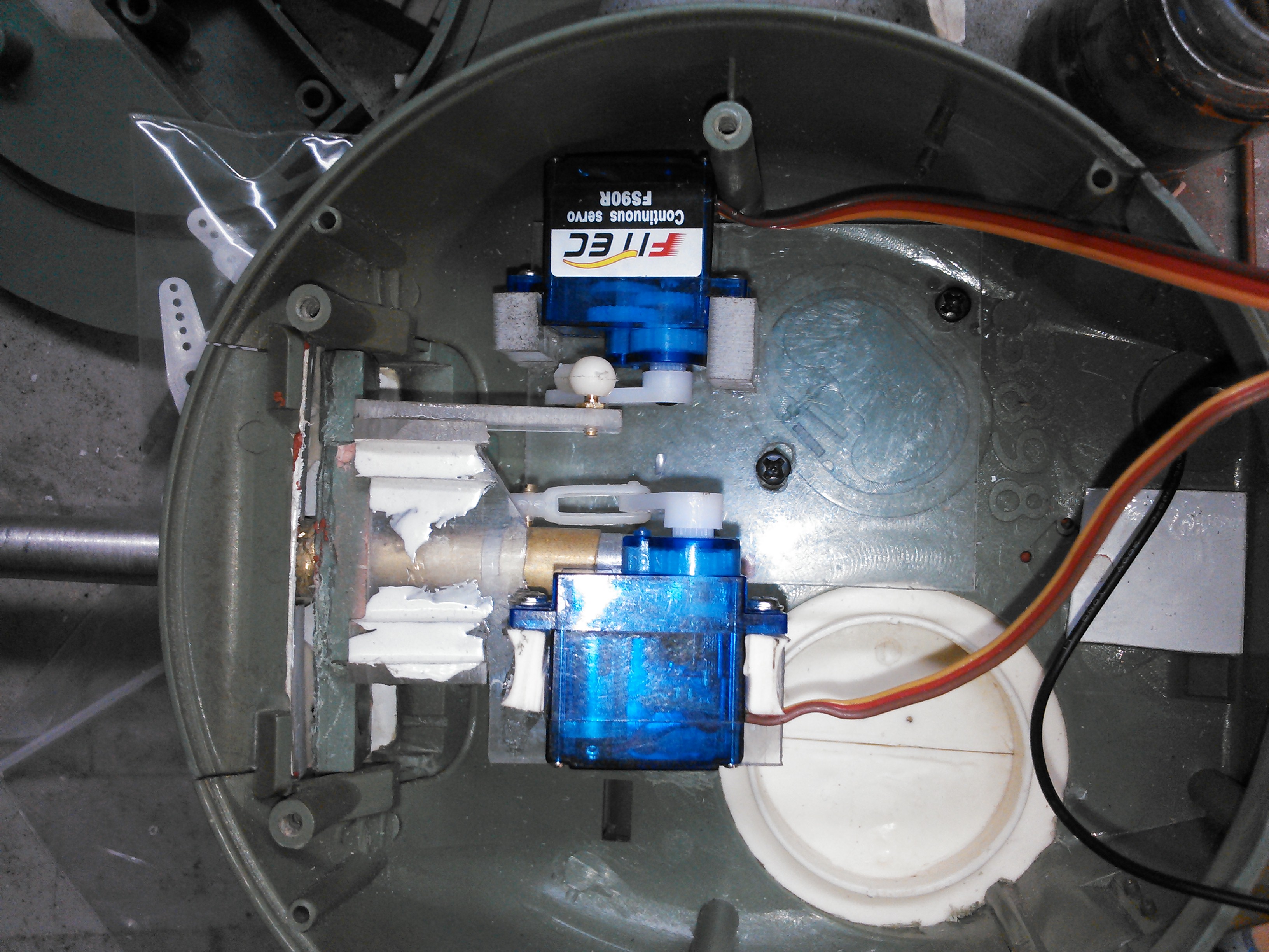

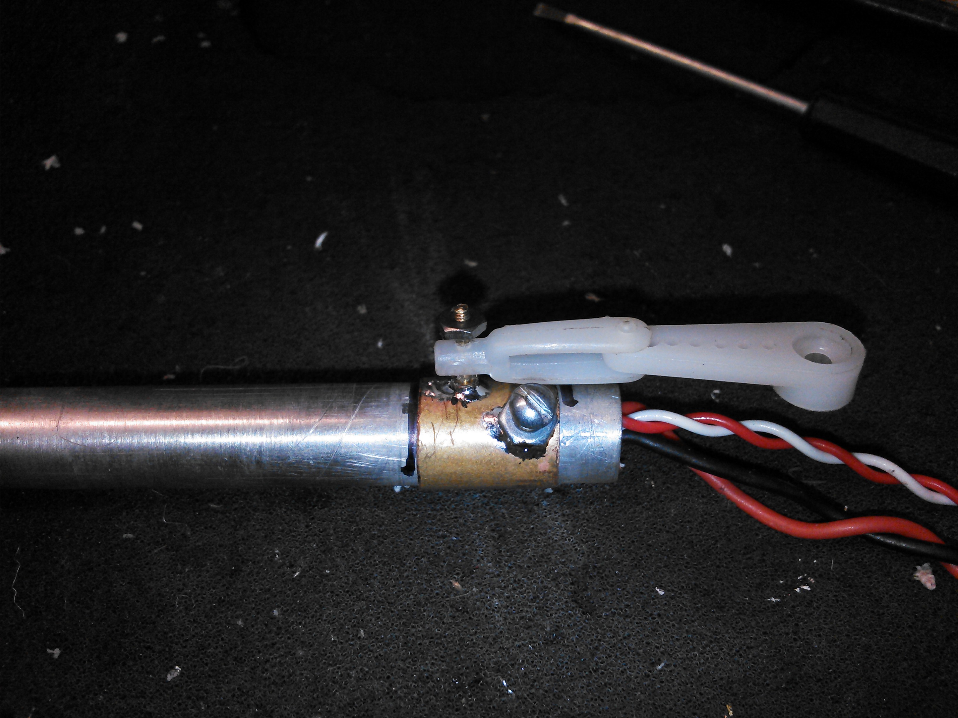

Servo Recoil BABY! Just have to wait for my BARC4 from Dan at Battle Armor to start hooking it all up.
Next I have to fabricate the elevation mount using a continuous rotation servo so that it will move with the stick, but stay in place when you let go of the stick and re-centers. Going to use a rate reducer on it as well so it goes slower. John turned me on to it, http://www.dionysusdesign.com/produc...roducts_id/192
I added screws to the servo blocks post photography tonight.

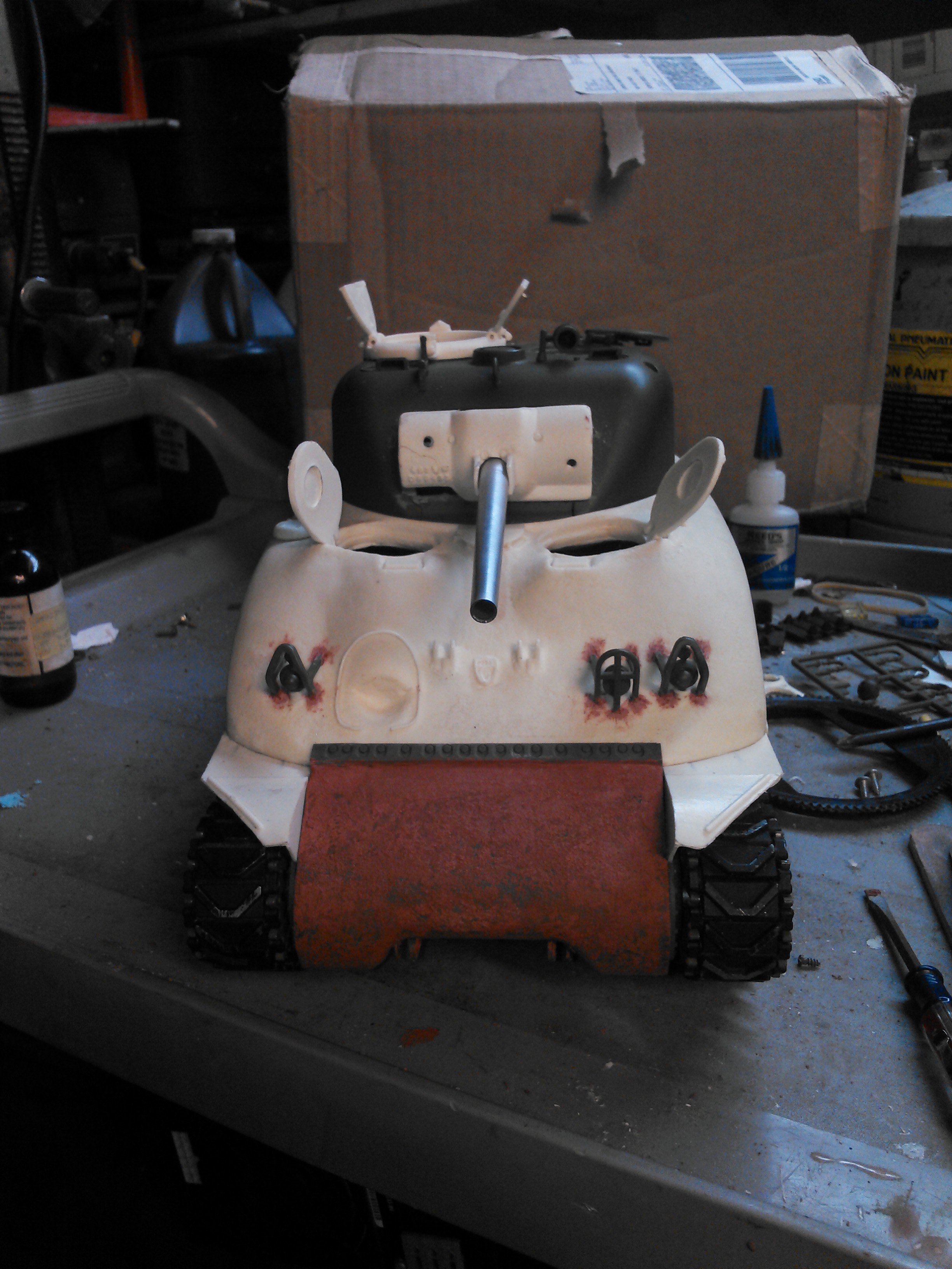

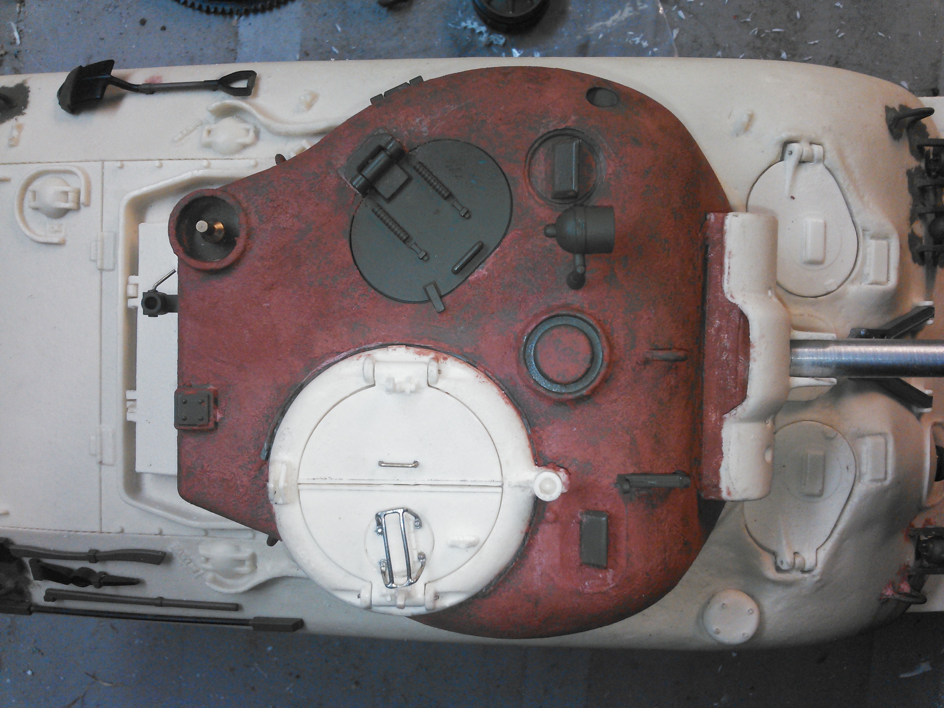

I am nearly done with the modeling aspect of this project. Left to do is mount the periscope guards on the hull hatches. I am also going to put mid war M2 .50 barrel stowage brackets on the top of the turret. I had some pictures but couldn't find them tonight.
I have finished the turret texture, modified a Mato metal barrel travel lock, got all the tools mount holes drilled and set in place. Not sure what more I can do or want to do, just call it done and wash the urethane parts tomorrow night and then I cant spray some paint in a few days. Then its just waiting on the BARC4 woohoo!
Oh the hull 30 cal isn't installed yet, I might get a nice Tamiya one with my next order, I just cant stand that HL pos.

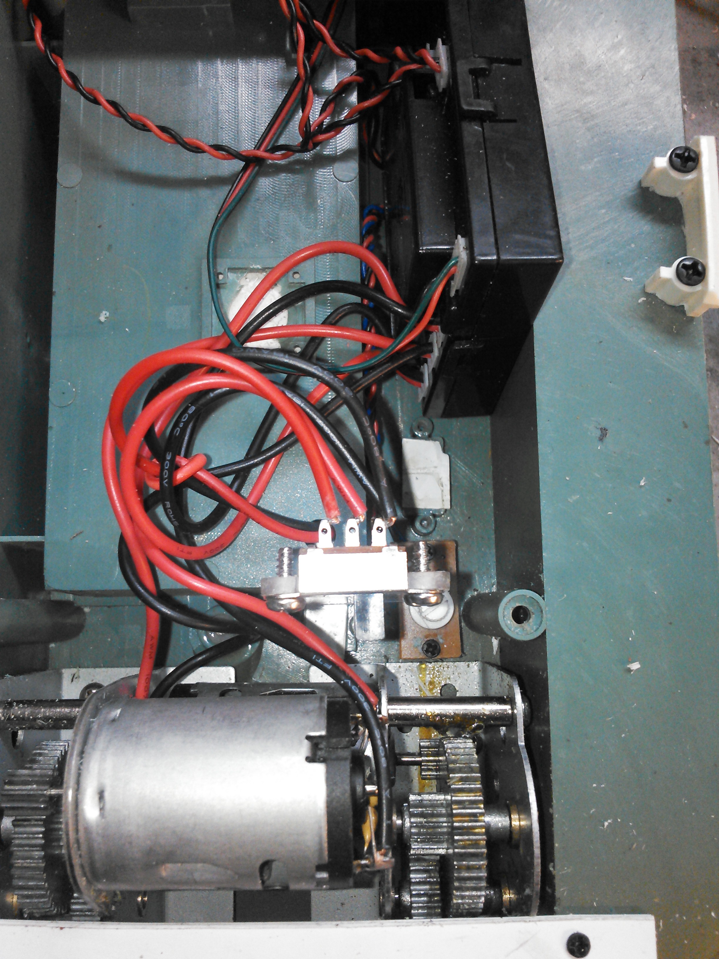

Got the hull washed up tonight for painting prep.

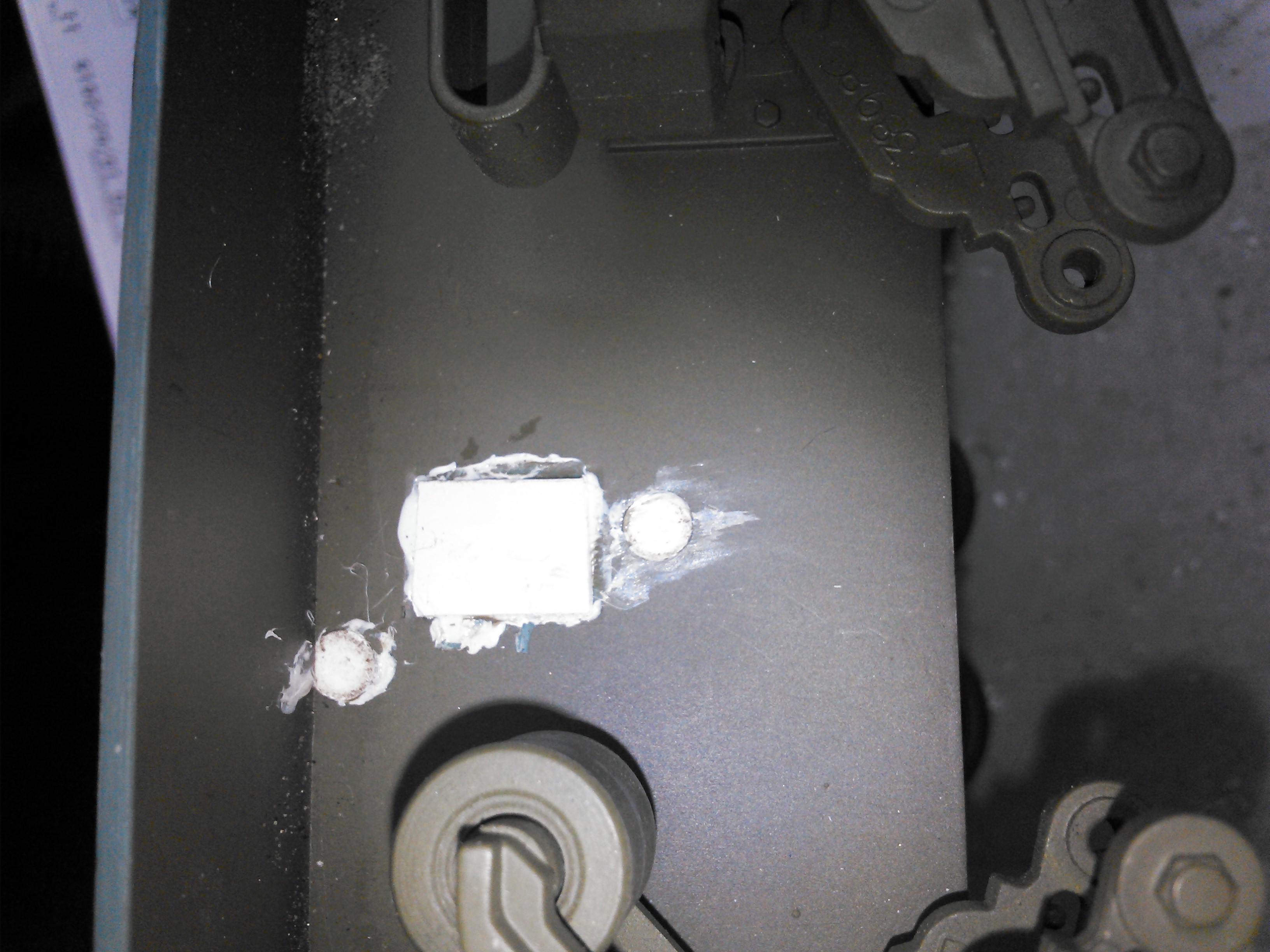

Also I decided to move the switches up into the hull and seal up the holes on the bottom as well as the holes on the side with the ABC switch hole left from the old RX14 system that HL never eliminated from the molds. I guess its hard to tell in the second picture, but I mounted the on off switch on a piece of plexi up above and behind the drivers hatch so that I can open the hatch and turn the tank on and off and if I want, adjust the volume because I just flipped the control pot over and screwed it back down.
I am debating whether or not I want to cut the battery box open and glue the bottom on and seal it up and just go through the top every time since I installed the body clips, it would be really easy to do it. Not sure yet.

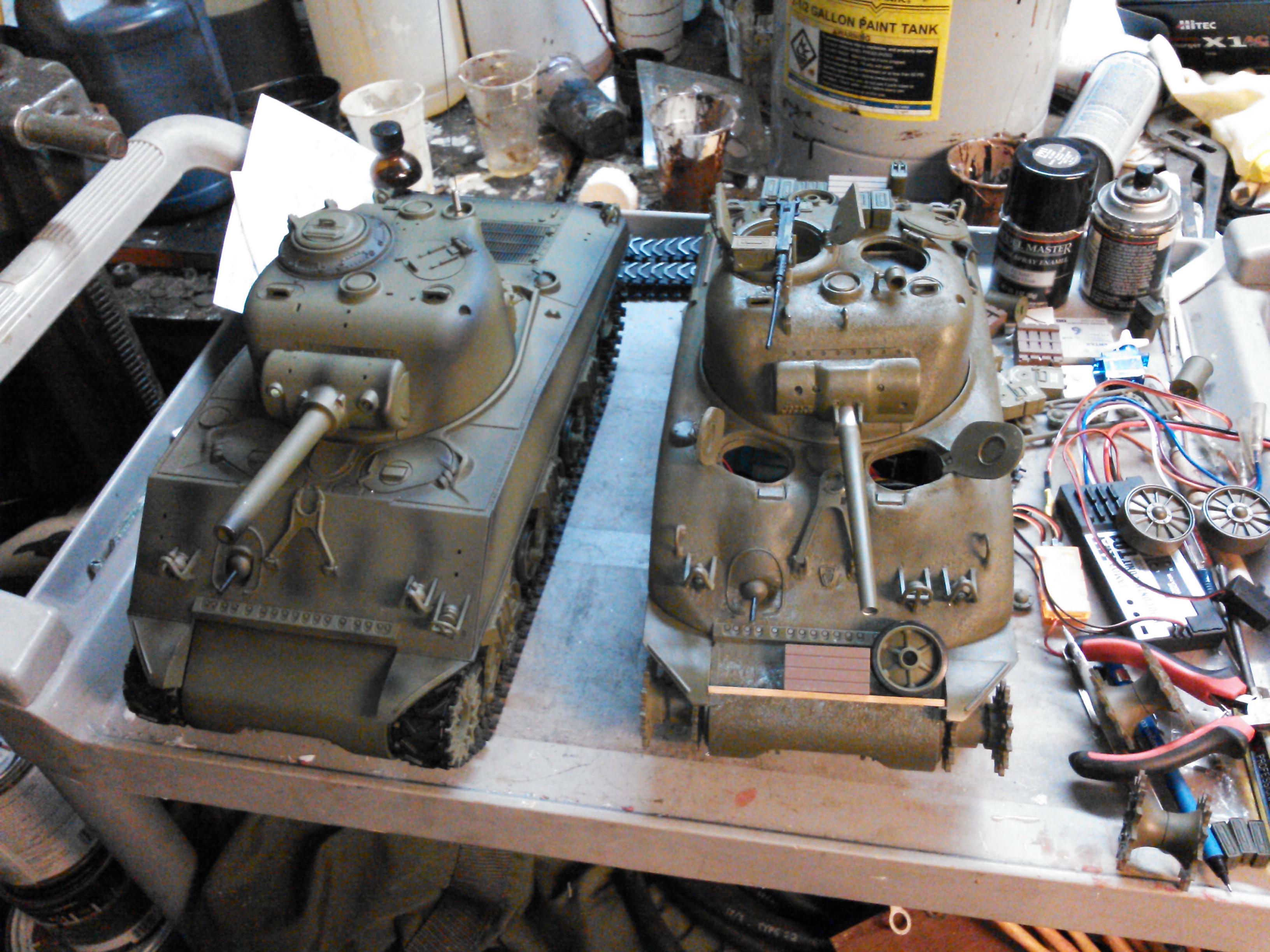

So here is where I am now. Paint and have the gloss coat applied. I think I am going to make and install the .50 cal barrel stowage mounts that go between the two hatches from front to back. These were on top of the turret until after D Day when those angle brackets were welded to the back of the turret like horns to hold the barrel.
This was before I sprayed the gloss on.

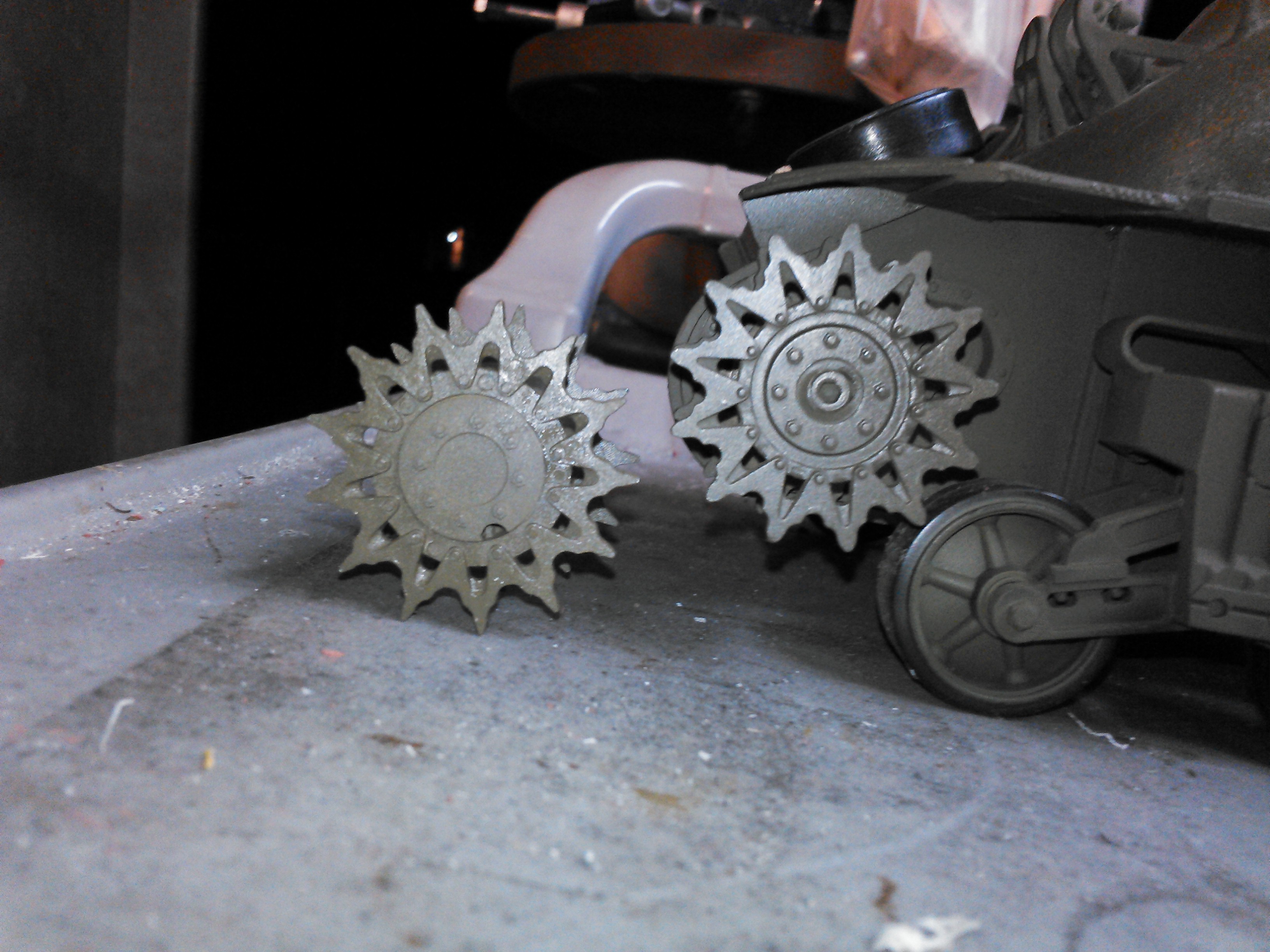

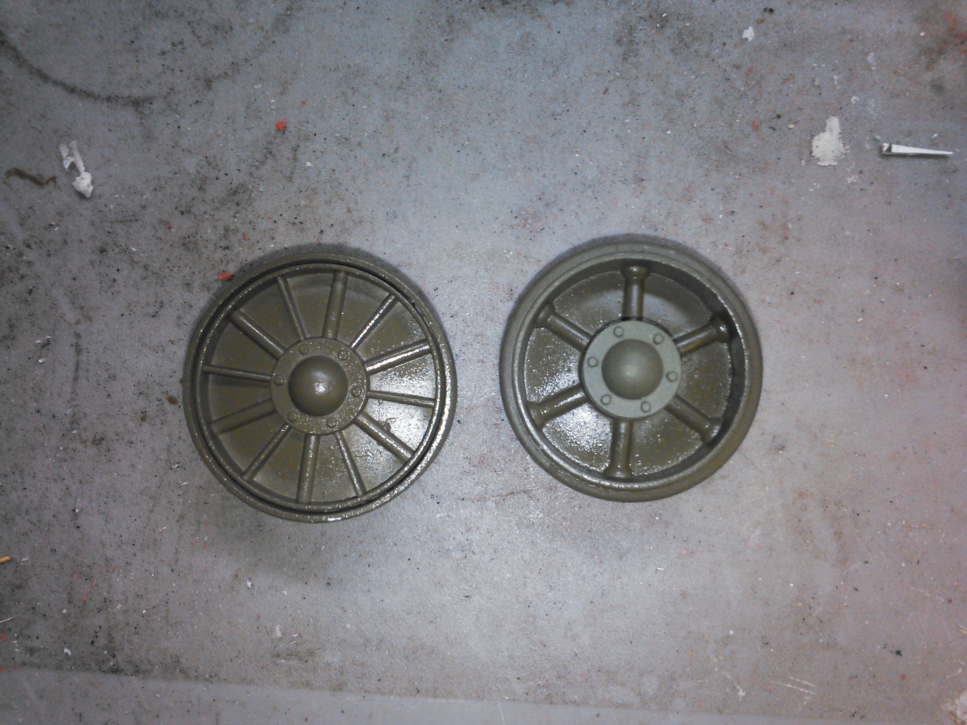

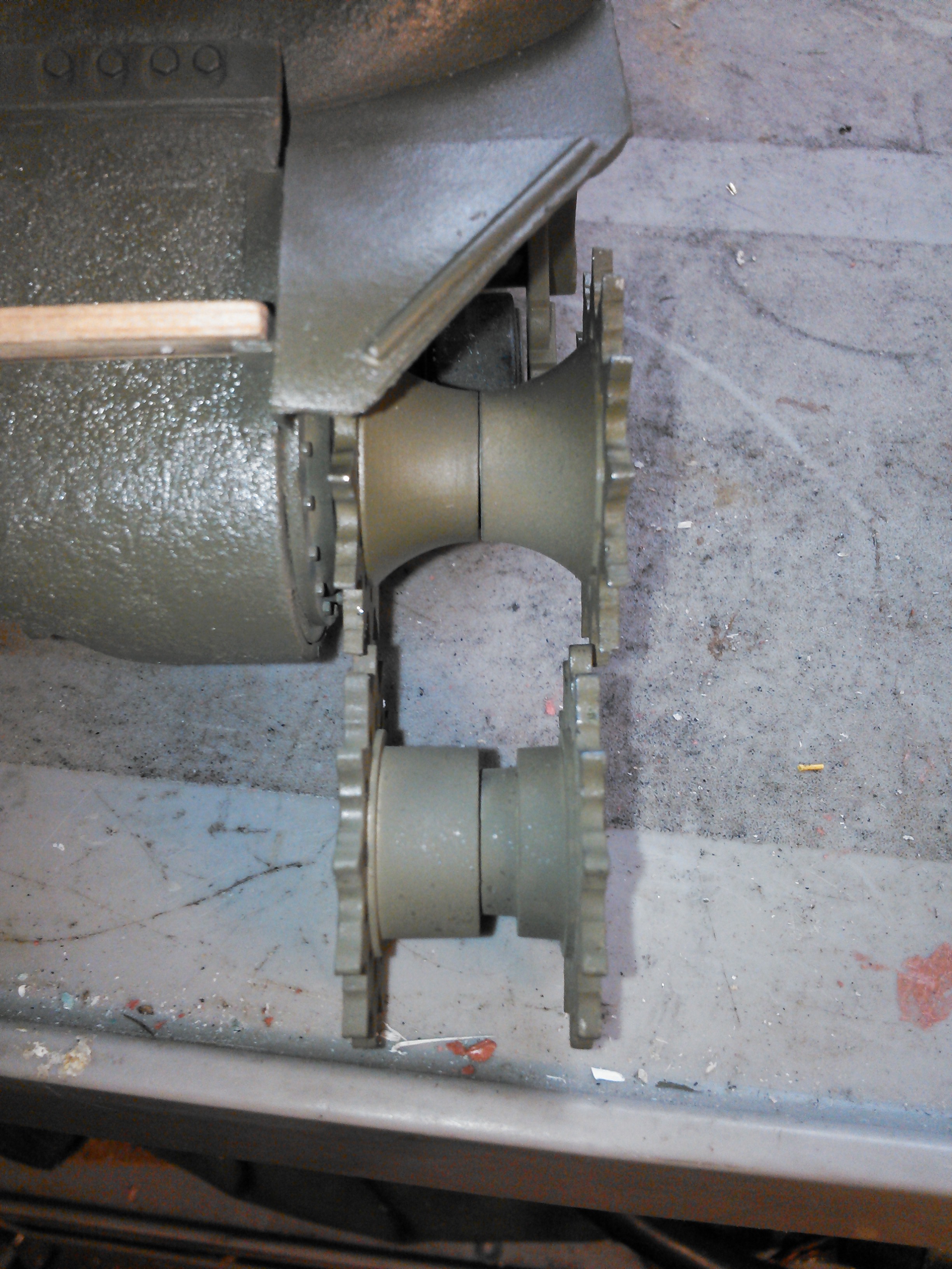

So this is something that surprised me and really pissed me off. This HL was a HengLong brand metal upgrade I got off ebay. Its not a Mato upgrade. Mato was out of stock for a few months so I went to evilbay. So it came with HL metal tracks and sprockets. I ordered set of Mato T74 tracks for my next project and was going to steal the sprockets and rear wheel out of it and order more because they look so much nicer than the HL sprocket and wheel. Especially the sprocket screw cover plate. On the HL its plastic, and it wont fit on with the screw in place. Go figure that, so you have to drill a hole in the cover so the screw fits through the middle of it just to push the pate into the sprocket.
So I went about changing them sprockets over, and guess what, look at the pictures, the Mato sprockets are wider than the HL ones, which means the MATO metal tracks are wider than the HL plastic or metal ones. Go figure that. So if you get a plastic track HL you cant buy the metal Mato sprockets and upgrade when the plastic ones break, you have to buy the whole track set.
I think that's a bummer, because the plastic tracks that come on the tank are nice to represent the rubber tracks. The ones on this model are metal, and the chevrons have already worn all the black paint off that I sprayed on so they don't look right. I am thinking of doing one of two things;
One, take the plastic tracks off the new HL I ran on the beach since its getting the Mato duckbill T74s for a Jumbo project,
Or use the black rubber tool handle paint and paint each chevron with one or two coats of the rubber so it will actually look like black rubber.

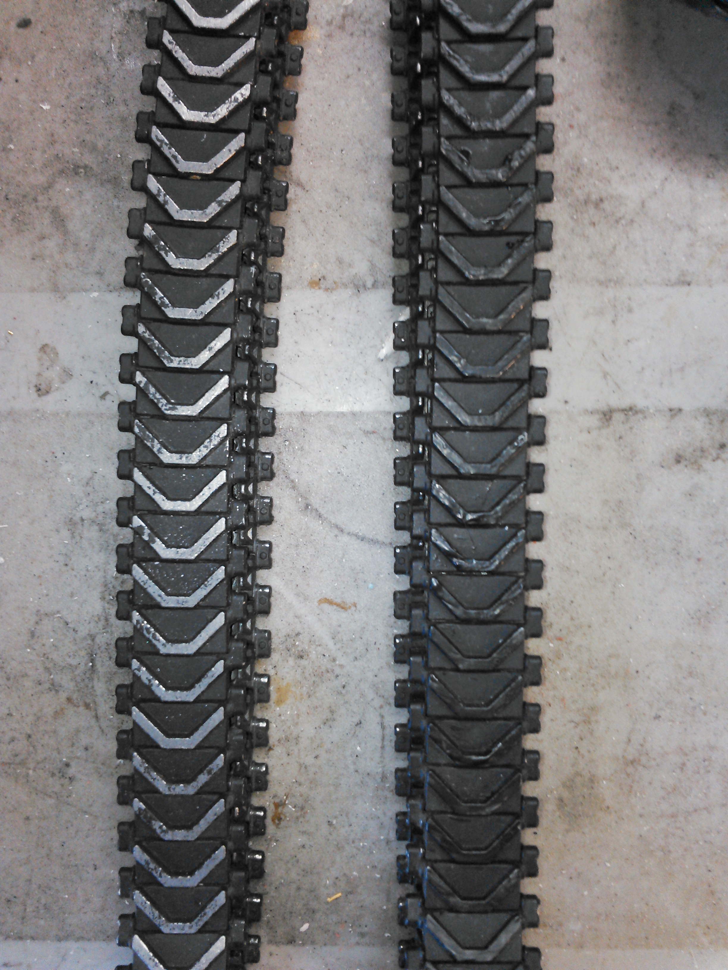

I got some plasti dip and painted it on the tread chevrons. What a pain in the butt that was. That goo doesn't paint.
Any way, Here is a pic of one side completed compared to the other side where the black paint wore off the chevrons. I don't know if this is going to work or not, it might peel off my first spin around the block. I hope I didn't waste a couple hours doing this. If so then I will just switch over to the plastic tracks from my other HL once I put the Mato duckbill T74 on it.
Im going to look into what Dan mentioned about getting Mato plastic tracks with metal links. That sounds interesting

I installed the BARC4 and realized that the Tamiya Apple IR base I put in the turret, wont plug into the BARC, so luckily I had orderd a Battle Armor brand Tamiya apple mount that has the cable plug that fits the BARC, didn't realize they were different, so I had to remove the Tamiya brand mount and install the Battle Armor one. Take note of that everybody....
I hooked up the a servo Y cable from the elevation channel going to my elevation servo, and the BARC Gun input, and the gun servo to the BARC. I have a rate reducer from http://www.dionysusdesign.com/produc...roducts_id/192 on the elevation servo to slow it down, though it only does a little bit.
The BARC operates the recoil, the opposite direction of my servo recoil install, so it wants to push the barrel out of the tank. I had to get a servo reverser to fix this, and because of that, it moved the stop position or full forward, making my barrel pulled backward a bit from where I had it mounted. I had to remove my barrel and take the barrel recoil saddle off and rebuild it so that it was adjustable on the barrel so that the barrel length could be adjusted when the servo sits idle. I turned the screw on the link clip around and soldered it to the saddle and put a nut on the end. Then I drilled a new hole in the saddle and soldered a nut on so a set screw could be used to secure the barrel to the saddle.

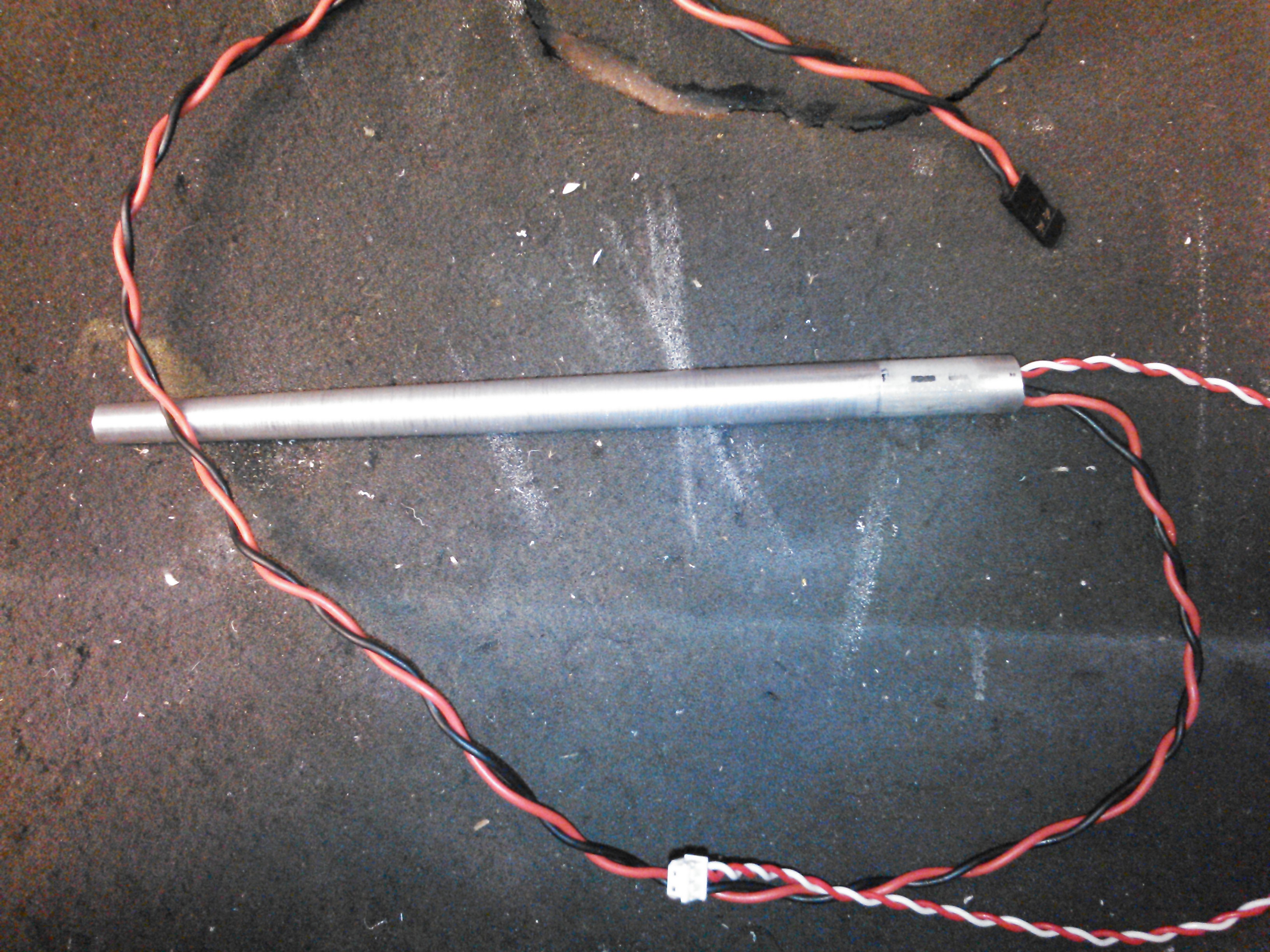

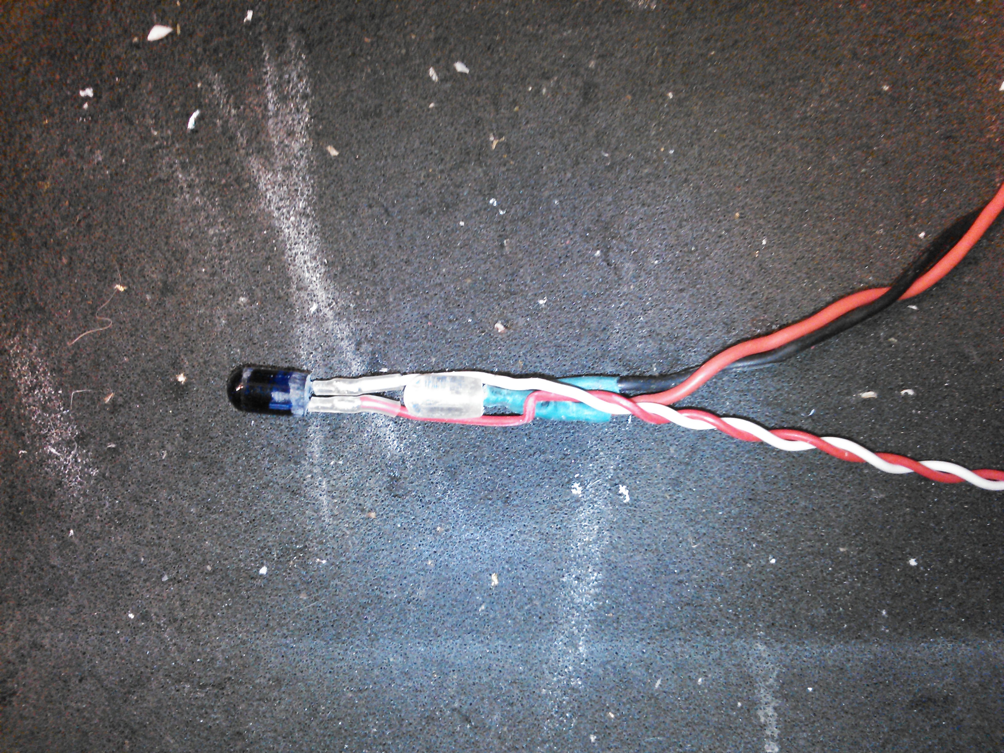

Next I installed my flash LED and my IR LED. I was able to fit both of them in the Nick Aguilar 75mm barrel by filing off the flange of around the LEDs and fitting them in the barrel. I have the IR up front, and the Flash right behind it, painted orange. I filed notches into the sides of the flash LED so that the wires of the IR LED could pass through it as the LED bulbs are the exact outside diameter as the inside diameter of the barrel. This was tricky but worked. The flash was brighter before I painted the orange on it, but it was bright white and I felt orange was more appropriate. Its color and brightness is muffled a lot more in the 75 barrel than in the 105 barrel of my Tamiya. None the less, this worked fine and is quite visible.
Two bulbs in the barrel
How the two LEDs fit together
Look close and you can see the notches filed in the Flash LED to allow the IR wires past it
My new adjustable gun saddle for the recoil
I am not sure how well I like the barc4 yet. The servo recoil is nice and accurate, fast pull slow return. But to fire the gun, you tap stick up left in the corner. Up right is the machine gun. Its much easier to fire the machine gun than the main gun because I use left stick drive right stick turret so the machine gun is my thumb pulling rather than pushing for the main gun. None the less though, most of the time if I am quick enough, My elevation servo doesn't move, even though its on the same channel.
