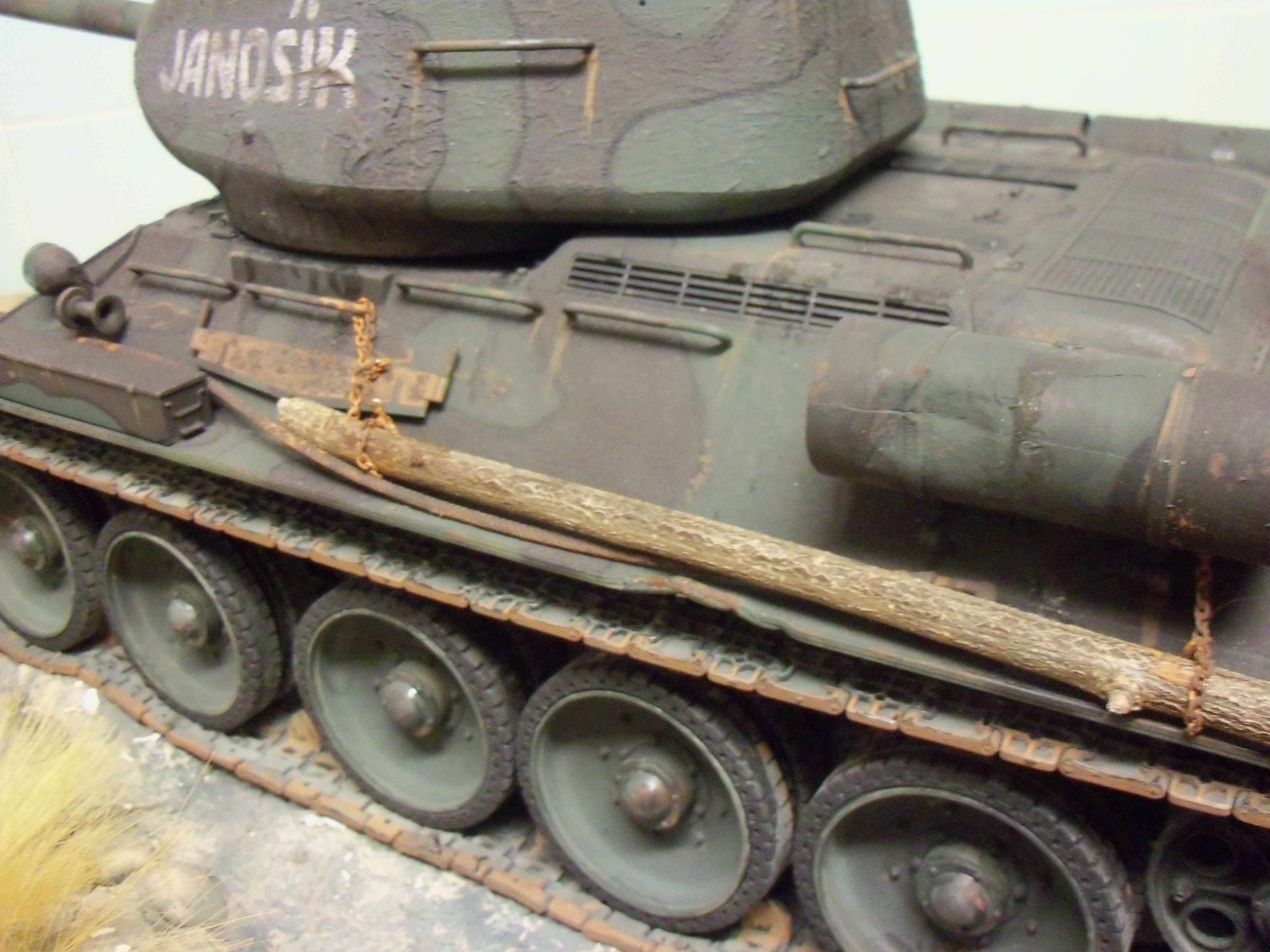

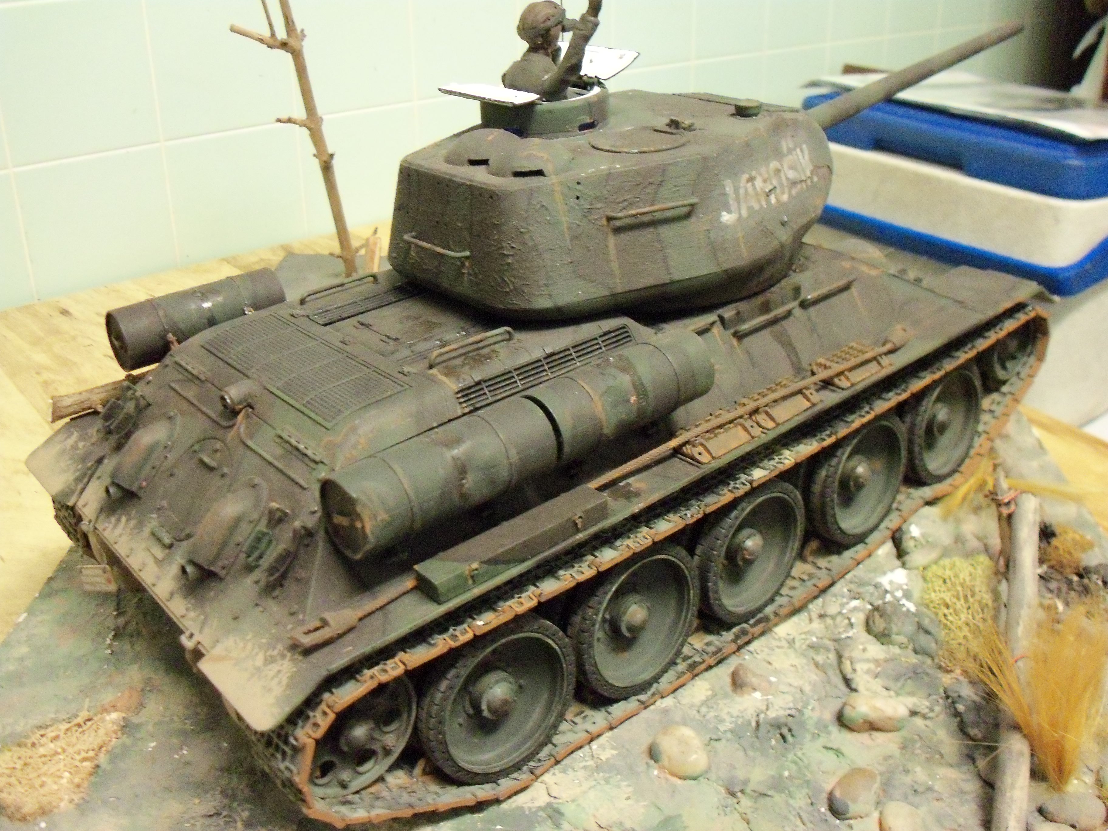

Old 03-10-2015 | 10:24 AM
YHR's Avatar
YHR
Joined: Nov 2006
Posts: 8,976

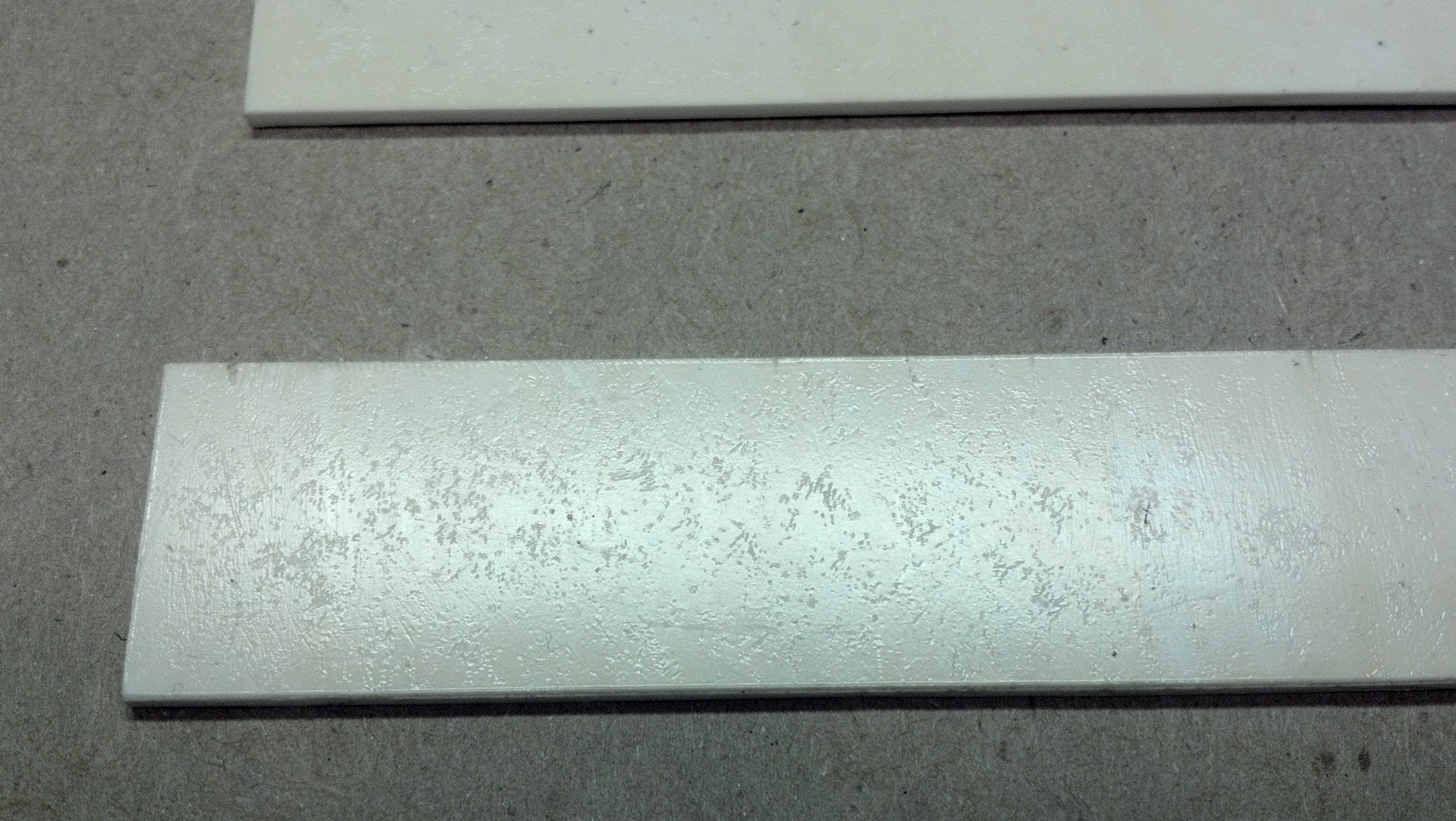

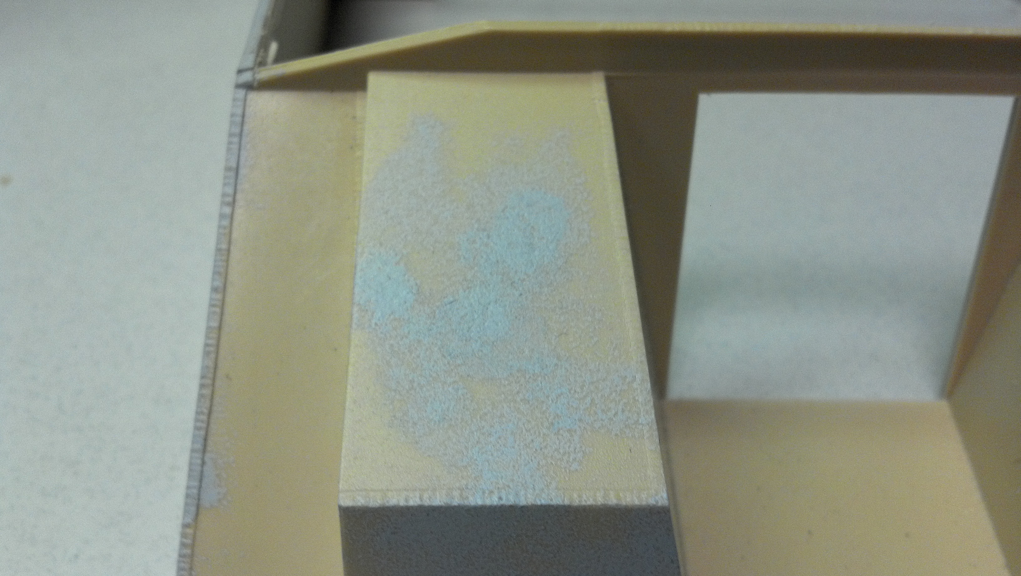

I use Auto body spot glazing. Simple and easy.

Old 03-10-2015 | 12:44 PM
Imex-Erik's Avatar
Joined: Mar 2013
Posts: 3,216
Received 37 Likes on 33 Posts
From: Brooksville , FL
This I will have to try! Is it heavy or a light texture? Think it will stick to ABS or PLA very well?
Old 03-10-2015 | 05:09 PM
YHR's Avatar
YHR
Joined: Nov 2006
Posts: 8,976
Oh ya, It will stick, no fear of it falling off. The stuff I use comes in a tube like toothpaste, with about the same consistency as well

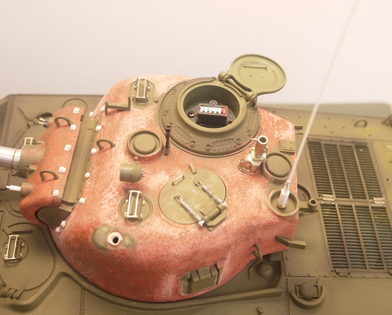

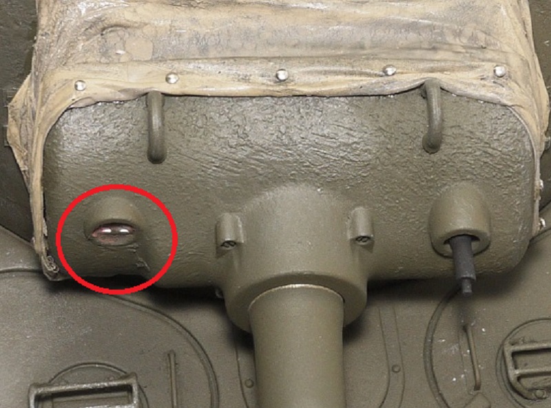

Old 03-10-2015 | 06:40 PM
Captain Nemo12's Avatar
Joined: Apr 2004
Posts: 1,305
From: Montreal, QC, CANADA

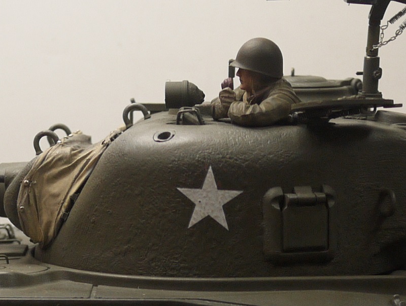

I use Tamiya Liquid Surface Primer:
http://www.tamiyausa.com/items/paint...mer-40ml-87075
I just stipple it on the model surface with an old paintbrush, two or three layers should do the job. I also use drybrushing to bring the textures out during the painting stage. Here are the results of this technique on the mantlet of my E-25:

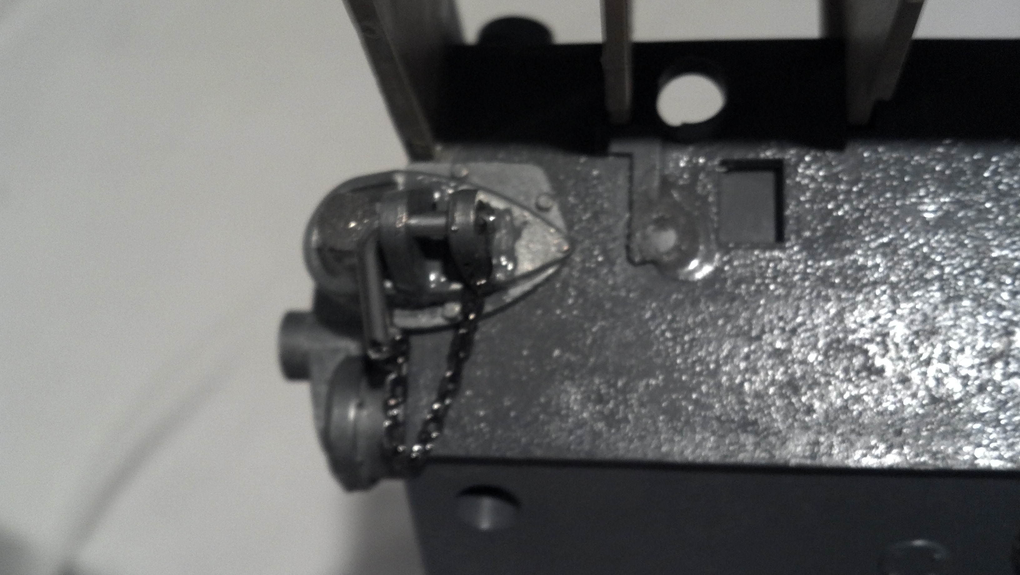

Old 03-11-2015 | 07:04 AM
MAUS45's Avatar
Joined: Jul 2008
Posts: 3,197
Received 38 Likes on 35 Posts
From: Old Hickory, TN

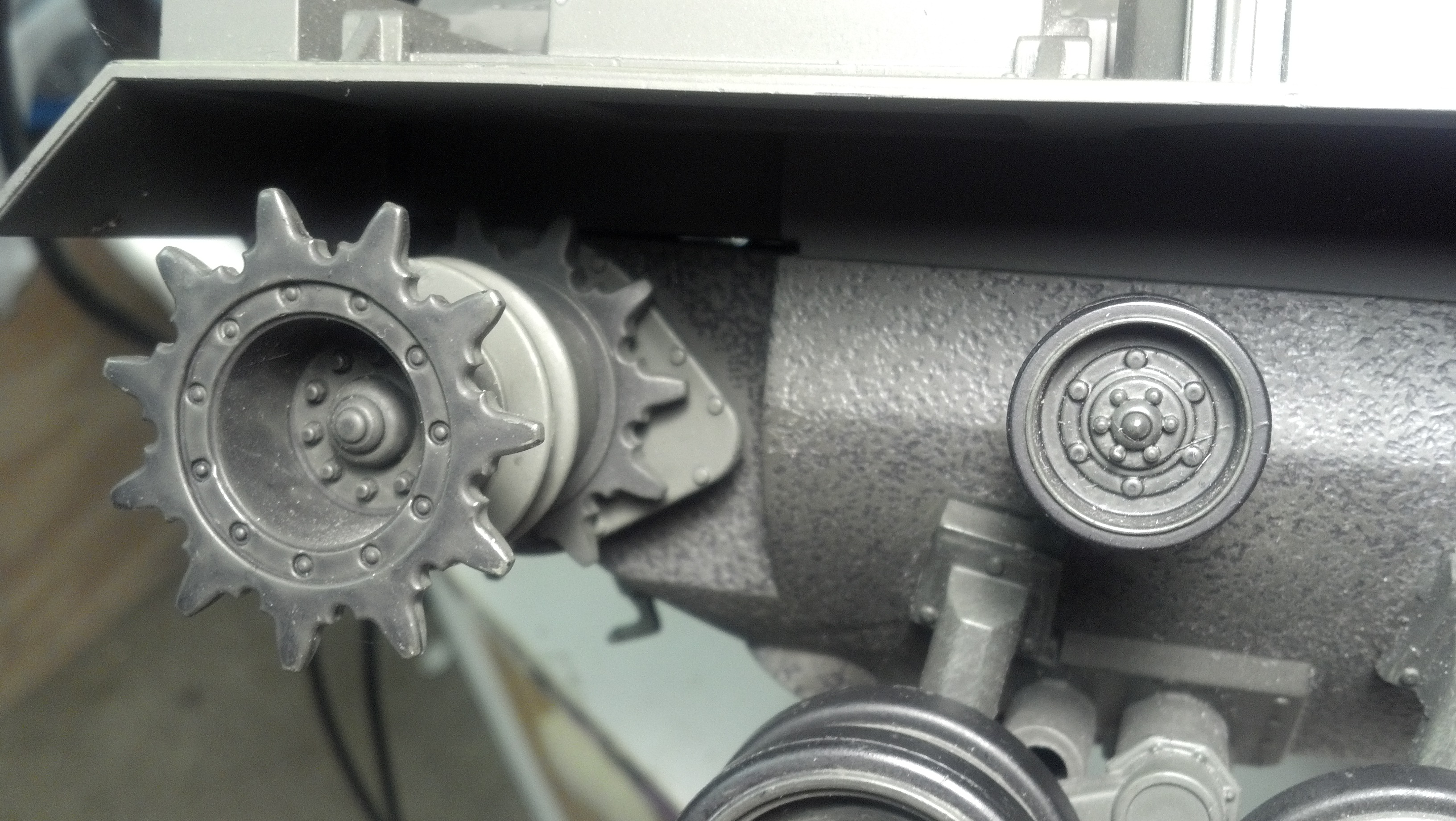

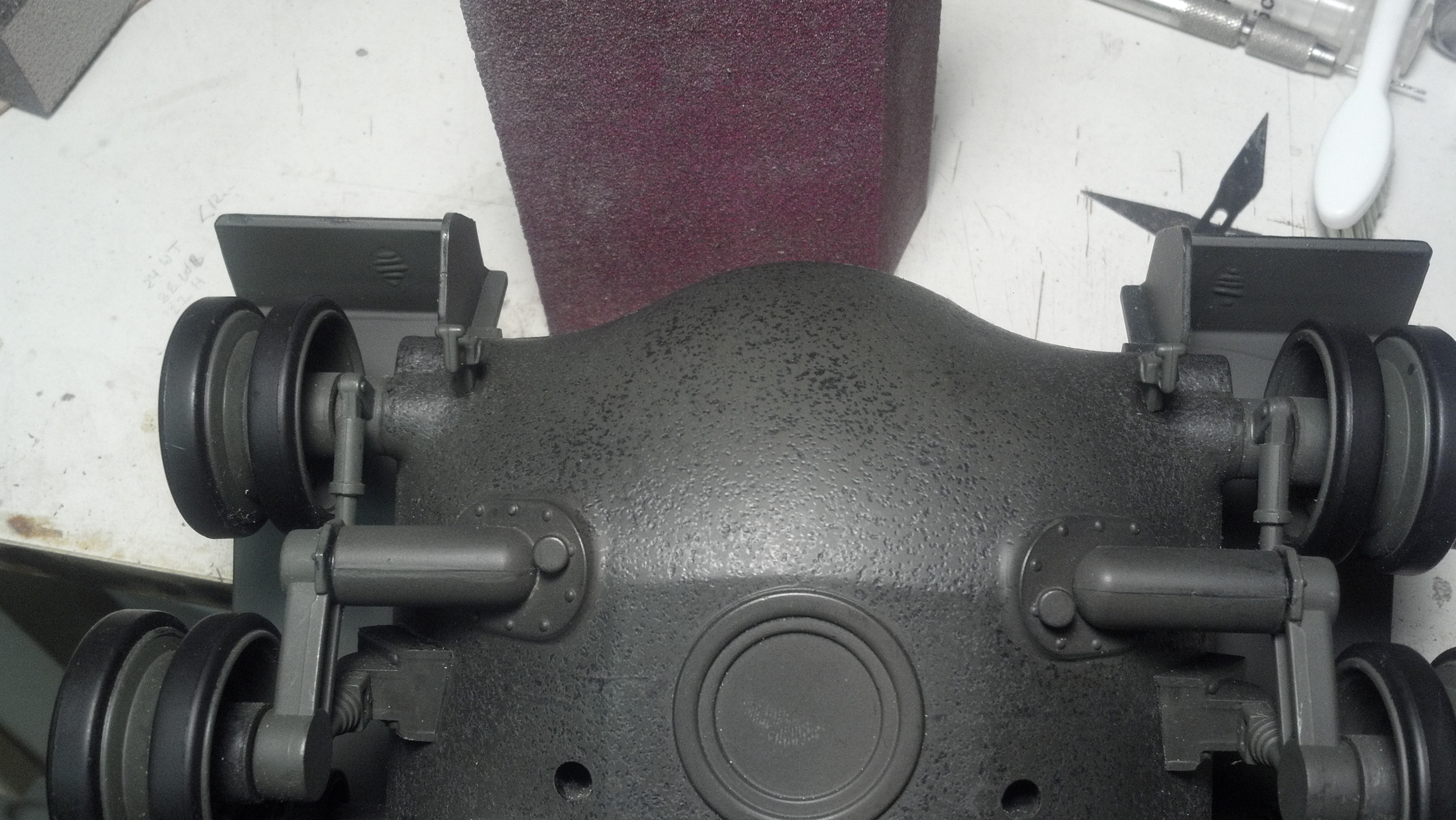

I use liquid cement or Mr. Surfacer 500 or 1000. I use an old tooth brush to stipple the surface when I use the liquid cement and a sponge for the Mr Surfacer. Just depends on how rough the cast effect needs to be as to how much I rough it up with the brush or sponge. I have also used a dremel tool to get a cast effect as well by using a round ball cutter bit to bounce around on the surface I wnat to look cast. It takes longer using this method but looks good. I ahve attached photos of all three methods. 1st set is the liquid glue method, 2nd set is the Mr. Surfacer method and the last set is the Dremel tool method.

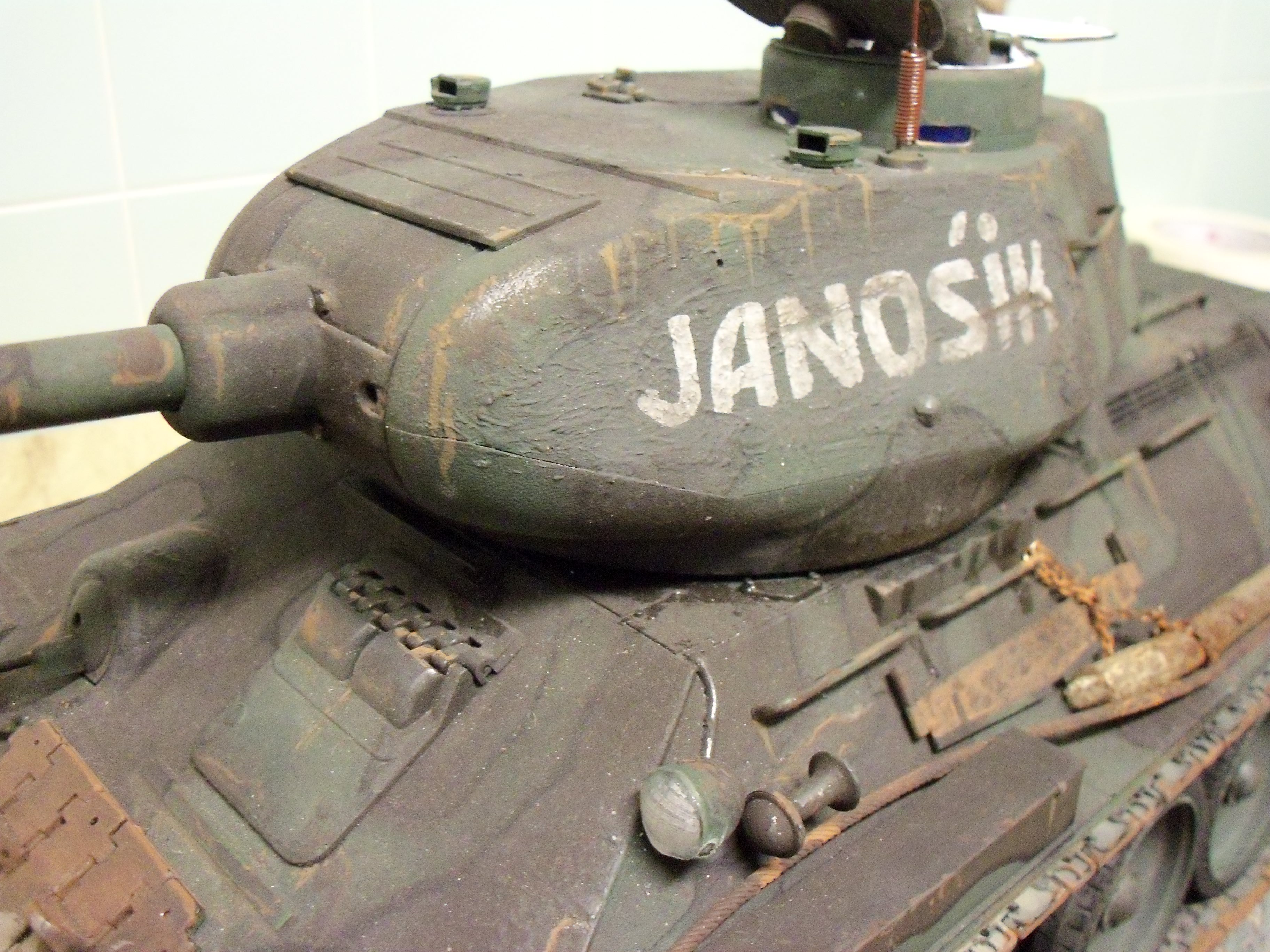

i use drywall mud and the acrylic paint i use mixed together it hardens pretty good and stays on the plastic not sure about metal
