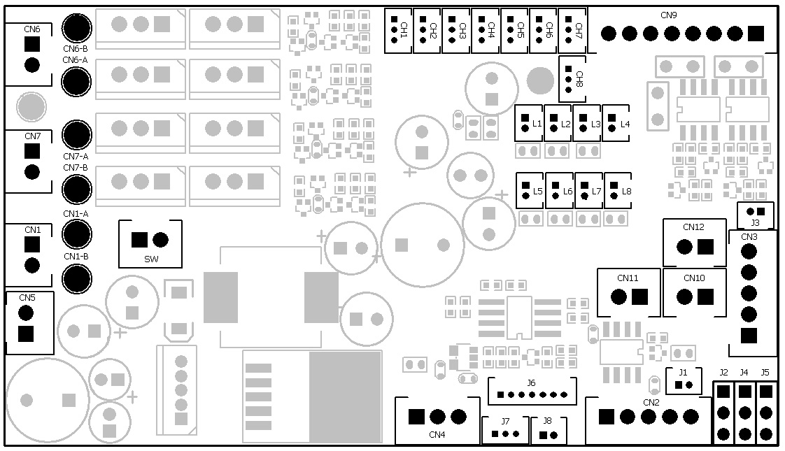

Launching Tk60
With most of software driver are tested OK, we now can lunch TK60, one of the final two building blocks of TK series, here are the overview.
Layout:
Control:
Up to 8 control channel( CH1~8)
Dedicate elevation control channel
Dedicate control channel for 2nd MG channel, sound/light
Dedicate channel to play any of the 3 user's sounds
Track driver(CN6, CN7):
60A max per channel, up to 550 type motor can be used for modern tank,
Additional solder pad for Hi-curret connector is provided on PCB( CN6-A, CN6-B, CN7-A, CN7-B , CN1-A, CN1-B )
IR battle system:
Support Tamiya 1/16, Tamiya 1/35, HengLong and VStank IR format,
Support Machine gun IR code,
Support repair function to simulate a repair tank (bergepanzer)
Support soft skin weight class. One hit and destroyed,
Tamiya-compatible, Small, medium, large caliber cannon IR code, ex. larger caliber code cause more damage,
Enemy fire direction detection, cause different level of damage, ex. fire from the back cause more damage.
Recoil:
Support for Tamiya, HL, Taigen and servo recoil,
Damping factor of servo recoil(J2) can be adjusted
Lights:
4-LED rotating light support, use 4 LEDs to simulate rotating light (L5~L8)
Working brake light (when tail lights and momentum is turned on)
Headlights and tail lights can be switched on and off by transmitter
Smoke Generator:
Heater of smoke Generator can be preheated for large amount of smoke at engine start,(CN12)
Proportional control of smoke generator (full power during engine startup, then proportional to engine revs)
Sounds:
15W, 4~8 ohm on-board amplifier(CN5)
5-Channel, dynamic allocation, smooth transit, sound generator(no delays on sound effect which is caused by priority table like IBU2)
Single to any burst MG sound and light,
2nd MG sound and light effect, also single to any burst(L4)
8M byte on-board memory, pack and program data(J7), like Benedini, no need to edit table, no need of SD card,
Engine sound level is proportional to true engine load and revs
Customizable sounds (22050 Hz, 8-bit & 10-bit, mono wave files), including
-Engine cold start
-Engine warm start
-Engine idle
-Damaged Engine idle
-Engine rev up
-Engine speed steps
-Engine deceleration
-Engine stop
-5x Random track chain squeaks(proportional to engine rev)
-2x Turret rotation, one for manual crank (no engine running) one for powered (engine running)
-Barrel elevation start ( best for modern tank)
-Barrel elevation looping ( best for modern tank)
-Barrel elevation stop ( best for modern tank)
-Turret rotate start ( best for modern tank)
-Turret rotate loop ( best for modern tank)
-Turret rotate stop( best for modern tank)
-Gun shoot
-MG shoot( ex .30cal on Sherman)
-2nd MG shoot( ex .50 cal on Sherman turret)
-Hit
-Bullet bouncing
-Destroyed
-Repair
-3 user sound( voice, music)
Power(CN1):
Automatic tank shutoff at low battery voltage( threshold can be set per battery type)
Others:
Servo elevation output(J4),
External sound card interface(J5).
Dual-axial Gun barrel stabilizer support(J6, TK60G2 version)
Price range:
USD $249 ( ~ equal to IBU2 Pro + TPA) to 399(TK60G2 )
Just let me know, if you need some functions which are not listed, and I will check if it can be included on TK60 board.
Regards,
Clark
