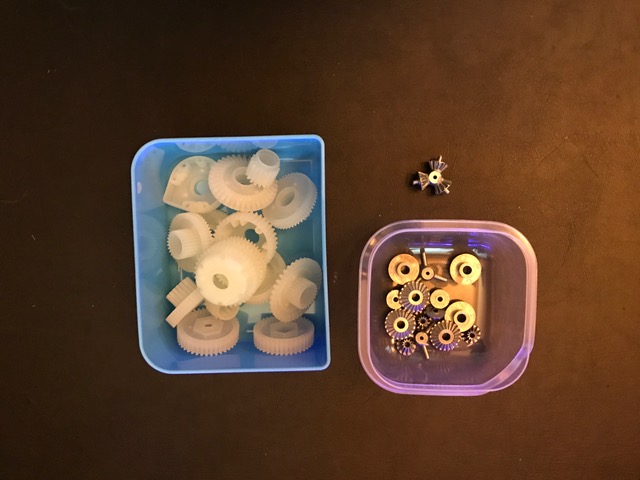

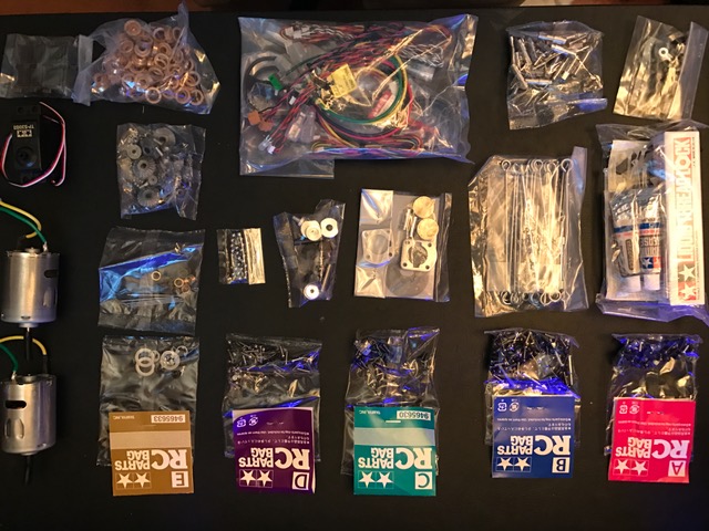

I really appreciate all the suggestions and feedback, it really helps. This model is certainly complex. Now Im worried about the radio and GBS situation working out.
I wanted to post some updates. Just finished building the drive gearbox. Man those parts are tiny. On 3 occasions pieces have flown out of my hands somewhere in my space. I can really admire the craftsmanship of this well thought out gearbox with 3 differentials.
Below is some of the tools I have as well as paints I will use.

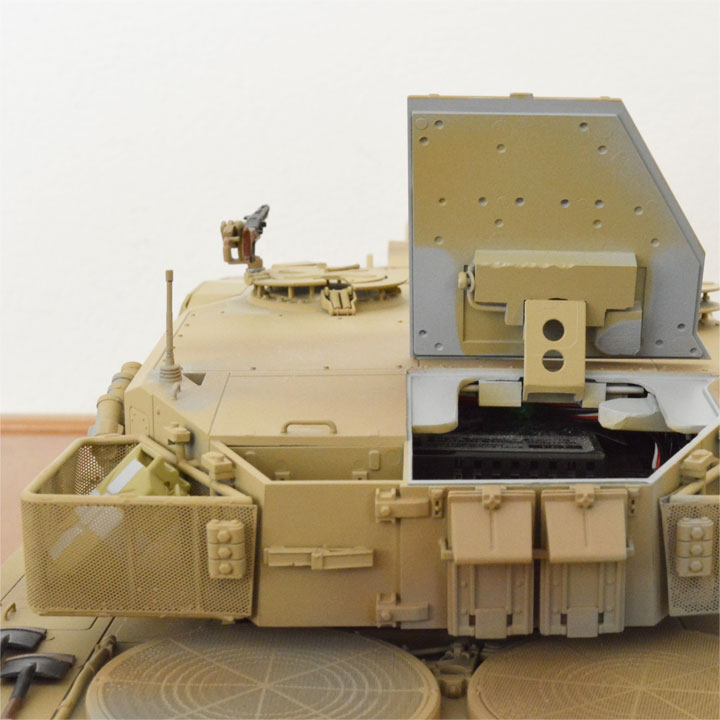

Worth noting the turret sagging issue can be easily overcome by placing a piece of plasticard on the bit of the turret that lifts off at the rear. This provides some support and is a quick and easy solution which should do away with lipos and relocating batteries etc (although lipos are fine in rc tanks as long as they're not abused and you use a low voltage alarm).
Old 12-07-2016 | 07:02 AM
  #43
heavyaslead's Avatar
Posts: 1,918
Received 39 Likes on 27 Posts
From: Loganville, GA
I added a bolt at the rear to solve the sagging problem.
Actually with all the packing of wires and components, that's what really causes the buldging.
A couple screws at the rear to hold the turret cover to the mounting plate works fine in my experience.

If that works for you all, OK, but those three posted alternative kluged solutions, seem to be less than elegant turret design fixes and really do not address the Tamiya Leo design flaw; battery placement.
Operational Empirical Observation: The turret base in my Leo 2, going on six years old now, is straight as an arrow with the DMD, servo, stabilizer and wiring in place, but with no sag, no warping, no kluged fixes and also no tank battery on it (primary culprit). Just as important, during IR play battery swap outs the lift deck solution is great, because it is not awkward to do or use.
And submitted to better upset the Tamiya Leo 2 builder herd and for design consideration for "fizzymike's" build: a Leo 2 hinged DMD hatch cover by "DT" for easy access during battle games, plus you will not misplace the hatch cover.
Merry Christmas,
John
