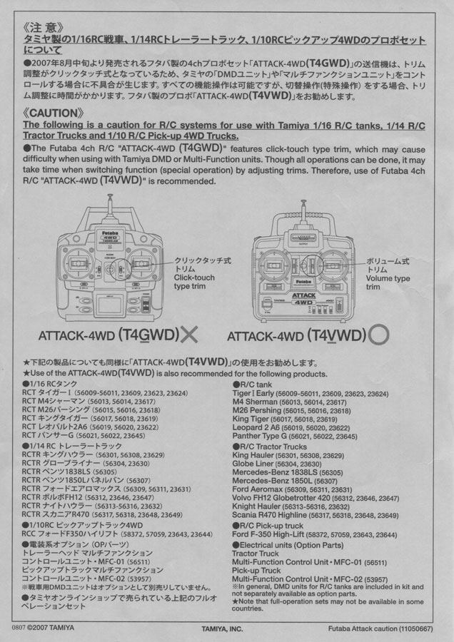

Originally Posted by Pcomm1.v2
This printed notice came in my Tamiya Leopard 2A6 Kit.
Dammit. Just wasted money. Damn.

The problem with the radio is the digital trim. Other Futaba Attacks and the rebranded Attacks Tamiya includes with their home island kits have analog trims that are instant.
The only drawback is they might not respond as quick when panning between elevation and fire or MG fire. There are easy workarounds with setup via travel limits, but most guys who battle eventually install momentary switches to fire anyway.
Don't be discouraged by the Tx.
If you do a search on rcu tanks you will discover the radio you purchased is not recommended for Tamiya rc tanks. Like the above Tamiya printed notice says, the radio you purchased is best used with Tamiya rc big rig trucks.
You will not be happy with the function delay as you try to access various effects like cannon fire etc. If your OK with a poorly functioning Leo 2, well no harm then.
Why not take the radio back to the store, this is not new news, and tell them they sold you the wrong radio for your kit. Print out the Tamiya notice above and take it with you, if you do not have the blue notice sheet that came with your Leopard 2 kit. Do not give up that easy.
John
Thx John. I'm going to take it back to hobby shop. I also printed the notice you posted to get the correct one. Thx again.

If you can take the radio back for full refund that'll be the way to go. If not, it WILL still work. You'll just have to learn the tx a bit on the trim and endpoint settings to get it to operate the aux functions. For the most part these are all novelty functions anyways, Like Ausf said, don't be discouraged if you can't return it. Other than turning the stabilizer on/off all the light/drive modes can be switched on the DMD/MF manually as well. Yes, this isn't practical in the middle of an IR battle, but it's there and these settings would usually be set before a battle.

The radio is programmable so you wouldn't have problems programing and to avoid the use of the trims.
I have done with Futaba 6J and Turnigy.
It works better and you don't need to use the trims.
