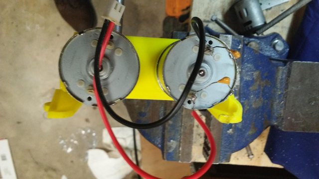

Well, I had the first go 3D printed - horrible design mistake though - the motors don't fit! The holes are too low. Simple fix, but this one was wasted.
Steve

Man I totally screwed the pooch on the placement of the motor - used the drawings provided on Amazon - not sure if the drawings are wrong or I screwed up. But the motor is larger than the dimensions said. Anyway I cut away some plastic - lost 2 mount point screws but hopefully 4 will be enough. If not I may have to make an adapter plate or something. Also my motor mount holes did not line up. Have to print another one tomorrow.
I was able to salvage the original shaft from the plastic HL transmission - bought some 6mm spacers from McMaster-Carr and drilled them out to press onto the knurled HL shaft. The gearing works.
Steve

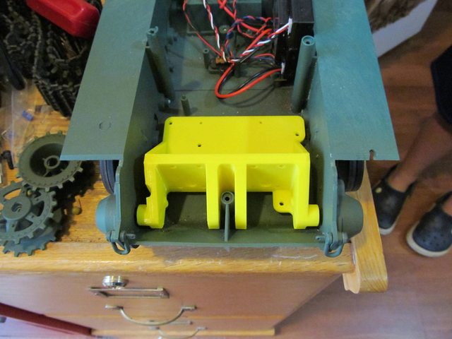

Here is an update.
I revised the design to lighten the frame and use less plastic, making it faster and cheaper to print.
Also, I angled the motors slightly so that they do not interfere with some of the old mounting and alignment holes for the original transmissions. This way you do not have to modify your tank at all to use this transmission.
I am able to salvage the main shafts from the original Heng Long transmission to save on cost and ease manufacturing.

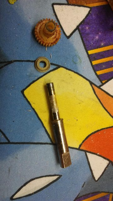

First, we remove the main shaft from the original Heng Long transmission:
Then we need to remove the gear pressed onto it. We can start moving it by using a pair of pliers to bear against the side of the gear, and tap it off the spline. Then we can finish driving the shaft out using a small punch.

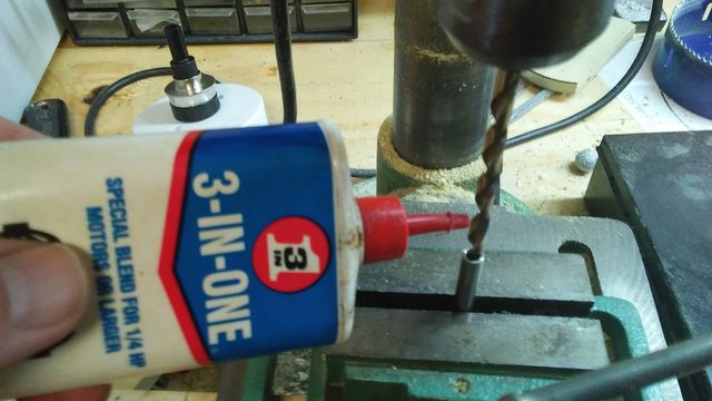

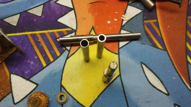

Next I found some 6mm OD x 45mm spacers, which can be used to lengthen the stock Heng Long shaft. But to make it fit we have to drill it out. I believe I used a #9 drill bit. You want to drill it out just slightly smaller than the knurling on the original shaft.
After it is drilled out, we can use a bench vice to easily press the shaft over the spline on the original shaft. This completes the shaft.

The holes in the 3D printed part are deliberately undersized, so next I drill them out to accept the shafts with a perfect fit. It's likely that with this plastic no bearings will be necessary. If they turn out to be necessary, it will be trivial to add them simply by drilling the holes a bit larger.

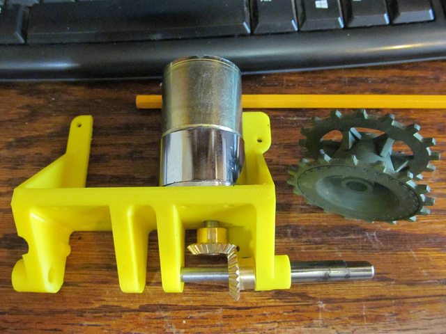

To set the spacing of the gears, first slip a bevel gear onto the motor shaft, and then temporarily install the main shaft and its bevel gear. Push the bevel gear on the motor shaft as far forward as needed to fully engage the main shaft bevel gear, and tighten its set screw onto the motor shaft.
Then remove the main shaft and its bevel gear - you can't install the transmission in the tank with the main shafts in place.

Finally, we install the transmission in the tank, and re-install the main shafts and their bevel gears.
