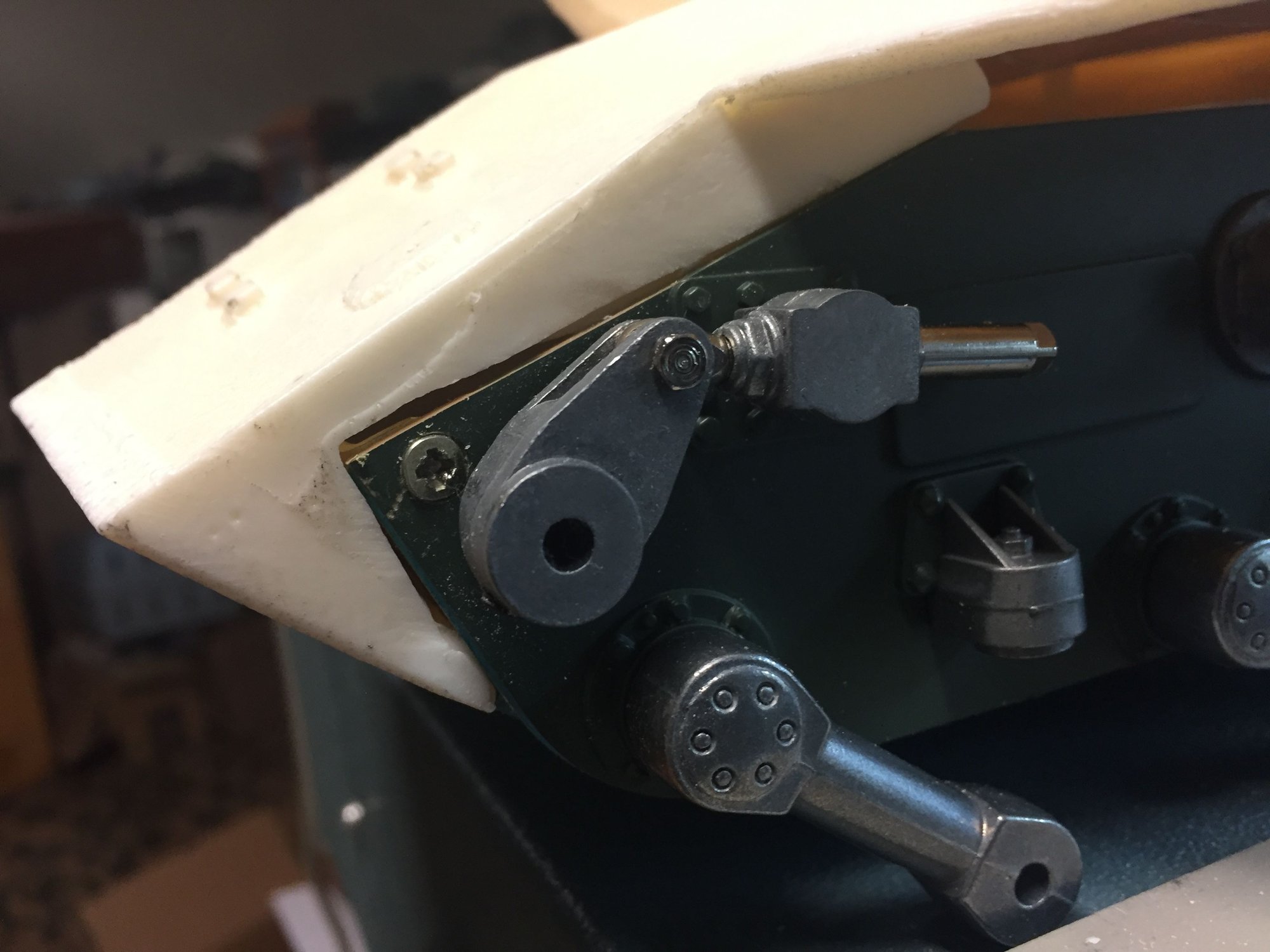

Okay, so got the kit, and a Taigen KV1 metal chassis. I have the top and bottom hulls fitted together by dremel work on the rear to narrow the top hull enough to allow for the extra thickness of the aluminum. So after placing test gearboxes in place, I cannot get the top hull over the rear of the gearboxes. Should I just flex it over? or??
I'm thinking of cutting the rear, lower portion off, and screwing it to the chassis to stiffen it, and avoid the interference with the gear boxes.
thanks for any help, Jerry

So I took the plunge yesterday and sliced the rear upper plate in two. It was 0.250 inches thick, so with the thin, deep saw I used, I'm left with almost an eighth inch on top and bottom. It now aligns fore and aft due to the angle of the halved plate. The torsional rigidity is now restored, and I can use the Taigen quick release also. Much better IMHO than the HL chassis.

Thanks Maus, I wish I cut it a little straighter, but it will do I guess. Those thin saws do flex a bit. On to the turret issues I guess. The upper hull sits lower than the KV's, so I don't have clearance for an airsoft with the FR7 speaker in place. The disc the turret sits on is uneven, and very flexible, so I hope to make new out of 1/8 inch aluminum plate.

Reviewing your work, i would have done the same mod to the upper hull kit that you did. Nice work.

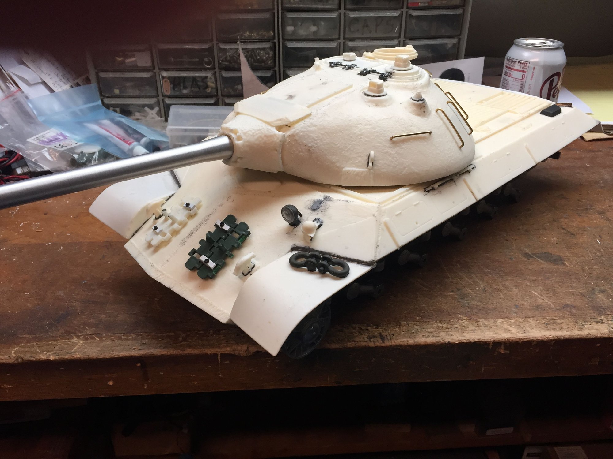

A short update, things are coming together:
JS2 shackles, front headlight from damaged JS2 upper hull.
JS2 exhaust outlets and barrel rest. Had to make piece behind vent sheet since provided piece was too fragile. Note rear and front flaps over tracks are slightly different width, which is consistant with close observation of actual tank.
I decided to make the turret top removable, makes it easy to work on....ledge where turret base rests was uneven so I put jacking screws which have small magnets pressed into base so it snaps into place. I can jack the turret to gain minimum distance between upper hull and bottom of turret shell.

Wow you have made great progress. Like what you did with the turret. So will paint it as Russian or Egyptian?
