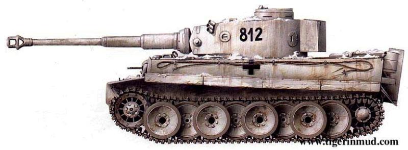

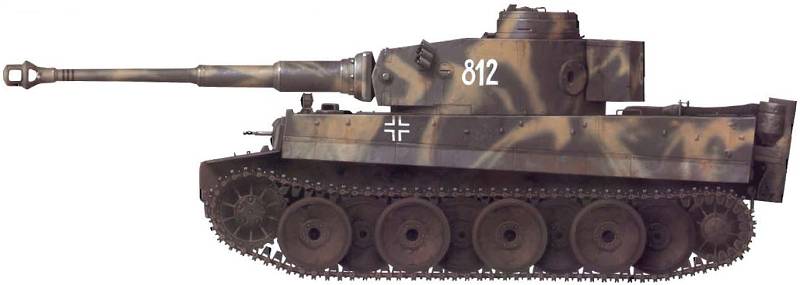

Lots to do but I am happy with the likeness, you could sit and pick all day but that would be pointless, for me its close enough.
ID:	621429   Click image for larger version

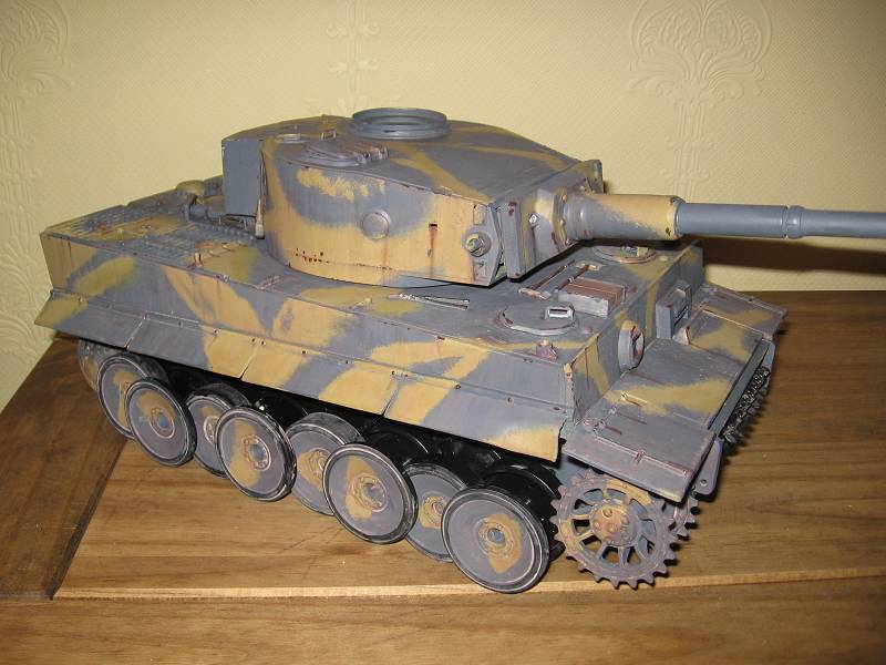

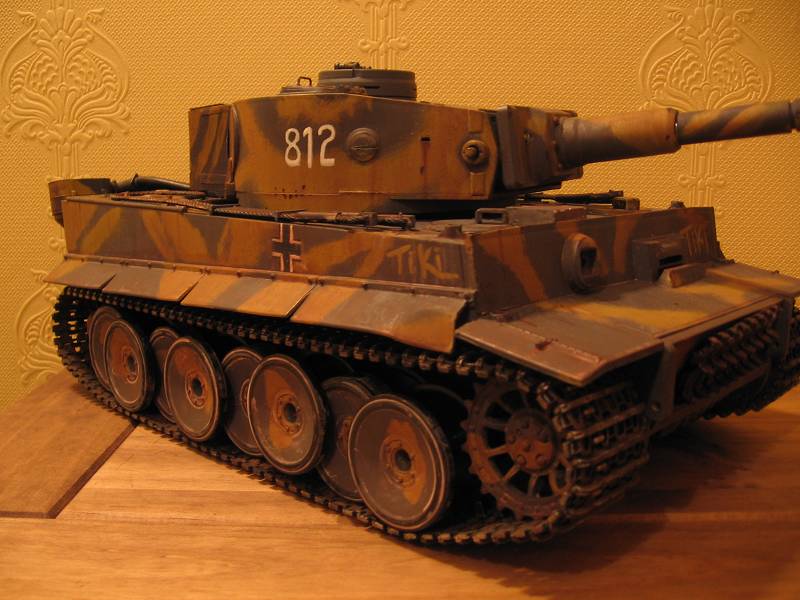

OK, the weathering will darken up the finish, but this is how things are looking. Time to put the brushes down for a bit now and get the build finished. Then I can complete the whole effect. I have some brass sheet to make detail like straps, bin lids etc etc.
ID:	626701   Click image for larger version

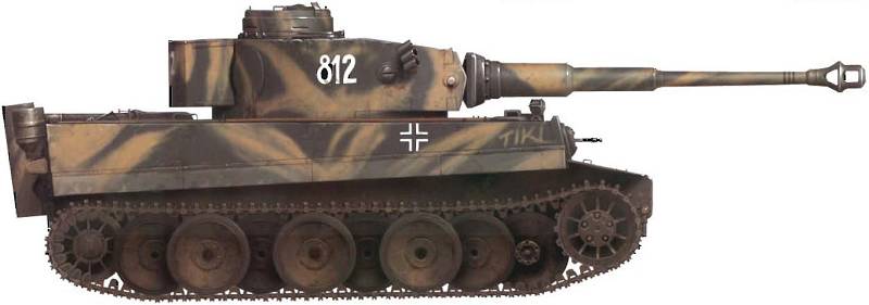

seen the one below before?

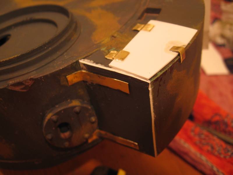

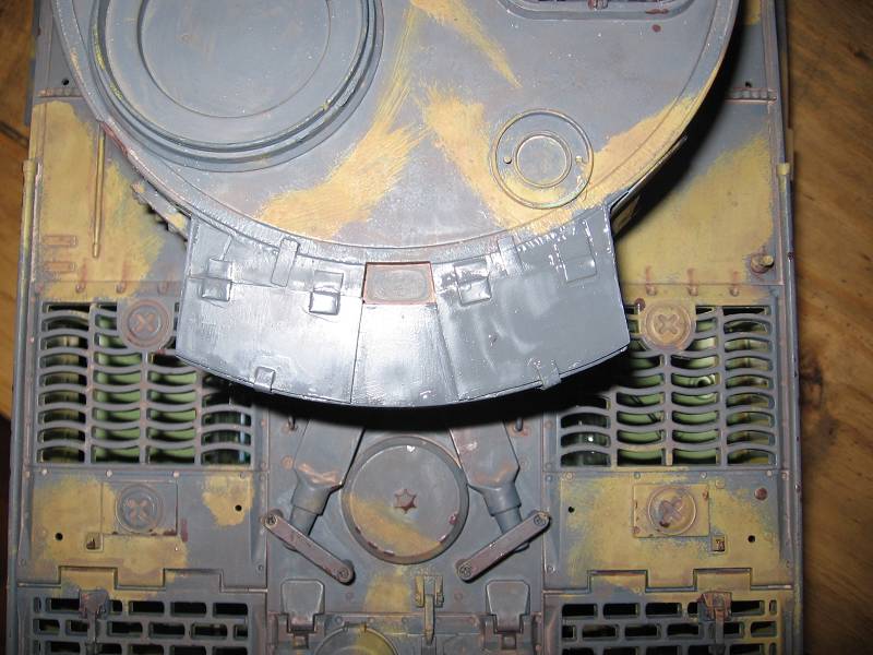

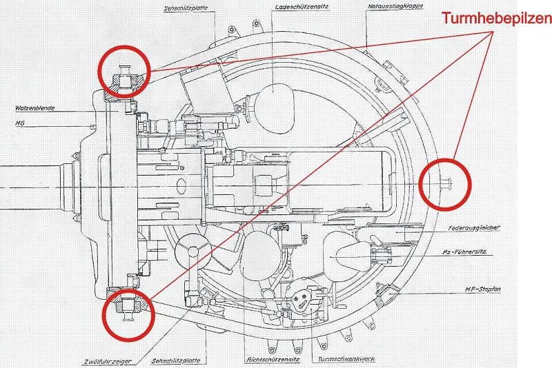

well, the tough bits are happening. Having to get this tank right without aftermarket stuff is testing my mini fabrication skills. The stowage bin is a challenge, making hinges and supports etc. Well this is what I have so far, as always they seem to look better innatural light. The bin basically need to be made larger and tangential to the turret curve. I used plastic card and some brass sheet I had. For the lid hinges and clips, just chopped up brass angle, i liked the bent and used effect hey gave as opposed to neat and new looking Aftermarket etched stuff. These things get battered and twisted over time and that is the effect I wanted.
Next is to paint the stowage area, fit decals and give the tank one deep and dark flat wash to age the paintwork. I am not going for any battle damge, just the curled fender on the RH side as seen in pics. Just chipping and a few rust runs and she will be done on the outside.
Jose, can you confirm these 'mushrooms' are the turret pivot points??? I think that is what you mean?
cheers

Hallo Bill
Eheheheh....."a simple modification"....eehhheheh!!
Each time you post an image I feel the urge to begin with a Tiki. I like the idea of not over-damaging your Tiger. Nice hinges and supports details. Keep on with your nice work!
The "Turmhebepilzen" also known as "Pilzen"(mushrooms) were the tower lifting points (3) mushroom-shaped.Two were fitted at the outside of the gun trunnions and the third at the rearmost upper middle of the turret. The reproduction of the side "Pilzen" needs just two disks of any suited material to be cemented to the outside of the existing HL trunnions. The rear "mushroom" is a little more difficult to implement in an HL Tiger, as you need to increase the depth of the hole between the stowage bins. maximum inside depth is limited to 7mm if you intend to keep the firing mechanism.
The sketch comes from the Tiger Info Center and has real quotes in mm.
Hope it helps

Ahhh, that is more than perfect. thanks jose

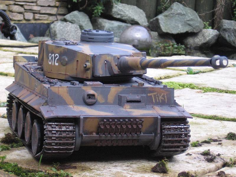

Default RE: 'Tiki' build thread
mmm, hand painting turret numbers isnt easy, its looks ok though I think. Plenty of detailing to go yet, but for now, here are some shots.

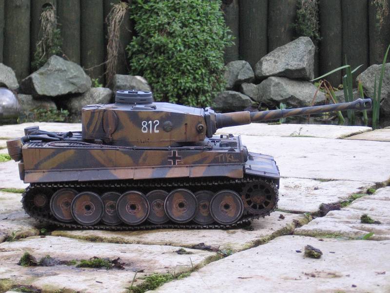

Just some pics in natural light. Almost done, just need to add the mushrooms, cut the slits in the turret, sort the hatch and launchers.
