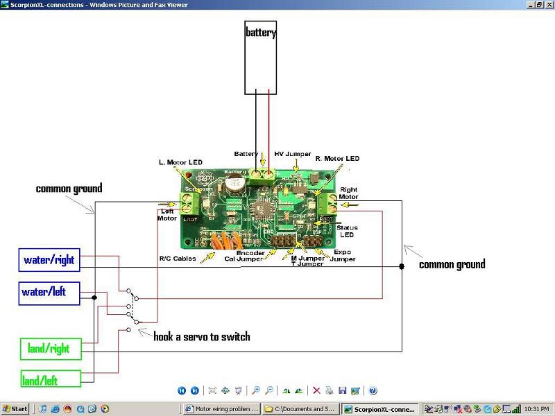

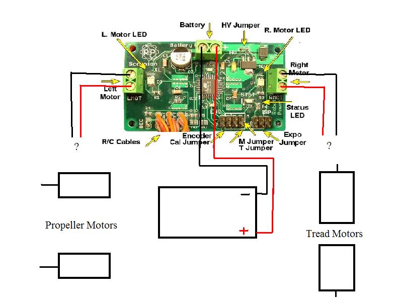

I need some help, i've been trying to figure this out all night but I cant seem to come up with simple solution. I'm putting 4 motors in my tank, 2 driving the treads, and 2 driving propellers for water driving. and I want to make it so a servo switches power in-between the sets of motors so there not both running all the time. heres a diagram. anyone know how to do this?

you could try using a switch like this
http://www.allelectronics.com/cgi-bi..._BUSHING_.html
it is a "Dual Position-Dual Throw.....On/On"
It has a long enough stem that you could rig to a servo somehow.
Hope diagram helps(positive wires are hooked to switch)

yup, just use two of those swithes and use a servo so that when at one extreme....activates one switch, when at other extreme....activates second switch.
Also, I think you would need a servo that would stay in place once activated....like a two position servo( I think they make those)
Also, your motor "polarity" may be different than what I have drawn...not a big deal though

If using two of these switches...which I think is a bad idea,because they have to be hit twice(once to turn on and then once to turn off) so good luck getting a servo to do THAT!!!!
I would use just one of the DPDT and call it a day....its either in one position or the other,thus easier to hook up to a servo.
You also might want to try a solenoid to throw the switch instead of a servo,this one is 12vdc but might work with 7.2vdc
http://www.allelectronics.com/cgi-bi...SOLENOID_.html
A basic understanding of reading schematics is also helpful......
