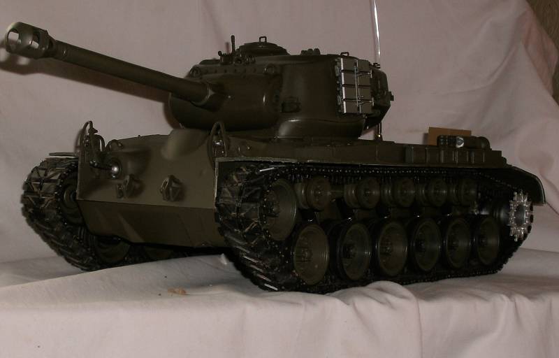

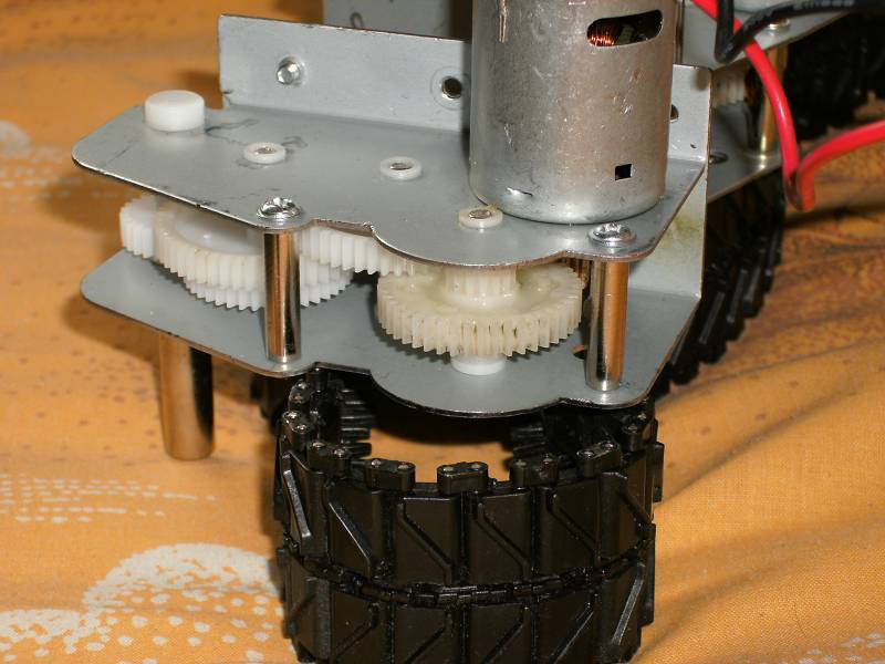

I bought a HL snow leopard a month ago and so far I have glued up the slipper clutches with epoxy resin (plastic gear boxes) and removed the side skirts and front fenders.
I am thinking of putting in the El Mod gear, but at the moment finances prevent this.
this tank has a rx 14 board in it so it will be easier to fit the El mod gear (no soldering)
a picture showing the tank without the side skirts and fenders the second picture is one of the slipper clutch glued up

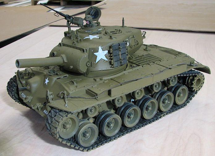

Brel found one of Pattoncommanders Pershings this is his M45 and clearly shows the skirts lifted for use as storage
Bill hope you don't mind me pinching your picture[][]

thanks Rob, how come it has a shorter gun barrel than normal
Old 08-02-2008 | 04:18 PM
Joined: Mar 2008
Posts: 2,147
Received 39 Likes on 31 Posts
From: Peterborough, UNITED KINGDOM
Default RE: pershing M26 (hl Snow leopard)
The M45 had a 105mm howitzer (like the Tamiya Sherman). If you search around, Bill (Pattoncommander) has posted a fair amount of info on it.

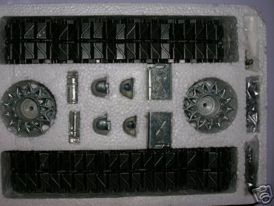

just ordered the metal track upgrade set from blueslateman on the evil bay.

if you get the replacement PzIII springs from the blueslatesman
They are a direct swap out for the pershing springs and stop you getting a saggy butt when you put the metal tracks on
the procedure is the same as my bulldog
but check your pershing first though as one of mine had thicker stronger springs on the four corners so it might not be needed
they are real easy to spot as the coils look thicker

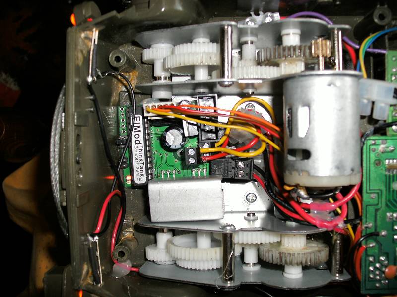

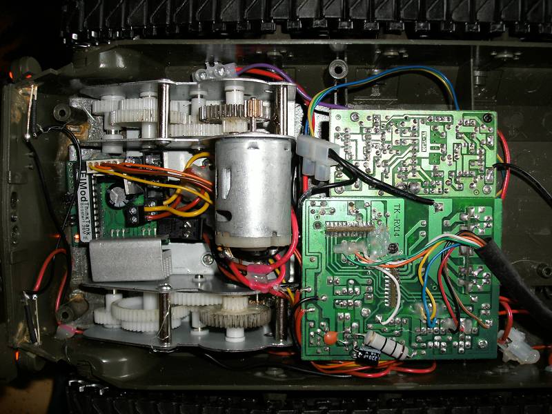

Old 08-06-2008 | 11:39 AM
Banned
Joined: Feb 2008
Posts: 631
From: Stone Staffordshire, UNITED KINGDOM
I have took the Elmod booster and TLS units out of the tiger and fitted them to the Pershing putting the booster where the smoker was and the TLS under the rear deck next to the turret motor on the RH side
I will replace the plastic gear boxes after they have broken whilst running with the metal tracks that I am expecting shortly

I got the tracks this afternoon and have just fitted them and the metal drive sprockets, the metal track look a lot better than the plastic ones. oh why oh why do the makers insist that the drive sprockets are a nice and shiny silver colour when the rest of the road/return wheels and idlers are painted green like the rest of the tank, got to get some paint to paint the drive sprockets to match the rest of the tank.
