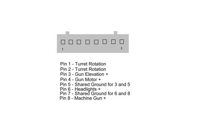

I am in search of if someone has the wiring diagram (schematic) for the tiger I, I replaced the RX14 main board with the RX18 board awhile back then got cough up with other things,now I cant find my schematic that I made and need your help so please be a pal it's been a long time since I had a tiger up and running.

no this is not what I'm looking for.I have a copy of this,with the wires being different in the same tanks , your tiger his tiger my tiger heng long does not always use red as positive never mind the other colours etc,so im interested in is this wire goes from hear to there, thanks Wayne

From Saxon's post, use the 8 pin turret connector diagram ("CN9" on the RX18 diagram itself). Wire color as you mentioned doesn't matter, as the function is determined by pin, you only need to figure out which is "pin 1" and you are good to go from there.
At least as I understand your problem.

Does this help?
