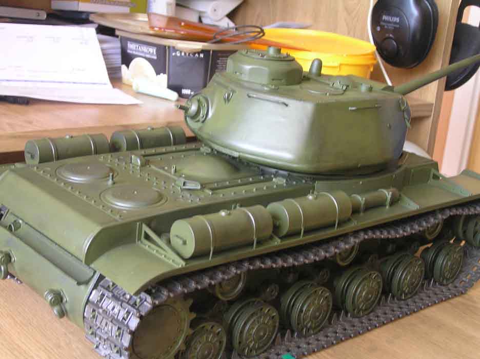

nice setup...very clean install. Better make sure you replace that plastic gearbox with a metal one...

wsn123 keep the pic's coming as you finish it as long as your taking it this far think about the Asiatam metal lower hull that's what im doing to mine and have the KV-85 turret coming also .

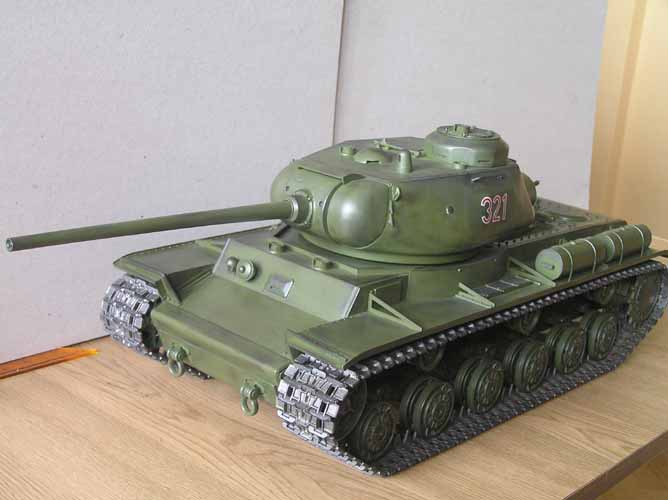

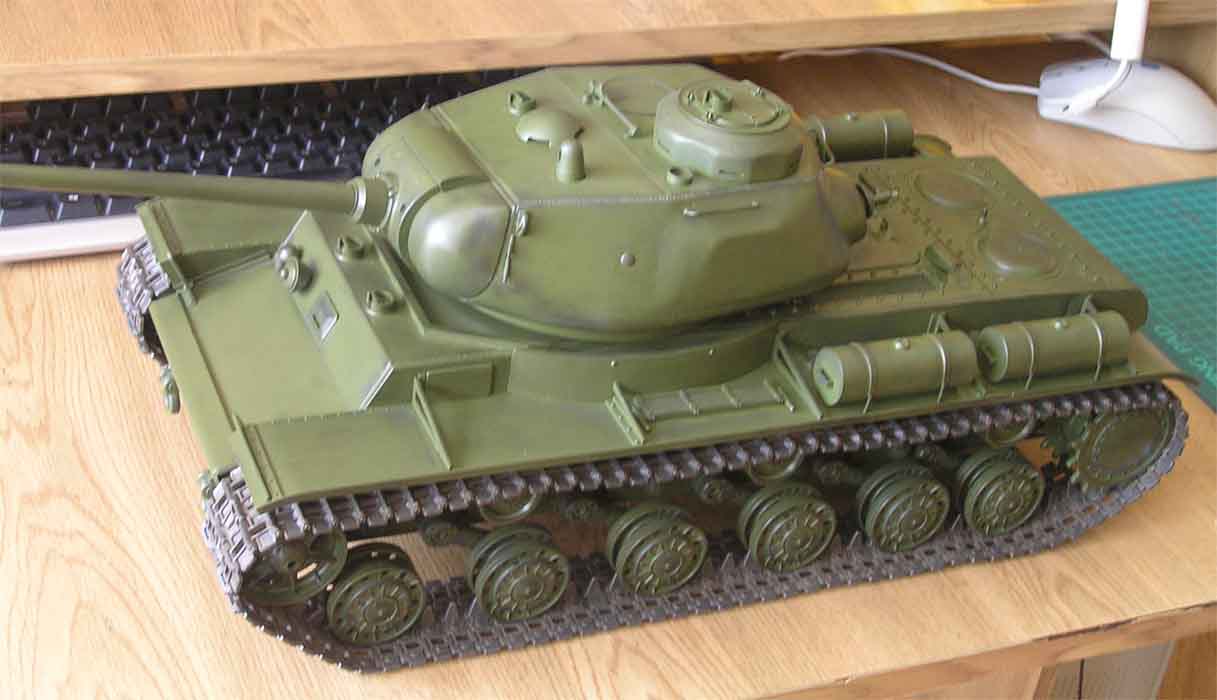

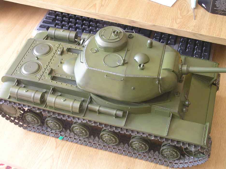

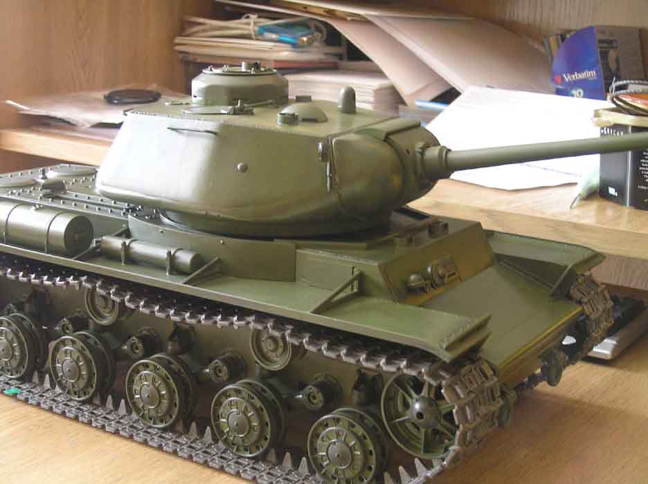

Thank You
and the next pictures ....

Looks good how is the HL recoil working with the Tamiya electronics or did you just use the barrel that came with the kit .

After seeing your pictures of the KV-85 wsn123, I really wished I had went ahead and got the Profiline kit too. Yours turned out so clean and really, doesn't look like an aftermarket was added on but like it came straight from the box like that.
Nice work and weathering as well!

I'll second what Panther said, great build. What color green did you paint yours?

That KV-85 looks almost perfect. Only thing it is lacking are the late road wheels and return rollers.

Excellent work on the KV-85! Really looks good!<div>
</div><div>So what steps did you take to secure the resin kit?</div>

1. I used the original Tamiya recoil and gun elevation units - so it wasn't any problems with Tamiya electronics. The turret rotation unit is taken from Heng Long KV-1 and it is working with Tamiya properly.
2. I adopted the plastic barrel from my second damaged WSN T34/85. The original Profiline KV-85 resin barrel wasn't driled inside and it was difficult for me to to place the Tamiya flashing unit at the tip of the gun barrel.
3. The model was painted with Tamiya "Olive drab 2" TS-28 and Tamiya weathering master set B
