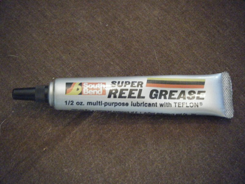

Tony, I use fishing reel grease... has teflon and is safe for plastic parts and you can find it just about anywhere. It's thick like the Tamiya ~ not like an oil.

Well, that's different, John! lol Never heard that recommendation before and I don't doubt that it works. But, after spending the amount that I have for the Leopard.....I don't know if I want to try something that I'munfamiliarwith. Especially with the Leo which won't allow me to observe the gears after time without a totaldissembleof the gearbox. I have a ton of silicone grease and I know that works and use it on my HL's and Pershing, but I figured I'd stick with Tamiya's recommendation this time once I begin my build.
I've read the Finish Lineingredientsand it states that it uses boron nitride just as Tamiya does....but Finish Line also states that their grease is for bearings....but I'm unsure if it's safe for plastic which is my primary concern although it's aTeflonsyntheticgrease.<br type="_moz" />

Hey Ern Thanks!<div>
</div><div>How well does it work in comparison to ball diff grease?</div>

The LEO gear boxes are not the same as any other gear box. they are a very complicated unit and they use nylon gears. Or a material like nylon. Any plastic safe lube should be fine Tony. As far as the oil and toothpaste trick goes, I would not try that on this unit. There are no steel replacement gears available for the LEO that i know of. The small tube of ceramic grease that was supplied wi5th the kit should be more than enough to properly grease the gear box. Remember it is a sealed unit once the cover is installed so you dont have the problem of the grease flying out all over the place. It will stay in the gear box.

Hello Tony
I used white lithium grease from ACE hardware about 5 bucks for 10oz. more than enough.
Unlike oil, it is 'sticky' like Tamiya ceramic so it won't leak out the seams.
I use it for all the wheels, gears and sleeves.
Totally harmless to plastics of all types used in the Leo kit.
