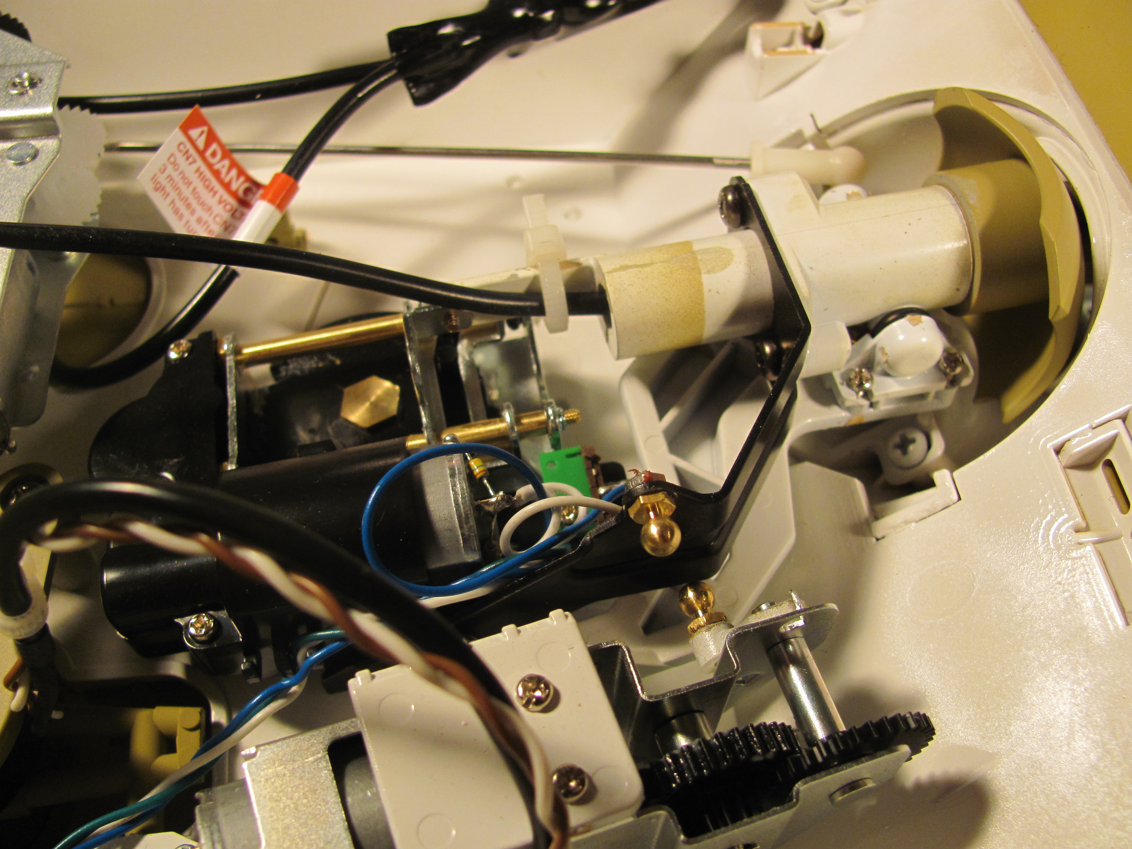

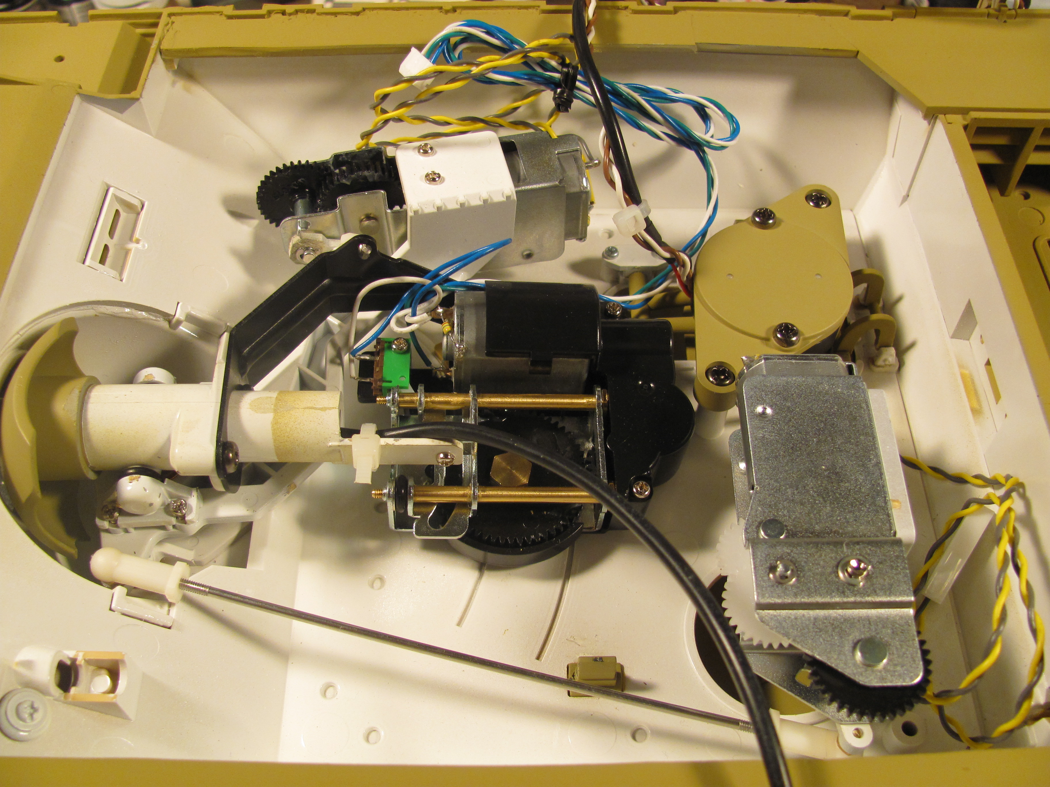

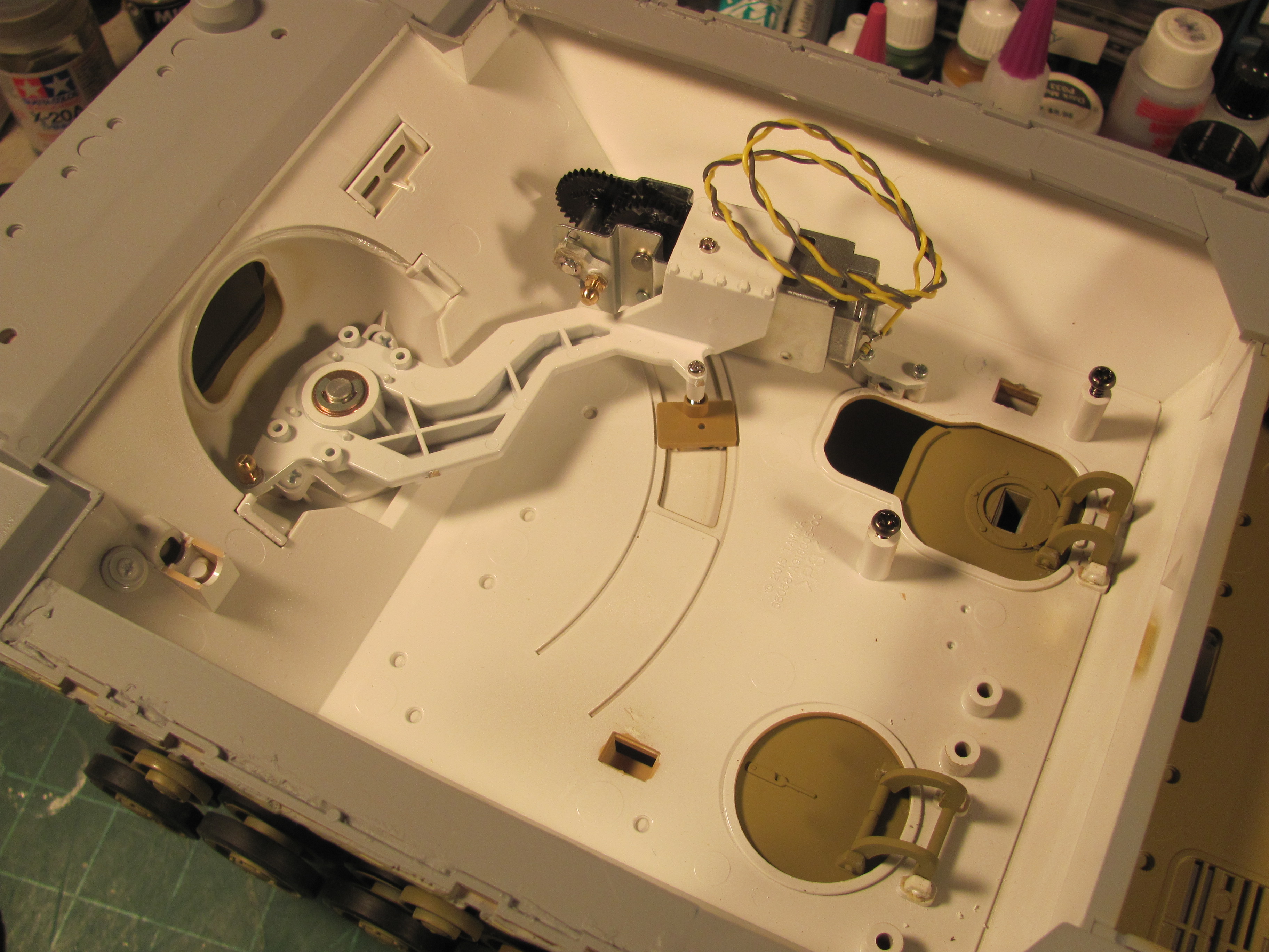

the rotation unit is installed
http://www.rcuniverse.com/forum/atta...mentid=2178332
the main gun is assembled
http://www.rcuniverse.com/forum/atta...mentid=2178333
The cable for the headlight in place
http://www.rcuniverse.com/forum/atta...mentid=2178334

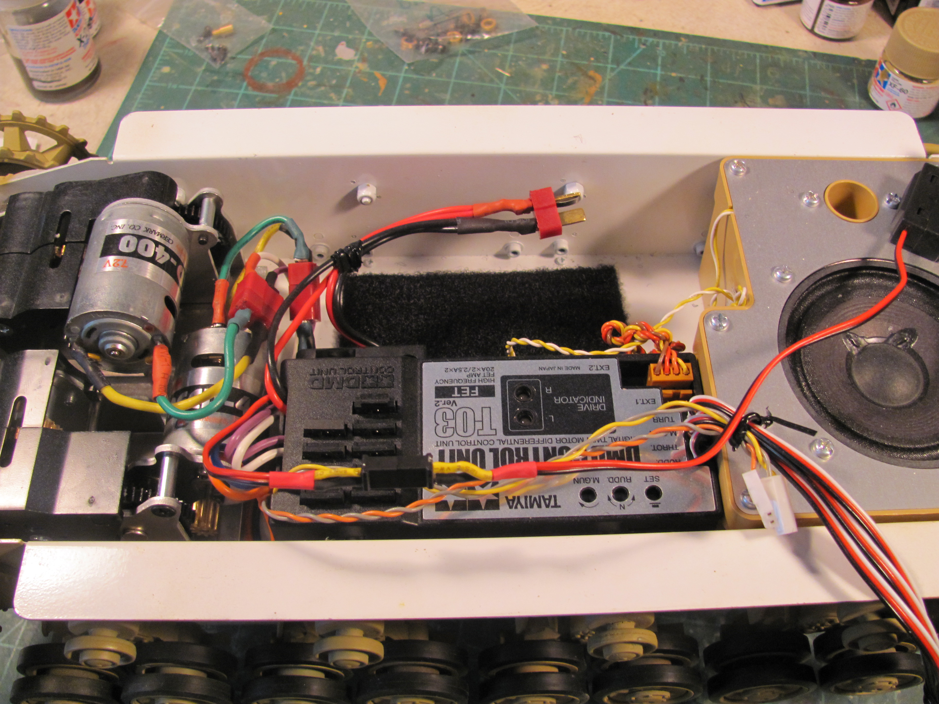

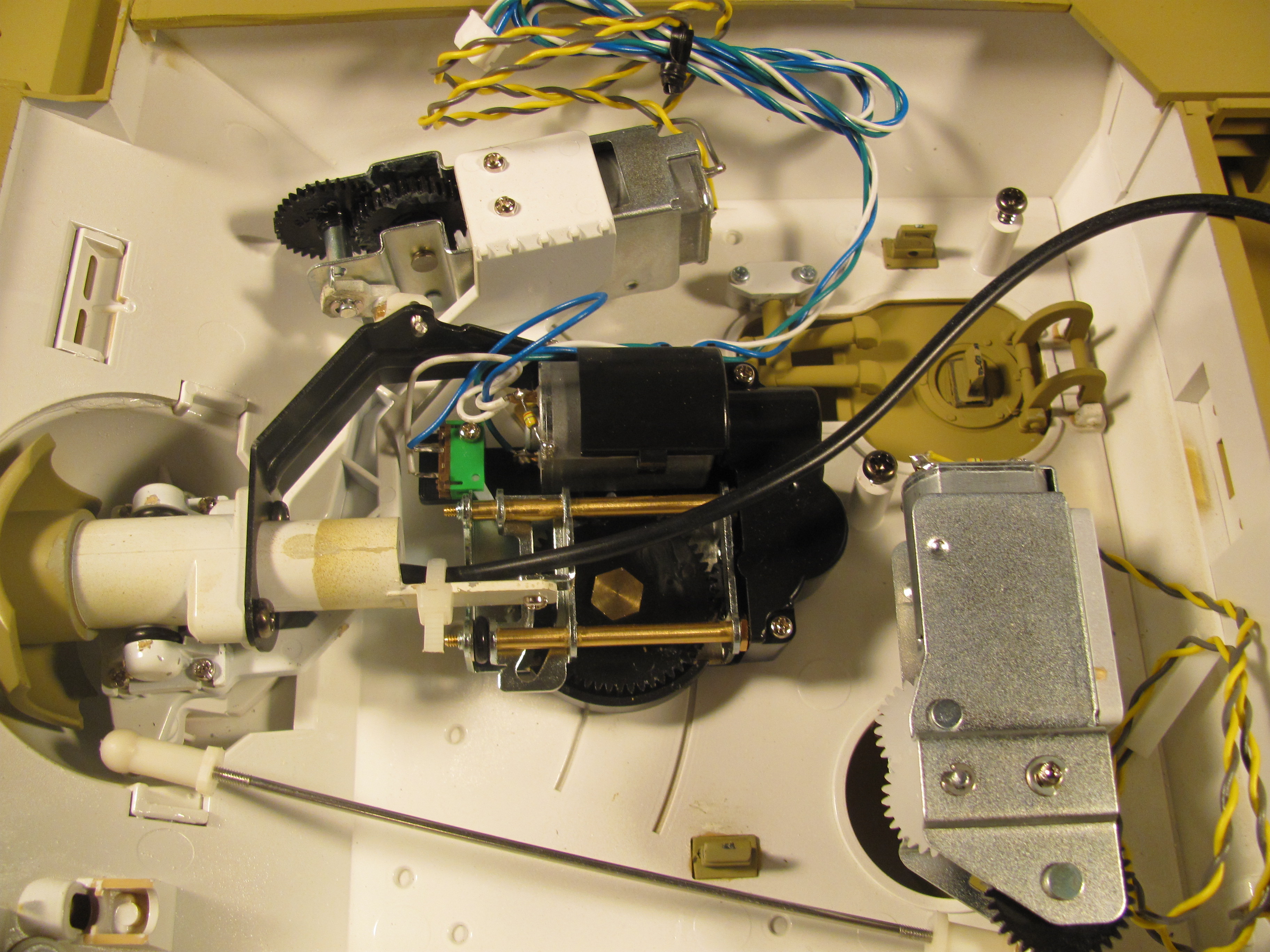

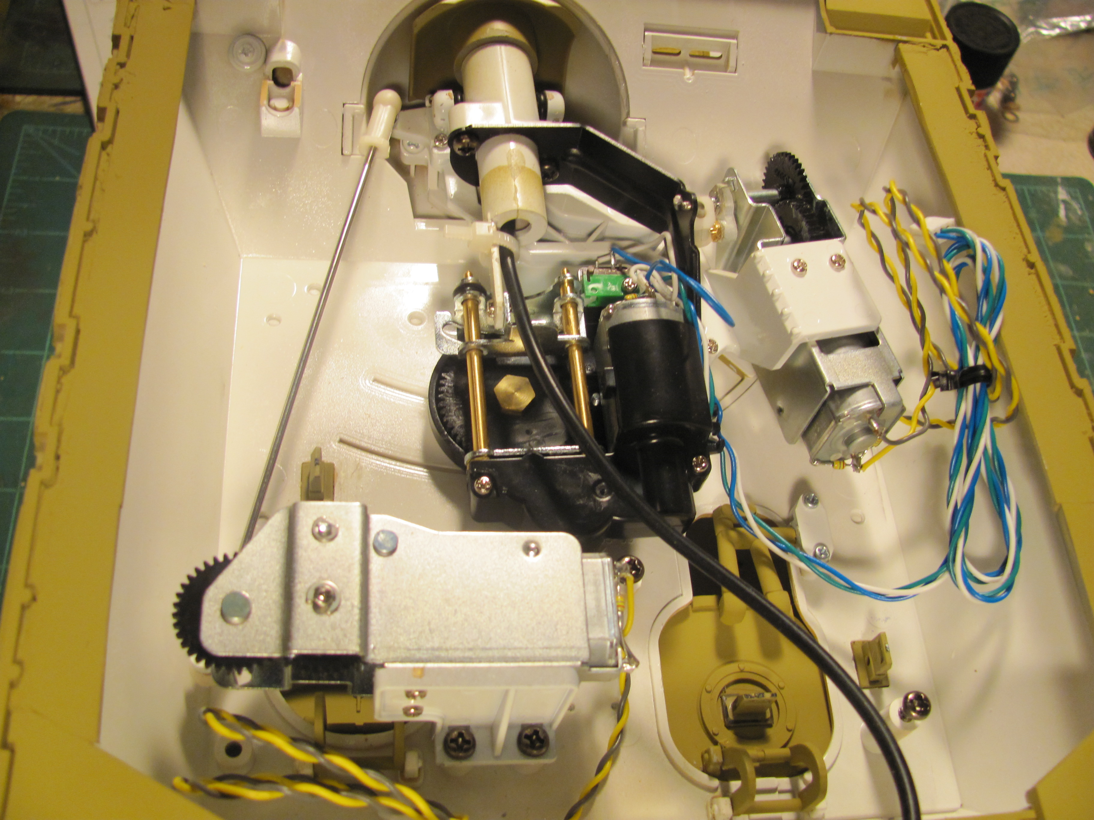

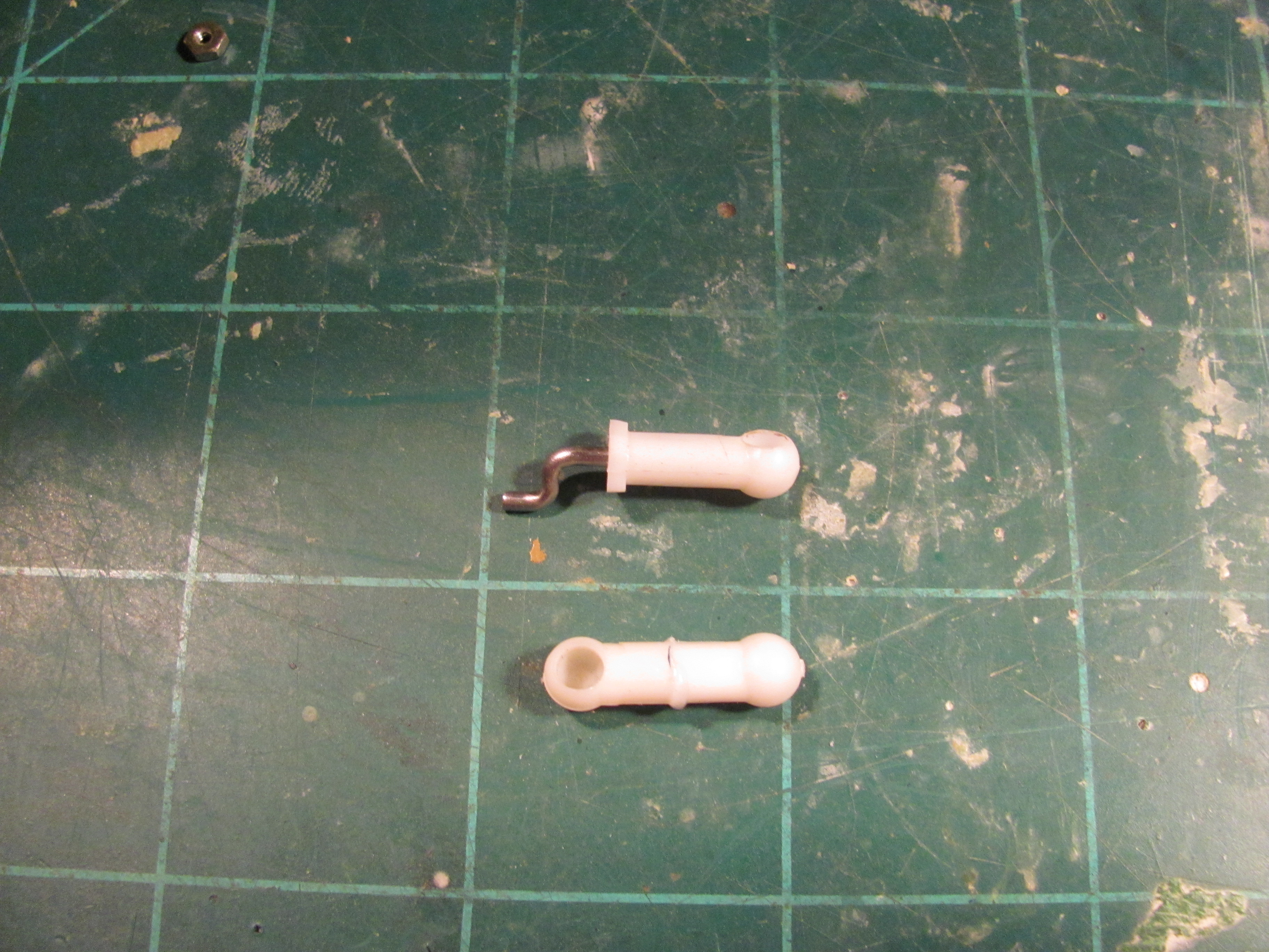

the electronics are mostly installed, still need to mount the Hull MG. space is a cramped, i dont like the flimsy elevation mount, the gun wobbles a lot, there isn't a spring at the rear of the recoil unit like on other tamiya tanks.
http://www.rcuniverse.com/forum/atta...mentid=2178365http://www.rcuniverse.com/forum/atta...mentid=2178366http://www.rcuniverse.com/forum/atta...mentid=2178367

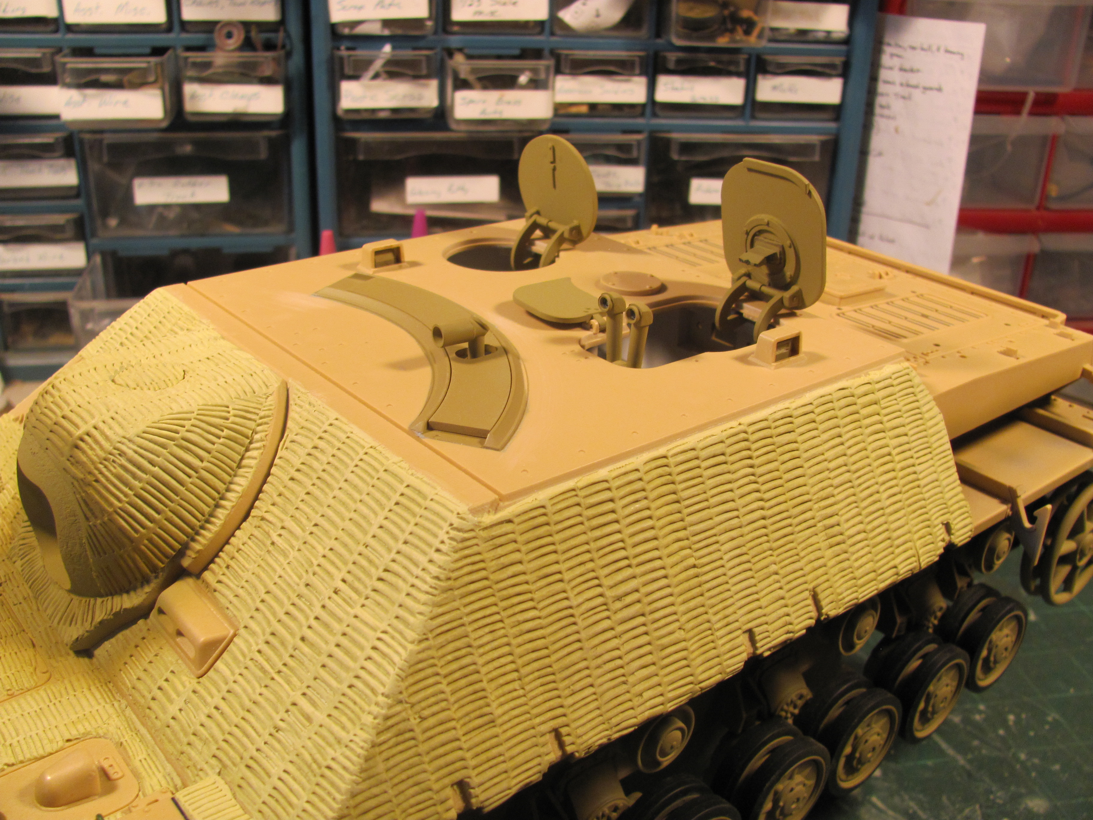

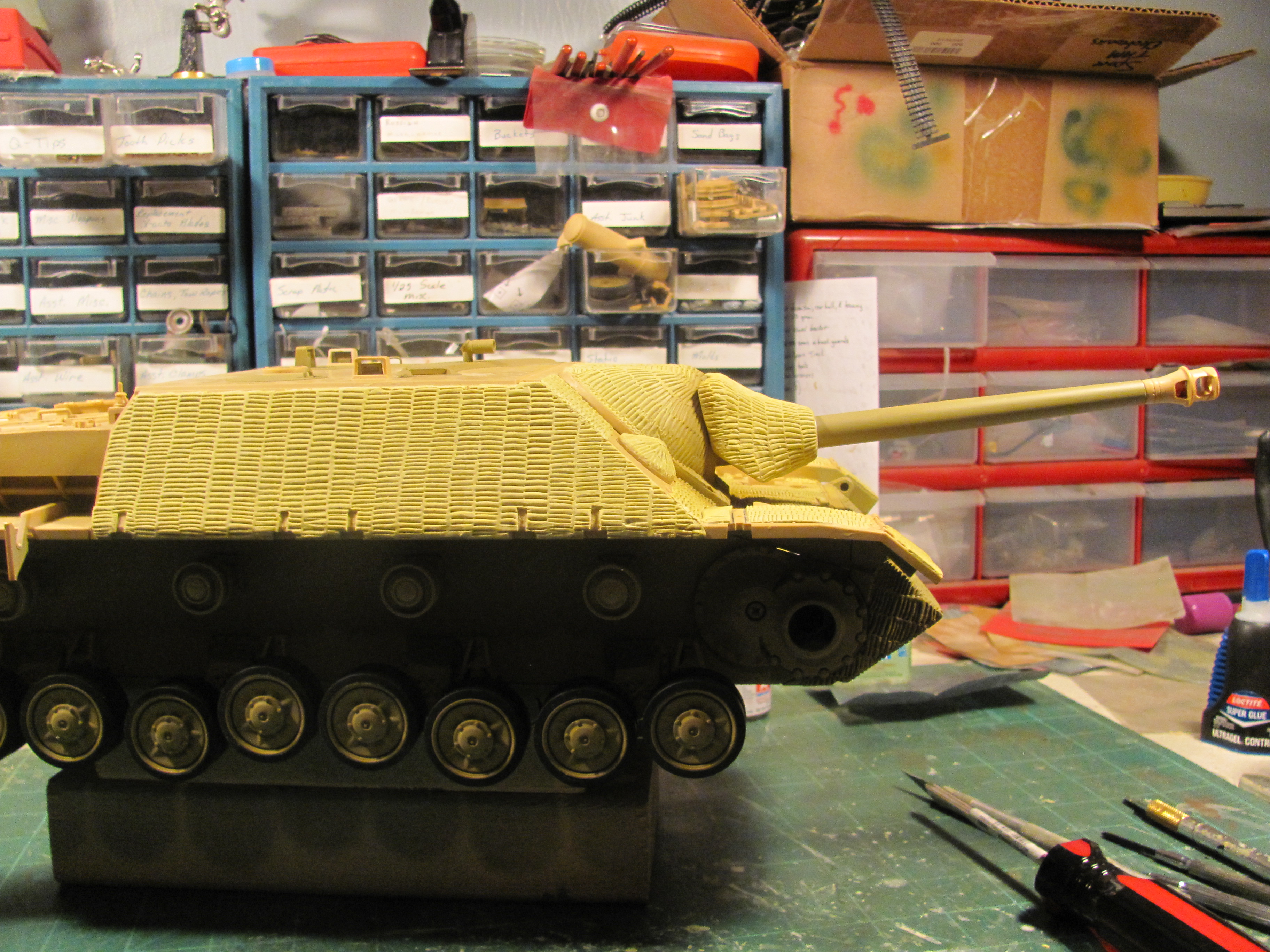

manchu9inf 08-26-2016 05:59 PM
4 Attachment(s)
here is the JPz with the gun mantlet and muzzle brake mounted. Hopefully tomorrow the speaker and gearboxes will get mounted.

Sounds like a another part for Daryl to improve on. If you make the trunion/traverse bracket out of aluminum should reduce some deflection. This was the same problem with the JP.

I haven't built the JP, but i think the problem is at least twofold: one, is how they have the elevation arm with that flimsy bent piece of metal that hooks into the recoil mount and second, the whole system isn't balanced well, i cant imagine how it would flop around with even the longer barrel.

i have made a more solid elevation arm with some extra parts, it helps but doesn't completely fix the problem.
http://www.rcuniverse.com/forum/atta...mentid=2178469http://www.rcuniverse.com/forum/atta...mentid=2178470http://www.rcuniverse.com/forum/atta...mentid=2178471http://www.rcuniverse.com/forum/atta...mentid=2178472

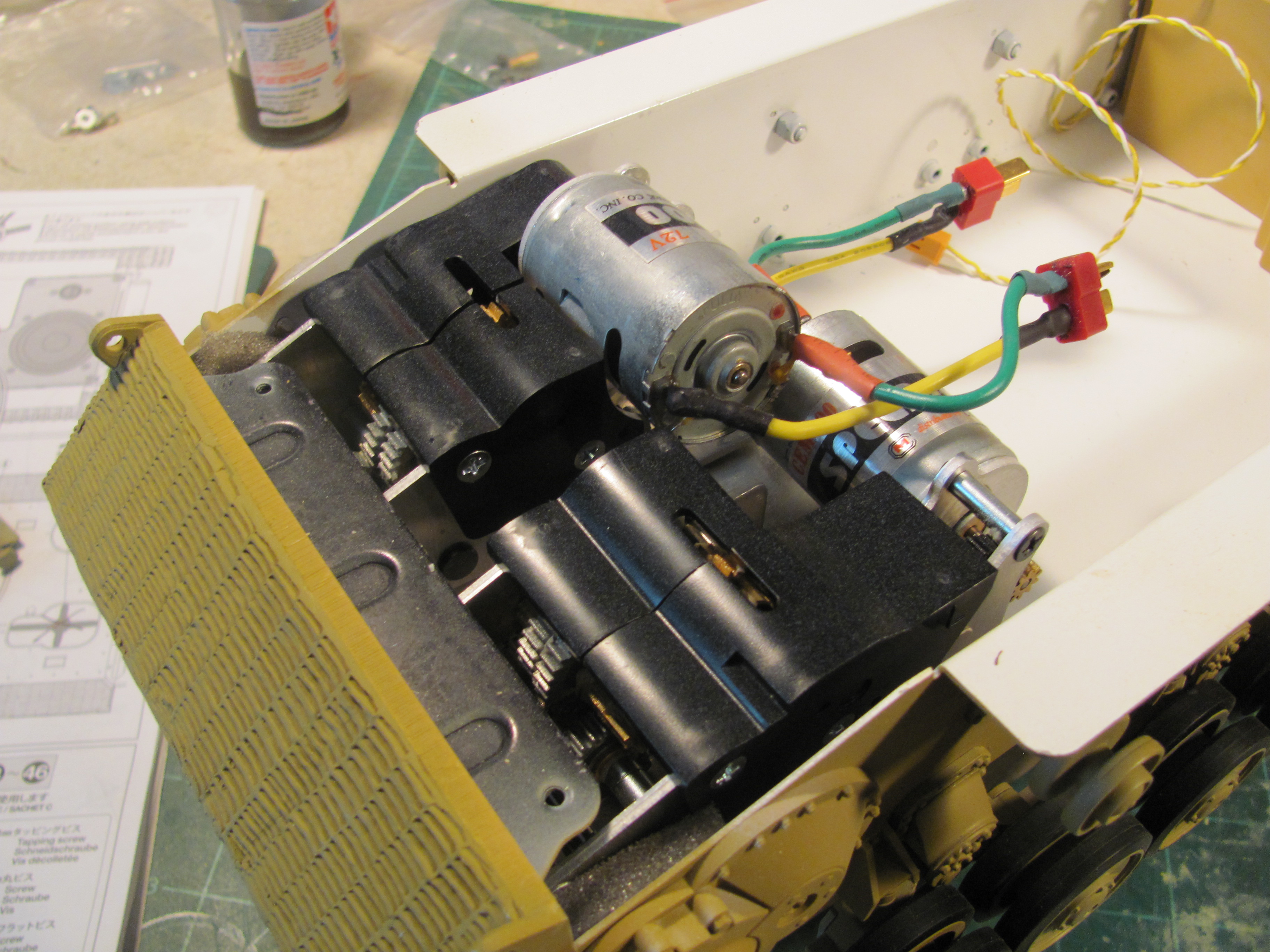

The gearboxes, MF, DMD, and speaker installed. I like to use the foam around the outshafts to help prevent dust and debris from getting inside the tank.
http://www.rcuniverse.com/forum/atta...mentid=2178478http://www.rcuniverse.com/forum/atta...mentid=2178479http://www.rcuniverse.com/forum/atta...mentid=2178480http://www.rcuniverse.com/forum/atta...mentid=2178481

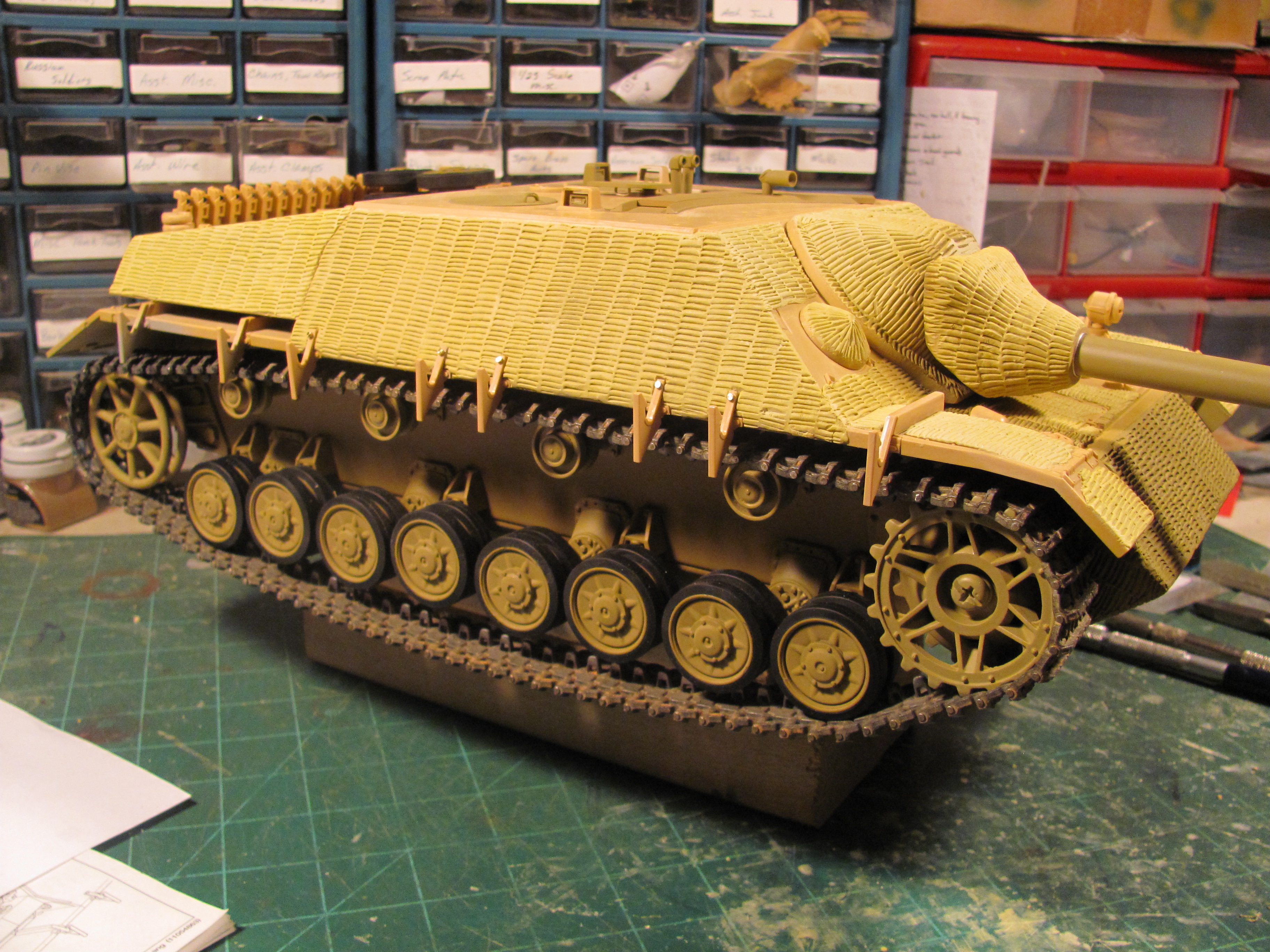

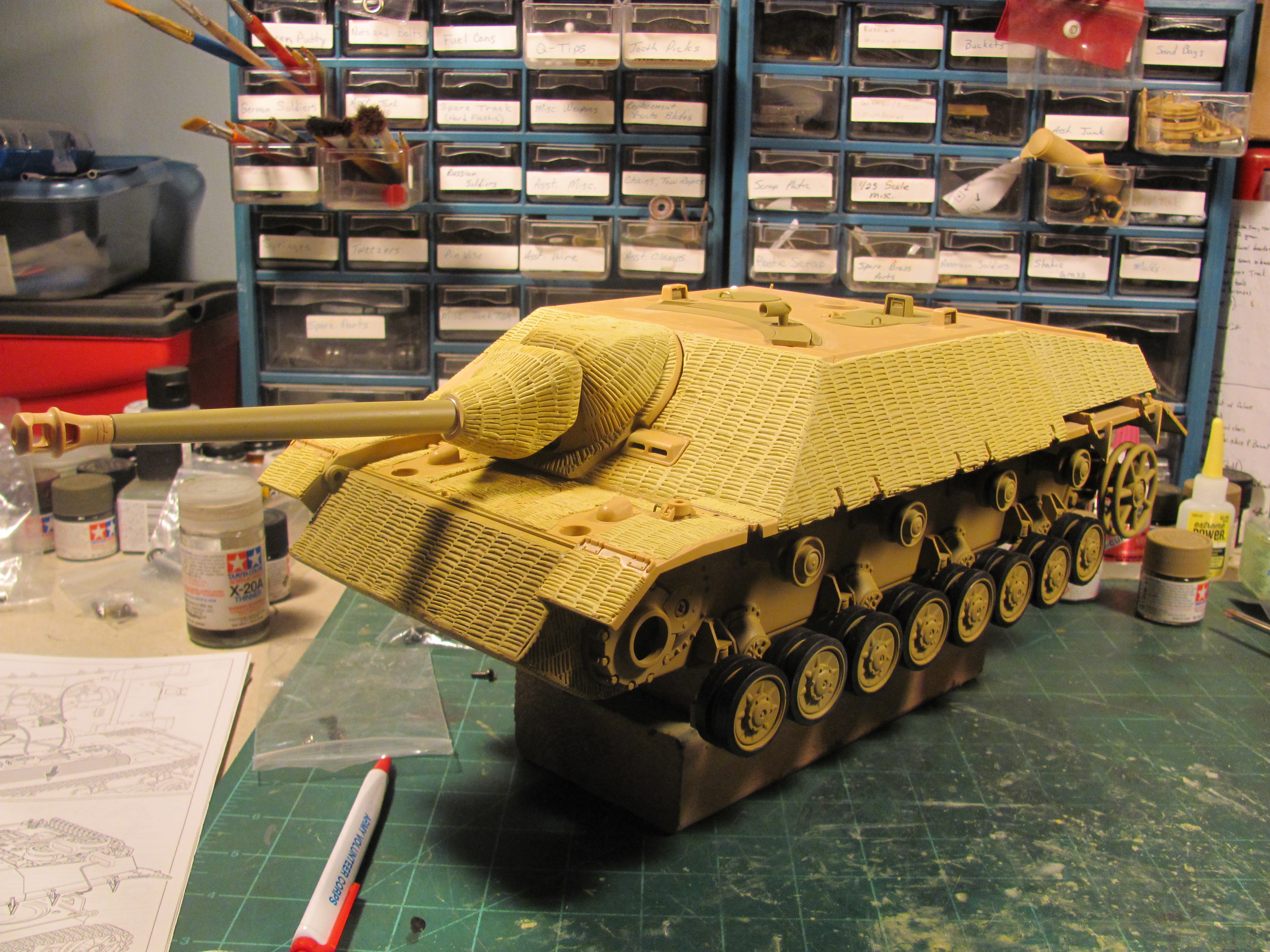

The tank hunter with tracks.
http://www.rcuniverse.com/forum/atta...mentid=2178485http://www.rcuniverse.com/forum/atta...mentid=2178486

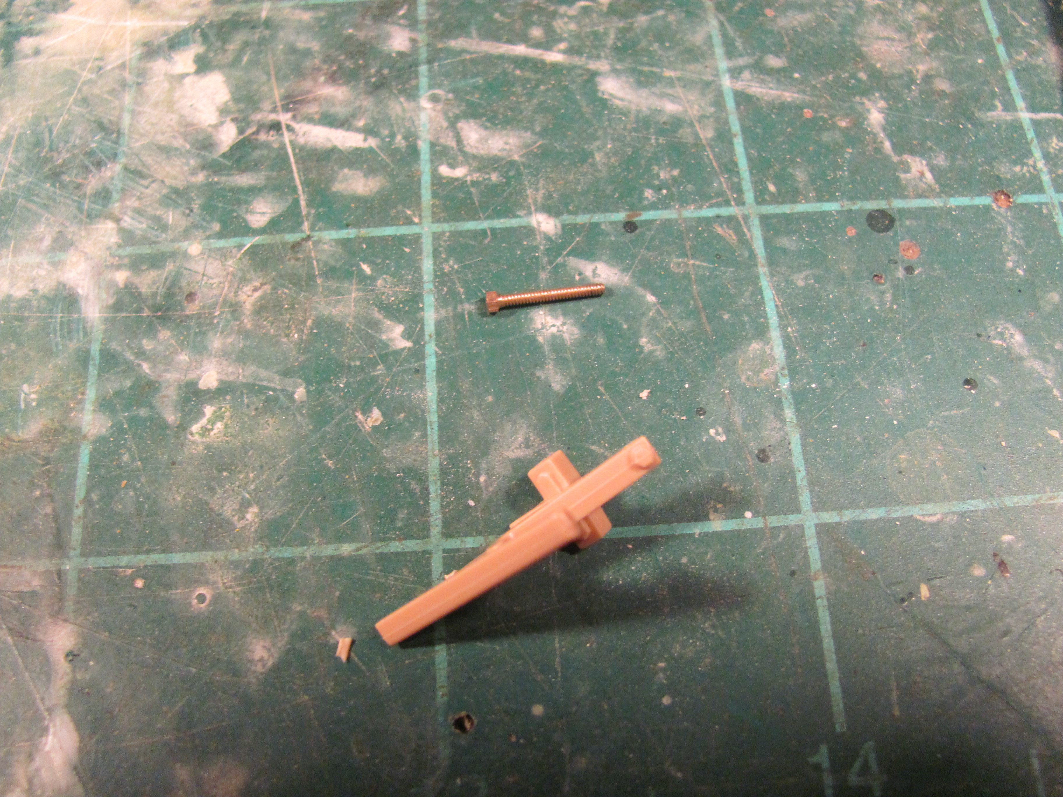

The hull schruzen brackets i added 1mm brass bolts to replace the molded on bolts heads as well as to add a little more bracing, hopefully they will stay on better.
