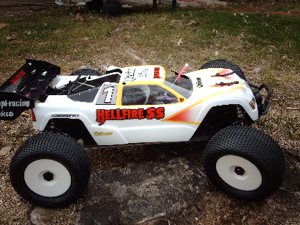

Made a little wallpaper out of my Hellfire SS
http://img529.imageshack.us/img529/4...iressbggo1.jpg
Still haven't gotten a chance to run her as I'm waiting on a pipe..
.http://img529.imageshack.us/img529/4...iressbggo1.jpg

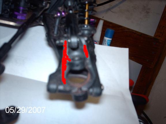

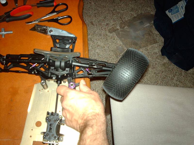

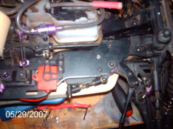

OK so I went through the whole steering system and this is what I came up with. I started with the steering knuckles and hubs. I ground a little clearence off of each side of the hubs and a little off of the outer front of the steering knuckle. I kept noticing that my servo would only travel a short distance when turning left. I was messing with my Nomadio React trying to get more travel out of the steering servo and finally noticed what was stopping it. The linkage coming from the servo saver actually hits the upper deck. I turned the screw and nut upside down but it still hit so I actually ground some clearence into the upper deck. I also ground some clearence into the front servo mount and removed the rubber grometts from the servo to let the servo set back a little farther inside the chassis. I'm not so sure that last step was nesasary though because after I got everything ground out I discovered that the final limitation to steering travel was the wheels hitting the steering arm links. The pics below are poor quality but they are the best I can do with my crappy gigital cam. The pics are all of places that I grinded clearence except for the pic of the wheel. That picture is just there to show that once you get to the point where the inside rim of the wheel is rubbing the steering linkage you have gone as far as you can. I wish I could say that I've tested these mods but it won't quit raining here [&o]. I am pretty confident though that I've gained quite a bit of steering. I did all of the grinding with a dremel using a small sanding drum for the plastic and a stone grinder for the upper plate. As allways you should know that I'm still pretty much a newb and you should take this advice at your own risk!! But if you decide to try this out, good luck and take your time. If anybody's got questions, post them and I'll help or explain better. Post u later

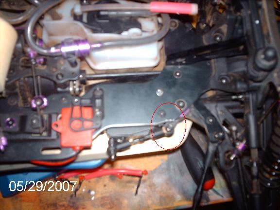

I guess if I had it to do over again I would start with the upper deck clearence. I am pretty sure that was causing the limited travel when turning left. Doesn't say much for HPI enginuity but I still love my Hellfire

Joined: Dec 2005
Posts: 281
From: Jay,
UT
OK here you go. Again I apoligize but my camera blows. Could somebody maybe tell me about a mode or setting on the camera that would allow me to take "up close" type pics? Anyway maybe these pics will help. I think that a person should start with the area where the linkage hits the upper deck and work out from there. Also I'll try to get a before and after if I can find the pics from when I built the SS and "thought" it had some serious steering throw. The first pic of the wheel is the stock set up the second pic is after grinding clearence. The red on the hub is basically where I did the grinding there. My red didn't turn out on the upper deck pic but you can see where it has been ground off at the corner to allow for the linkage. Oh and theres a pic of my lid too!!
OK now I've got a pic of the deck modding with a nifty red circle!

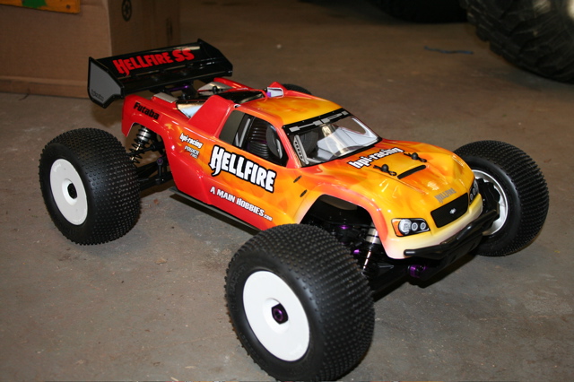

#900
Here's my Hellfire SS, just waiting for the ultra torque servo and 6V battery. I figured its called "Hellfire", so why not try the true fire paintjob? Its my 1st airbrush attempt. I was thinking of a black background to the flames but the red's alot brighter for track visibility. IMHO my best paint ever. 2nd pic shows my 4wd cars, a really old optima mid and nitro mt. my, how things have changed....
