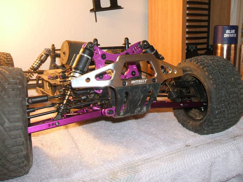

this is one tough truggy. love it. will have pics up soon. had to pick up all new front arms after the steering servo went out and hit a tree. so while i was at it got shock towers and a few little odds and ends.

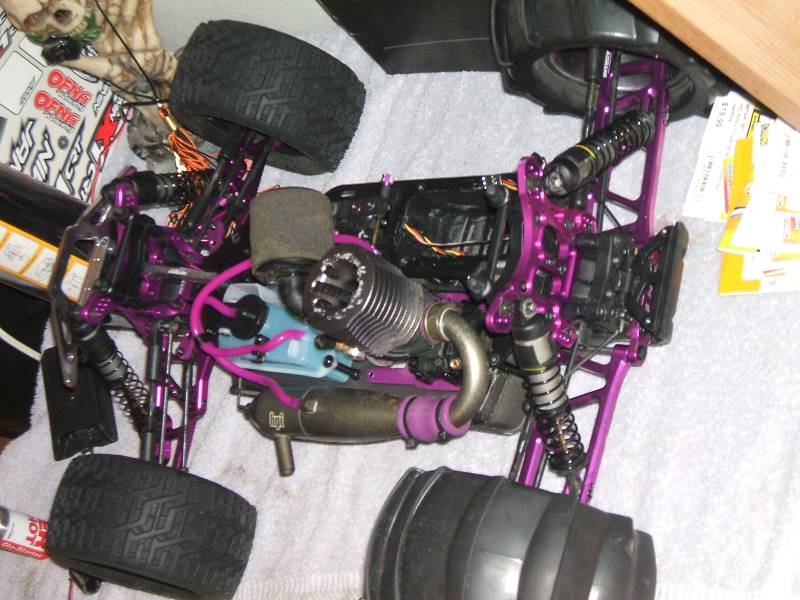

when i got my hellfire they didnt have the ss kit so i just got the RTR. i have:
Integy front and rear A-arms (purple)
Integy front and rear shock tower mounts (purple)
Integy front and rear chrome bumpers.
and a few other integy parts.
axis torque style rims in the rear mounted on paddle tires. and a few other things. i live 10 miles from Pismo beach Cali. i just took some video, going to edit it and then will post it.
how do you upload pics?

Thanks, yeah i noticed the wheels right after i took the pic. lol. stuff like that happens after a 12 hour work day and wanting to come home and put my truck back together.
