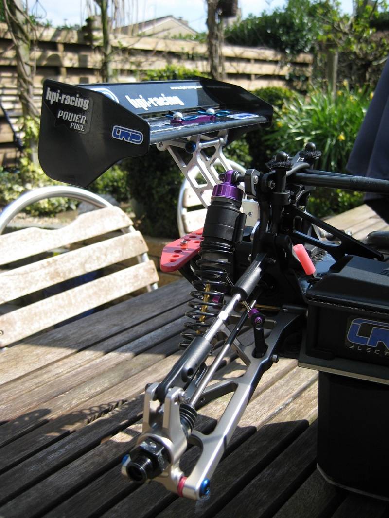

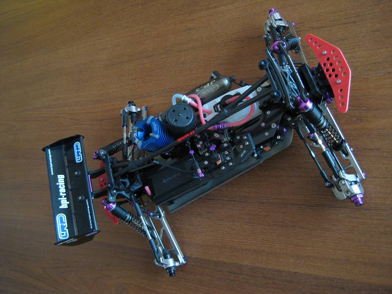

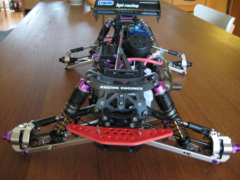

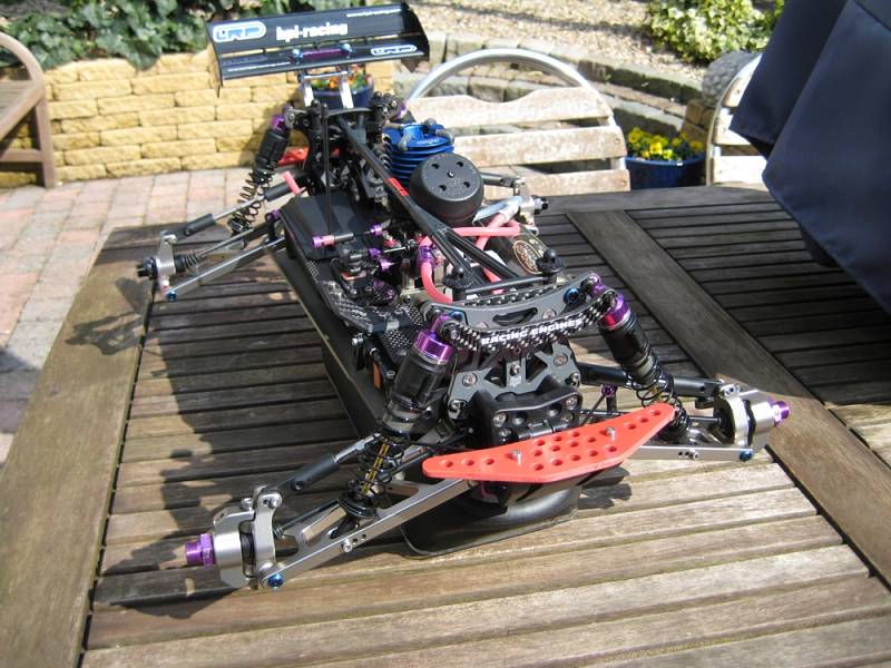

Hi, Buzz01.
Your HF look's impressive, i'm very interested regard the bumber you install. May i know where you get it from, or from which RC off-road.
I'm having a HF too, i like it a lot. As different people have different type of view regard the RC, but i just like it. I intend to improve it make it more better.
Thank you.

Thanks Kyo,
The bumper is a home made soft red plastic/lexan, no carbon here, to hard.
I like to do thinks differently, and i don't like the original bumper .
The upper deck is also home made and in two, for easy maintenance !!
Now i am making some 2.5mm carbon disk brakes.
The next thing is some custom made carbon side gards.
Never bore with the HF!!
I you want, i can sent a PDF drawing from the front and rear bumper, just let me know.

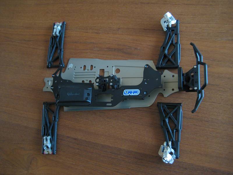

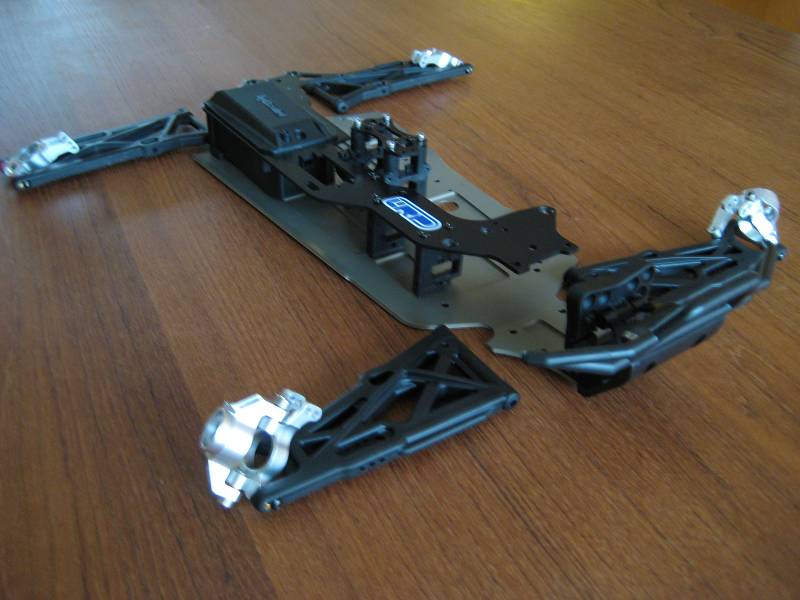

#1192
Actual size, trust me it is a perfect fit !! (print it, en you wil see)
I will post this evening a pic. from the shocktower support to.
