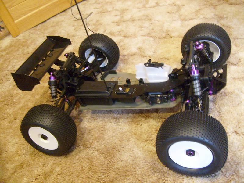

Old 05-02-2009 | 09:17 PM
  #1567
Joined: Apr 2009
Posts: 9
From: Canberra, AUSTRALIA
Default RE: Official HPI Hellfire Thread
NICE!!!! That is flying!!!
I so keen to get mine up and running!!! My engine is on it's way. Just went for an STS .28. I'll start with a cheapy and upgrade when it dies.
Is there any way to tell if the front or back diffs are leaking without physically pulling them out? I was hoping there might be a tell-tale sign or position, where you can see it drooling out of the casing???
To remove the fornt and back diffs, can i just remove the shock mount tower and the other bits and pieces that sit over them and then slide them out? Or is it a major hassle where i need to remove all of the steering gear aswell?
This is a pic of the beast now. Got a good idea for paint job too!!!

Old 05-02-2009 | 11:22 PM
  #1568
Joined: Jun 2007
Posts: 682
From: Gold CoastQueensland, AUSTRALIA
You will usually get oil around the outdrives/dogbones to each wheel when you have been driving it but when its new and unused like yors?
To get the diffs out remove the 2 screws from the bottom of the skid plate and then the 2 screws holding the purple suspension mount, then the 4 screws above holding the bulkhead. The diffs then slide out. Only takes 5 mins to remove diff and front and back remove the same way.
Remember to shim the diffs (pinion/crown) or they will wear out very very quickly. Also replace any worn bearings on the pinion.
Iam keen to break in my 5 port bump start sts28. Should have really good power but quality could be an issue.
