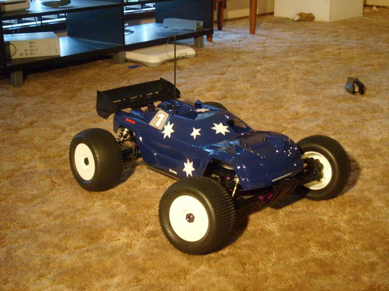

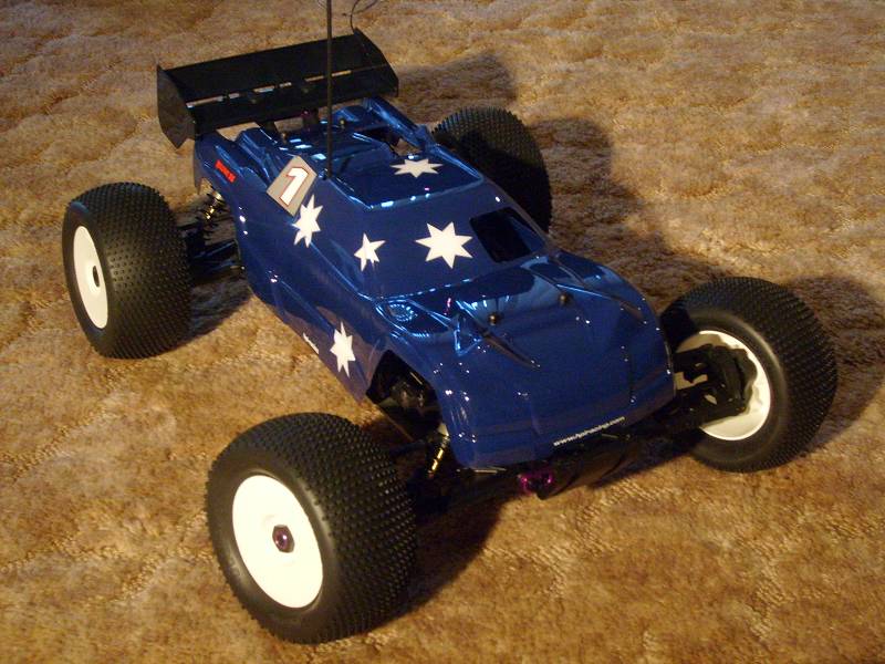

Here's a couple of pics of my Aussie paint job!

That looks sick!!! Nice!
